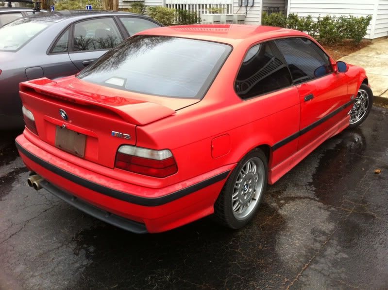

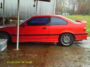

    well i recently picked up a 95 M3 a friend found on craigslist, i had one before and it was a very fun car
    so anyway here it
    i knew it was red from the ad but when we got there we found out it was the rare MugelloRot
    heres the pics from the ad
    its a one owner car its been very well taken care of as far as mech, has the factory keyless and alarm, window sticker all 4 keys and 2 remotes!

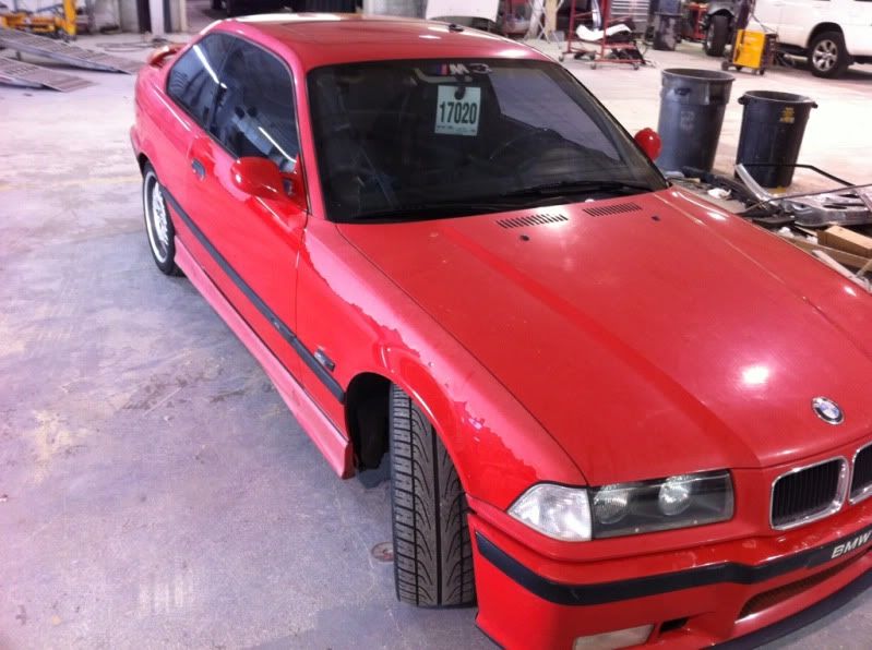

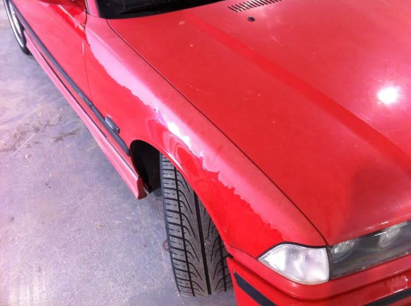

    only downside is that the paint is faded from sitting in the sun (mugello is factory single stage )

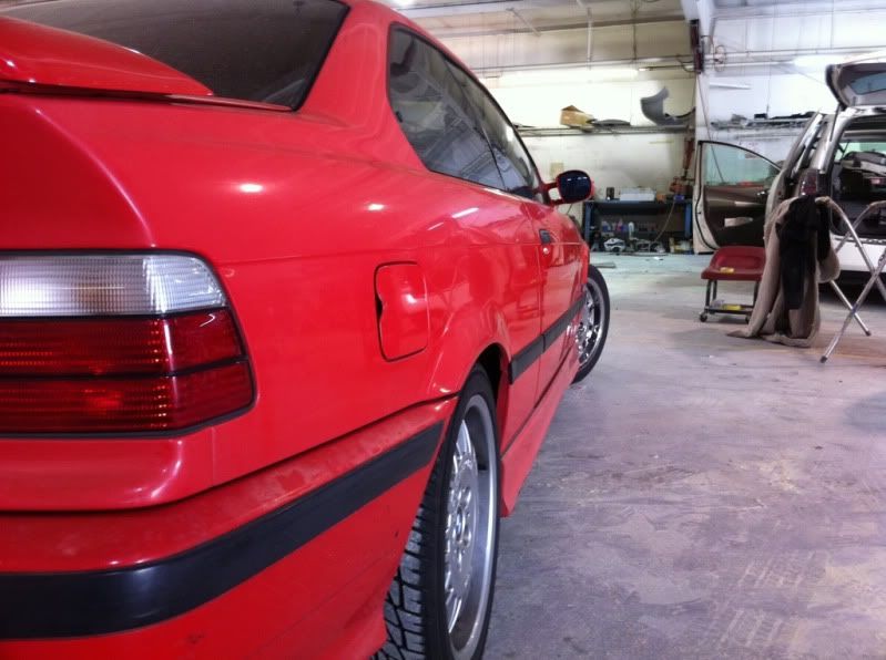

    but here is some pics i took when i first got it
    and at some point it had the fender replaced and they painted it and the door base clear
    also the headlights were very yellow as most of them tend to be
    but our buffer at work does wonders!!

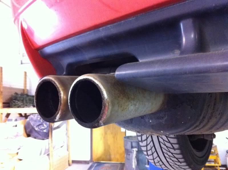

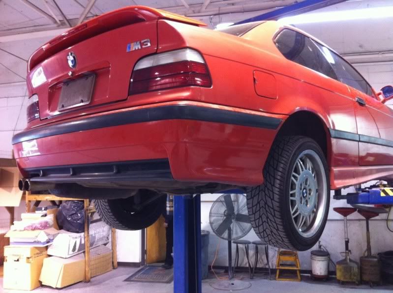

    the factory exhaust was all rusty and such
    so i picked up a nice catback for it
    and when it was on the lift i checked it out and i was amazed, all new bushings no leaks AT ALL

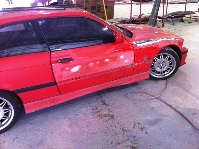

    then i sanded the flaking clear off the door and fender and fixed a couple door dings
    then on to the hood, i was gonna replace it but it was almost 1000 for a oem m3 hood so after MUCH struggling, it got repaired

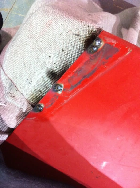

    and while i was detriming it for paint and took the wing off i though "hmmm this looks much better without it so needless to say
    holes welded
    grinded down
    Toxxxic's job interview
    New Project coming soon!
    Billy0cean crxsiguy's Avatar
    PimpsVille, GA
    2,579

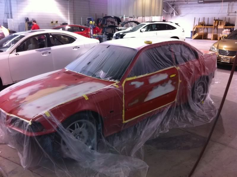

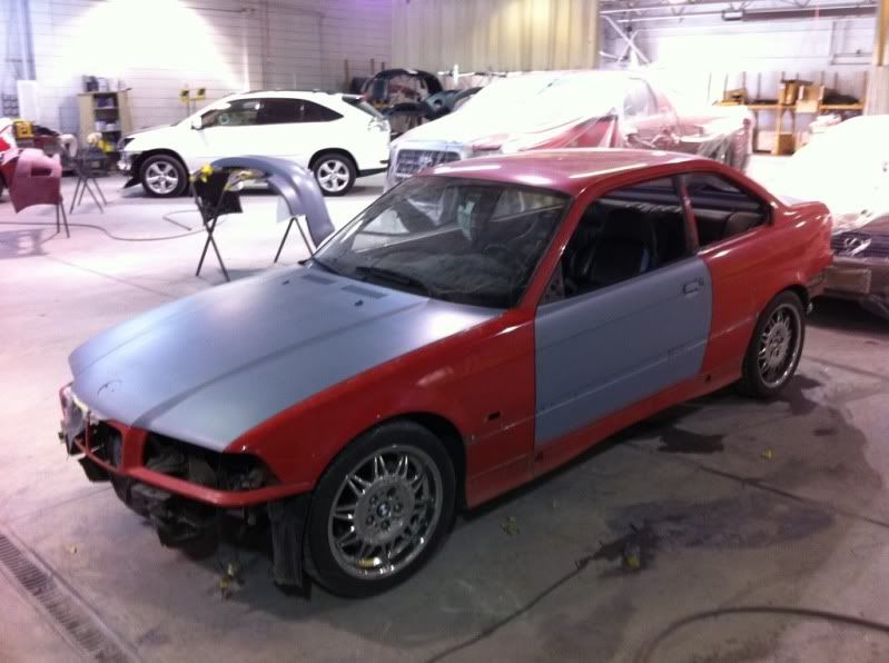

    and the driver door had a dent in it too so i fixed that
    then got everything all primed and ready for blocking
    then picked up a set of wheel
    and of course i had to do this
    and thats about where we are now cars torn down for paint and should be done soon, ill keep this post updated as i progress

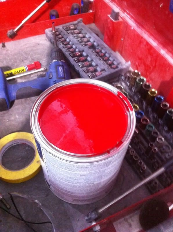

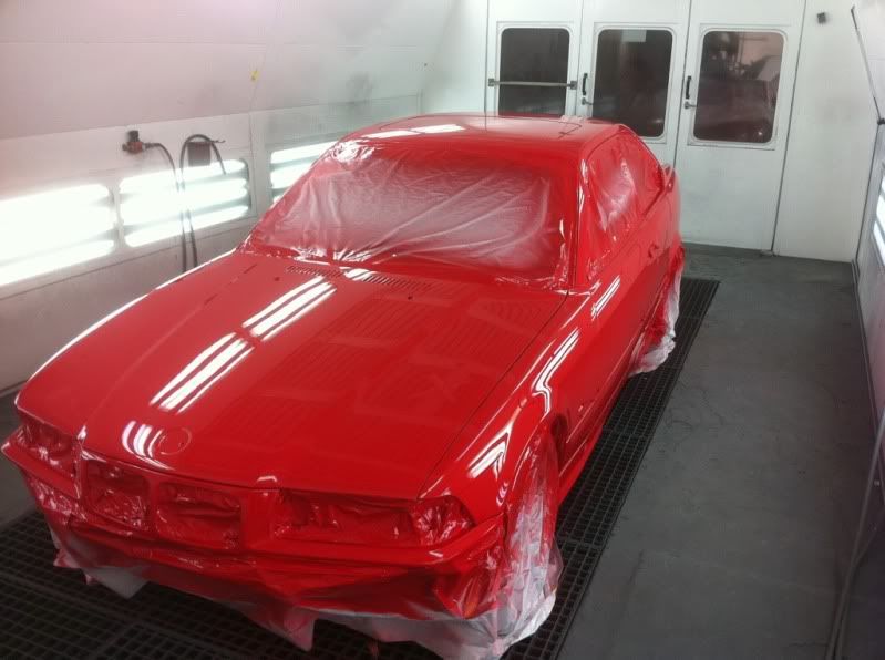

    this arrived
    and after months of collecting dust it made it

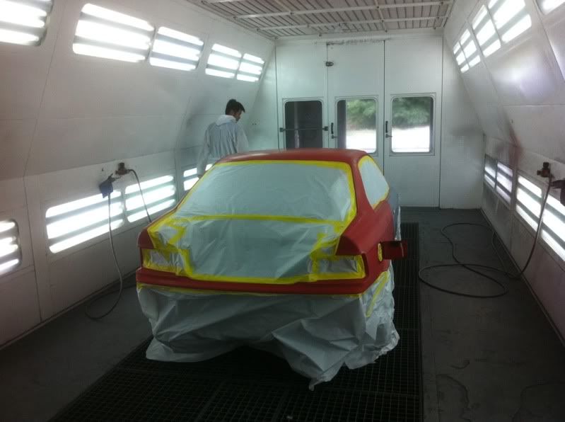

    a coat of sealer
    and the end result
    a separate booth for everything else
    and thats where it is now, i plan to build it up next week and ill post more pics when it is done of course!

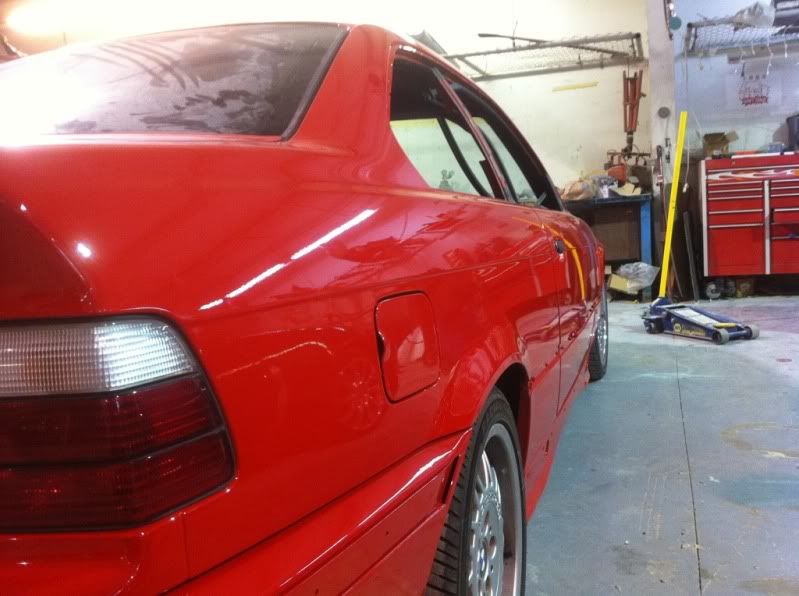

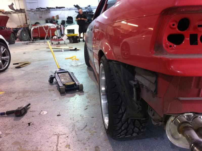

    not much of a update but heres where i am now
    got it untaped and pulled out the booth
    just a reflection shot before its wetsanded or buffed

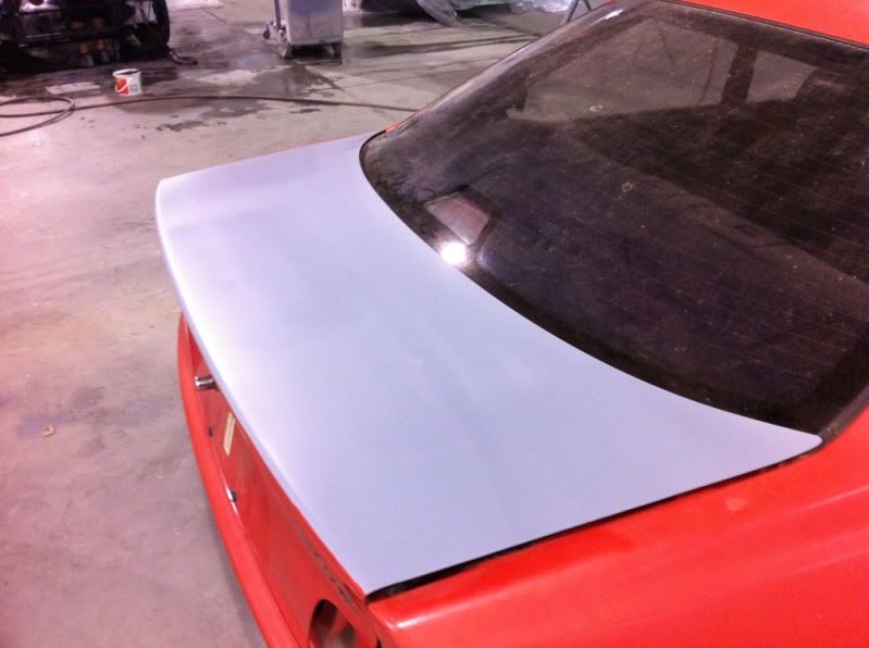

    built up the trunk and put on the rear bumper
    and i guess you gotta have these two pics
    and thats where i am now, more updates coming soon!
