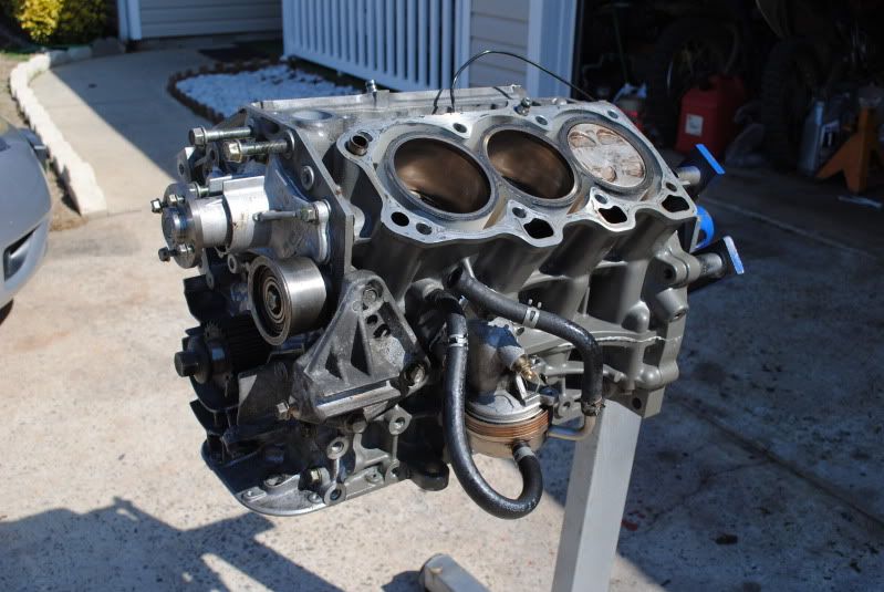

    Yessir. I bent two rods so its getting a fresh build.

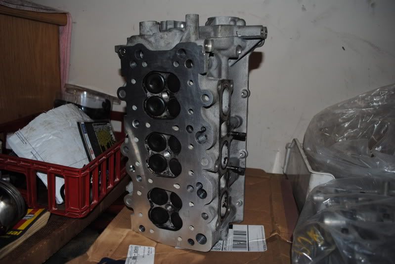

    Nothing crazy basically a stock rebuild with some new parts. I can't afford forged so I'm just going to use some rods out of another motor I have. Going to mill the heads to gain a little compression, and possibly port the heads too.
    And James it was a stuck open injector. Hydrolocked the motor basically.

    that block looks mighty clean!!!

    hopefully in the next few weeks. its pretty much a waiting game right now. im getting the heads shaved, but i cant get the heads back until i get the gasket set which hasnt come in yet, because im getting valve seals done too.

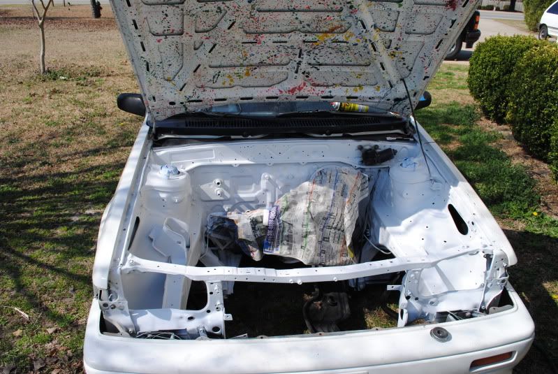

    clean bay man. never seen an engine tuck before....

    Looks like we are in the same spot with empty bays. Yours will be running before mine though. But I should have the motor in this weekend. I wanna see this car in person soon.!

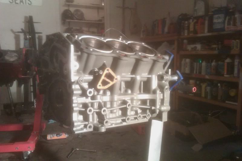

    last night's work. i hope to get it all finished up tonight..
    mmm, high compression...

    Lookin good bro. Did you do all the milling and polishing yourself or did you take it somewhere local?

    I got them .025 over. It's non interference so you can mill up to .055 with no problems.
    Quote Originally Posted by JBrakeS2K View Post
    Reeves performance over on Green St. did the work.
