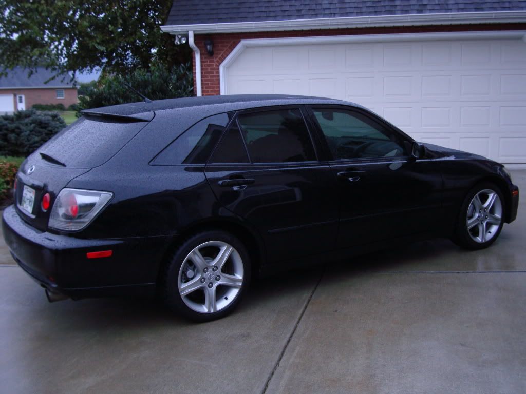

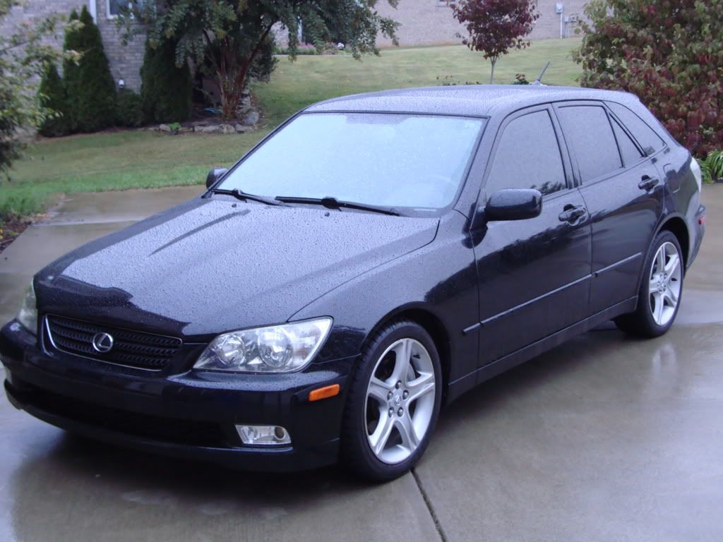

    Here she is when I got her. 2002 OB Lexus IS300 Sportcross.

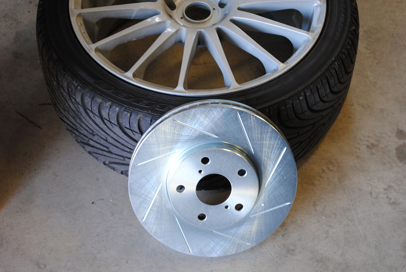

    Well then I couldnt stand the ride height anymore. TOO much gap! I first thought about just getting some springs and giving it a mild drop. Then some lil devil on my shoulder whispered in my ear.. GO LOWER!!!! So I decided to scoop up some Tein Super Street coilovers and got the EDFC to go with it.
    I thought to myself.. Well if I am going to handle a lil better and since I will already be right there working on the car.. Why not go ahead and replace the brakes too. So I ordered slotted rotors with ceramic pads...
    Finally got them in and did the install in about 5 hours.

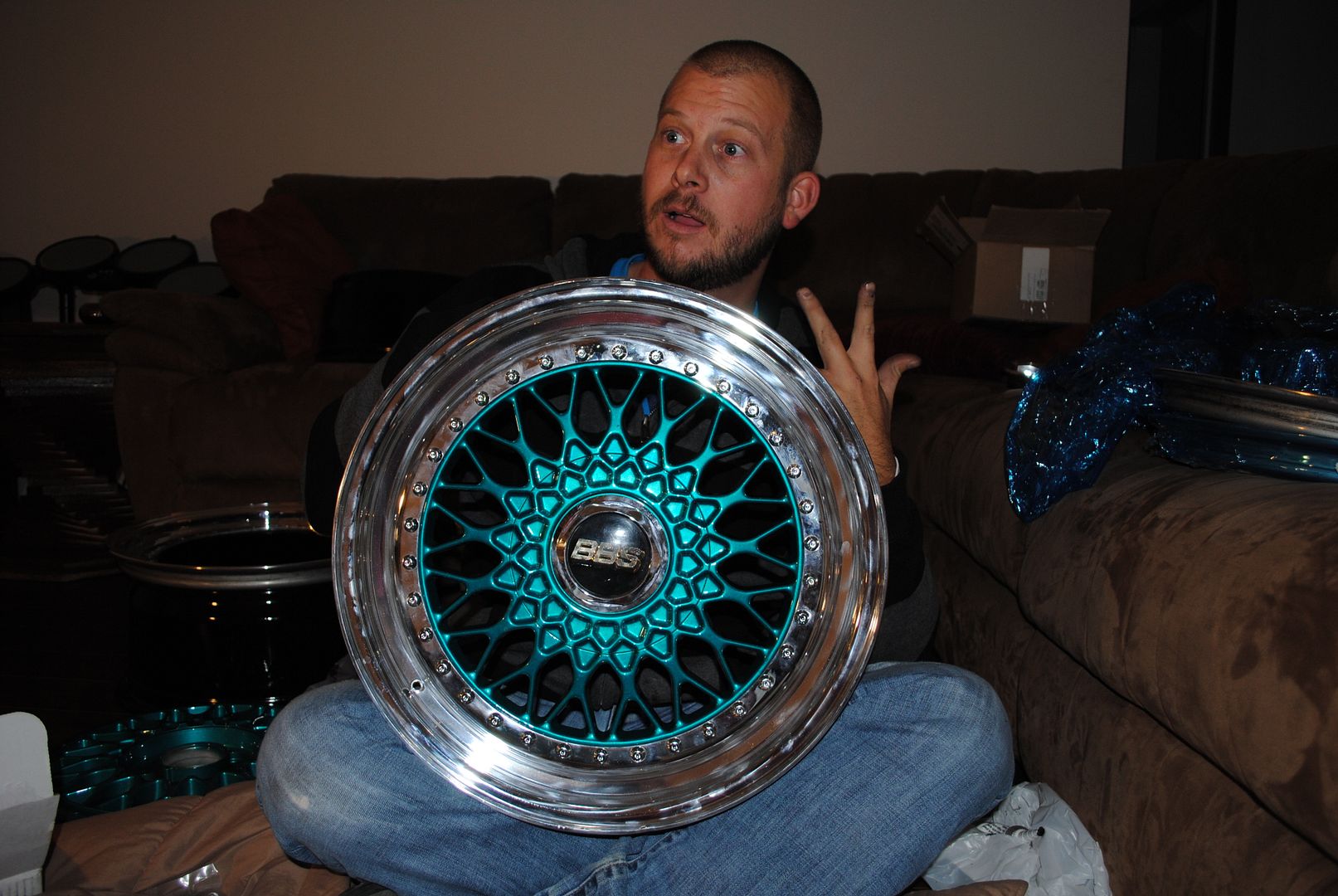

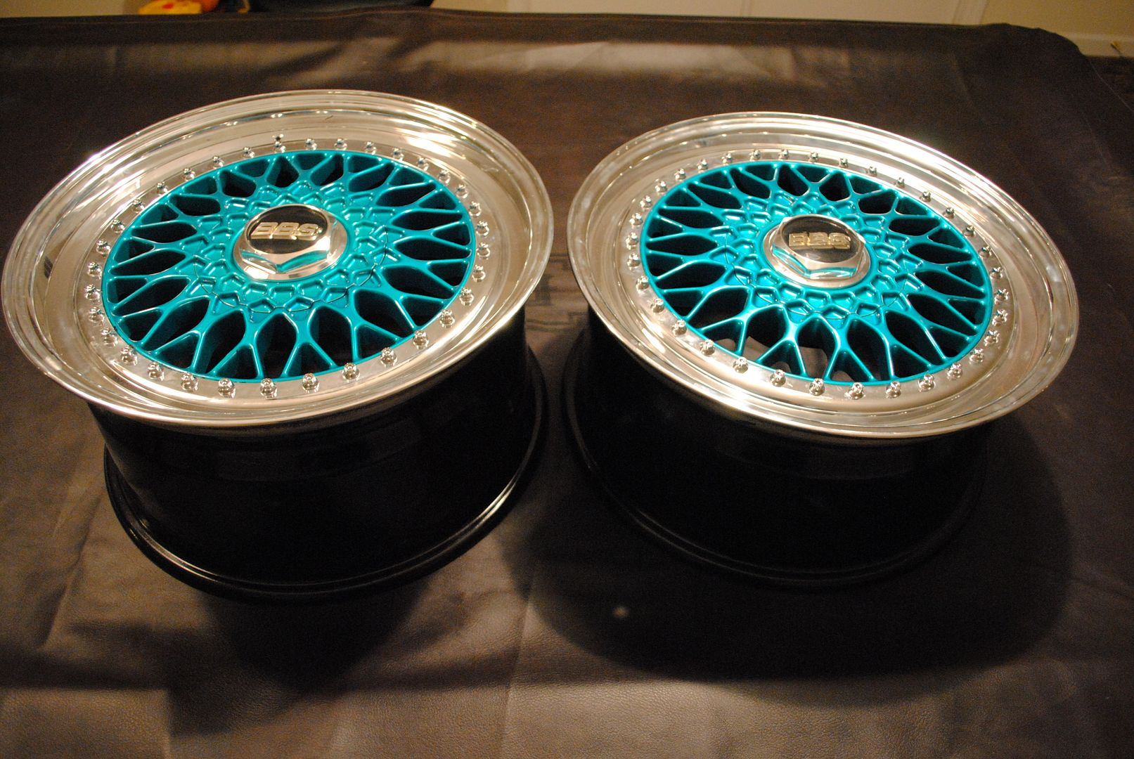

    17X8 +35 and 17X9 +40 BBS RS's

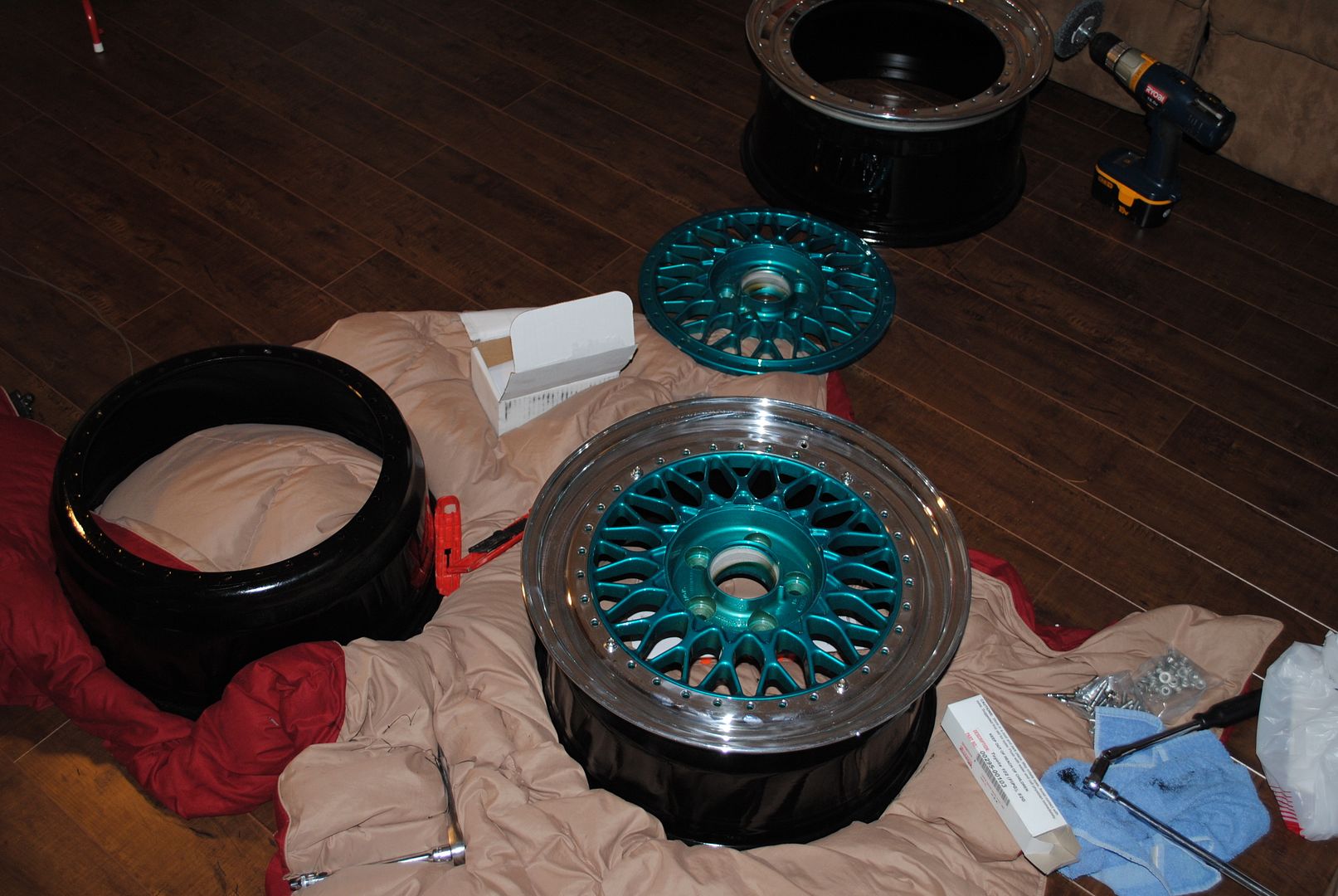

    I was stoked. I knew I needed to refinish them so I pulled them apart the day they came in. I had decided on a color scheme a lil crazier than I normally do to get away from the safe side...
    Barrells = Gloss Black
    Lips, bolts, hex center caps = Mirror Polished by me
    Faces = Candy Teal
    So they are dropped off at the powder coaters and I take the lips, bolts and hex centercaps home.

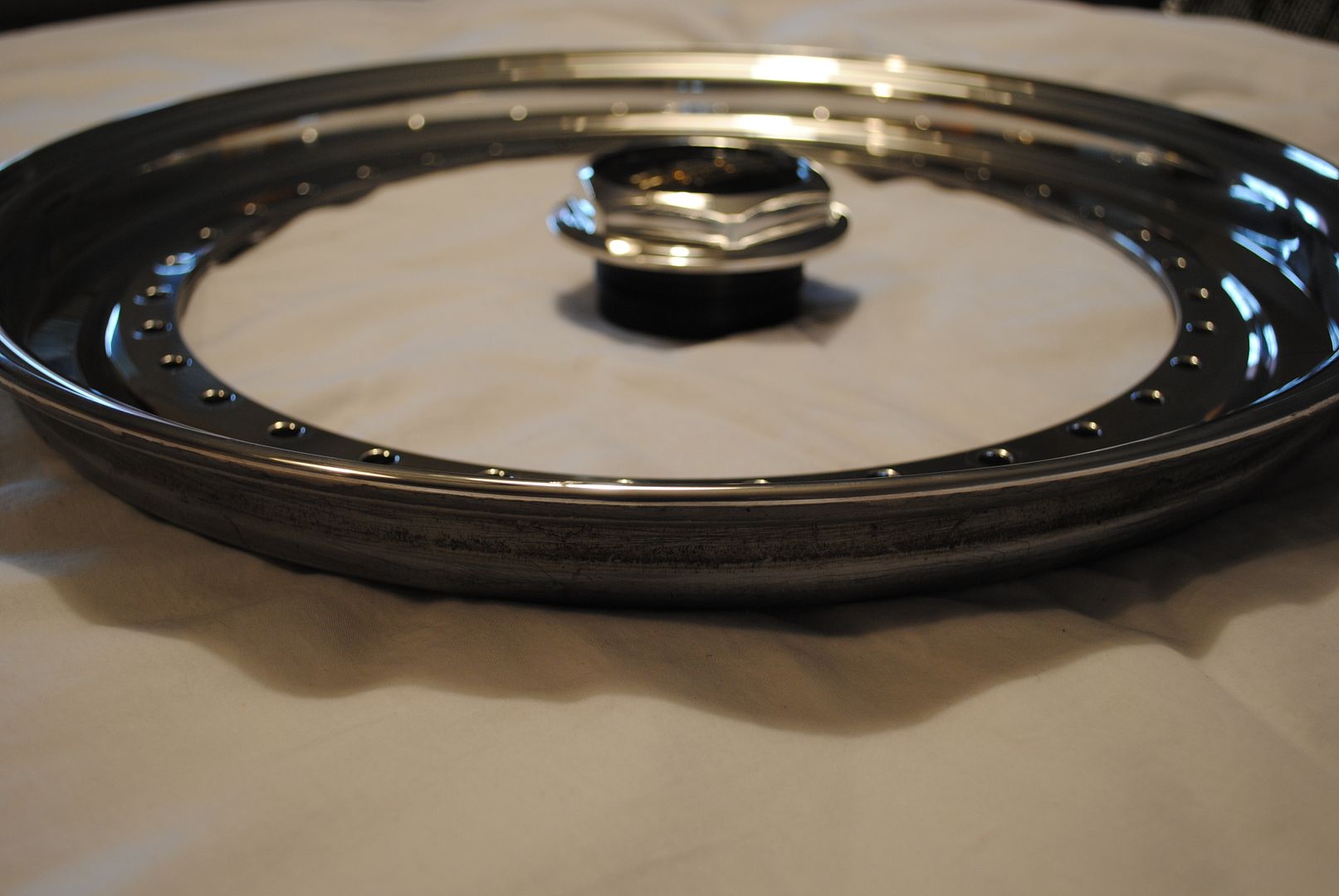

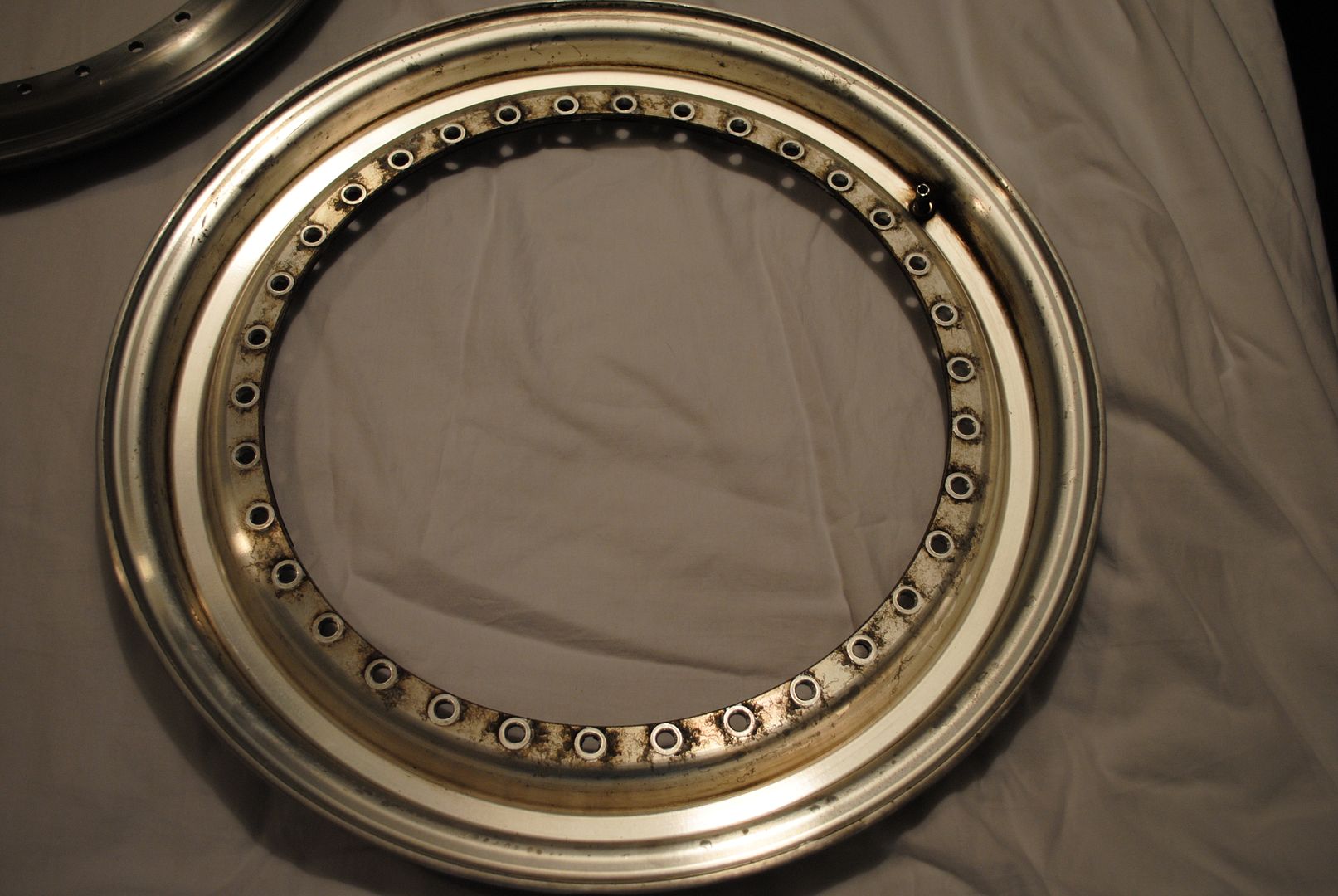

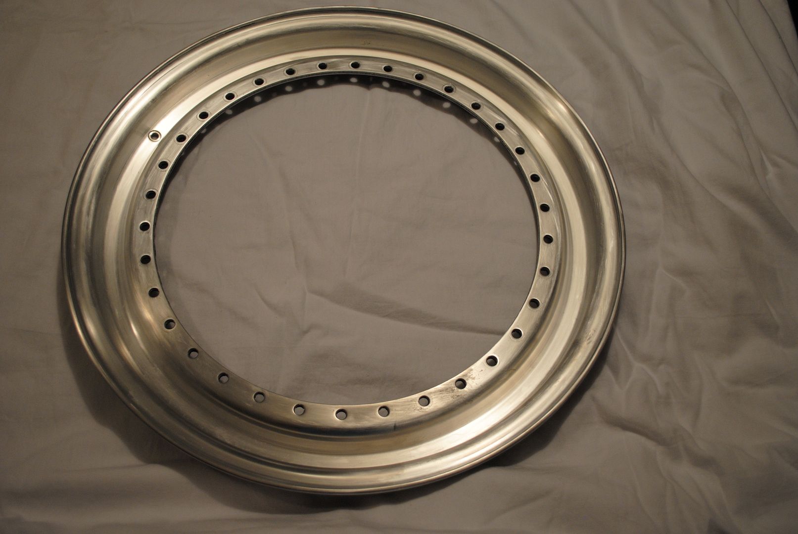

    So I started with 320 grit sandpaper and worked my way to 2000 grit. Wetsanding at 1000 grit and up. Slowly working my way through the clear and the grime that had eaten into them. I ended up with this.
    Side by side comparrisson
    I then did the same process to all the lips and all the center caps. I spent approx. 40 hours doing this process.
    Alarm clock went off. Got up. Showered. Got dressed. Yawned. Grabbed a Diet Coke. Ate some breakfast. And headed to the polish wheel in the garage. It was time to bring my hard work to life. I started on the cutting side polisher. Used the "brown" polish stick. Worked out the small surface scratches and imperfections. Then went to the other side with the "pink" polish stick to give it the full on shine.
    This is what I ended up with...

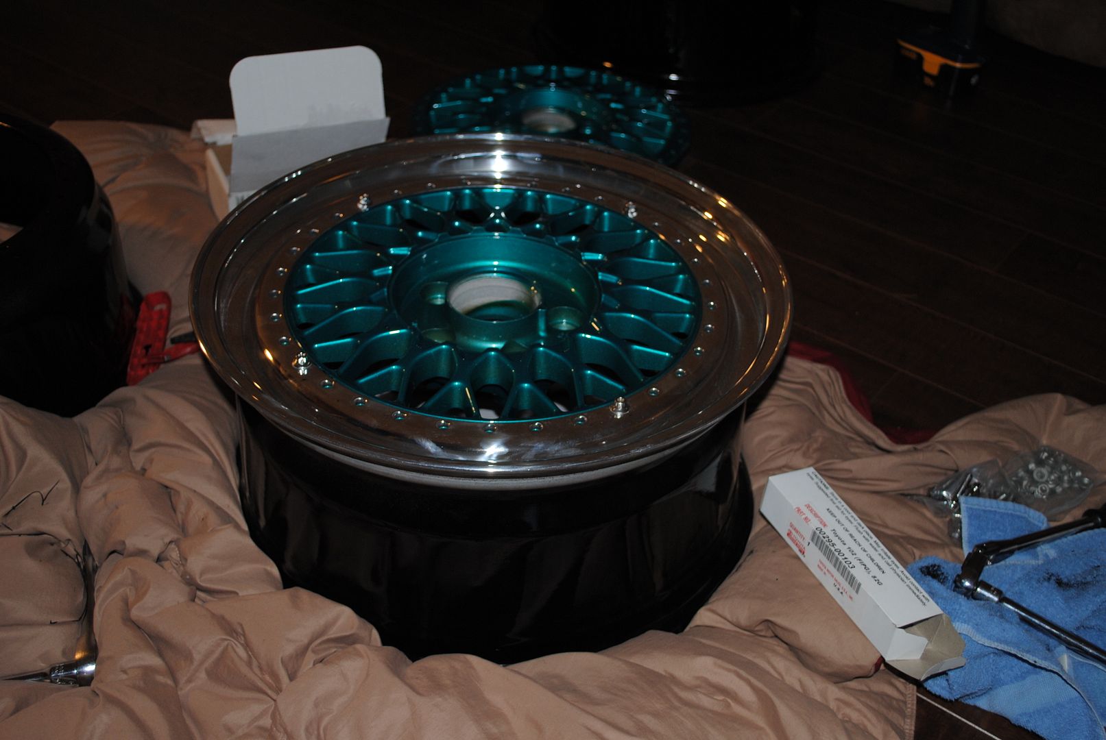

    All I gotta say is....
    BOOOOOOOOOMMMM Bitches.. Wheel one is done...
    Others are still in pieces.. I need to clean off the finger printed mess I have on them, so dont mind the smudges.

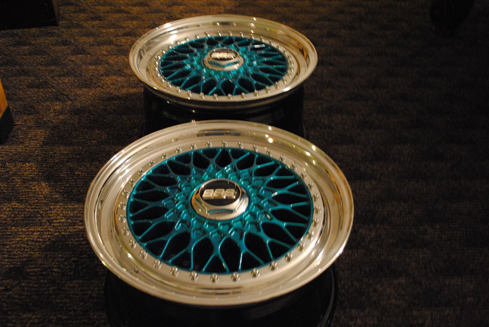

    Sorry to post again but snapped a few shots of the TWO finished.. Had to whore em out a lil more...
    One 17X8 and one 17X9 done.. one side of the car can be baller lol
