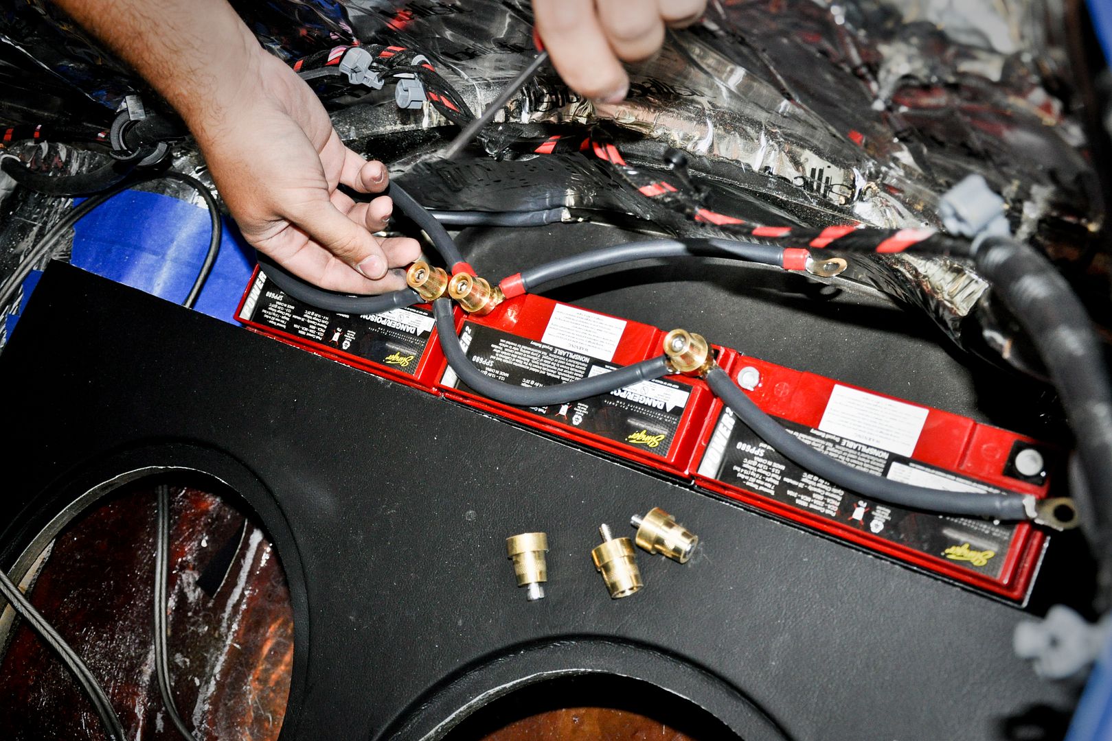

    -3 Stinger Batteries

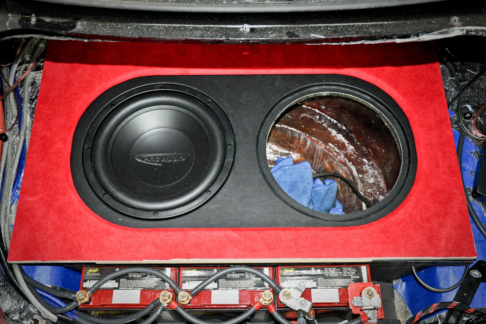

    -Complete custom trunk w/ custom fiberglass box, custom battery rack, custom amp rack, and custom trim

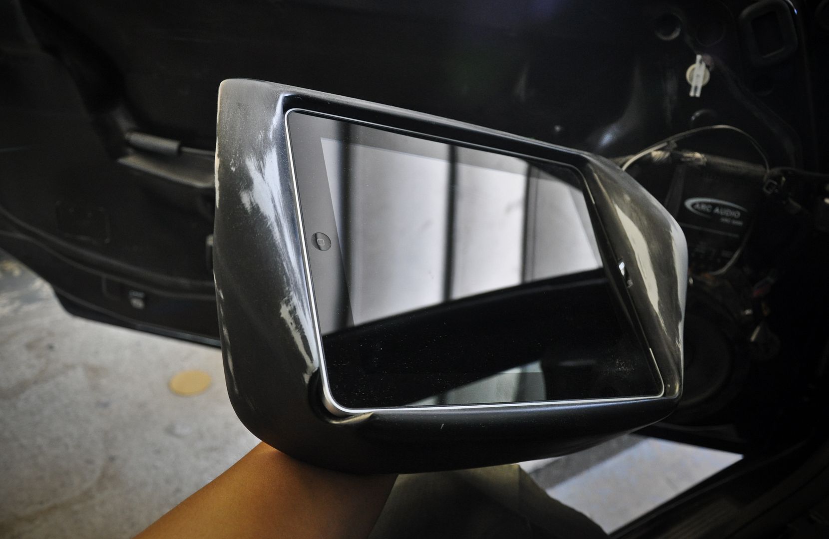

    -Rebuild dash to flush in an Ipad and radio w/ steering wheel controls, bluetooth, and secondary Iphone/Ipod connections

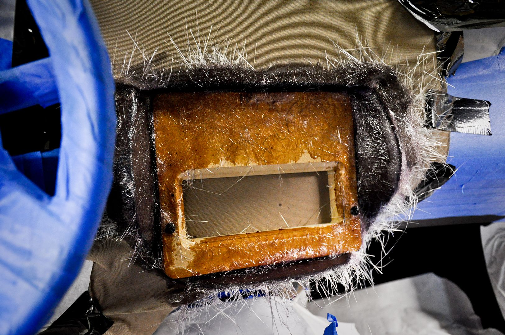

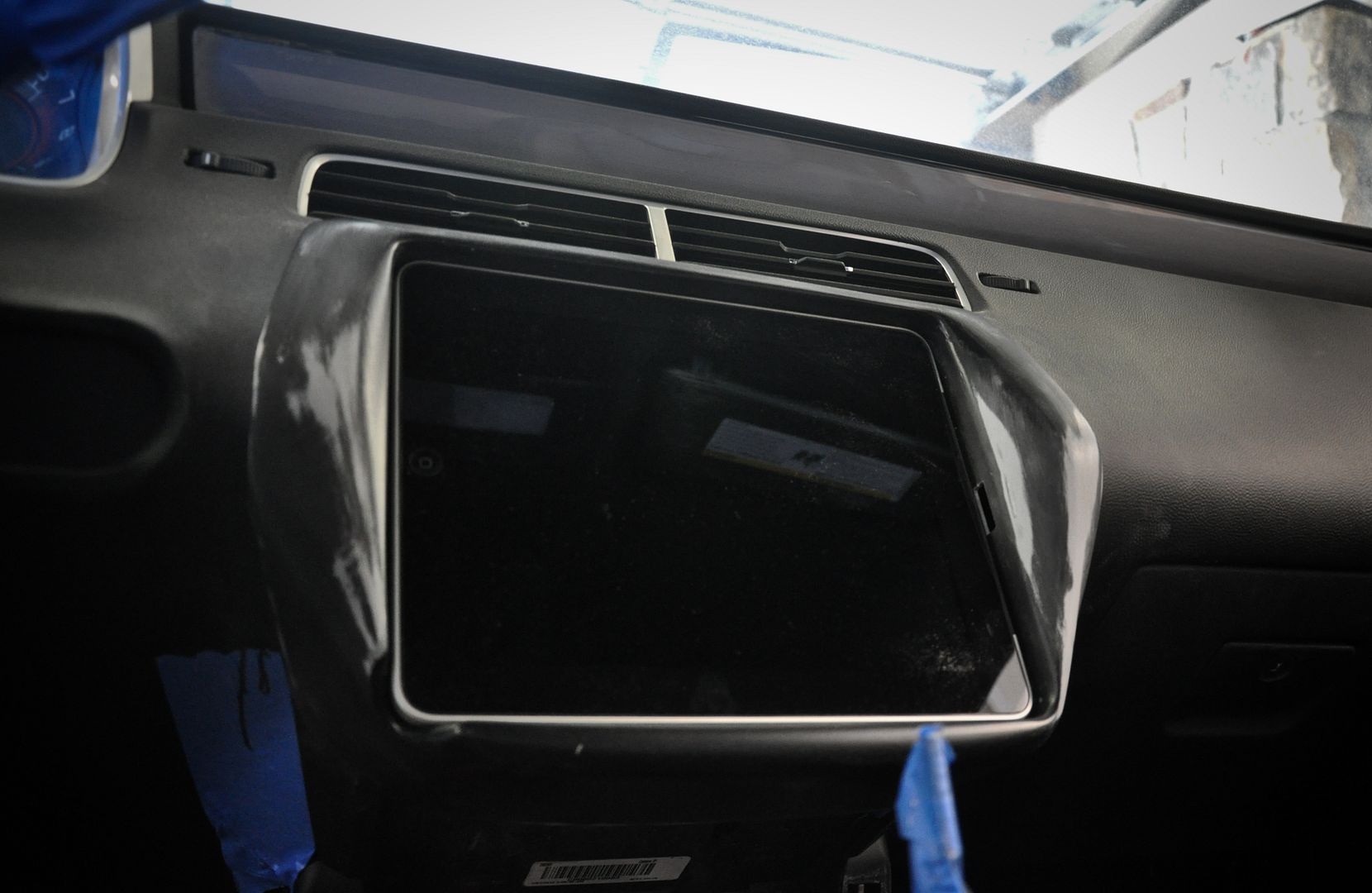

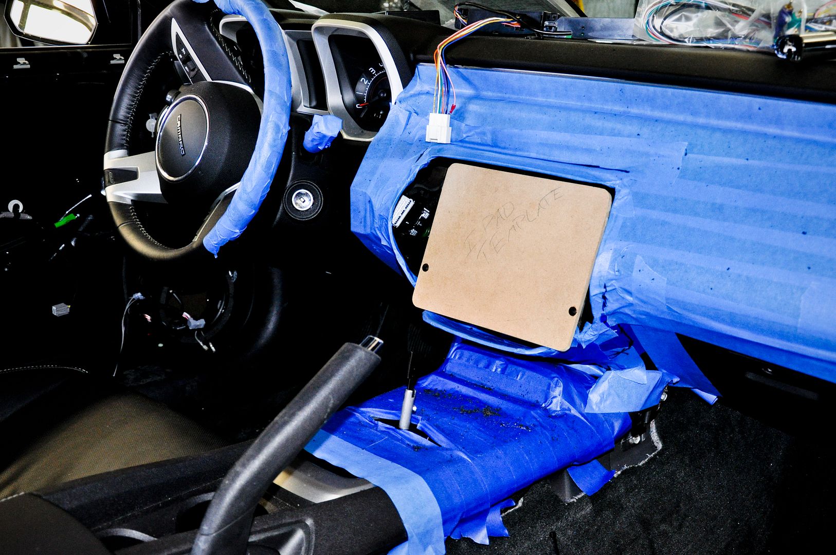

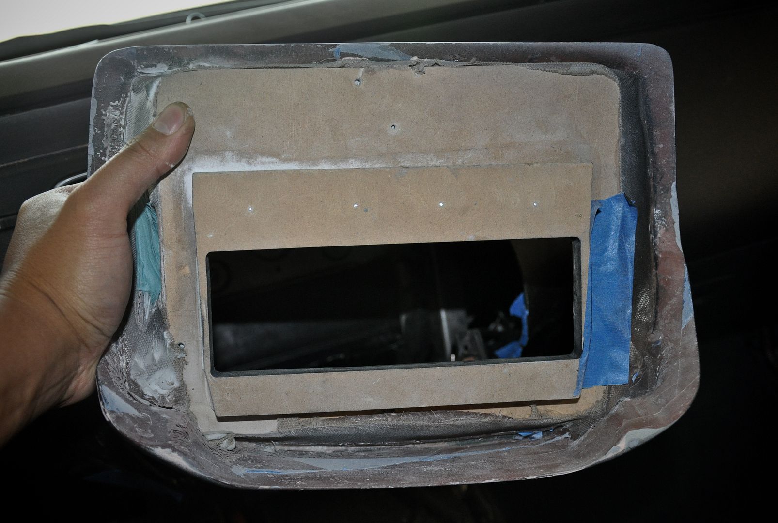

    and a quick spy shot of the routered frame for the radio and Ipad getting fiberglassed into the dash:

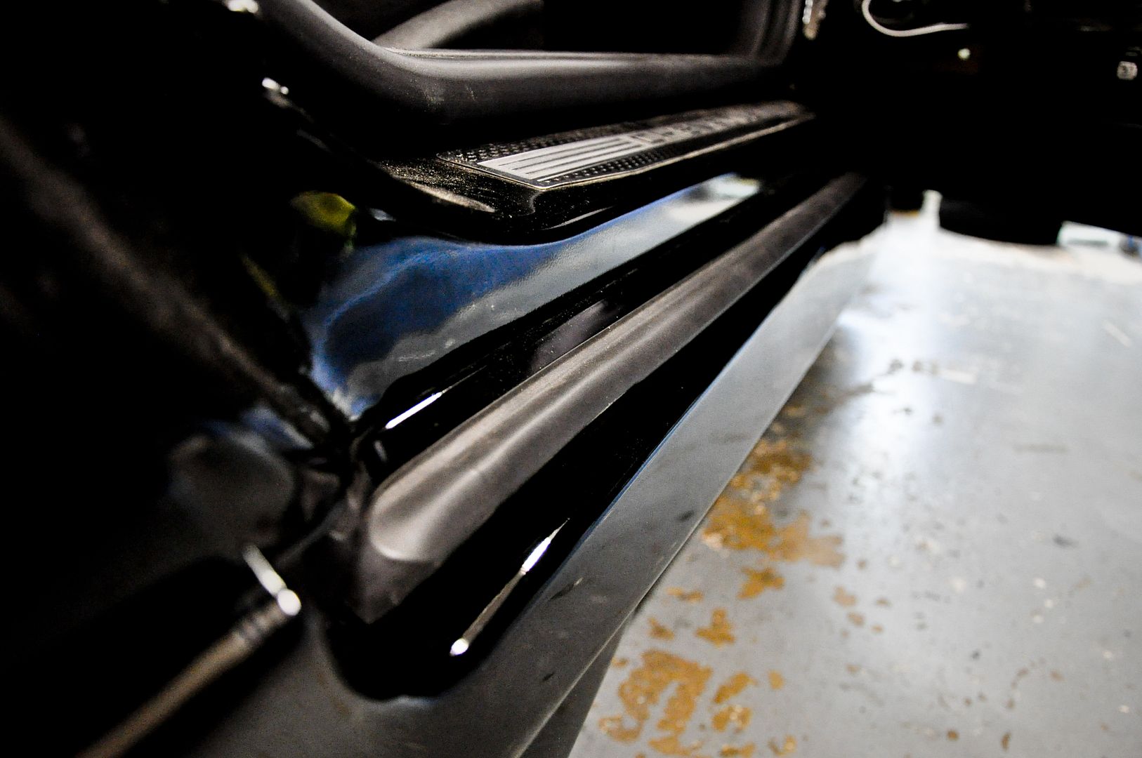

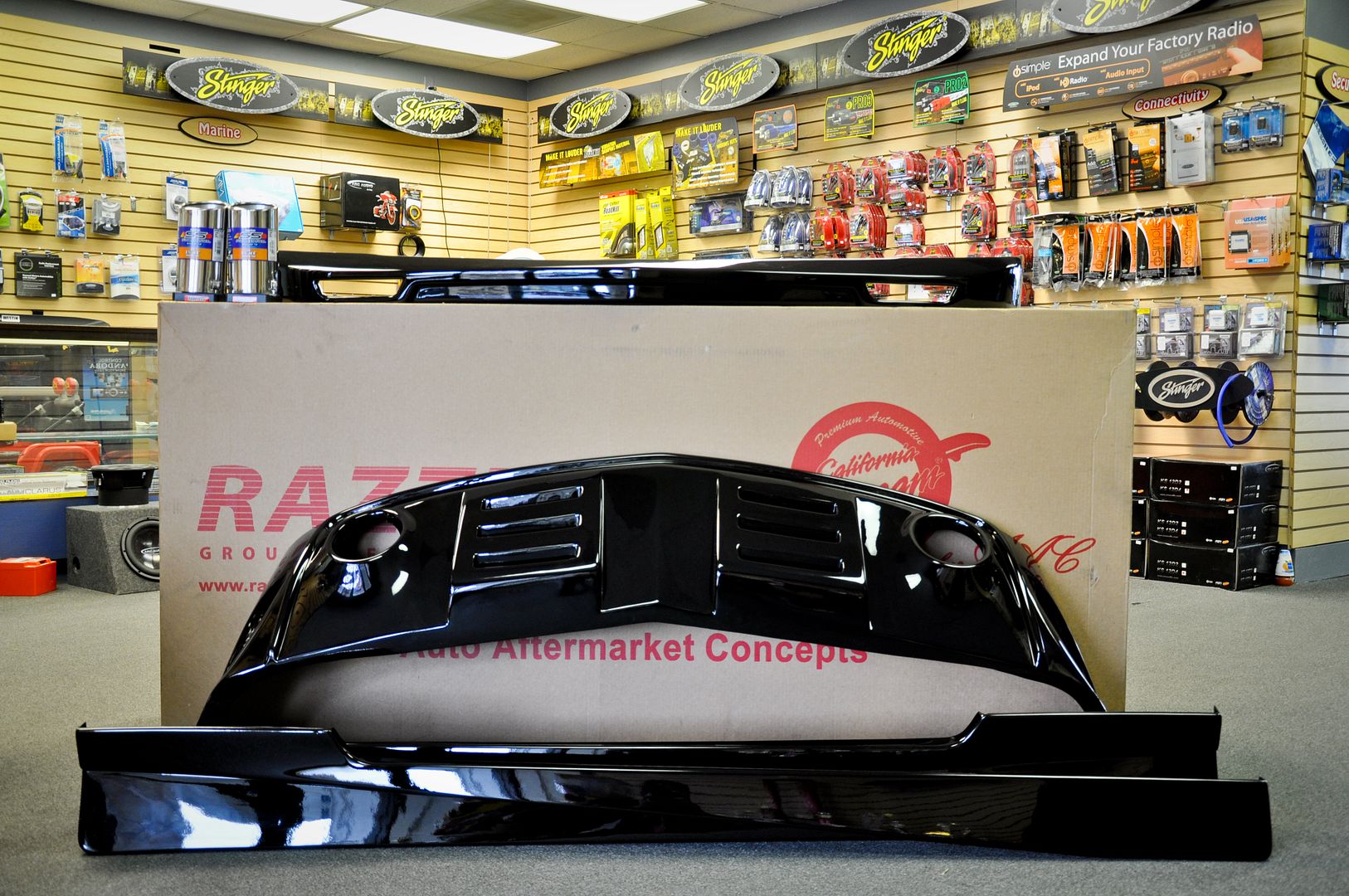

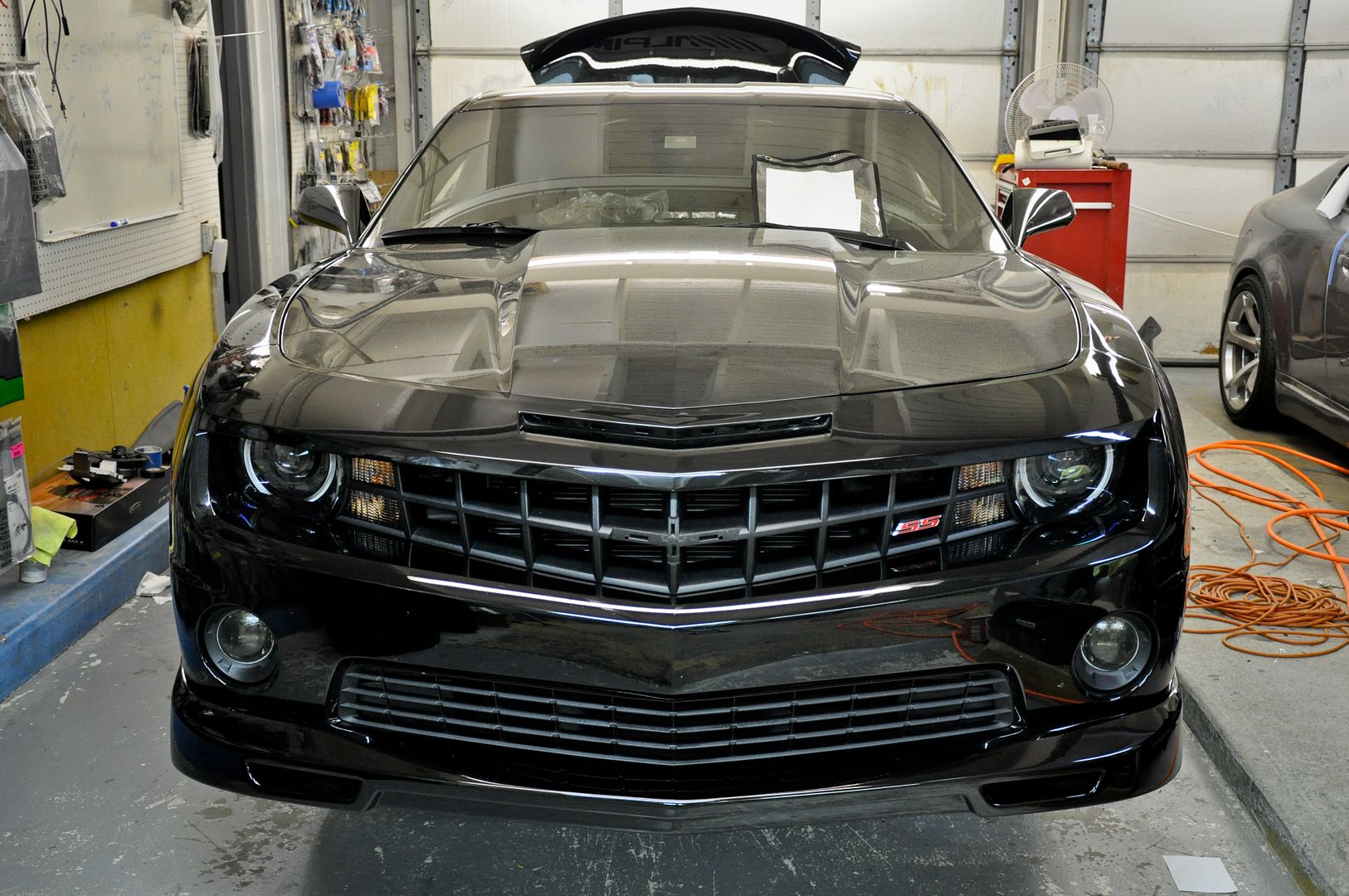

    Body kit work:

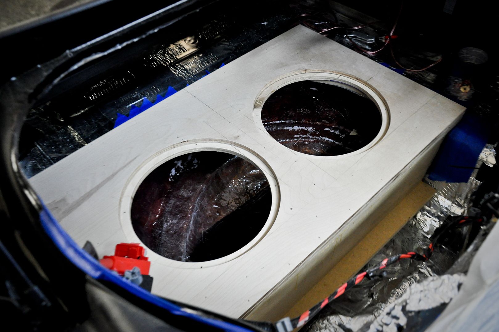

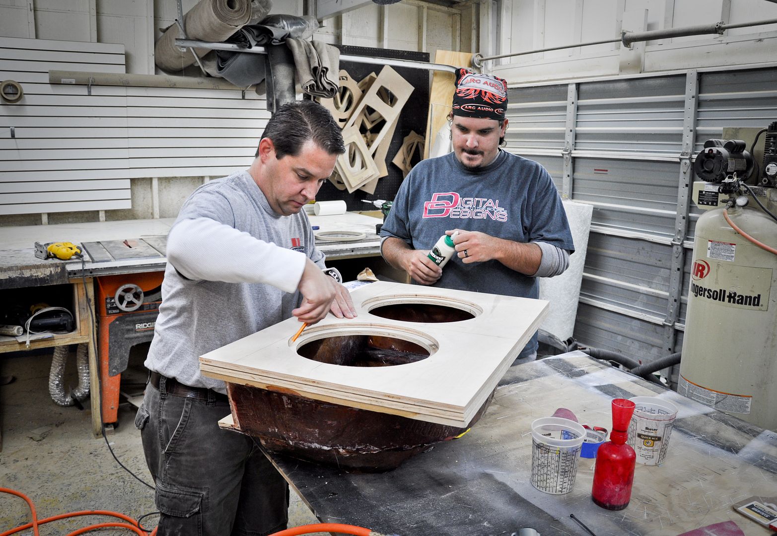

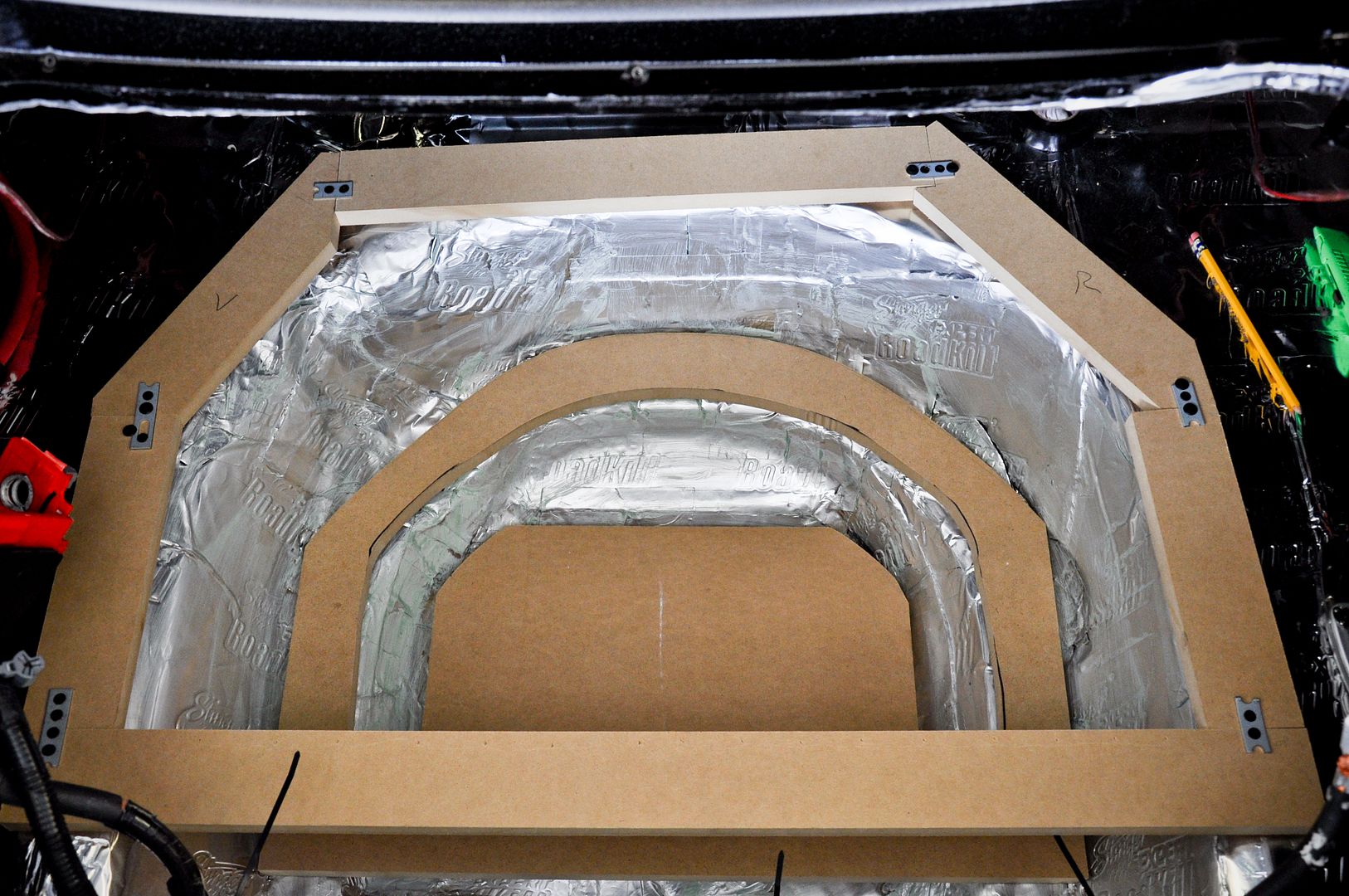

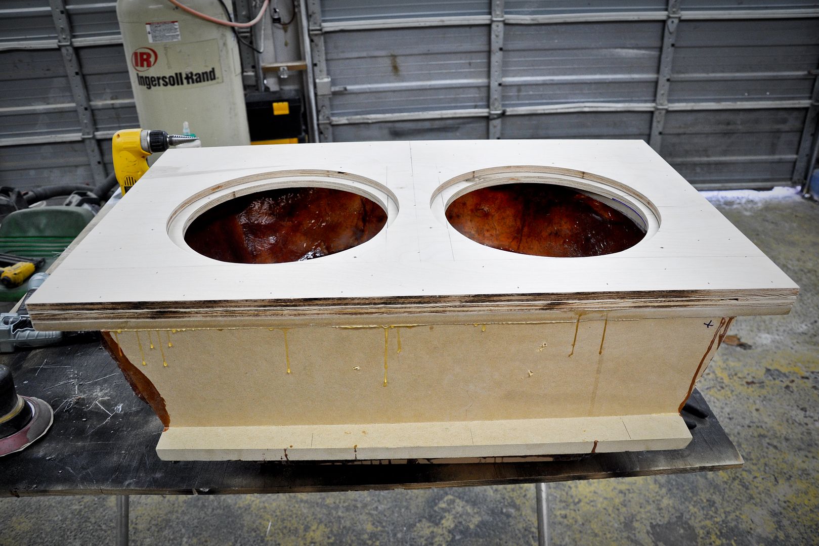

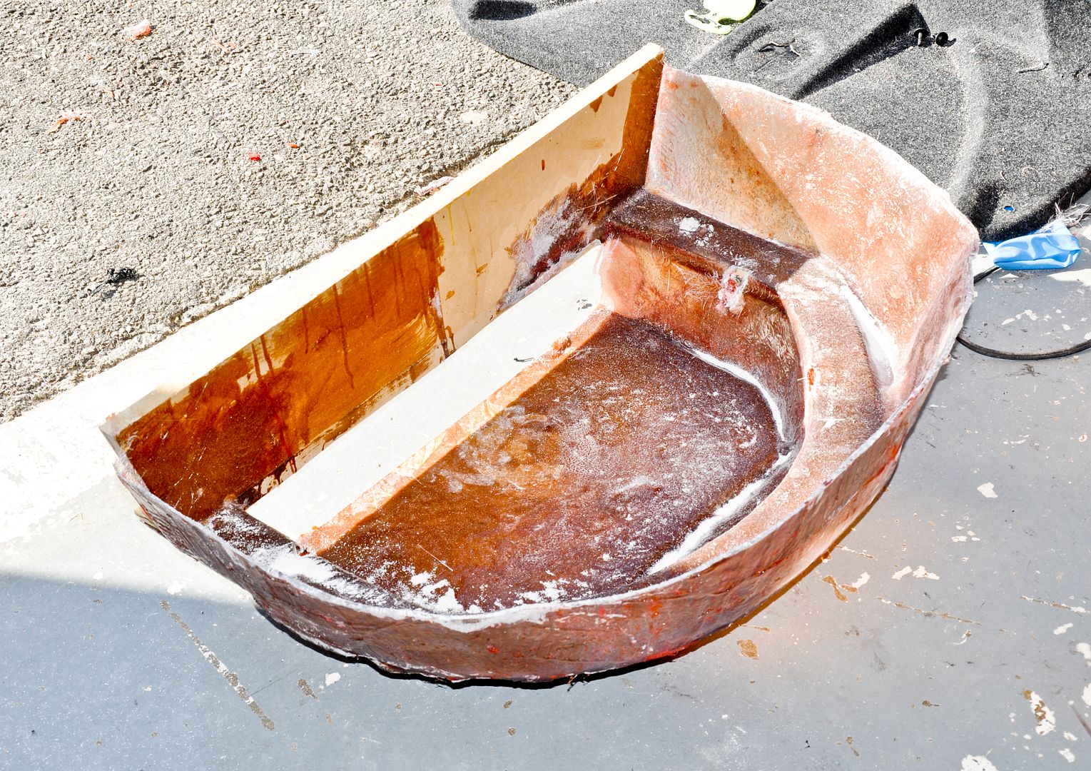

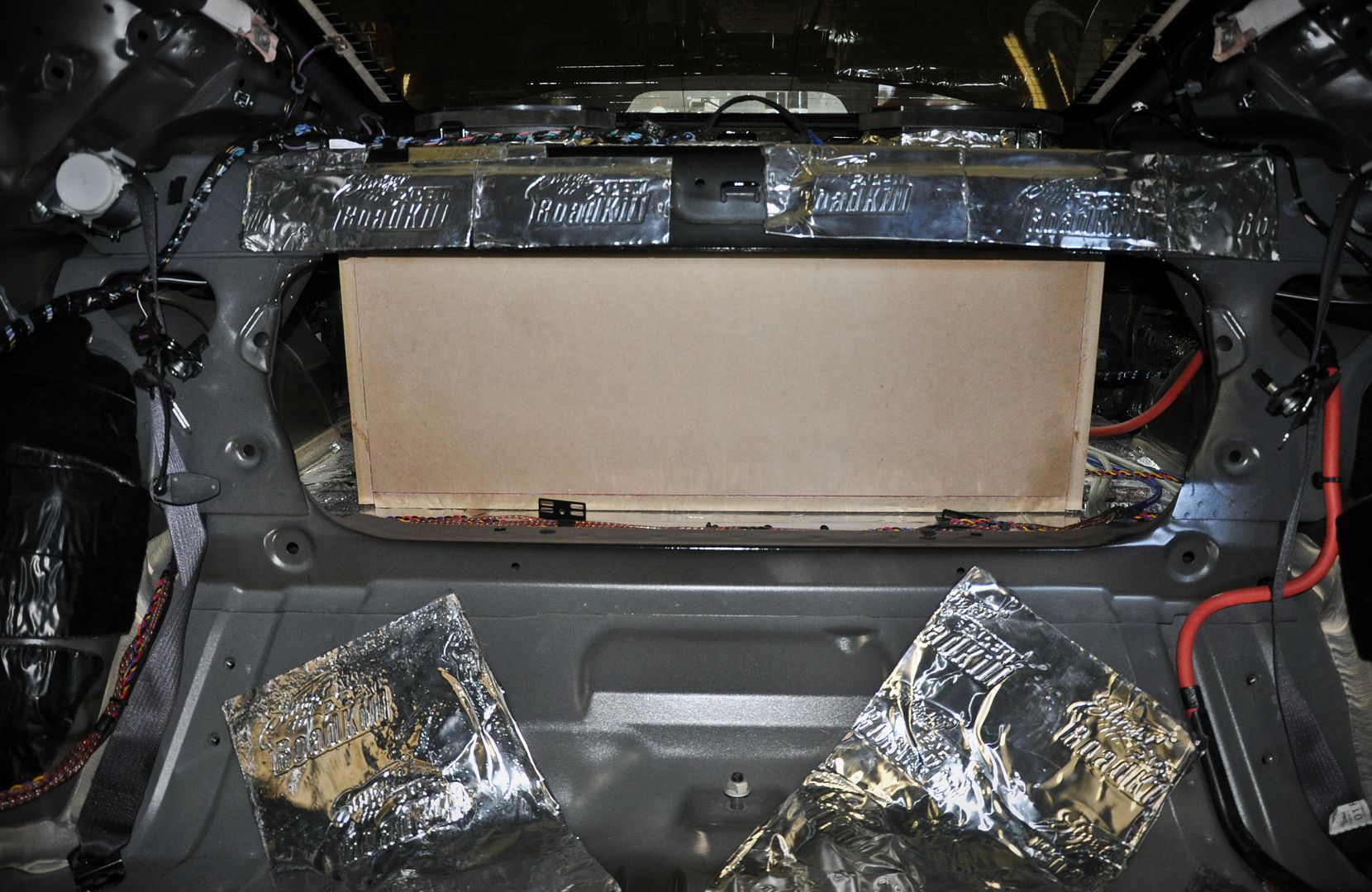

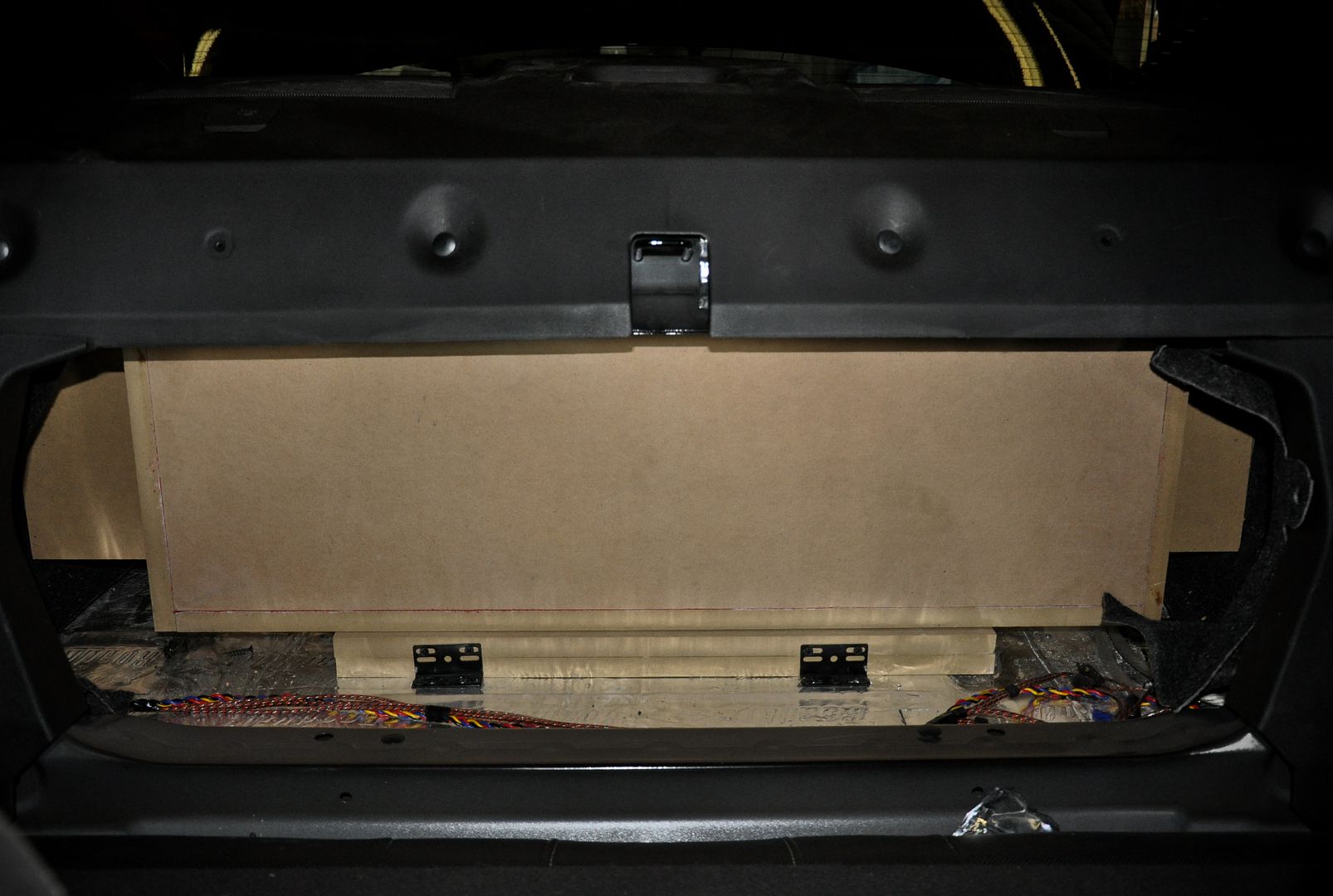

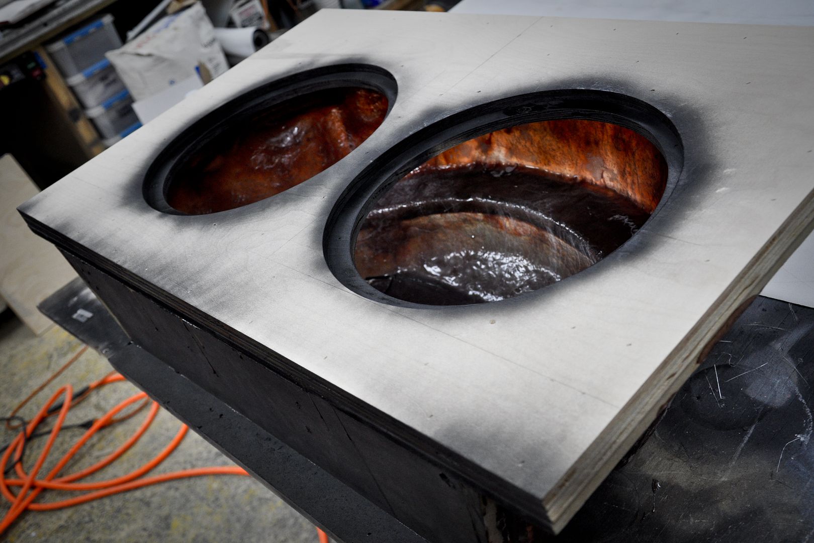

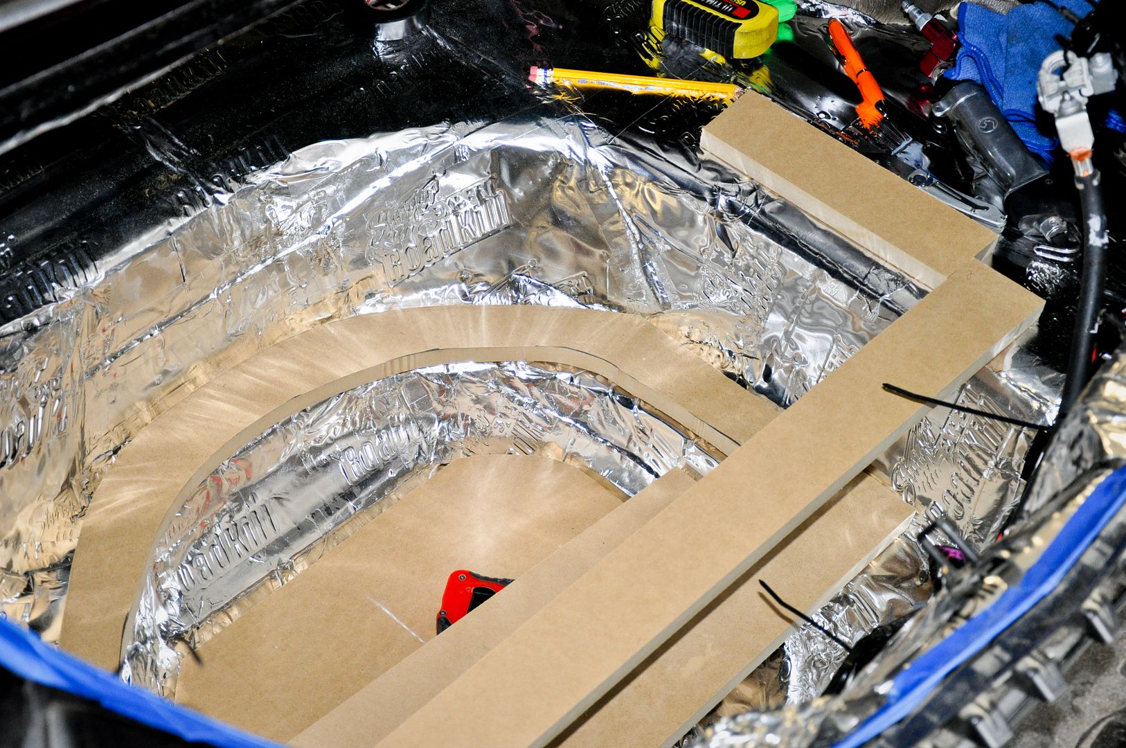

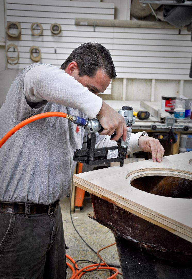

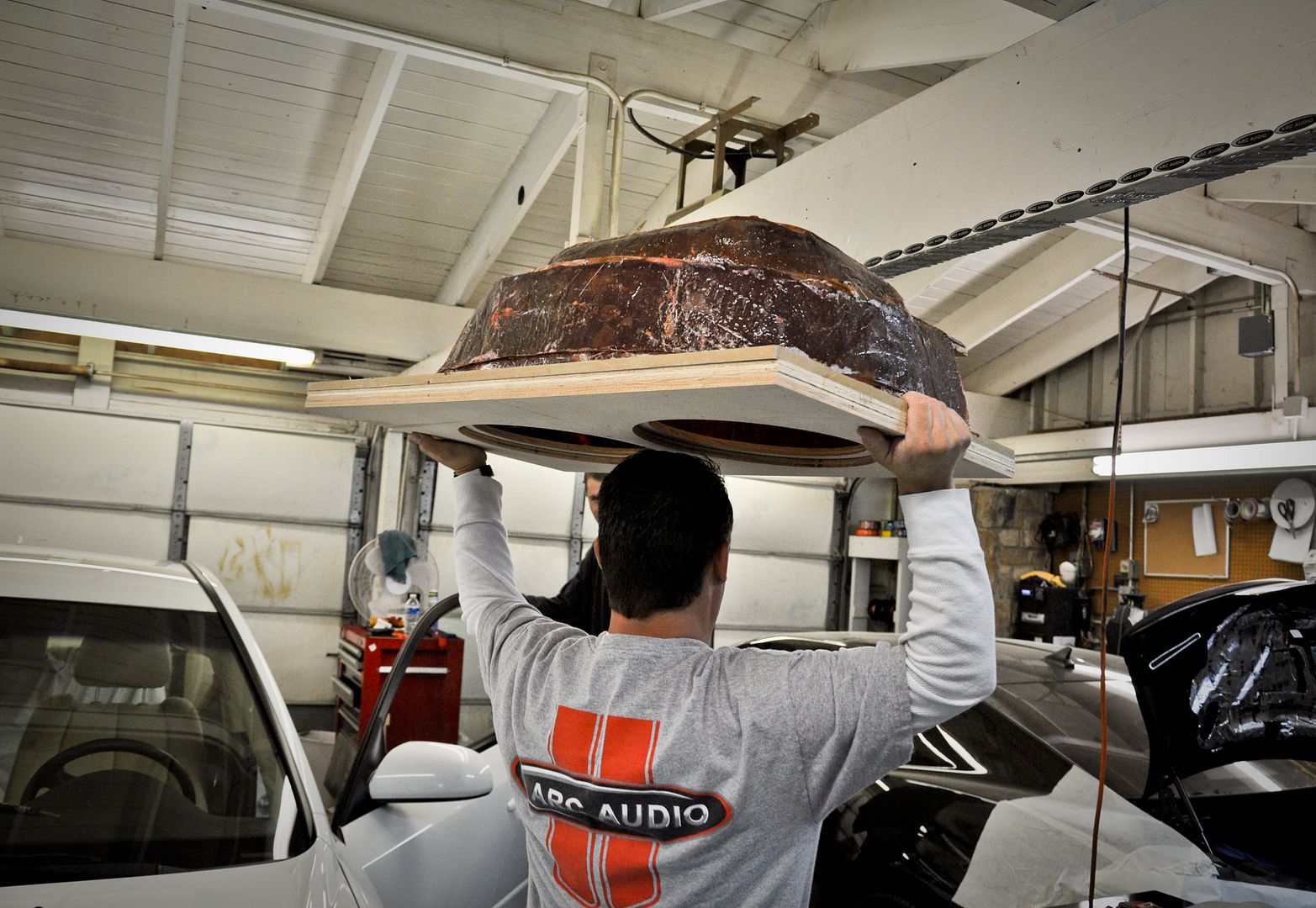

    Trunk work:
    Mind that the top lip was merely a handle to be able to pull it out and not part of the actual enclosure:

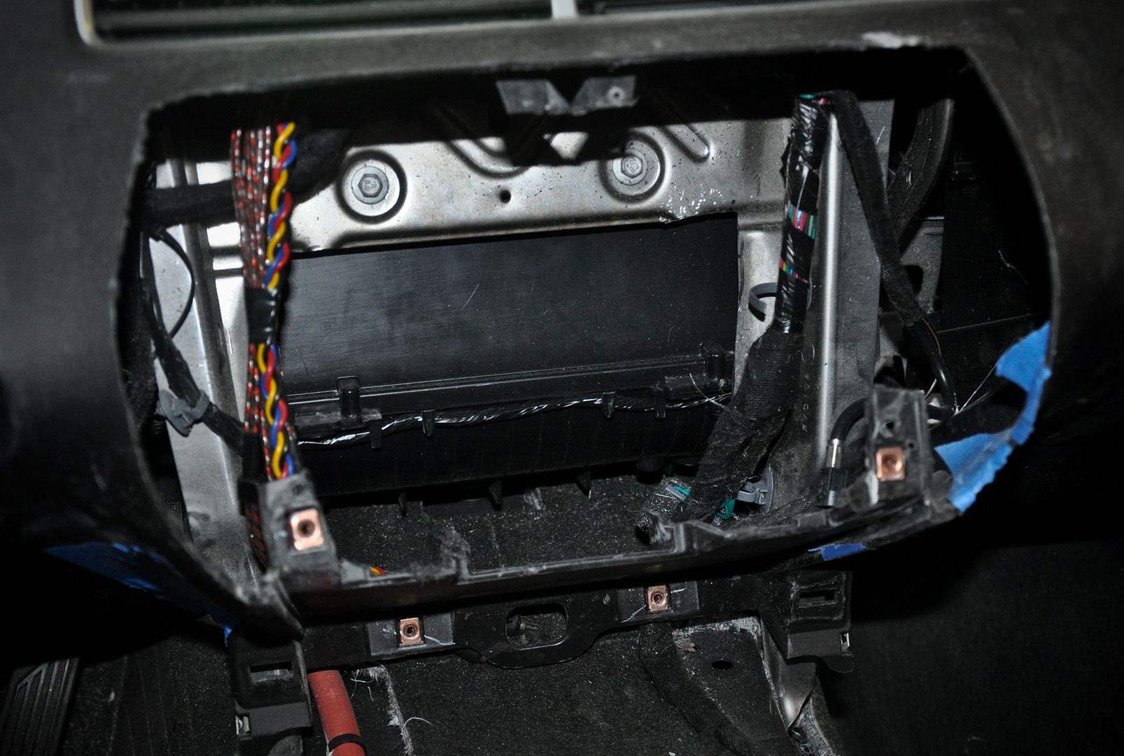

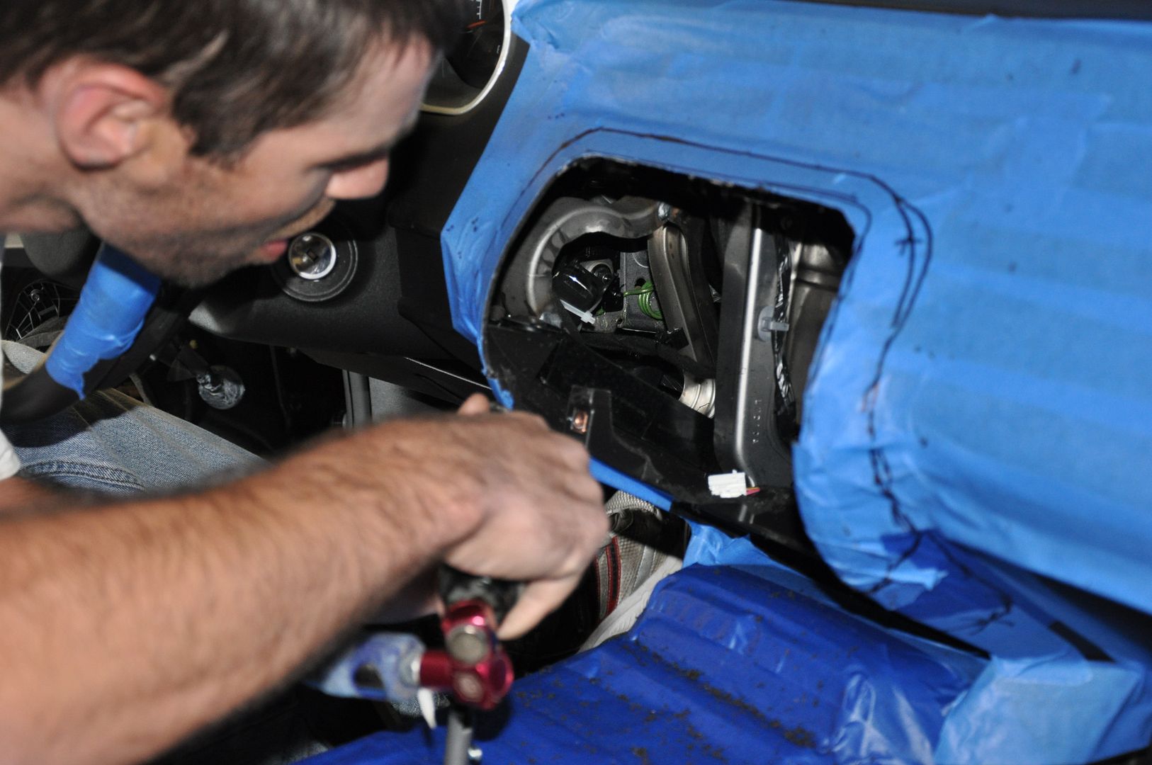

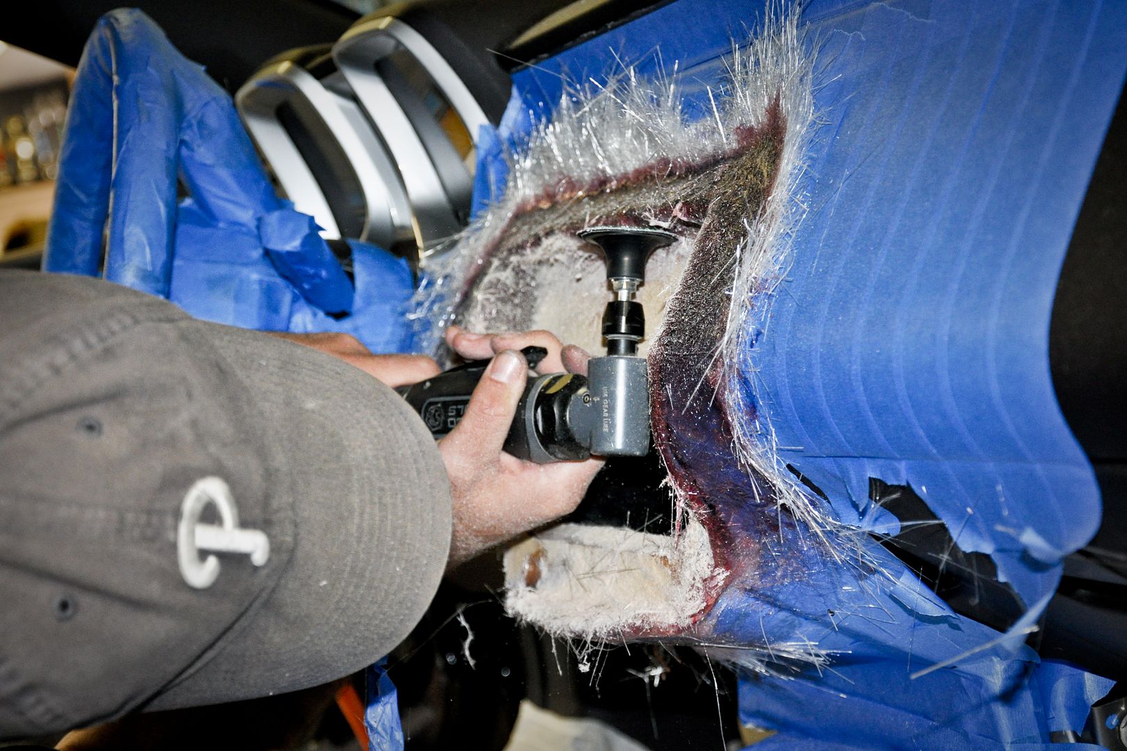

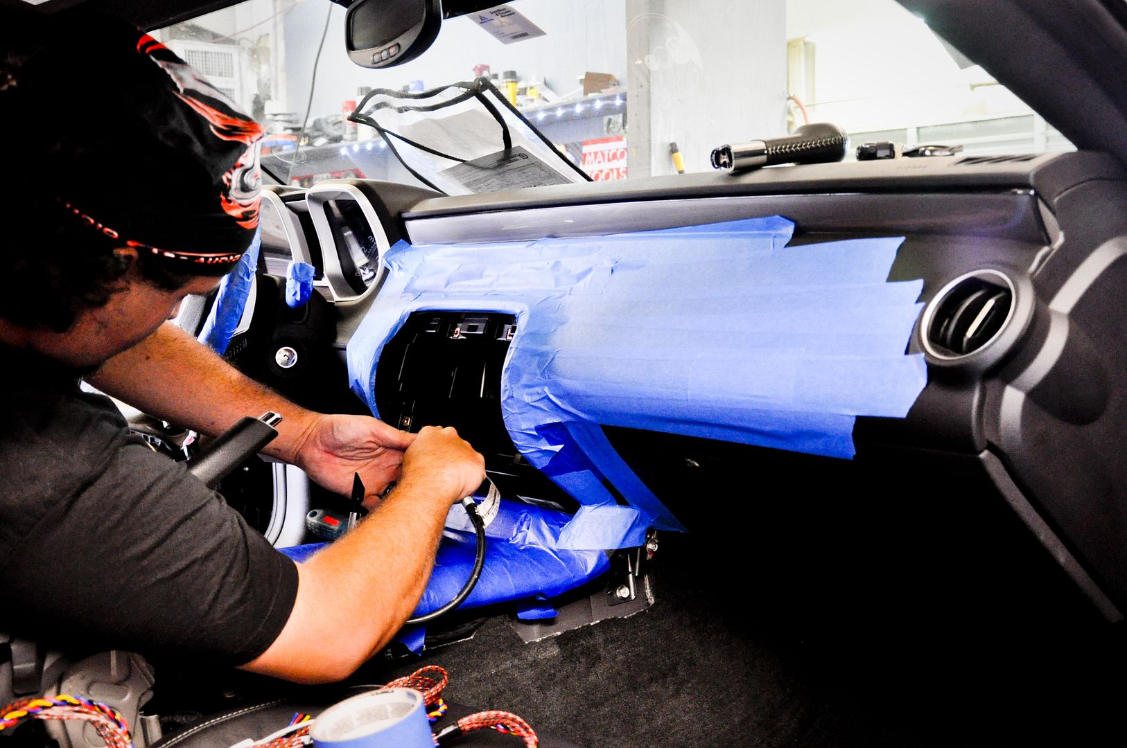

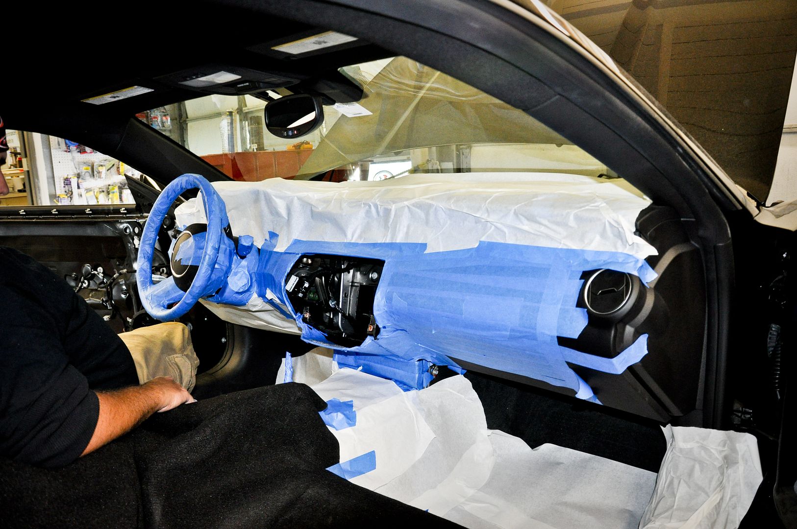

    prepping the stock dash:
    No turning back now:
    yup that's better:

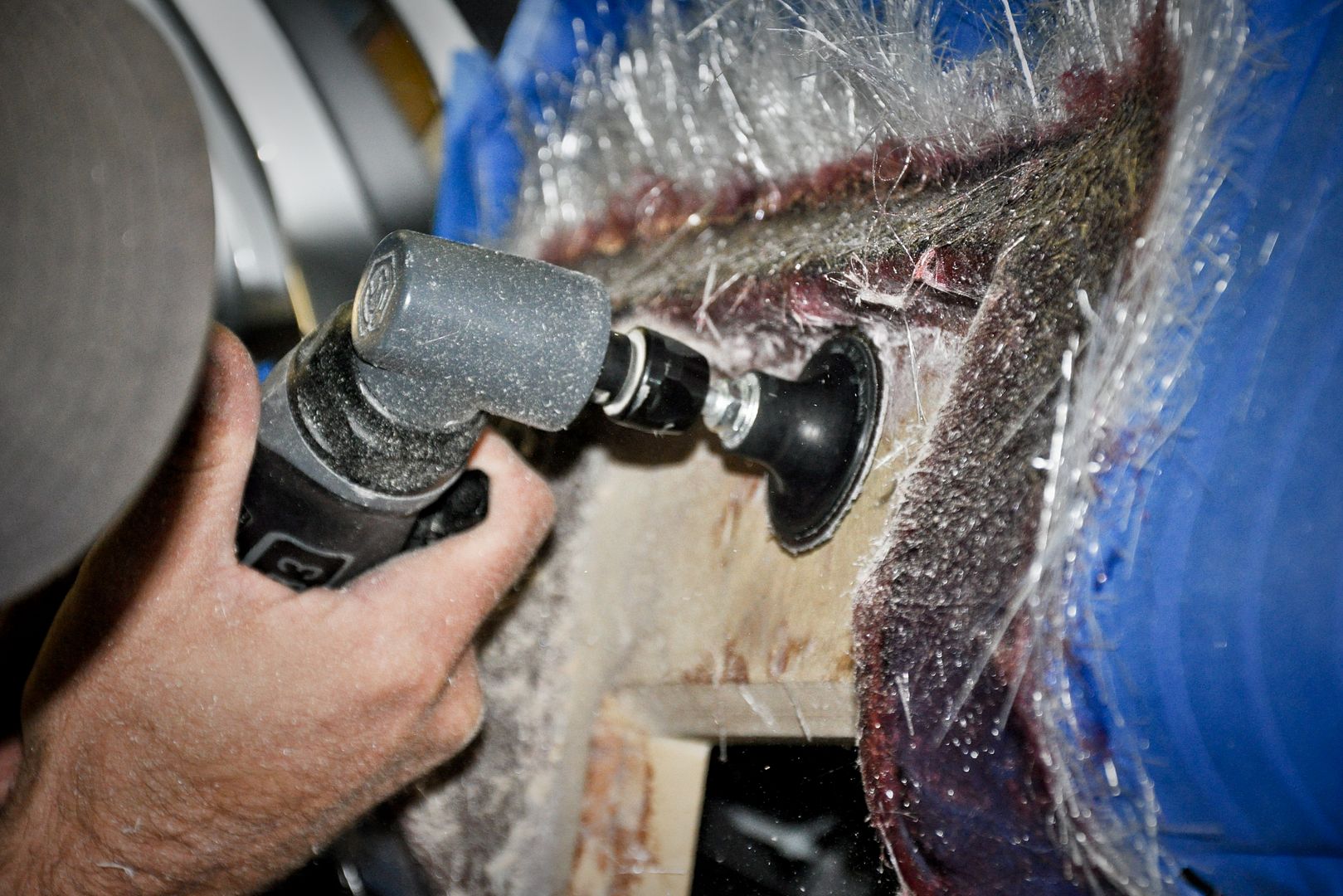

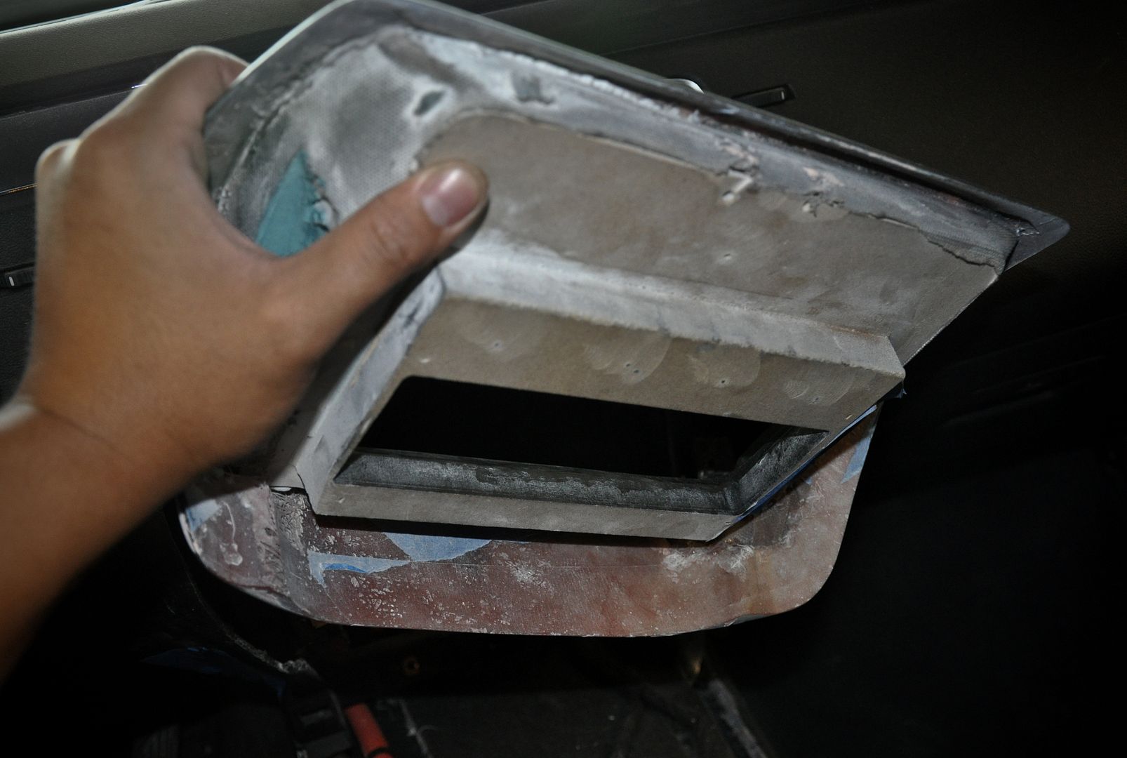

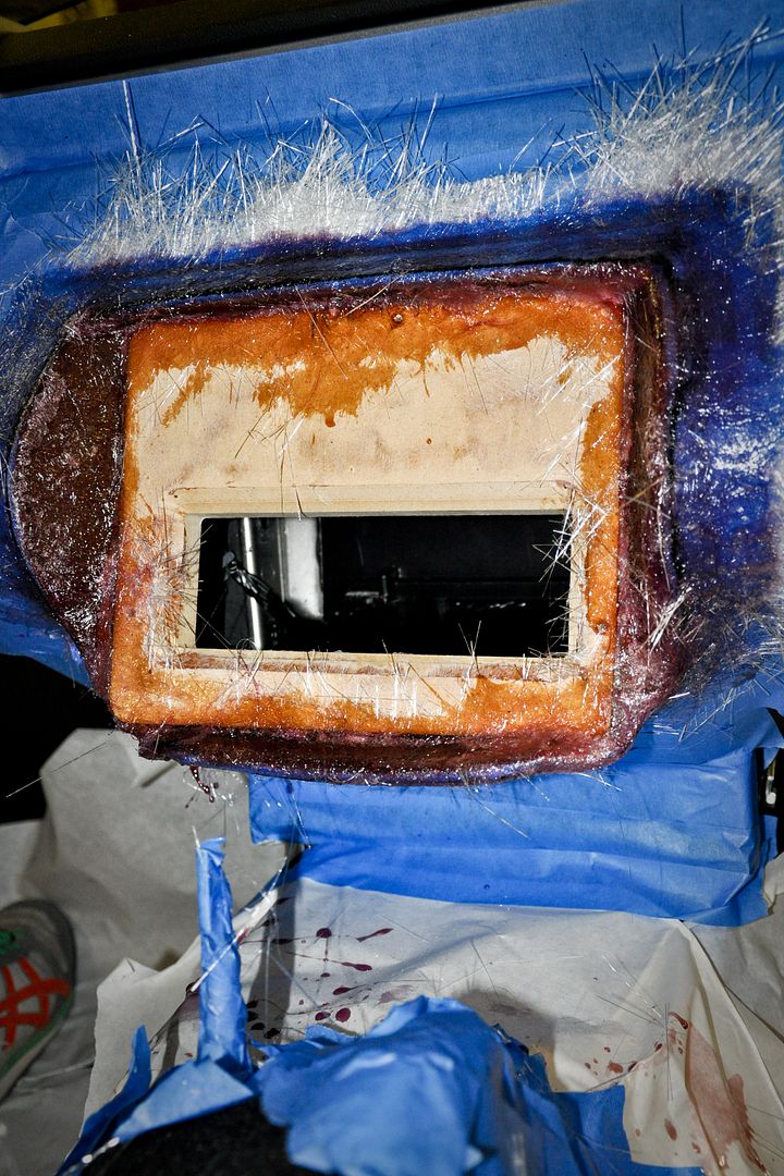

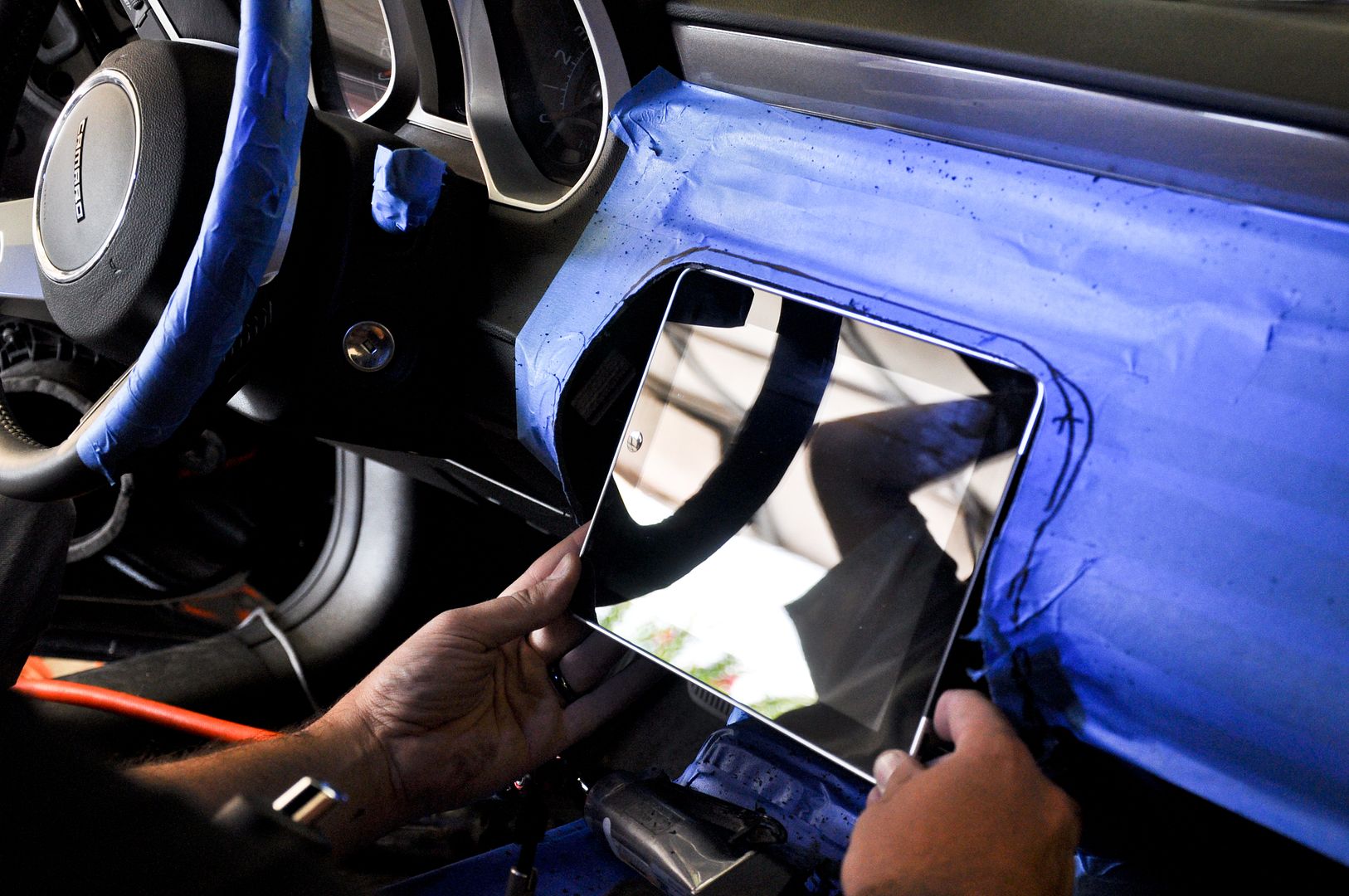

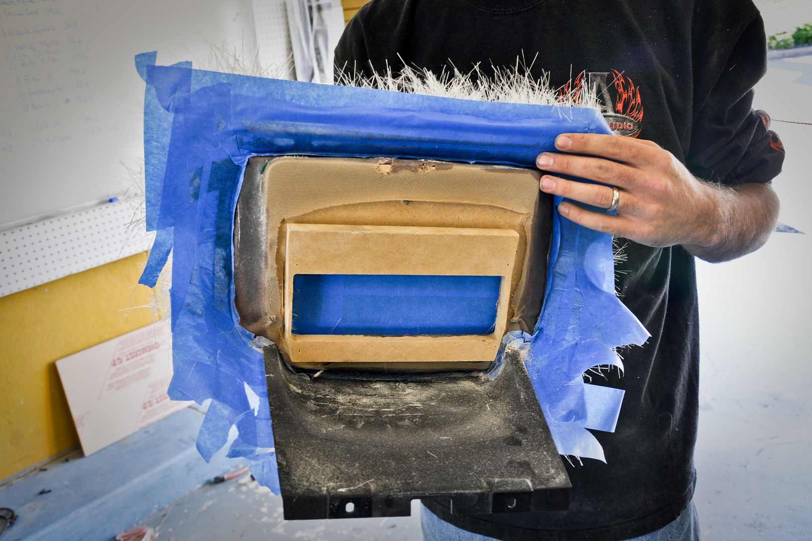

    creating the back of the mount for the Ipad:
    prepping the back plate for the flush mount openning for the radio:

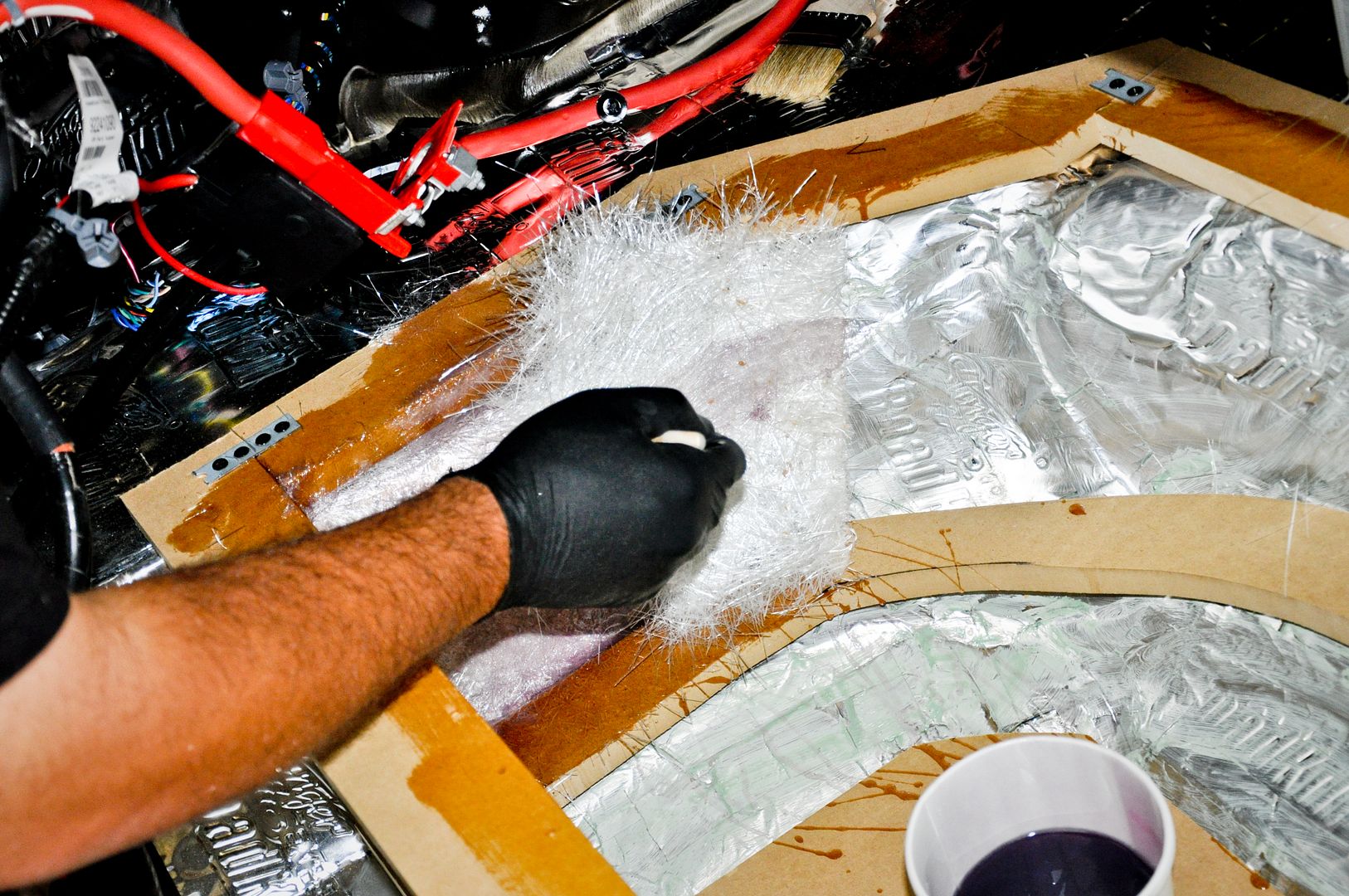

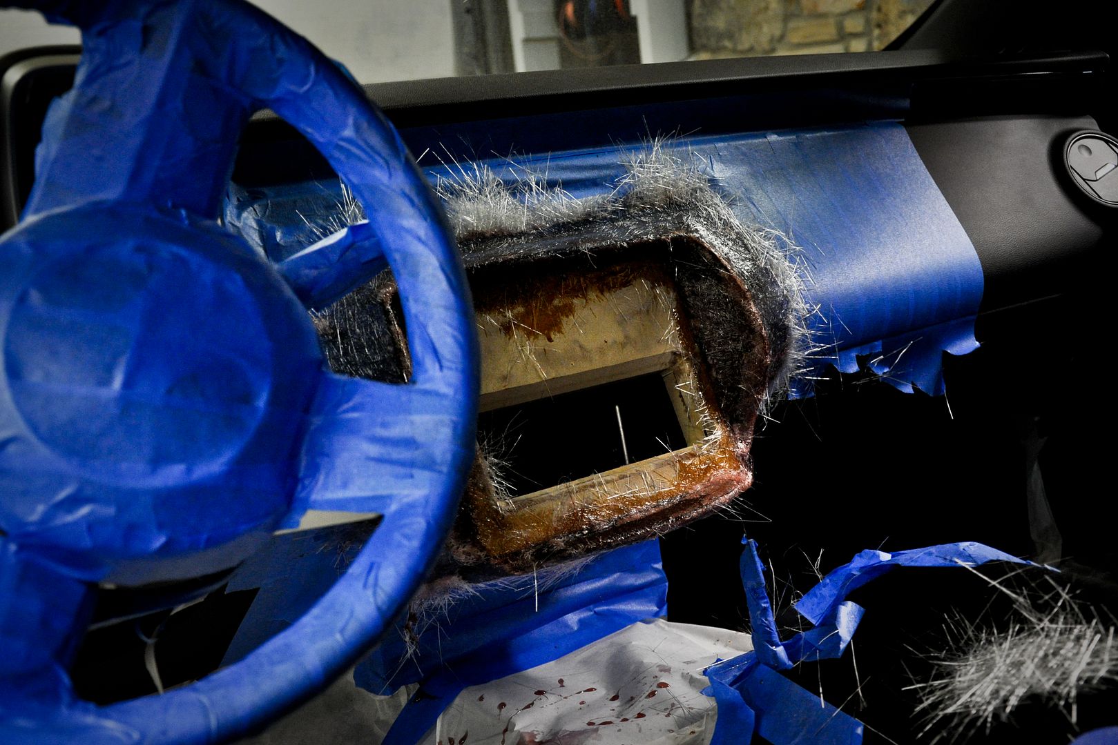

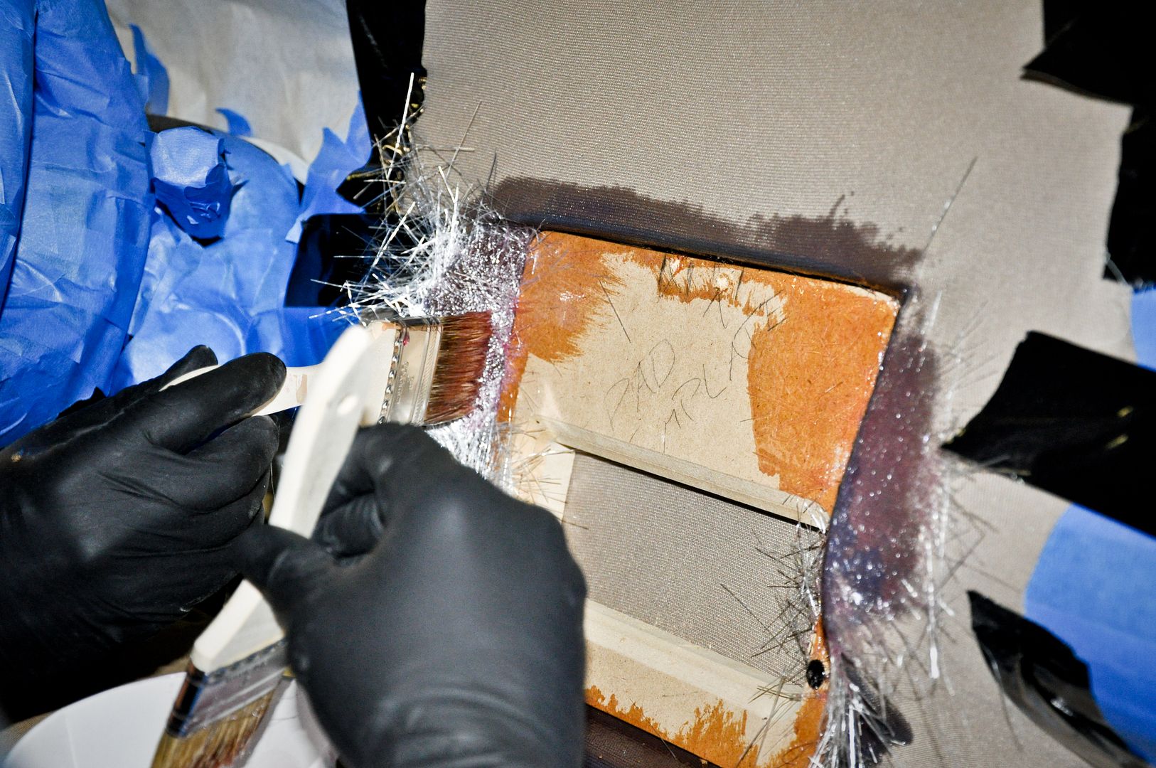

    Dash prepped for the first round of glass:

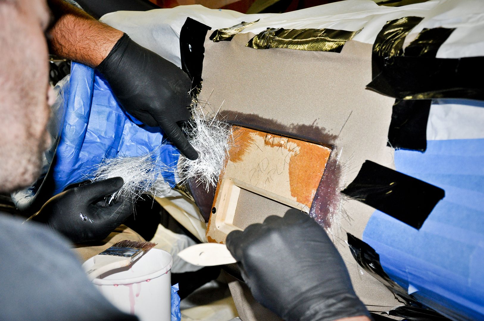

    And let the fun begin:

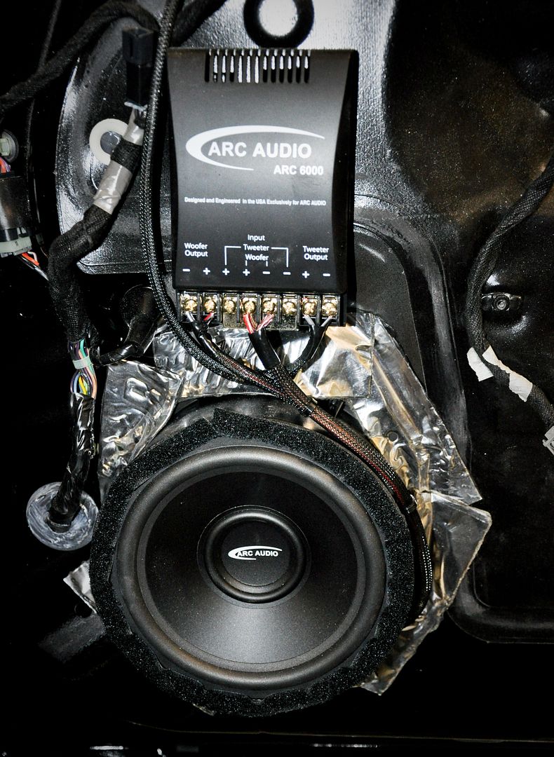

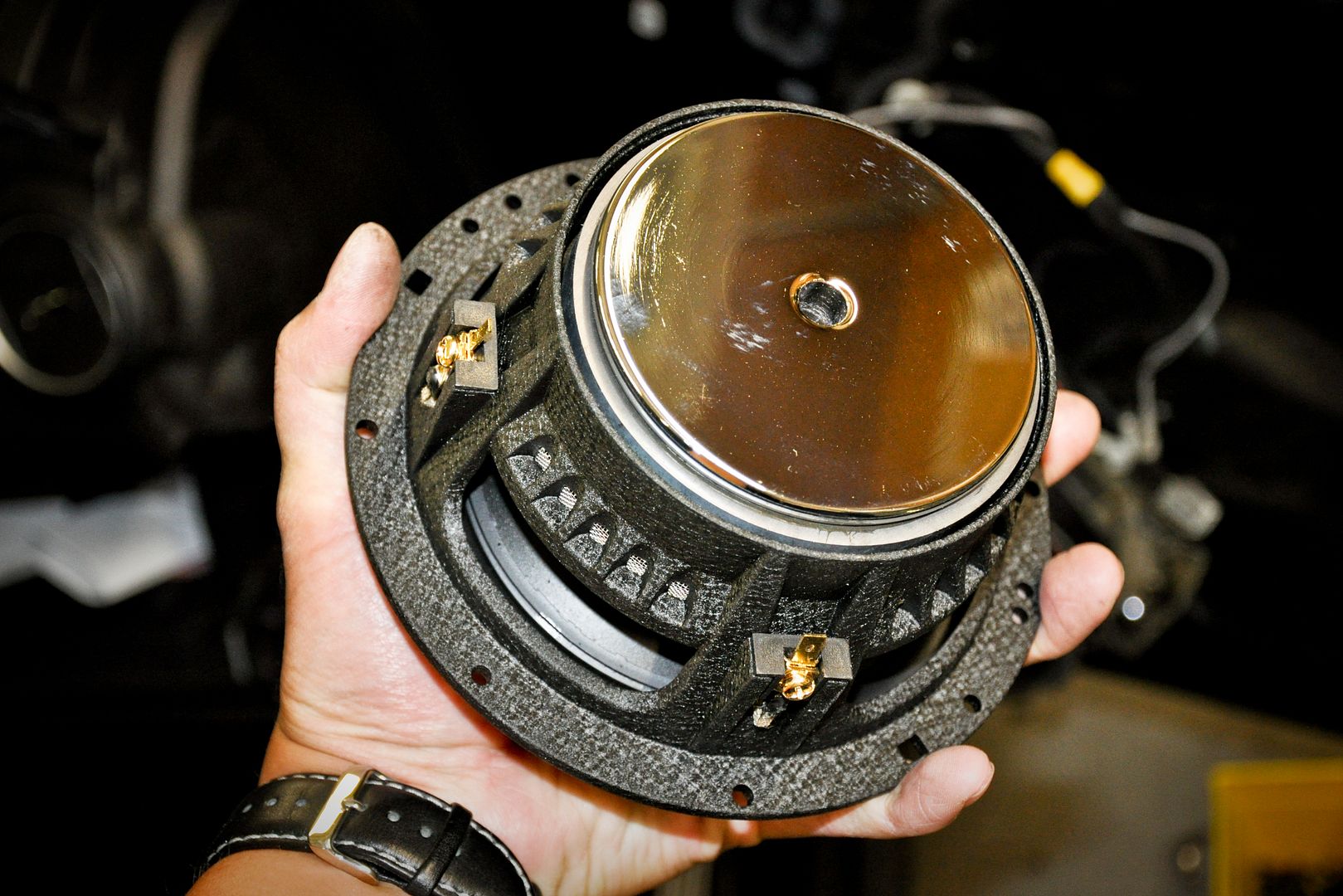

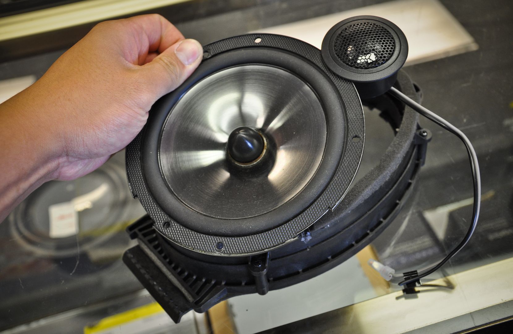

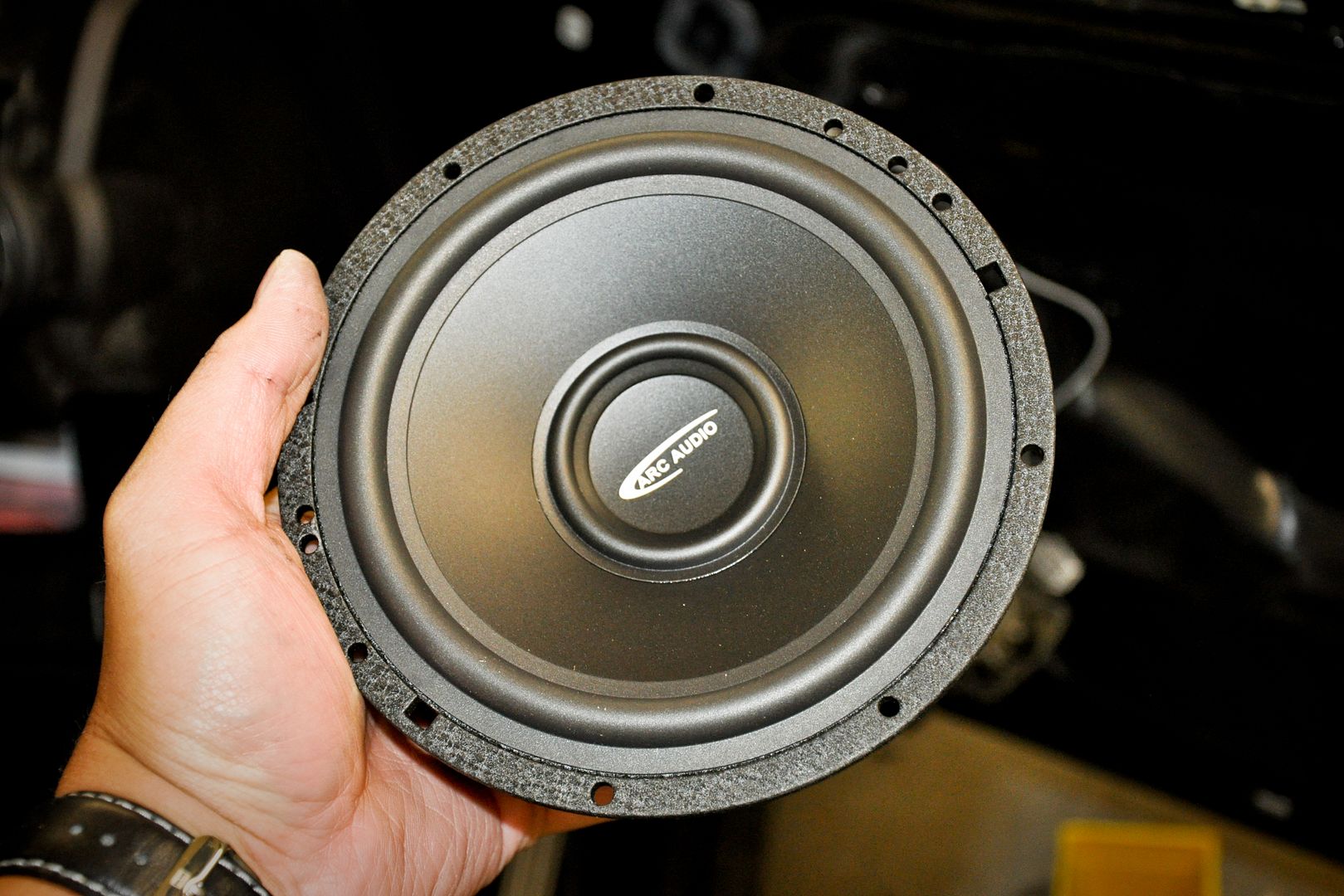

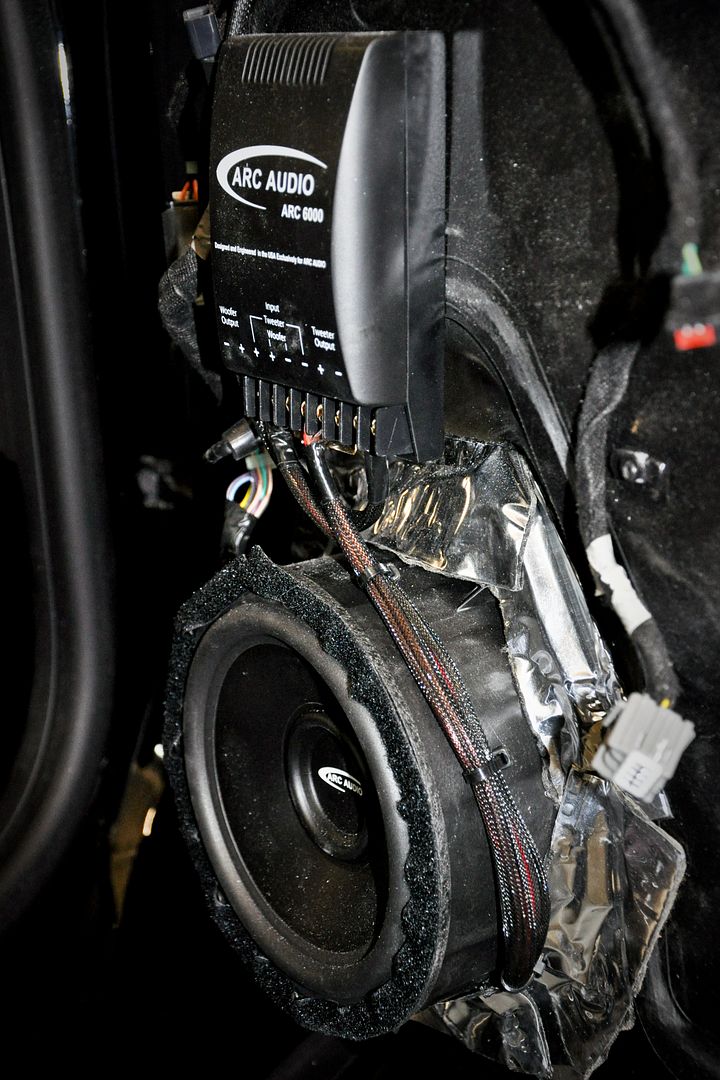

    ARC 6000's going in the front stage. Awesome component speakers.
    We sealed the baffle with some left over scraps of Stinger Expert Roadkill Sound Damping Material

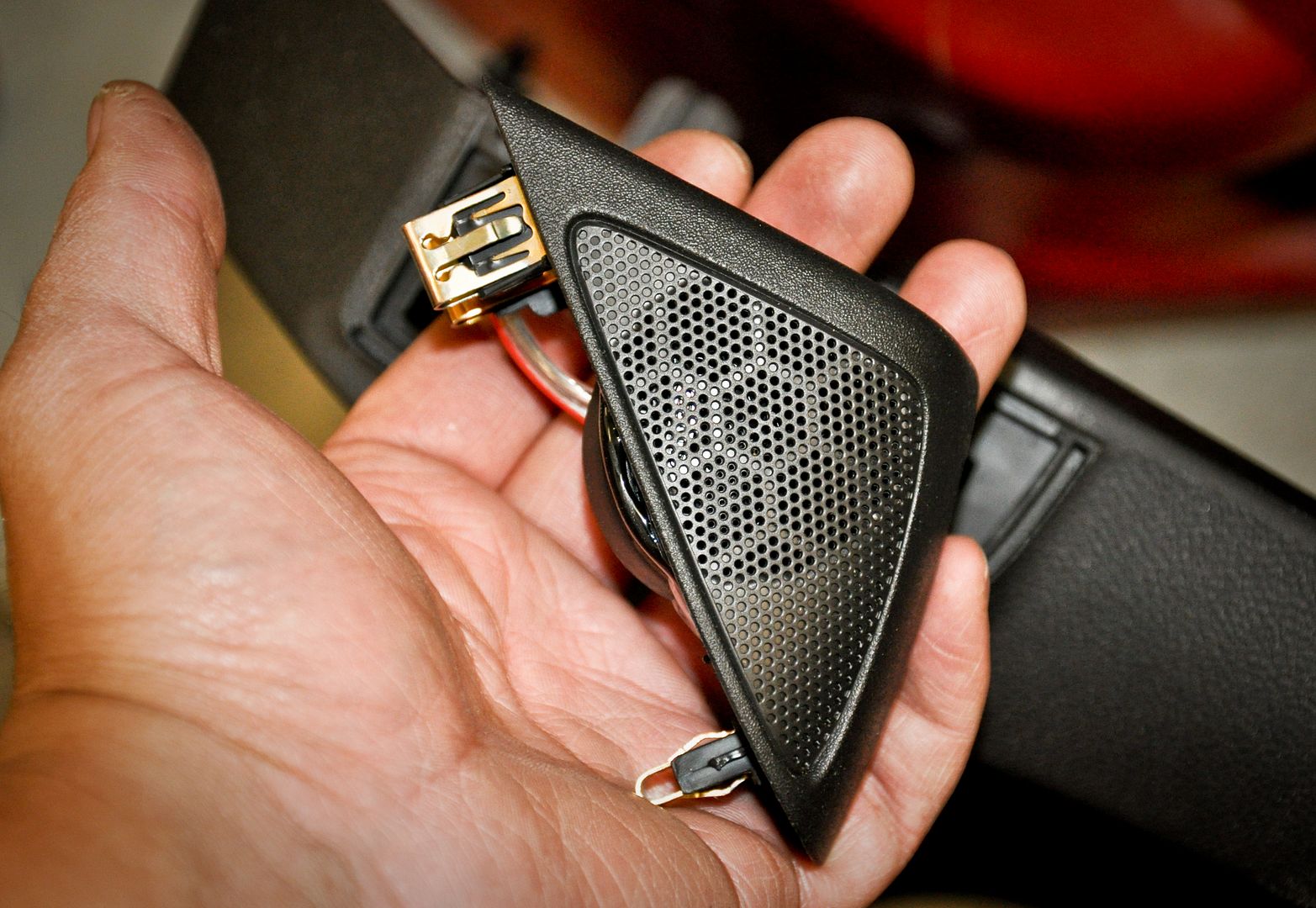

    All the wires were tech-flexed

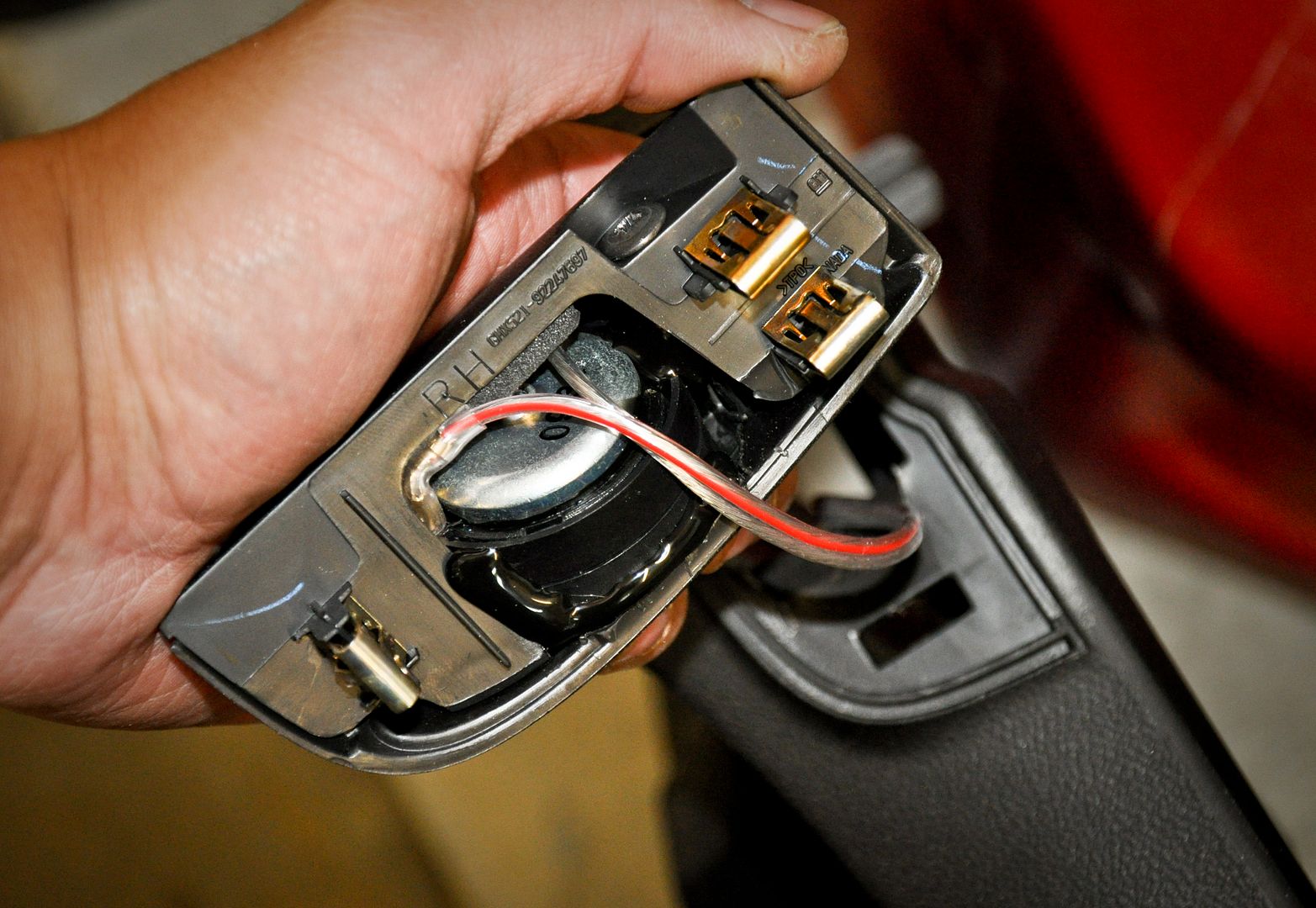

    Tweeters were mounted in the OEM pods

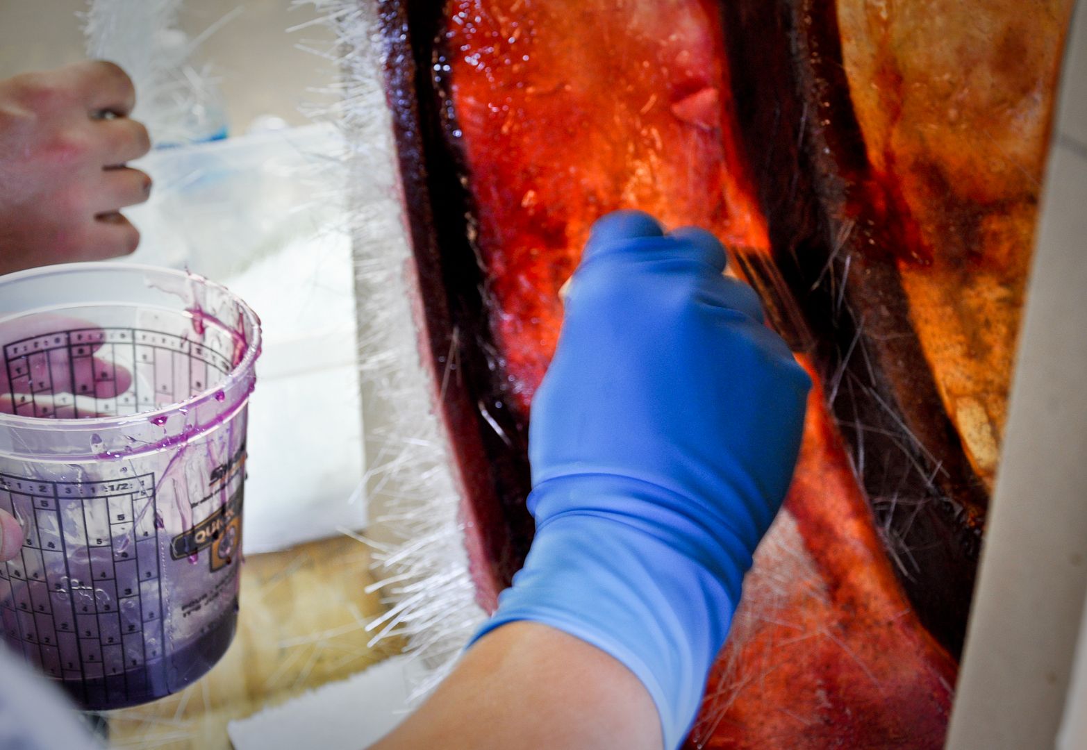

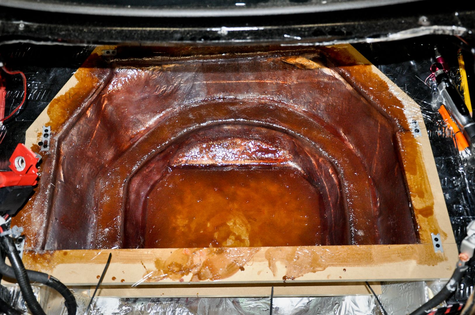

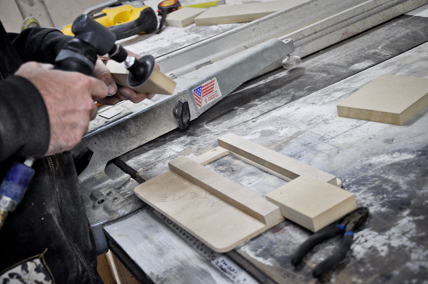

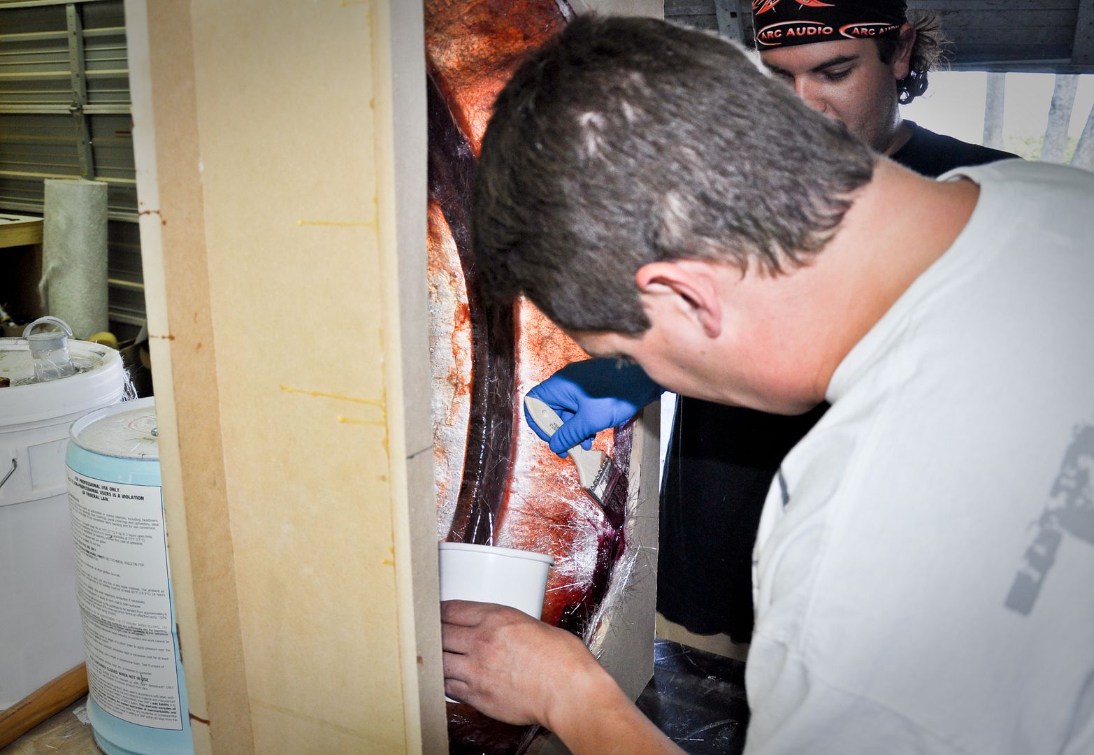

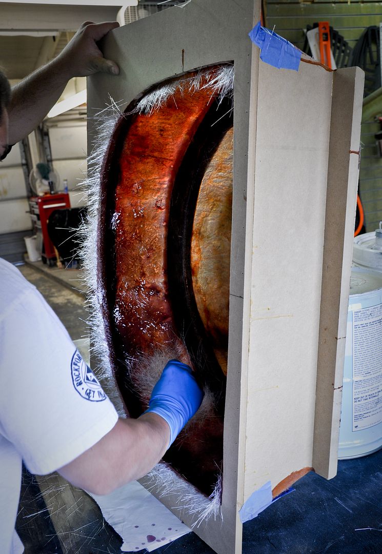

    Reinforcing the box with some more fiberglass and resin
    Fitting and trimming the baffle for the speaker to sit flush
    Final test fit time
    Box top was wrapped in black vinyl and custom battery mount was made

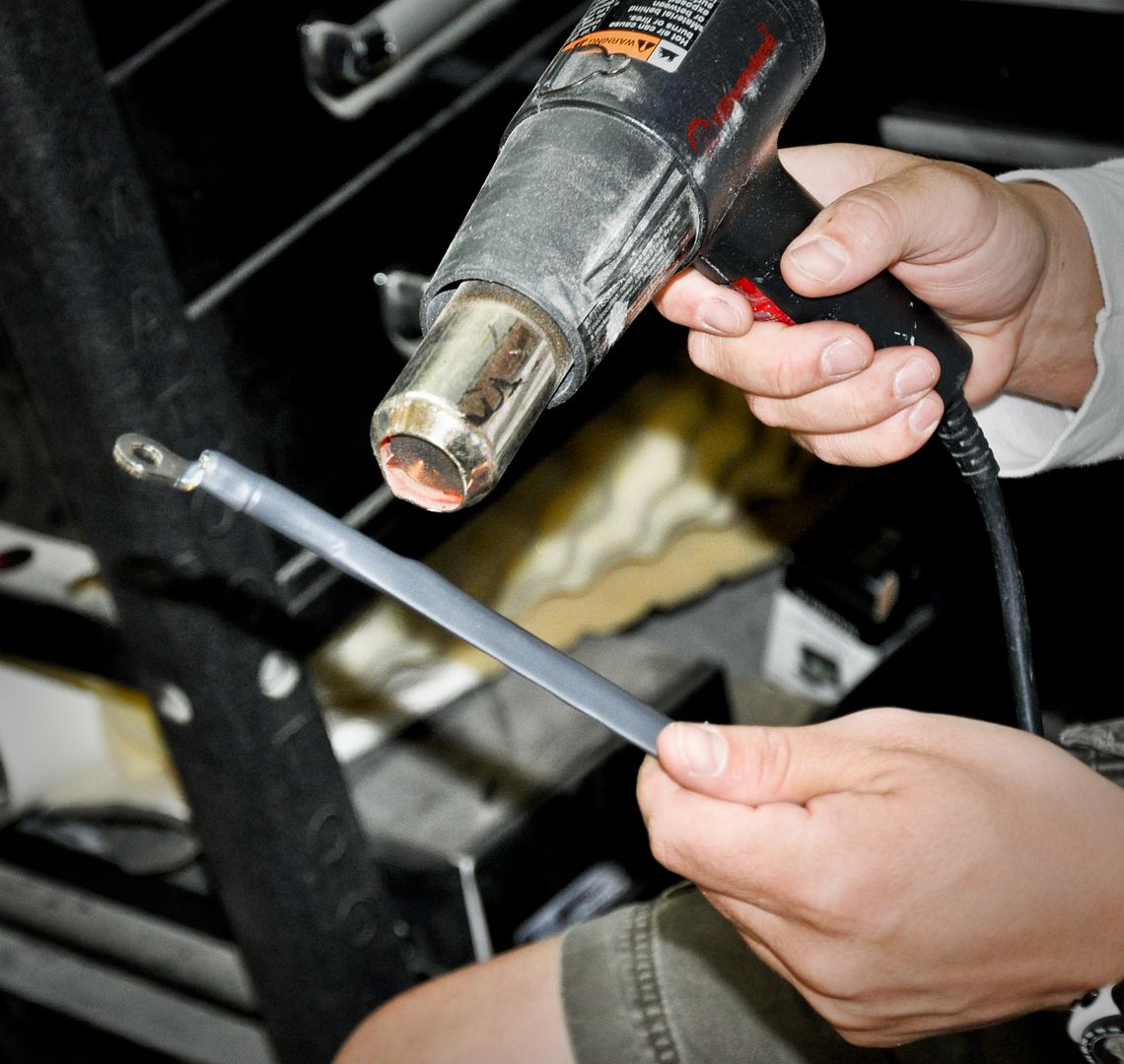

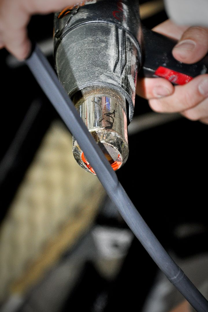

    Heat shrink wrapped all the wires

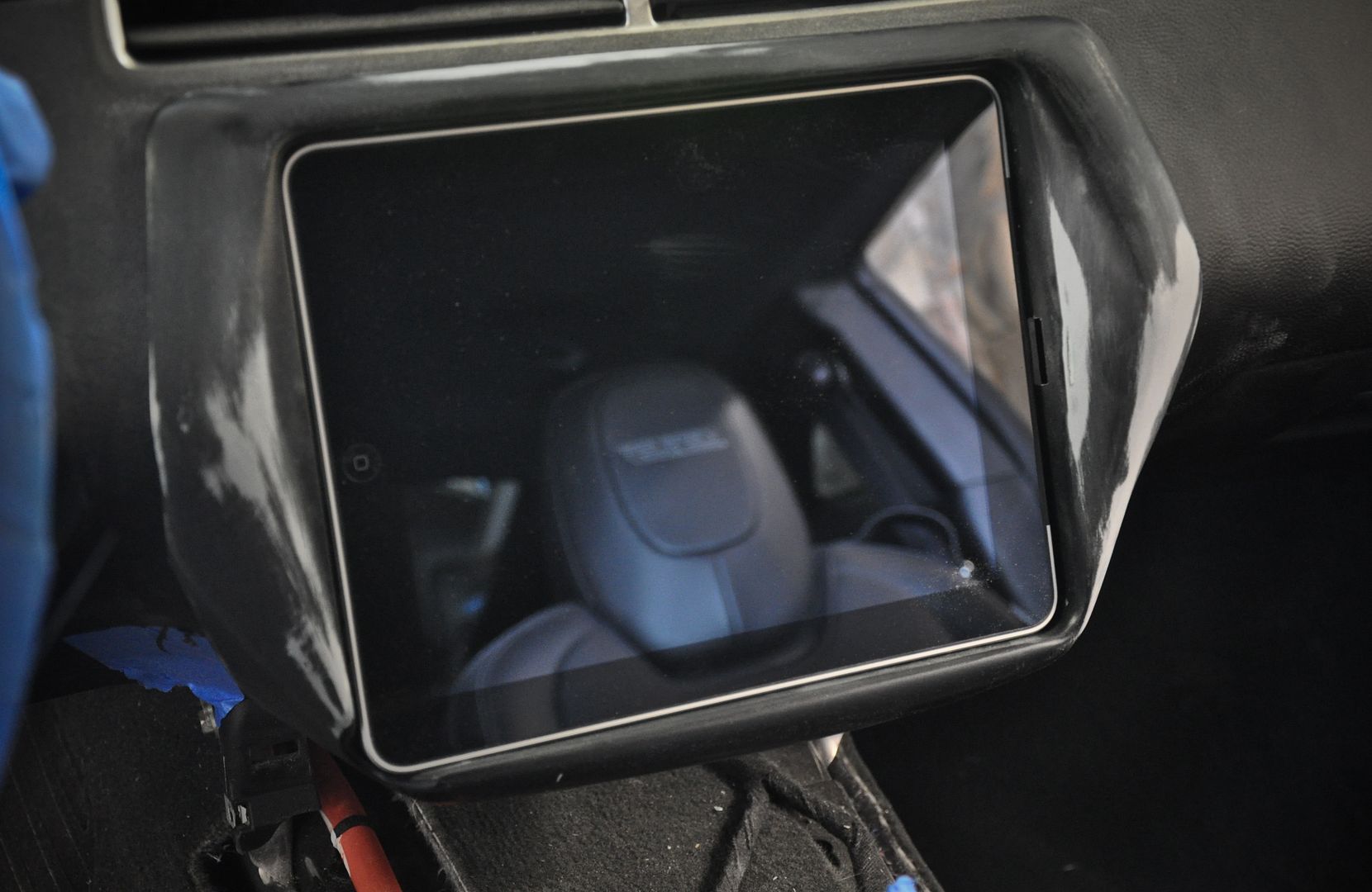

    Back into the car for more Ipad fun
    Fine tuning the trim work with a grinder
    Back of the Ipad dash piece

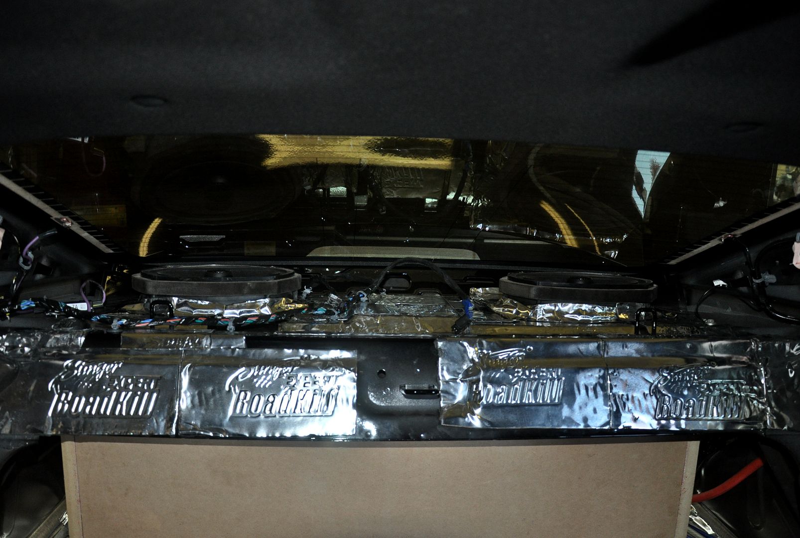

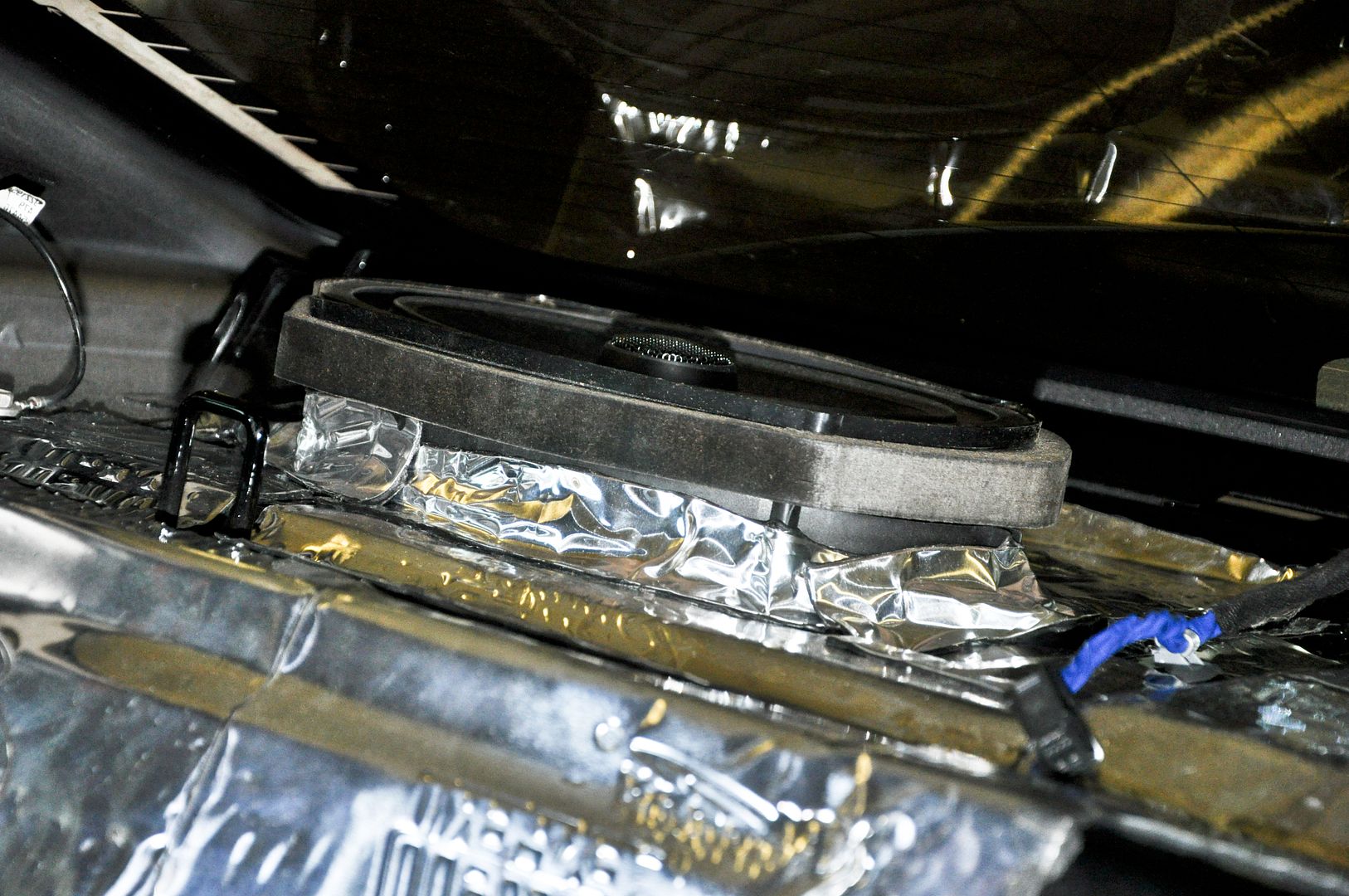

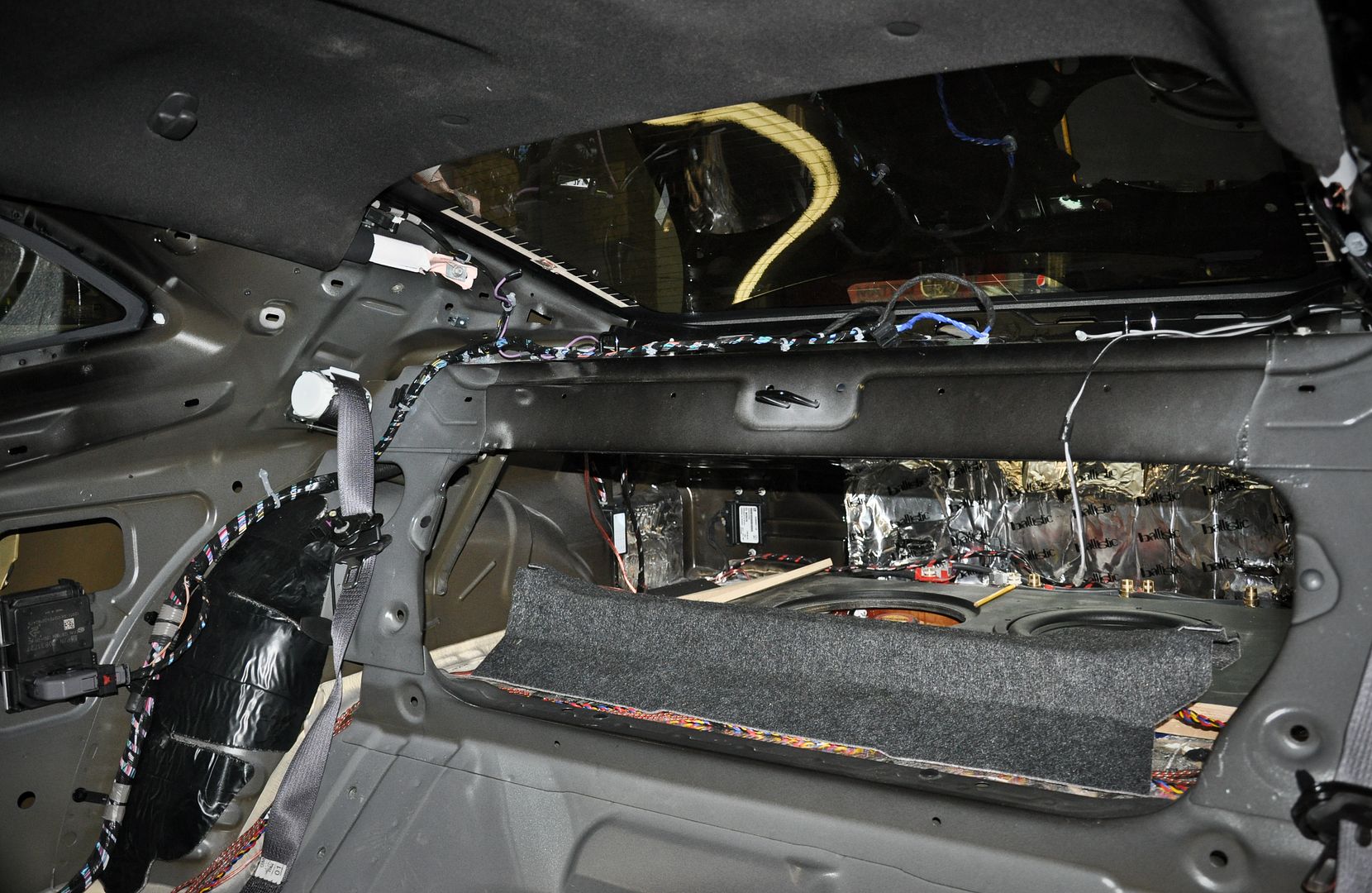

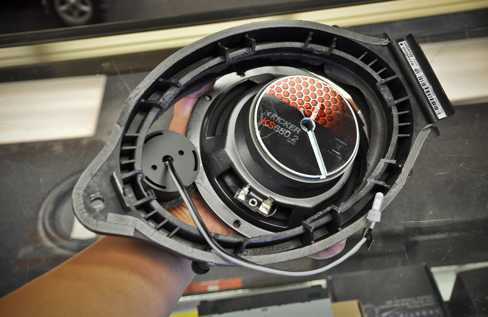

    Stripped the rear out to gain access to the rear deck lid speakers. We found some interesting install tactic up there from the previous installer.
    Our shadow box for the Amplifiers back side

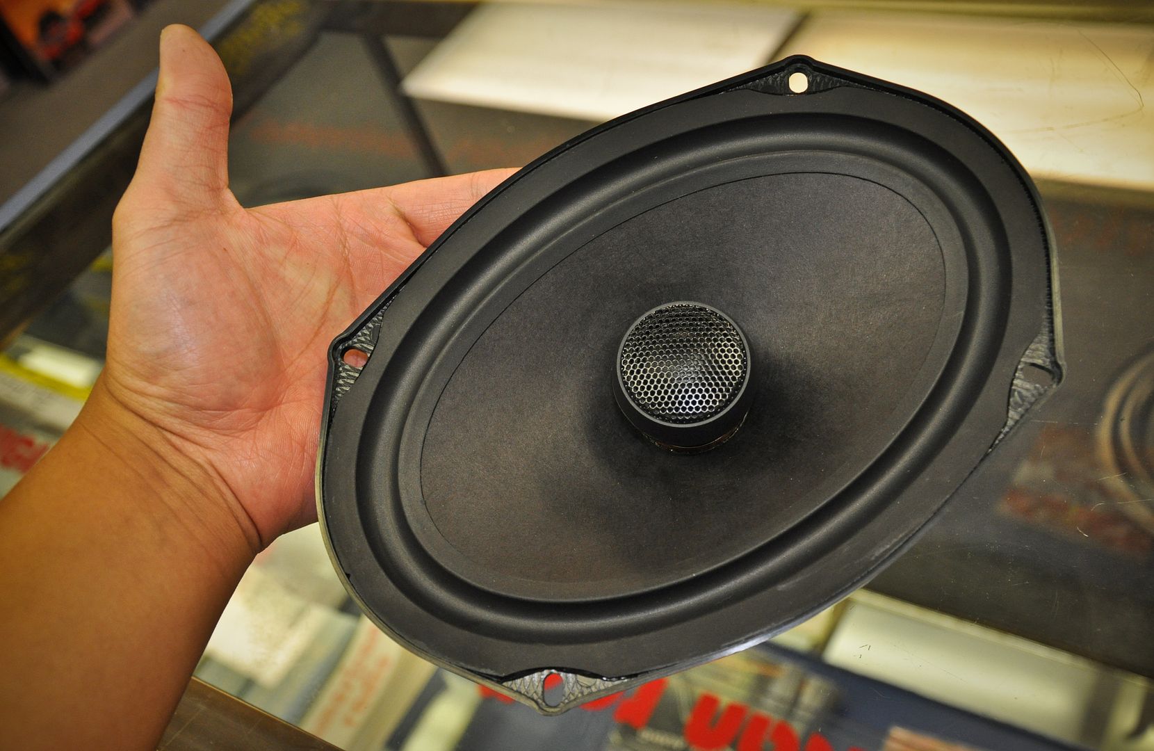

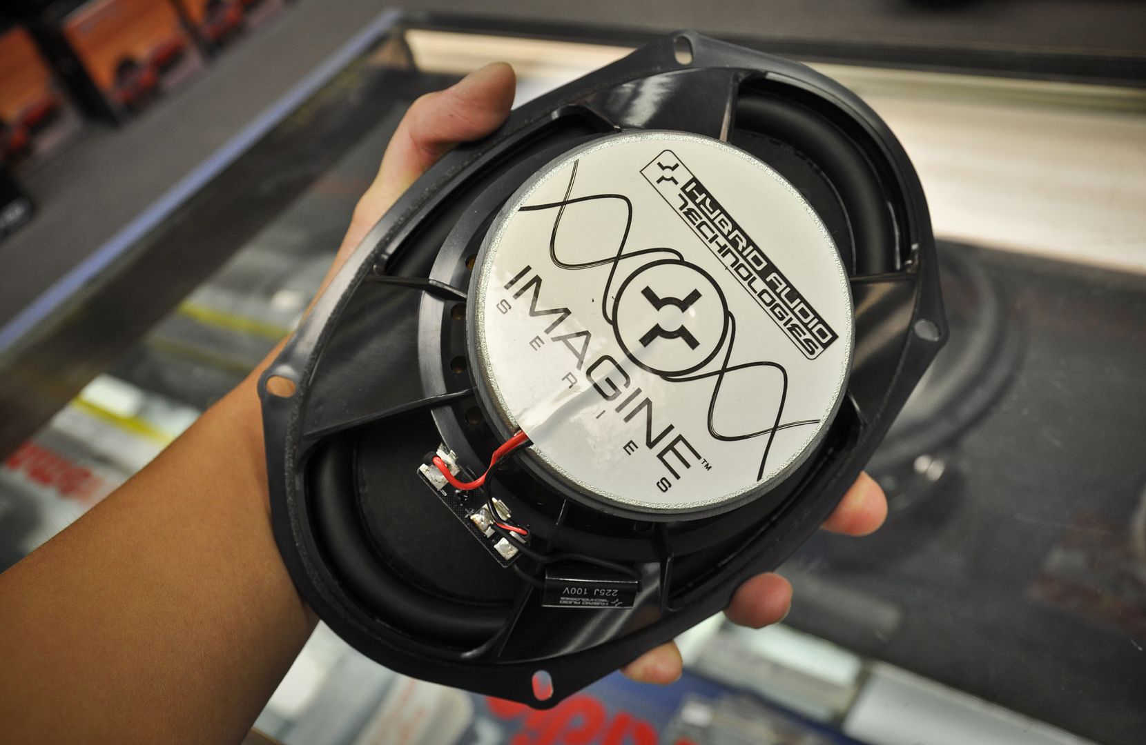

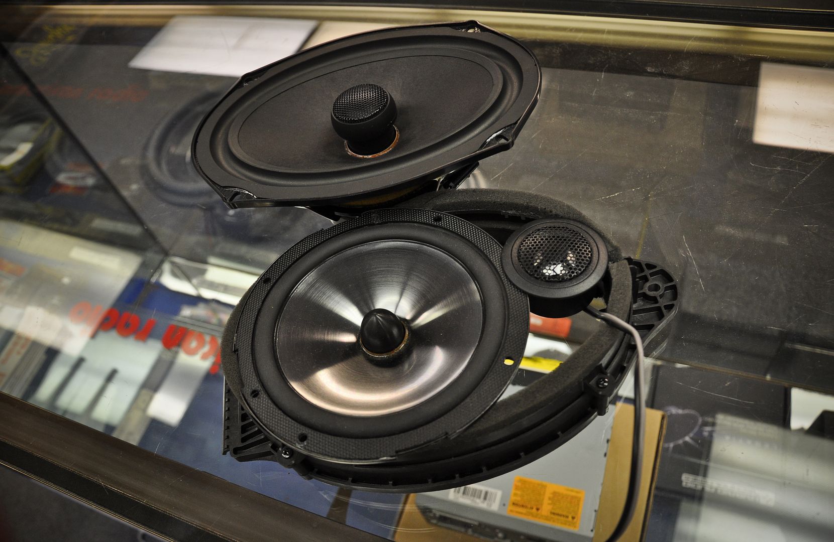

    This was what we took out of the rear deck lid in place of the stock 6x9 these were there.
    Back side
    This is the big problem. Customer thought he had rattling. Turns out these speakers on the deck lid weren’t even mounted. They were just sitting in the ring and the tweeters were glued to the mid base speakers.
    Back of the Hybrid Audio Imagine 6x9 going in the rear deck lid
    Front of the Hybrid Audio Imagine 6x9 going in the rear deck lid
    We made new baffles and installed them along with sound damping material

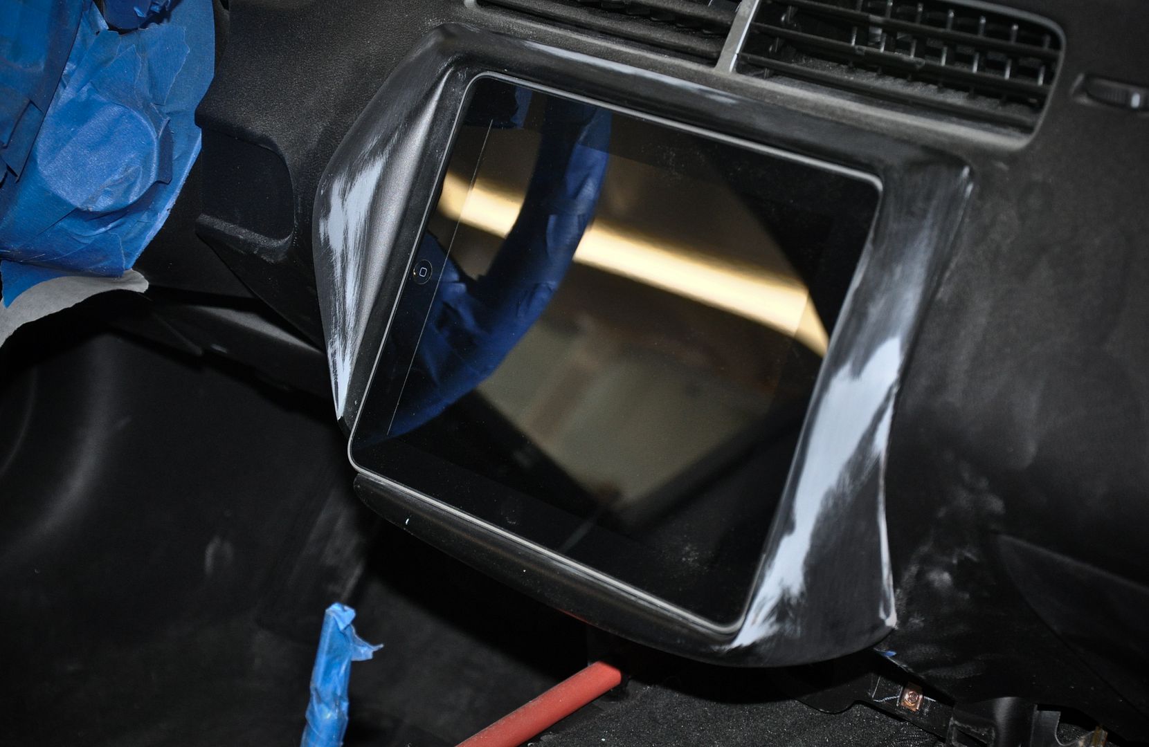

    Back to the Ipad mount. We still have a ways to go to make this as close to perfect and that’s what we are aiming for. Again, this is still rough and just wanted to post up pics for the owner to see them.
    Back side
    With the Ipad sitting in place
    The dash cutout

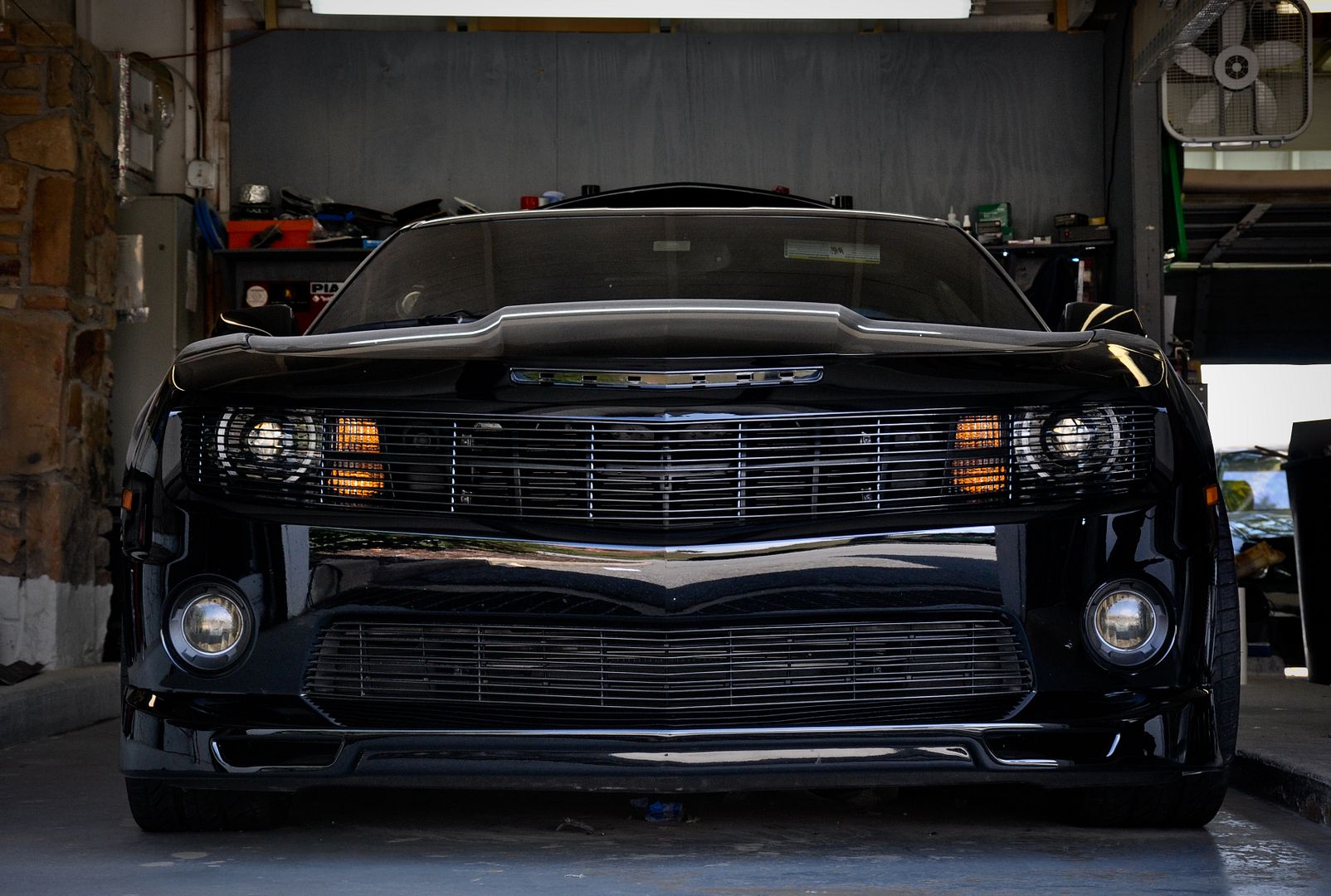

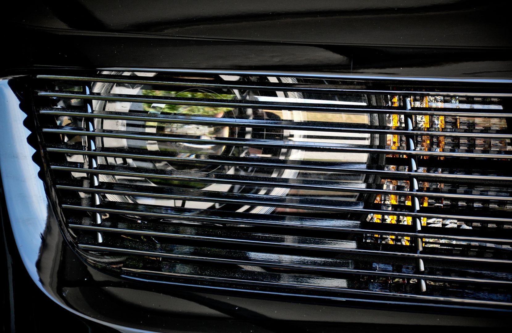

    The Black Billet T-Rex Phantom Grills are in

    wiring for the trunk

    amp rack in red suede
    more suede
    red LED's in and amp rack faceplate fitting

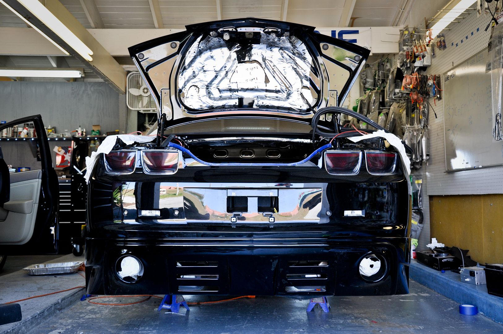

    had the car back up on jack stands to do the led under body kit
    there will be more additions soon. the ipad mount is taking shape and there are a few more goodies we need to work on.

    thanks! just an update, the IPAD is in and mobile in car wifi is up and running too! more to come soon
