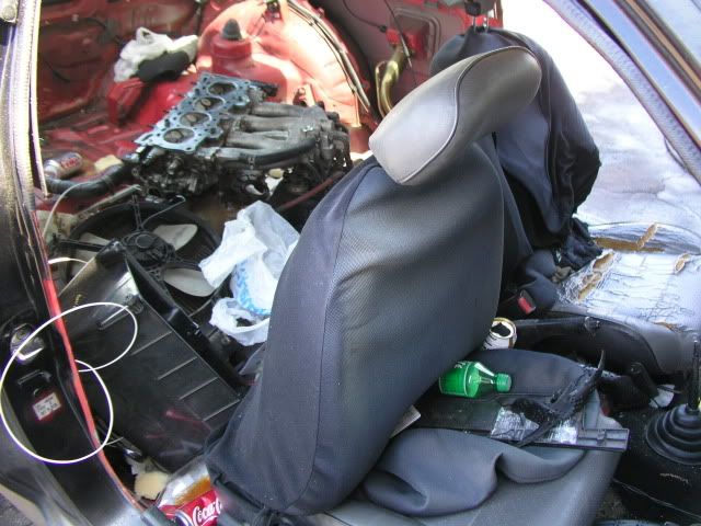

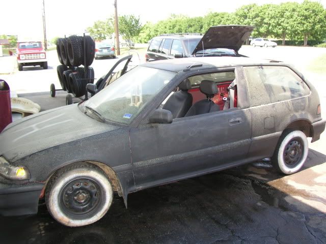

    this is what we started w/... yes this kid drove this car like this, he was a dull pencil if you know what i mean... and yes he kept it full of trash and shit...

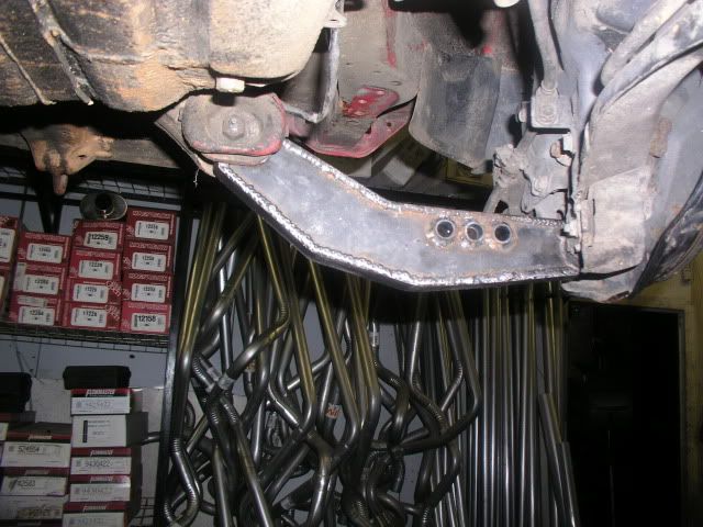

    new lower control arms, this was to effectively lower the spring rate so that is will have a softer rear suspension... we lifted the car 2.5" overall...

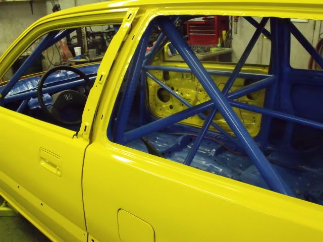

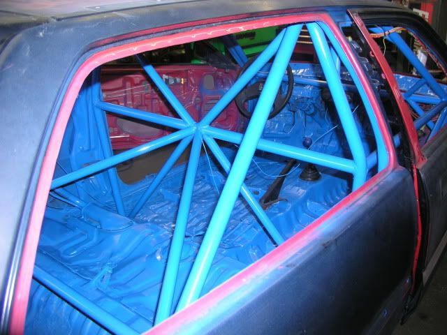

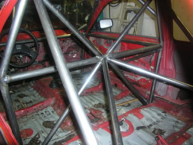

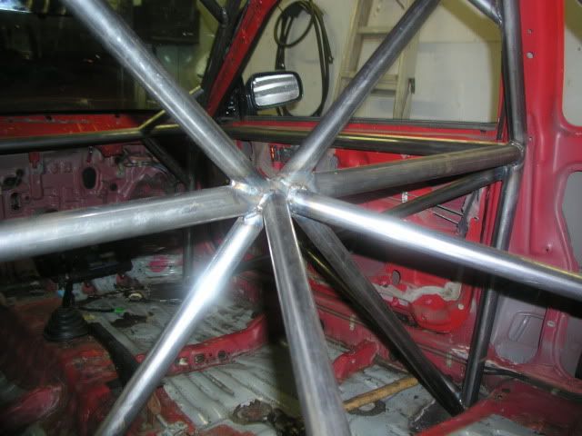

    the cage... still have to build the drivers door bars, but i will wait until last for that...

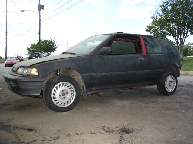

    after the lift... its getting a little bigger tire...

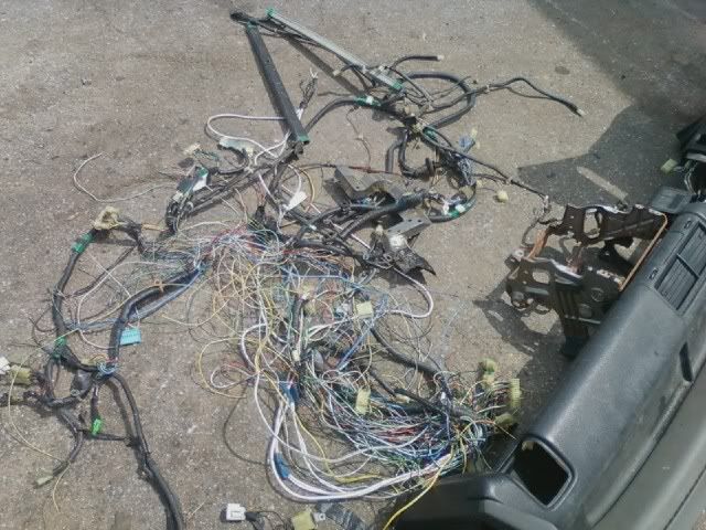

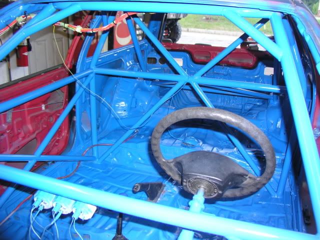

    wire tuck this... the only wires left is what is required to make it run... everything is on a switch panel...

    our platform on this has been to keep it as simple as possible... aside from the wiring we even went as far as to weld up all of the extra water ports, just so that the hoses cant fail... there is literally two radiator hoses and thats it... the fuel pump, fans and ignition are all on toggle switches, just so that there are no relays to fail... there will be two fans, wired seperately, just for redundancy... the car doesnt have to be the fastest thing, just reliable, because if you cant finish, you cant win...

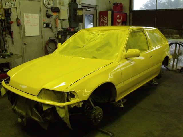

    we got the car painted today and i am very pleased w/ how $40 worth of rustoleum turned out... hopefully i can get the number stickers next week and i need all of your racing stickers that you dont need... thanks for looking...
