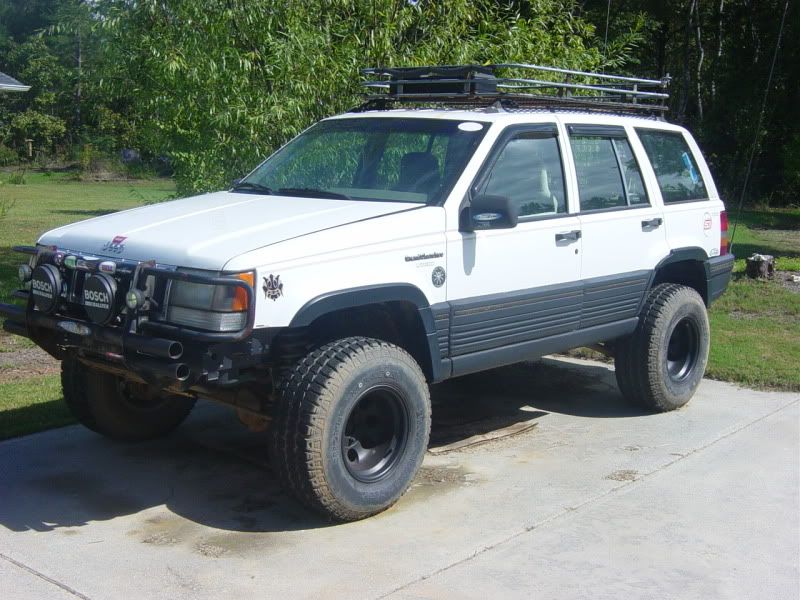

Picked this up Thursday night/Friday morning. I got home around 3:00AM after a 2 hour drive home in it. The way to get it was the coldest I've ever been 2.5 hours riding in 25* weather.
It was dark so these are the only pics I have until later on when it light outside.
I know lame pics but I'll have good ones later today.
