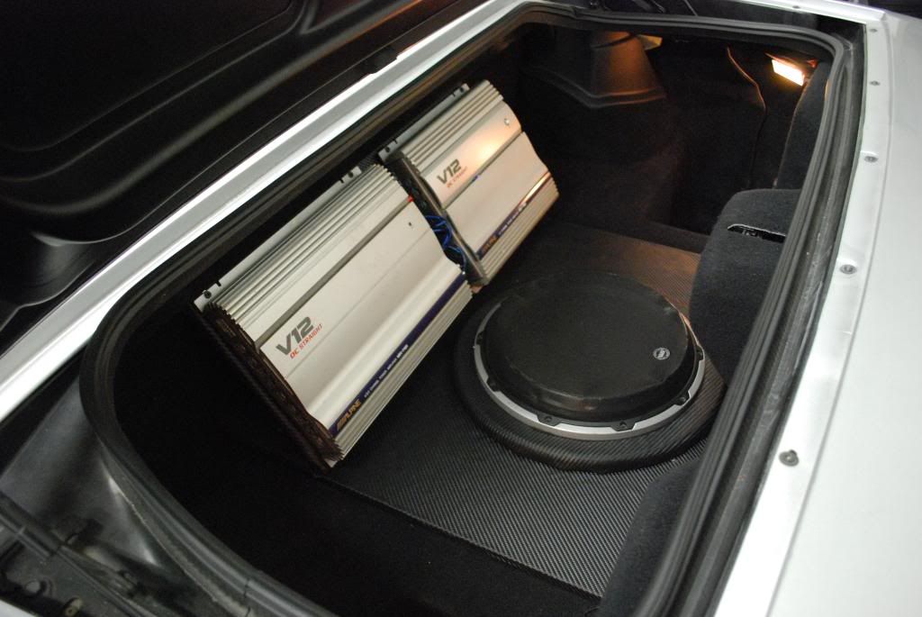

    Default Zen Motors - stereo install on a zo6

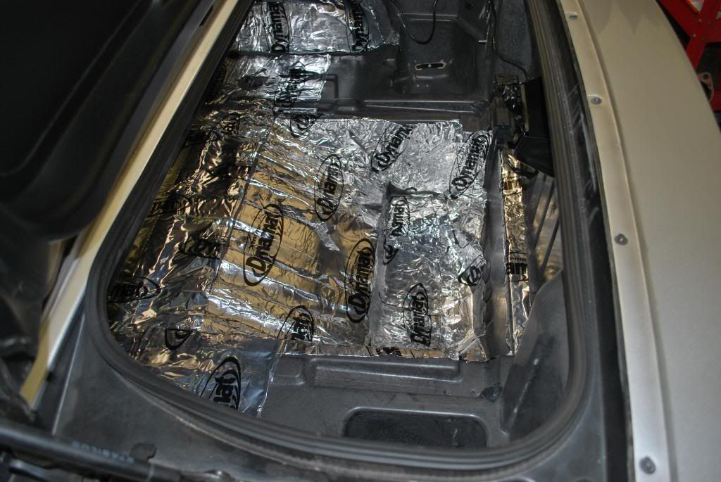

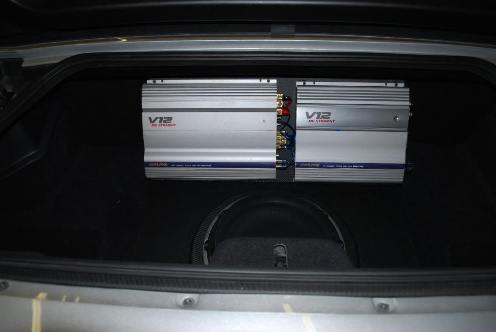

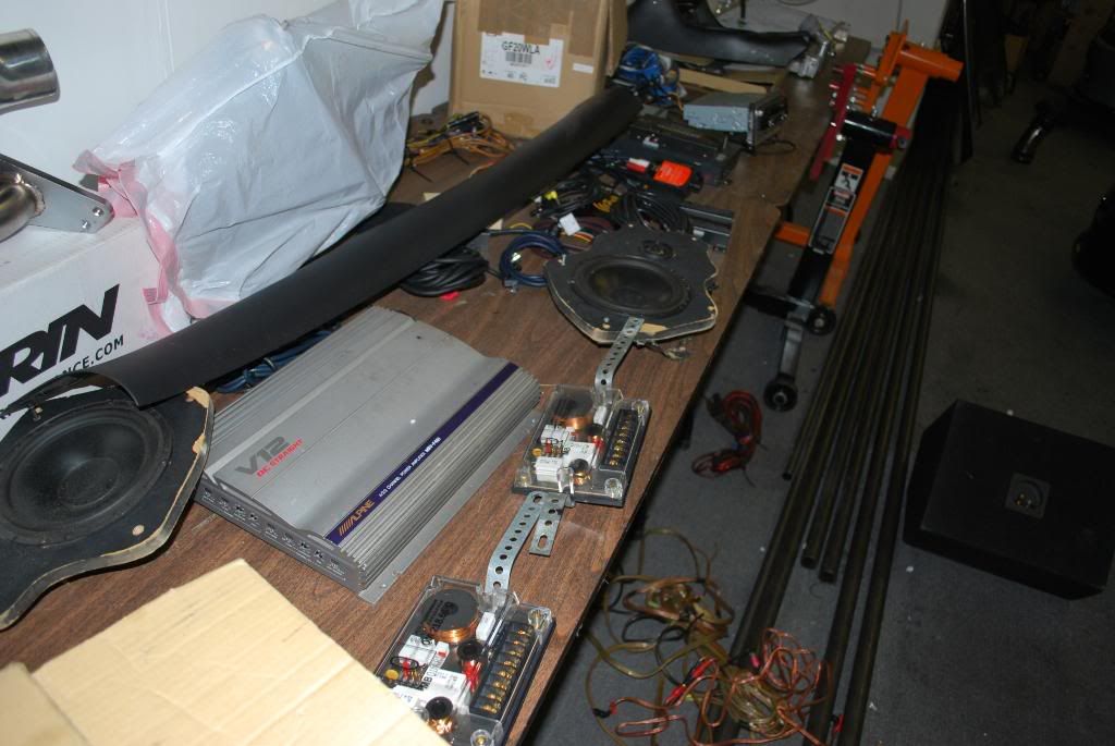

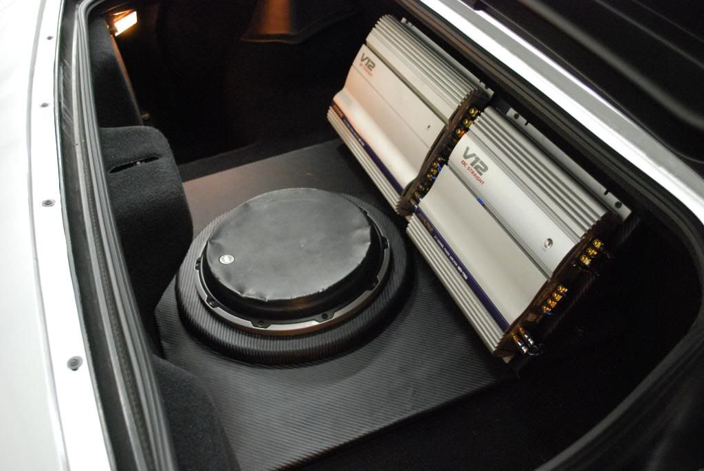

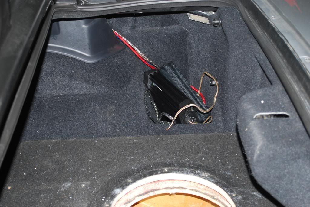

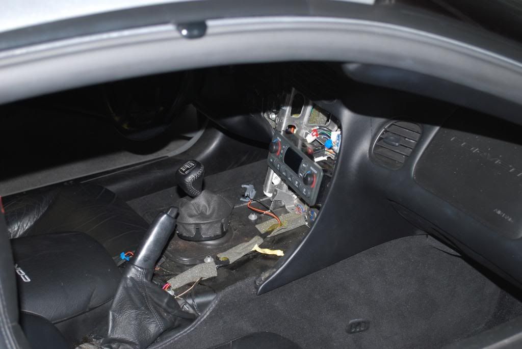

    We recently had a customer come in for a stereo install. He brought us all the components (used), all we had to do we re-install everything and make some minor adjustments (didn't come complete). At the end of the day, our customer was very pleased as we went above and beyond his expectations.
    He already had a box which was carpeted. We stripped the carpet and applied a carbon fiber vinyl for a sleeker look. Made him an amp rack, installed his double din headunit, nav, xm radio, mb quart q series components, all new wiring, dynomat, amps, sub, and a few other things. here's a few pics that we took. wish he at least had a new speaker cover for the sub.. you'll see why. we forgot to get pics of the interior after all was said and done. when he comes back, we'll be sure to remember to take some more pics.
    We wish we could have done the whole project from scratch, as we noticed a few issues here and there, but the customer got a great deal on all of his parts. this was a very basic install, nothing crazy, just enough for the daily commute. :thumb:

    You running both amps off that 8 gauge? Or is that the old wiring?
    Kevin
    -zen motors-
    at the shop
    4,518
    ^^ old wiring. he had another system in there that we had to take out.
    4,202
    You don't see 2 amps to 1 sub very often. looks pretty good.
    -zen motors-
    at the shop
    4,518
    ^^ one amp is for the components, the other, for the sub.
    I GOT IT!
    Jan 2003
    Lithonia, GA
    822
    2 amps for what looks like a 10w6v2 since both amps look to be bridged? looks pretty decent though

    Quote Originally Posted by hybrid90accord View Post
    what? no. it appears that the 4 channel on the left is running the interior speakers and the 2 channel on the right is bridged to the sub.

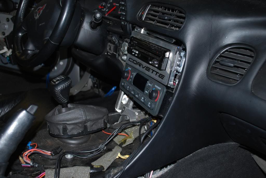

    install looks pretty clean. any pics of the deck install?
    Real Friends > Car Clubs
    -zen motors-
    at the shop
    4,518
    ^^ forgot to take pics of the dash after we were done. im sure our customer will be back at some point in the near future, i will be sure to take some interior pics.
    StayClassyAtlanta raybuck's Avatar
    437
    A new grill and trim panels would clean it up. (If customer wanted it) The carbon vinyl looks pretty good; but I'd rather use it for accents instead of the whole top of the box. ex. Good install
    -zen motors-
    at the shop
    4,518
    ^^ i hear ya... if we actually designed the box, we would have gone a completely different route. we had to work with what we were given. considering the price that he paid, he got a hellova deal. :P

    Quote Originally Posted by Prime. View Post
    [/QUOTE]
    your right at my work computer i was only able to get this pic to render so from this angle it looks like your running 2 two channels. Once i got home i was able to see the rest

    Hey I was wondering, I have my whole trunk dynamated, and I am doing a 97-99 conversion on my Maxima within the next few weeks, which requires me to change trunk lids. Is dynamat transferrable? Can I just peel off the dynamat on my current trunk lid and stick it to my new lid?
    -zen motors-
    at the shop
    4,518
    ^^ never actually tried to remove and reinstall dynomat. no idea if its going to deteriorate as you pull it off. sorry.

    Our interiors are so shitty... System is too flashy for me, the trunk is not usable.
    Quote Originally Posted by swollix View Post
    a system done correctly doesnt have to be flashy
    IA Hater/Shit Talker
    2,393
    Quote Originally Posted by b@d @pple View Post
    I know. If it was mine, I would have preferred the amps to be hidden and the sub more discreet.

    as far as the dash is concerned, it looks like any other vette w/ a flipout screen. id say the "carbon" looked pretty good for what is was used for ( a refinish and and accent for the amp rack)
    the vinyl is a little unforgiving to surface inconsistencies so sanding is necessary to get all the glue and old carpet off. all in all, the car sounds pretty good for some older alpine and a whole lot of gear in the car (which is hidden, this system has all the bells and whistles)
    I wouldnt say entirely not usable. but discreet is harder to do with amps tht size in a car of tht configuration. Where they are seemed to be the logical location given tht the box and rack are technically "one piece". I didnt have to mount to FG parts or structures but still get a pretty rigid structure from it so he can sling the car as hard as he likes and not worry about anything breaking. if somehow I can figure out a way to shove those amps in the cabin without sacrificing sitting space or utility with tht box
    (behind the seats/dash doesnt work btw lol) Ill let you know
