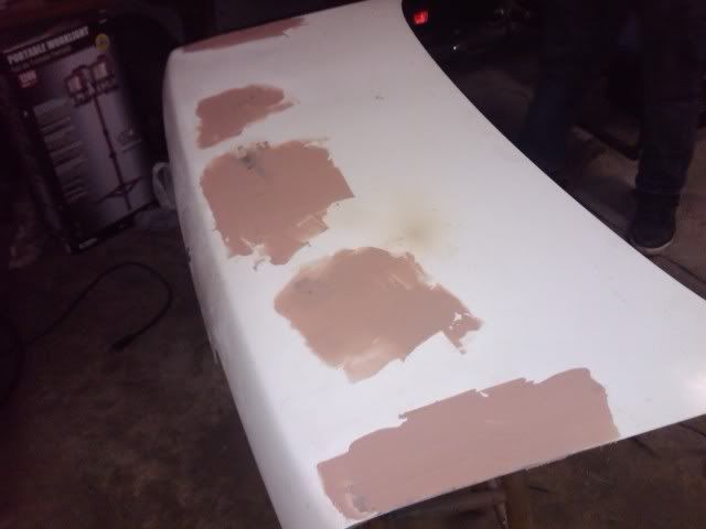

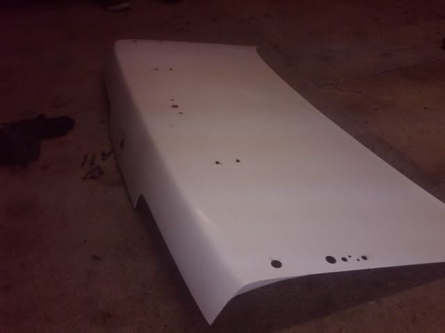

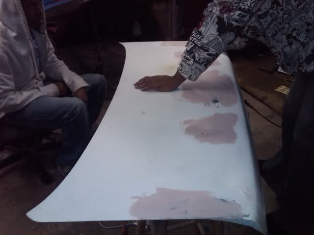

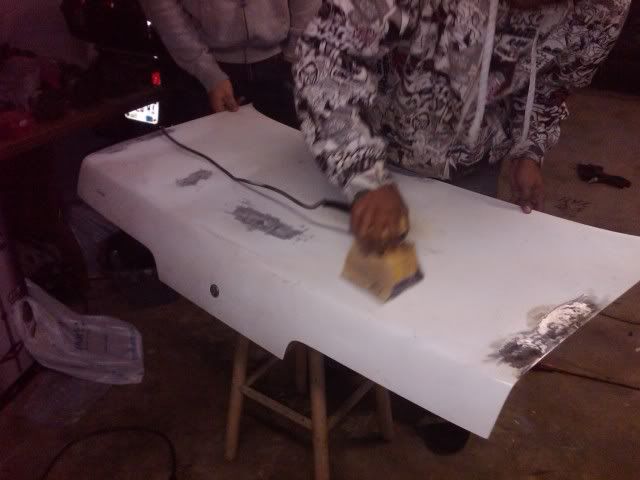

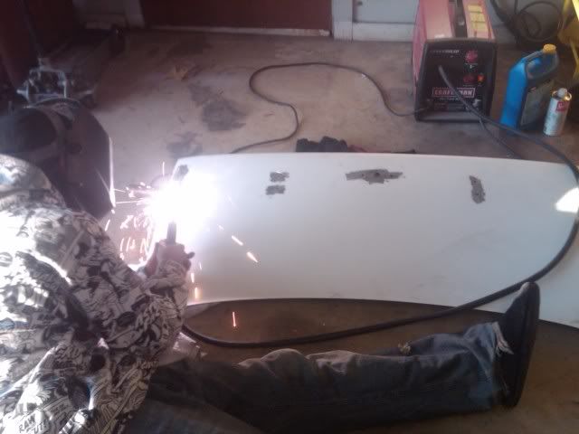

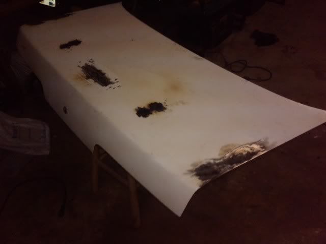

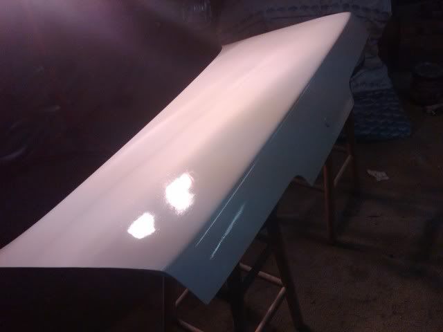

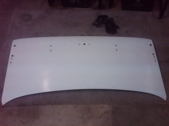

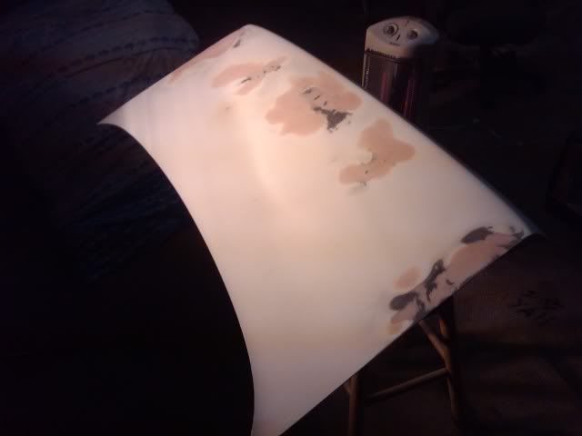

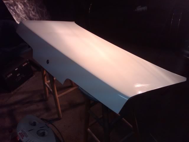

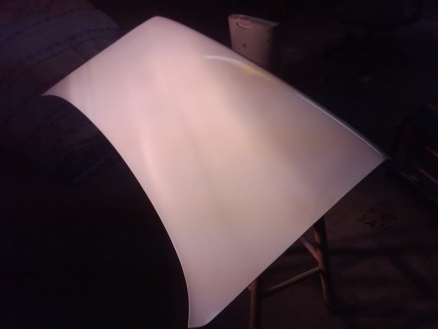

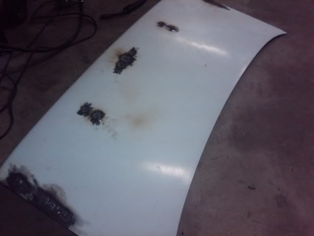

    a good buddy of mine brought his s13 trunk to my garage and needed me to get rid of those holes in his trunk so there wouldnt be a lake in his trunk everytime it rained! did it in about a 2 hour time period. sorry for the bad pics used my cell phone!

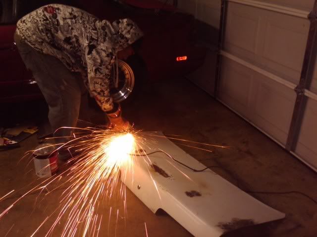

    good job, i like the welding, but got to wear that PPE. (personal protective equipment.)

    Looks good, did it warp from welding?

    Quote Originally Posted by Kserieskid View Post
    not to bad.. i welded at a very low amperage and let it cool of slowly.. as it cooled it kinda settled back into place.. the bondo took care of the rest
    Hit u w/ ur own pimp
    Oct 2009
    My tool box
    308
    nice, in the future try using a wet rag to cool the surface immediately after you weld.
    really... never thought of that... thanx alot ill give it a shot next go round

    dam,how long did that take?

    Quote Originally Posted by silverDA View Post
    2 hours

    19 Holes in a trunk?...That has to be a record.
