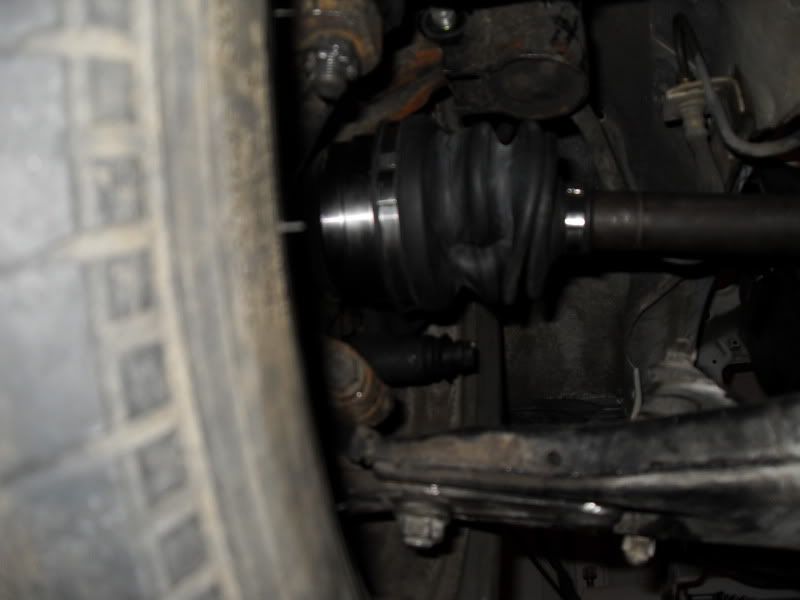

i jacked this side of the car up and got my buddy to turn lock to lock while i spun the wheel. it seemed to be ok. but it just looks scary. i know i didnt replicate high speeds, but it at least spun freely while turning at slow speed. i will probably have to swap tie rods, because at the very end of the lock, the tire hits the lower control arm.
http://i71.photobucket.com/albums/i1...1/SDC10759.jpg
http://i71.photobucket.com/albums/i1...1/SDC10764.jpg

thanks bro. if these axles function like this, all i have to do is tackle this wiring and she will be running! :yes:
