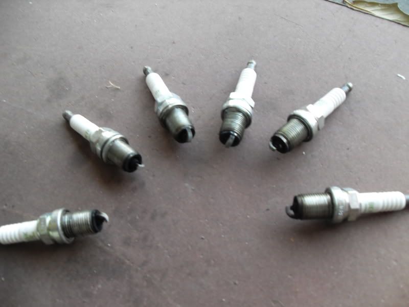

    Just when i thought the swap was going well, Kaboom.
    Spun a rod bearing just cruising along out of nowhere. It was not even knocking the day before. FML...

    5,717
    Idk man. I've never seen anything like it. You could not hear any kind of knocking until yesterday. I thought it was a bad valve because it was so faint. so I was driving home to park it last night and it happened.
    I'll post some pictures later.

    Which bearing did you spin?
    5,717
    Thanks Joe. I might hit him up on that offer. I wanted to build a Klde/ze hybrid anyway but not this soon. Thats the plan right now.
    EDIT: didn't see it has a blown HG. I have one of those in my driveway in the mx6 lol. I want a zero mile rebuild.
    Blackshine it was cylinder number 6. Looking up at the bottom end it was the far left rod.
    Oct 2003
    2,961
    Yeah, a weak oil pump will do that. I probably might wanna consider changing mine out sometime. I don't feel like spending $160 for a new one, though
    5,717
    That might explain the lifter tick...my head might have not been getting enough oil. I thought it was just common with Mazda heads because my old b6 did it too.
    I knew I should have finished hooking up my oil pressure gauge. Had one in the car ready to go but just had not ran the nylon line yet.
