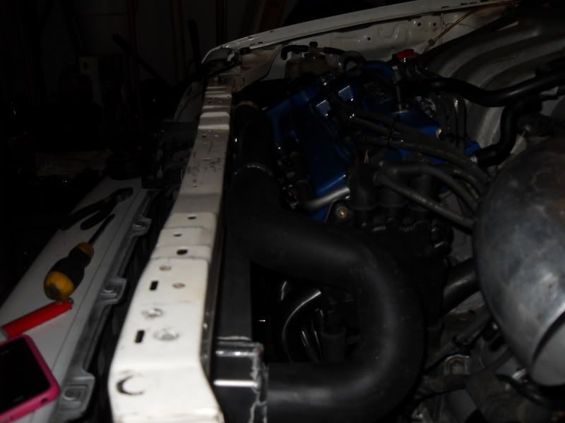

    tonight i didnt do much. i was scared about my upper hose not having space but i figured something out. i went to autozone and searched their entire inventory of radiator hoses. after finding two that put together would work, i used an exhaust pipe reducer to bring them together. total cost for a custom hose = $27.
    this was a test fit. the hose does slide on the reducer farther. of course ill put some hose clamps on it as well.
    what do you guys think will be good to coat the pipe with to keep from corrosion?
