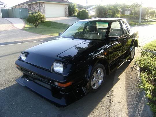

    Run down of the car.
    Motor:
    Forged rods and pistons, Nitrided crank, heavely ported Jap head, o/s custom made valves, cam by Sure Cam to suit porting and valves, adjustable cam gear, valve spring upgrade, rocker arms of head balanced, kometic head gasket, o/s gaskets to suit porting, motor balanced.
    Airflow:
    3inch exhaust, custom exhaust manifold, t3 Turbonetics turbo, Turbonetics external gate, custom engineered inlet manifold(needs to be improved), au falcon throttle body, FMIC
    Fuel:
    680cc fuel injector, Turbosmart fuel reg, Turbosmart type 3 bov, custom fuel rail, twin msd fuel pump, surge tank
    Electrical:
    Haltech e6x, 4 x LS1 Commodore Coil Packs, Gizzmo shift light, 10mm Leads, Autometer: oil/p, oil/t, water/t, boost, af, fuel/p
    Drive Train:
    n13 front hubs, n15ss pulsar brakes, n15ss pulsar rims, Azenis semi slicks, custom combined driveshafts(still all forged bits like nissan end to suit hub difference), n12 belhousing with n13 internals, locked diff, NPC custom clutch to suit intended power, custom flywheel, n13 koni adjustables, coil over springs on front, rear on kings high tension springs.
    Interior:
    Stripped, no a/con, no fans, no heater condensor, no deading, brand new carpet, custom made dash to suit gauges(see pic), OBX race seat, no rear seats.
    Exterior:
    Custom made body kit(not the most beautiful...but we needed something to cover the wheels sticking out and it was available to buy), Engine vents molded over, no lines down body, custom fibreglass rear bar(standard but smooth), black paint.
    I can't think of much more...alot has been done, still a little to be done...car will be back in brisbane soon, from there we need to get a full power tune, intercooler needs to be modified, few thing here and there in the bay, front seats to be fitted, rear springs needed to be re heated and shrunk, new rims.
    We have taken our time...and no intention of starting to hurry now, the car will be hopefully ready by march...just a little to do now...and a not much to pay for...lol! Not sure what she is actually going to perform like, may just break drive shafts and gearboxes all the time. Intentions are to have it running by march and we'll see what it does. Intally on the run-in tune we had a turbo fault, but we had enough go time to get it goin on the dyno, with around 10psi we made almost 200hp atw...then we ran out of boost as the turbo gave up The external gate spring is set at 15psi...

    is it a rally build?
    Senior Member StreetHazard's Avatar
    Sep 2008
    1,612
    I understand what is going on in these pics at all
    No
    9,232
    I'm trying to figure out why it looks so hideous, and sits about as high as taterdog's truck..
    Macon
    5,591
    Please explain this vehicle.
    ALL CAPS JITB's Avatar
    20,772
    i doubt that there is a motor in it on those pics.. i hope not...lol
    'Round These Parts
    15,713
    Terrible Lookin car but enough power/weight to embarrass everyone in this thread (in a straight line), including me.
