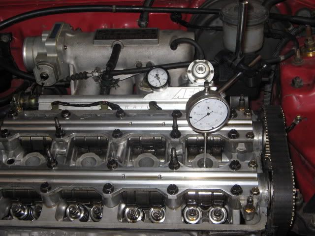

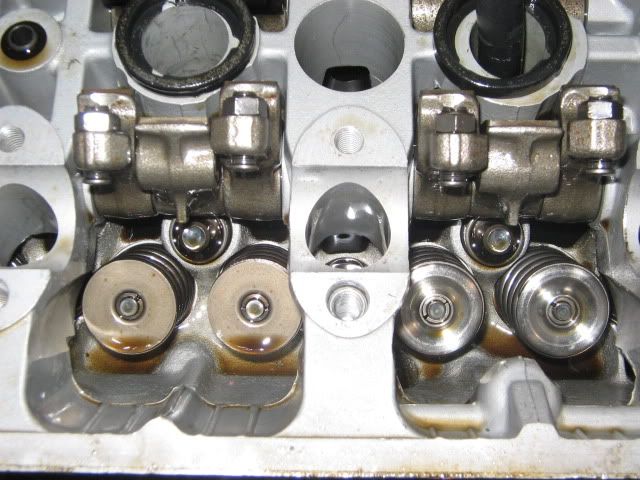

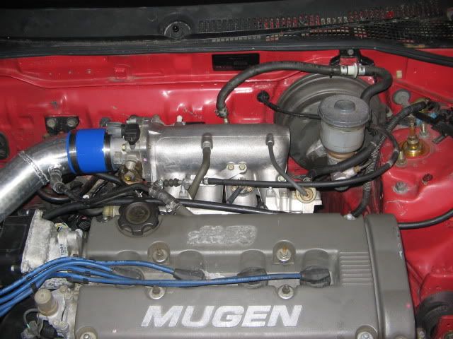

    As some know Mike got another rex to get some parts off of. Those parts included a set of S2 Pro 1 cams and S2 valvetrain. Also a S2 intake manifold and TB. We also threw in some bigger injectors since he was maxed out on the stock ones.
    Before

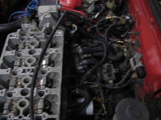

    Valve springs and retainers going in...
    Old intake and cams out...

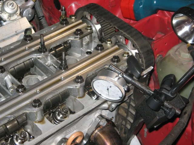

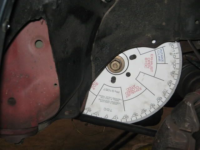

    Setting up the degree wheel to degree in the new cams
    Finding TDC of #1

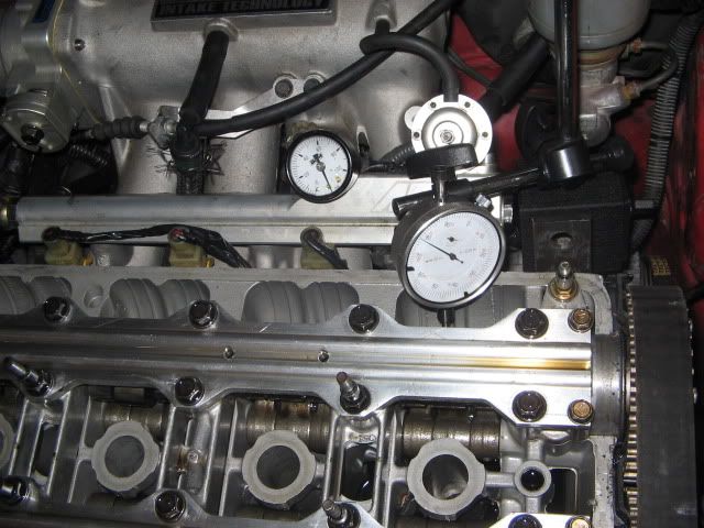

    Setting the intake cam
    Setting the exhaust cam

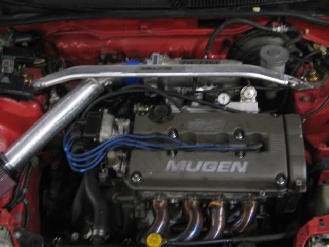

    All done waiting for the dyno....

    Heres the new graph, about what i expected. After all its a UNTOUCHED STOCK ITR block and head. When i dynoed it last it made 196whp which is INSANE for a stock R motor with just a header. After adding all the cams, intake manifold, springs ,ret etc i didnt get my hopes up because there is only so much you can do with a 10.5:1 compression 1.8L.
    Pretty much what i accomplished was now i can safely rev to 9500 with the PRO valvetrain. The PRO1 cams extended my powerband out about 500-600RPMs and made 3-5whp up there, and i picked up some midrange gains.
    Plus IF i ever do decide to go bigger, i have everything i need to make big power.
