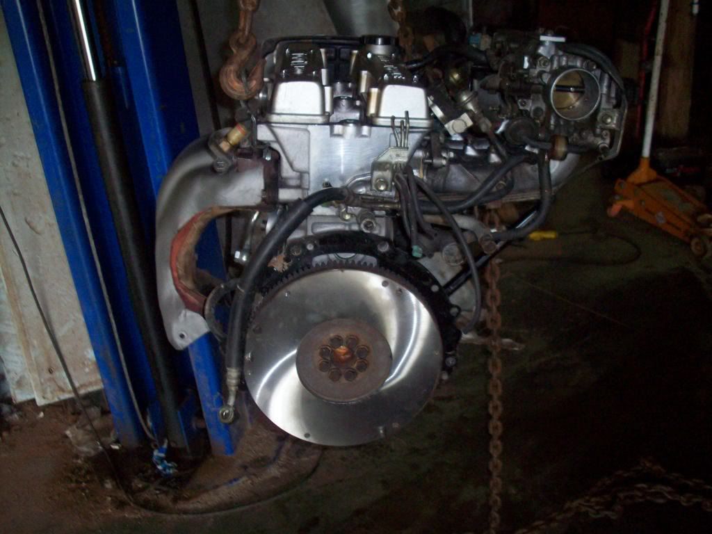

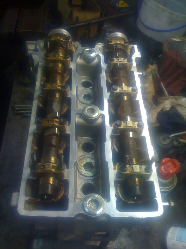

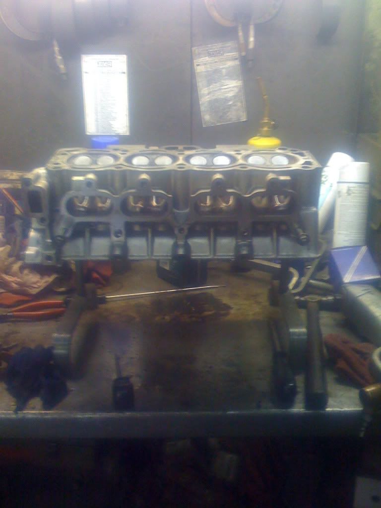

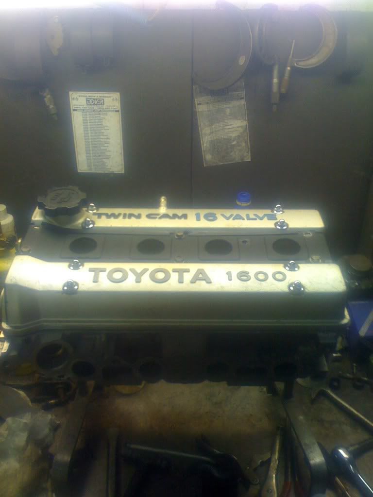

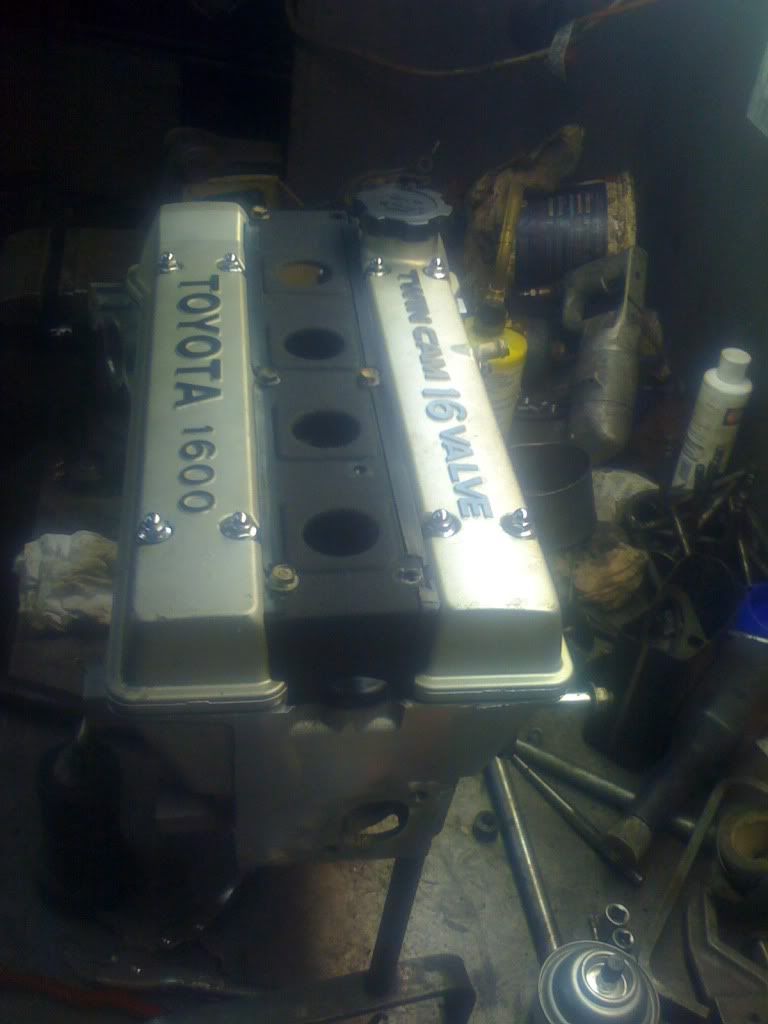

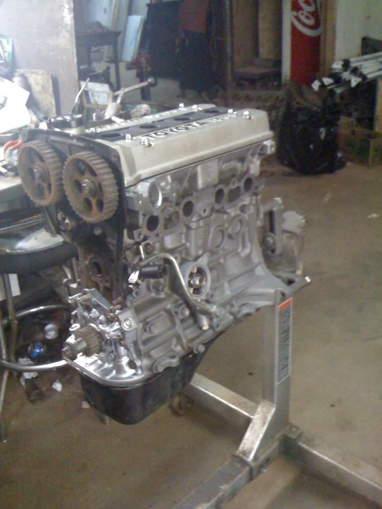

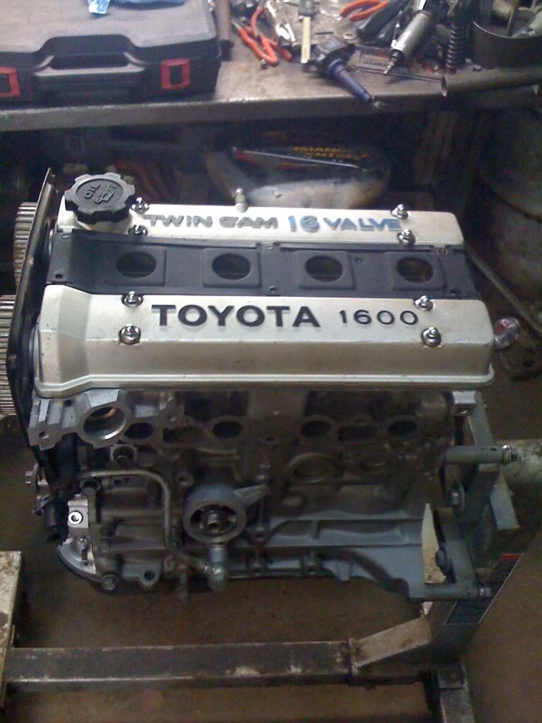

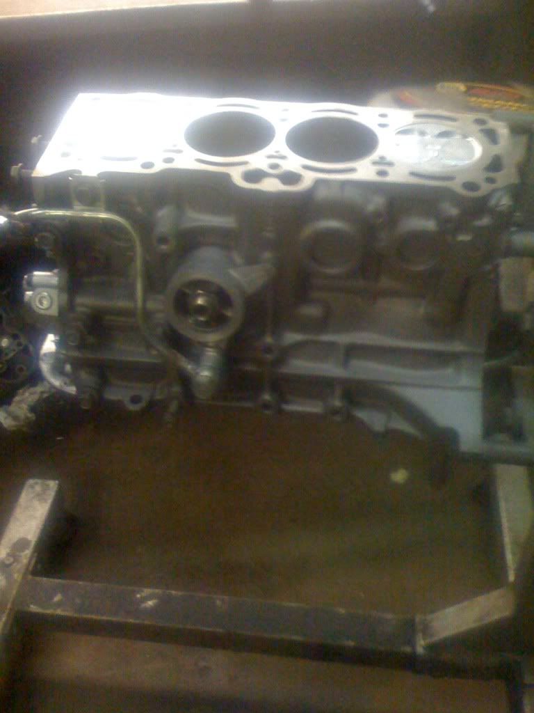

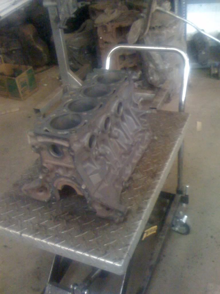

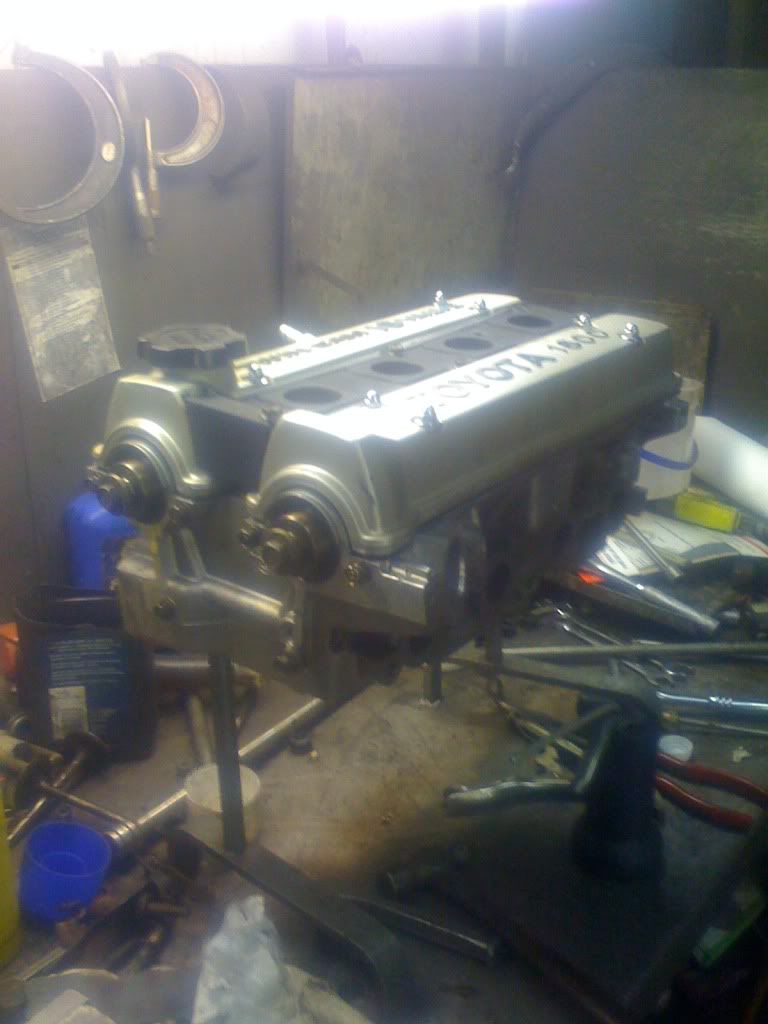

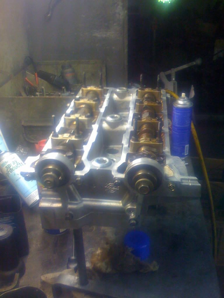

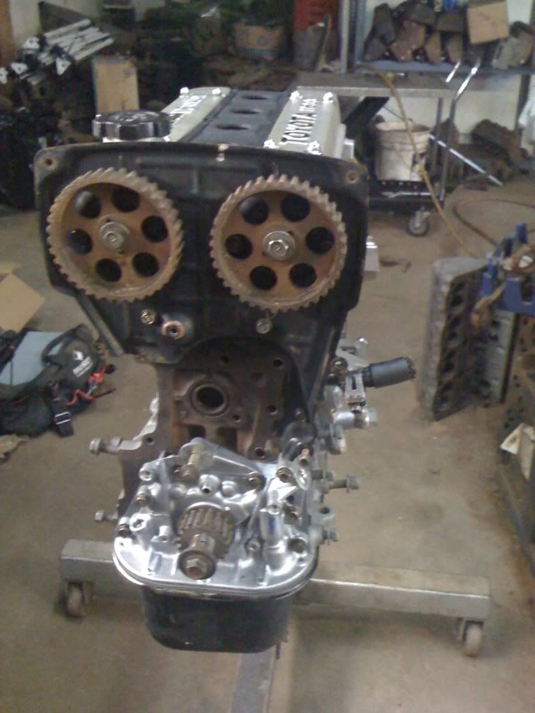

    Pics explain all.

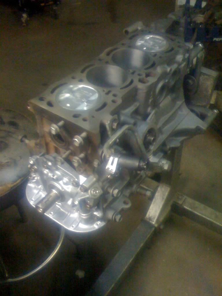

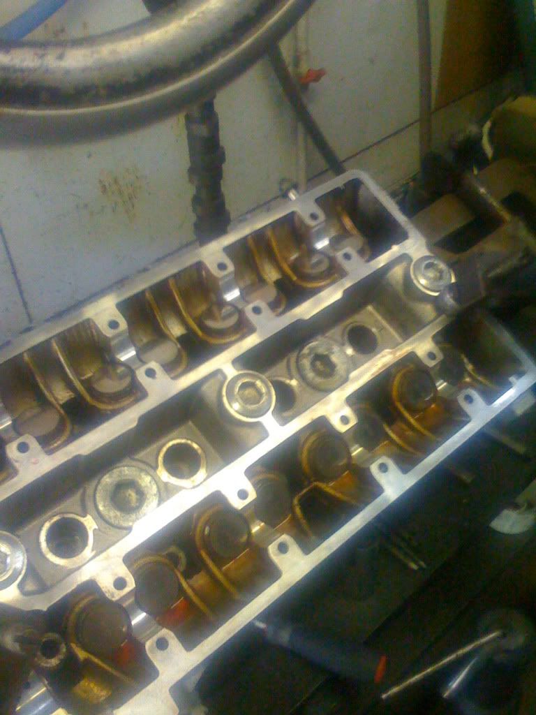

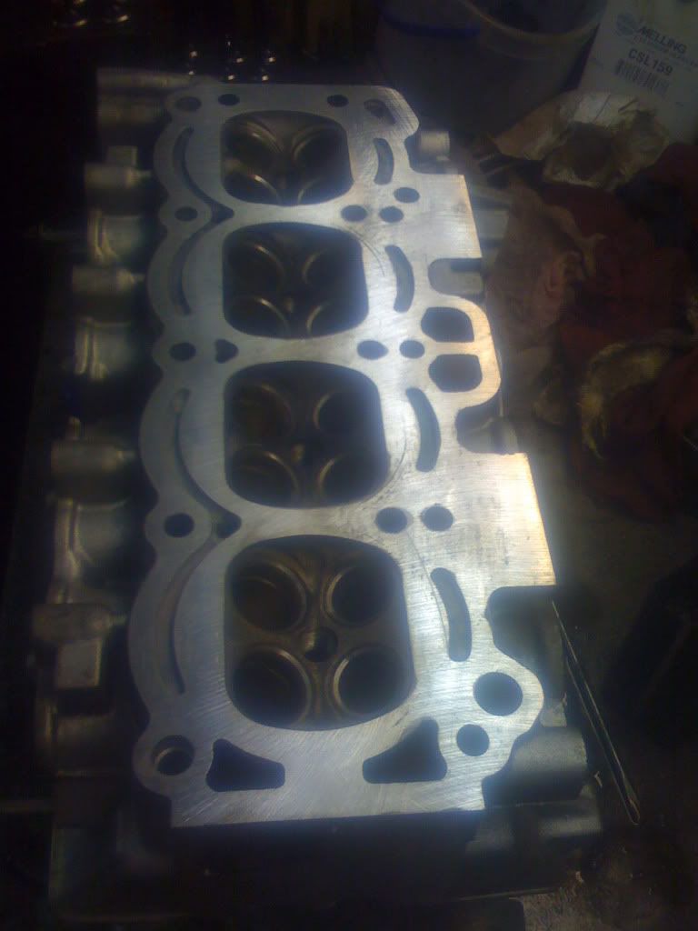

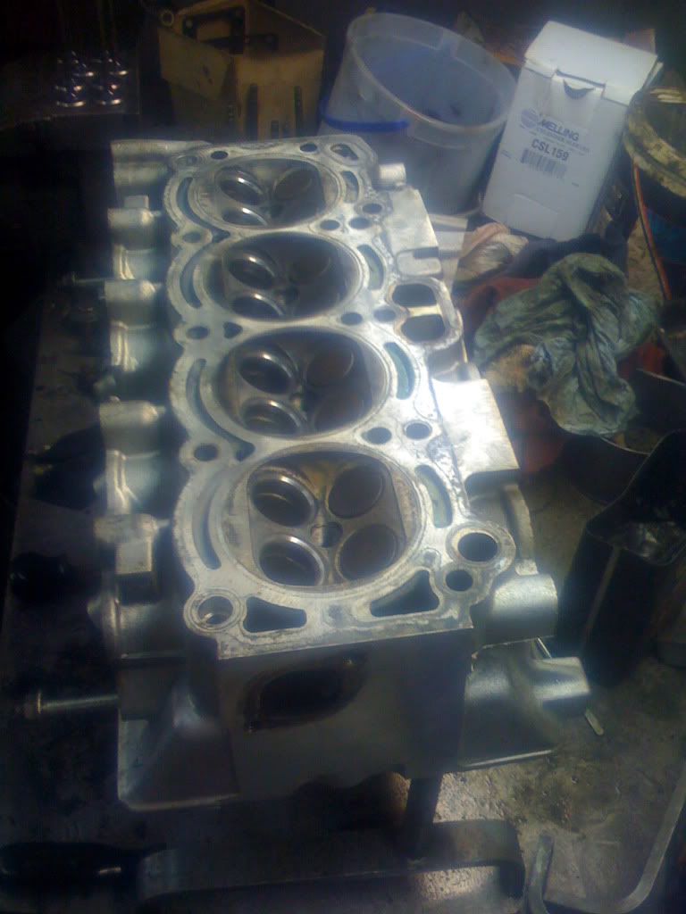

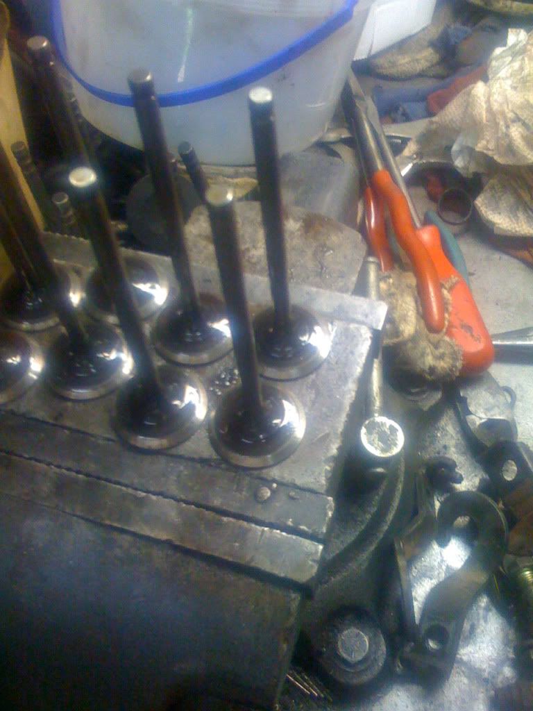

    The head has been surfaced, 3-angle valve job, and cleaned.

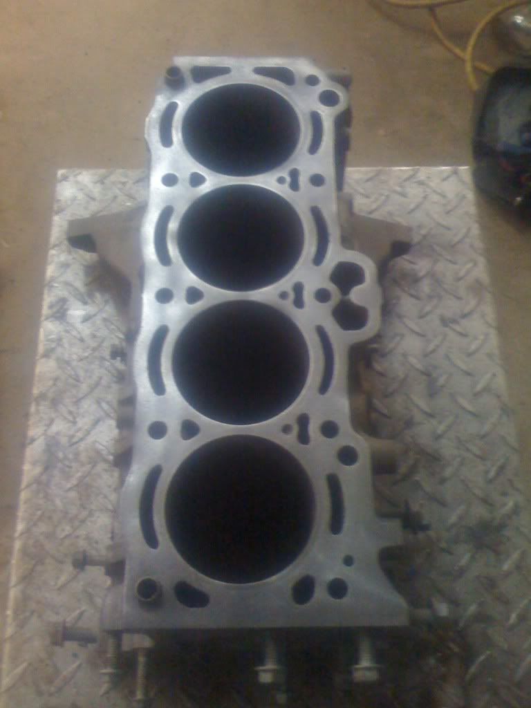

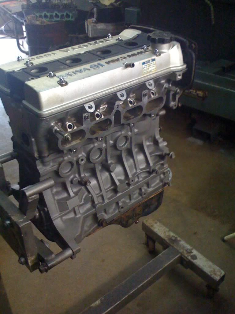

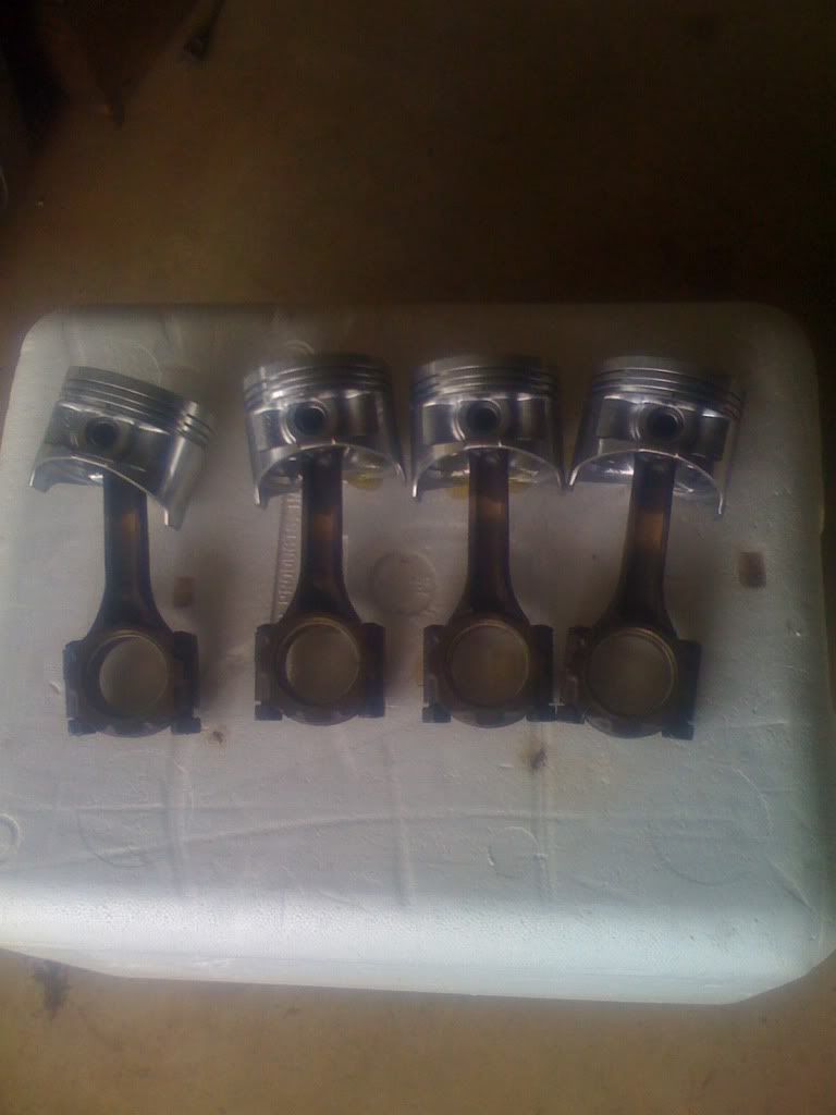

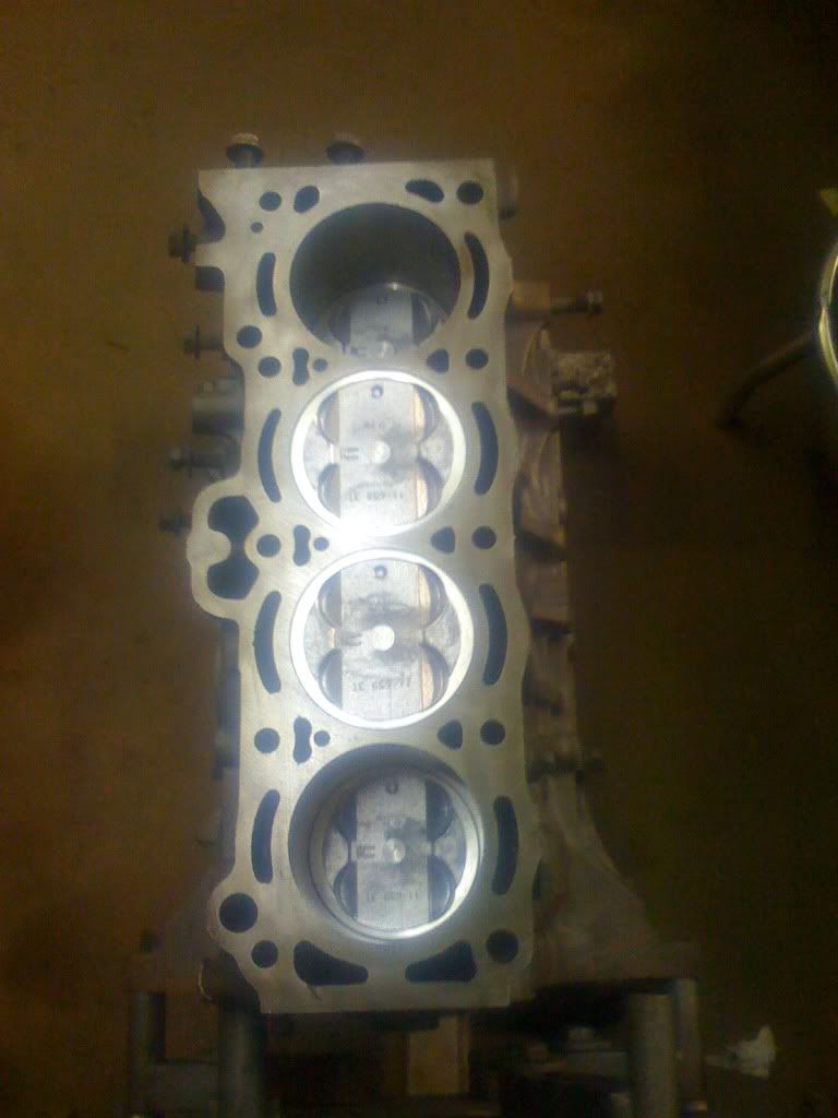

    Block has been vatted, bead blasted, cleaned, bored and honed to 0.030 over stock, decked, and cleaned again! lol
    Finished product! Well almost hehe
    New: Plugs, Plug Wires, Distributer cap and button, Acc. belt, Air Filter, Fuel Filter, and oil filter.
    Some AMS over priced oil! haha but worth every penny!

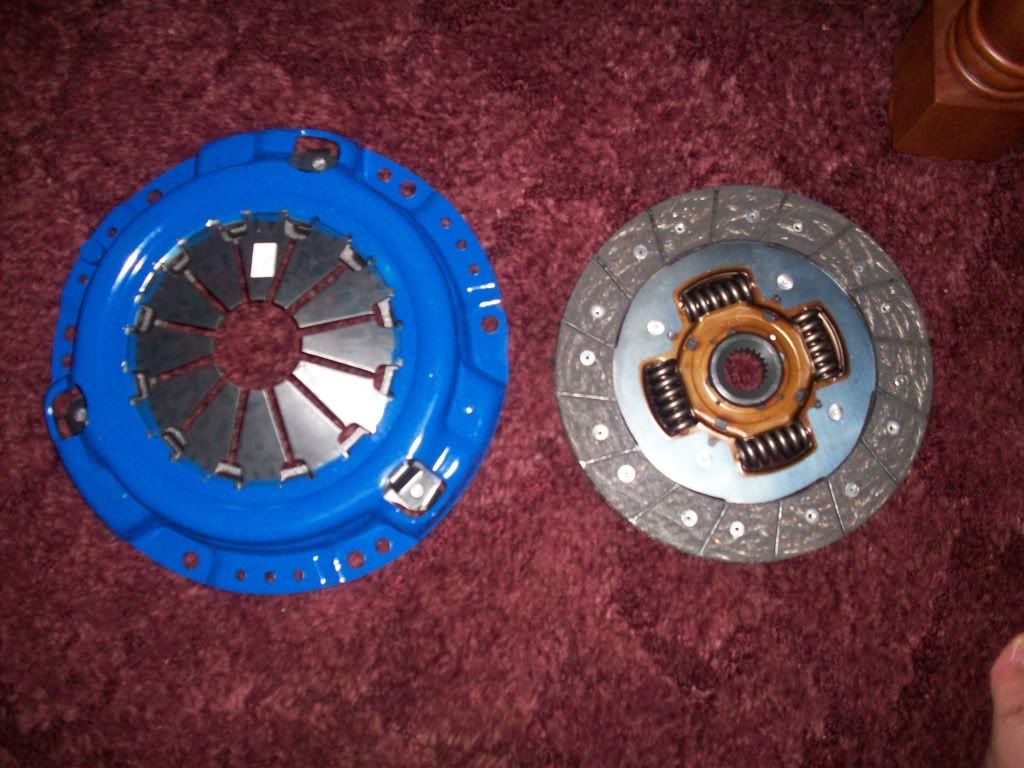

    New F1 Spec Racing Clutch Stage 1 Upgrade.

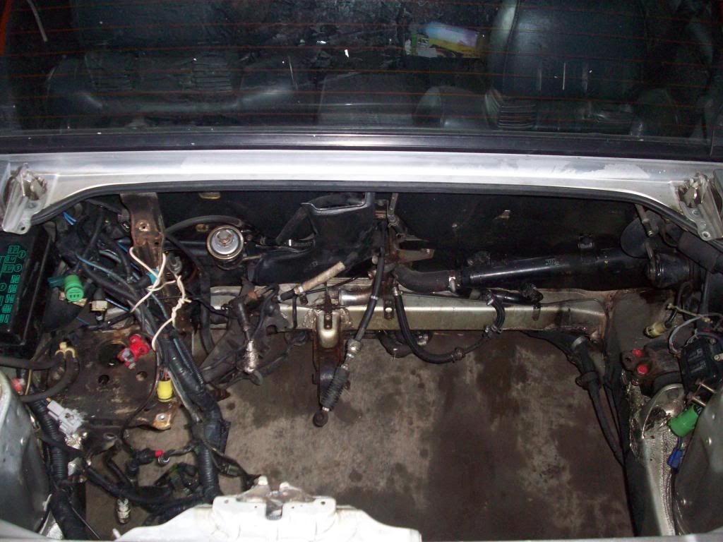

    Nice clean engine bay!!!
    A couple pics of the finished motor.

    Yea it's not quite done. Oil pan was installed for the "rough" pics. Once everything is painted and installed I will be posting more pics.

    Before you waste your time with that F1 spec clutch get something else. IT completely sucked! I had one in my 240 and it was horrbile and it was stage 3 or something.
    Please. lol it will save you time and effort before you put that tranny in the car.
    Certified Gearhead carton30643's Avatar
    Hartwell,GA
    293
    Quote Originally Posted by HachiDori View Post
    Well it's only suppose to be a daily driven car so no hard times on it maybe!!! lol but thanks for the look out.
