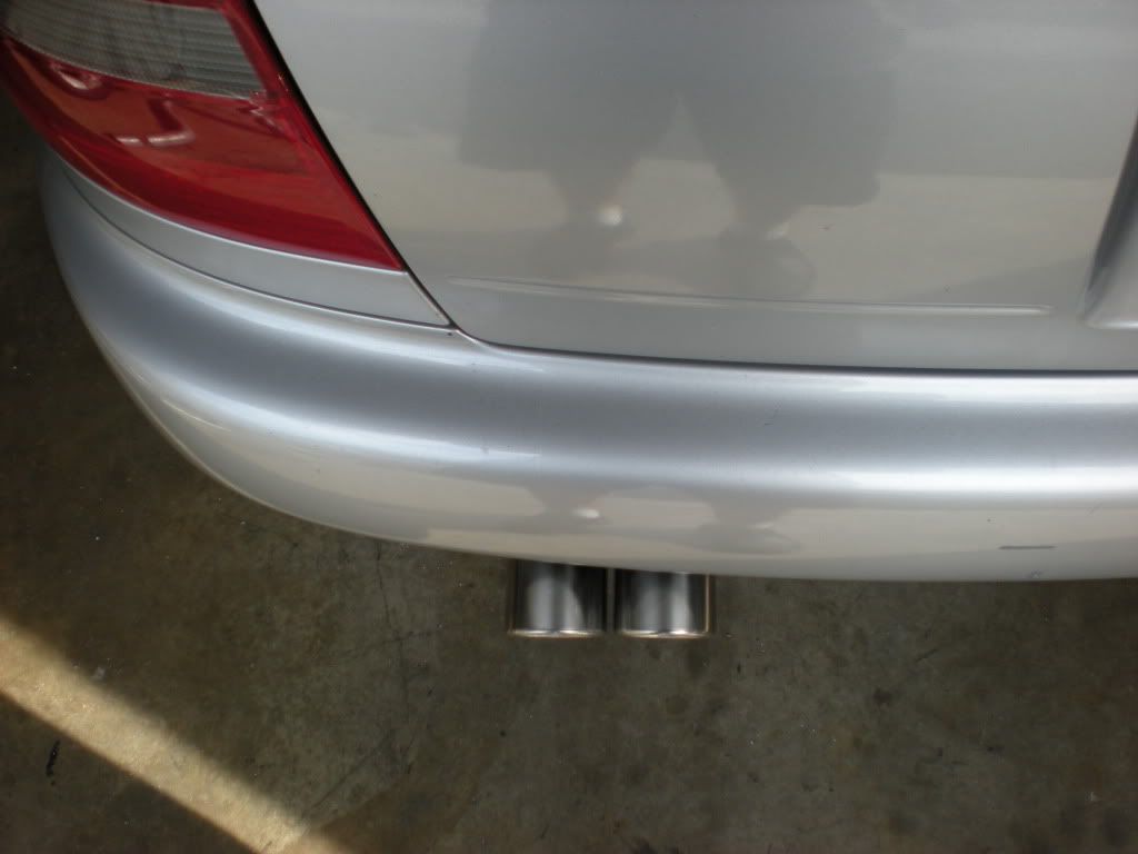

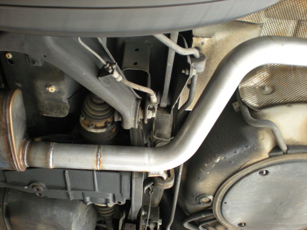

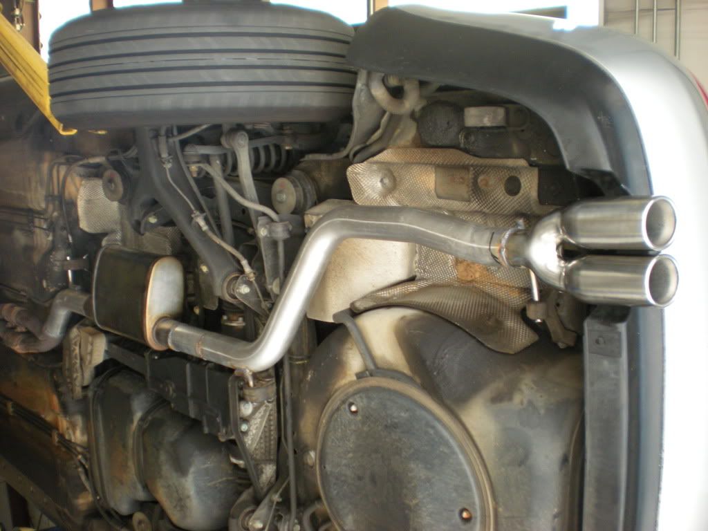

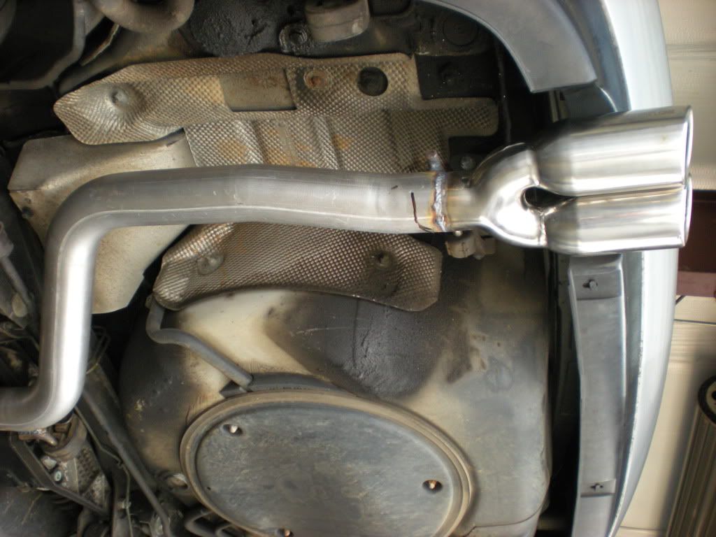

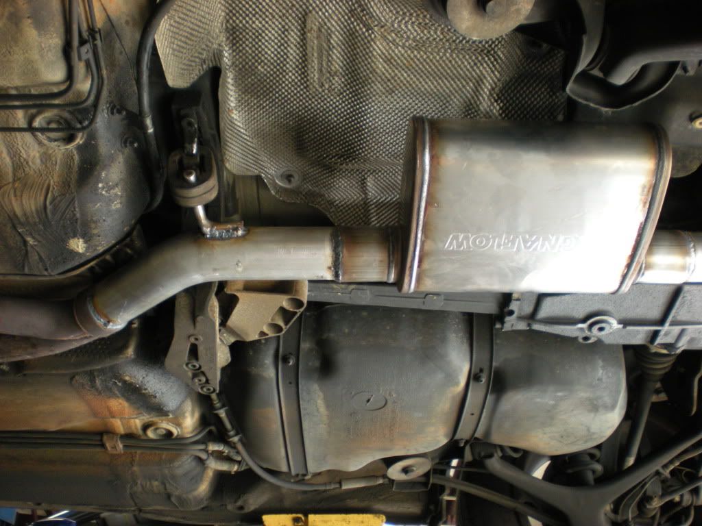

    Built this CAT Back exhaust today on a Audi A4 2.8l V6. Magnaflow 4"x9" oval muffler with the same side offset inlet/outlet. Magnaflow dual layer twin round angled tip. 2.5" exhaust pipe post CAT(s) all the way to tip. This came together really well and thankfully we were able to get all the parts today from our suppliers. Stock exhaust is so rediculously over engineered and it weighed a metric ton! Two mufflers stuffed under that car. We shaved near 15lbs of exahust on that thing. Sounds really really good too, very Euro V6.

    darn should have gone with a magnapack. would have been slightly more expensive, shaved slightly more weight and probably sound a hell of alot better!
    though question why weld the mufflers on, and not do u-bolts or band clamps for easy removal of the exhaust if they ever wanted to change it out or take it off for anything?
    Hand Built Self Made batlbrandon's Avatar
    around
    401
    The CAT outlet pipes are slip joint and go into a "y". I welded on at that point. It seemed to be the easiest and make the most sense. Basically I did it the way the stock set up was.
    Public Enemy #1
    11,300
    Quote Originally Posted by batlbrandon
    so the whole exhaust comes down at the cats then? bet thats a bitch getting off and on!
    around
    401
    yes sir. not too bad if you can get it in one of the hangers first.
