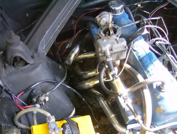

    yeah im reallllly thinking about keeping the 6 in there... and just do mods to it. the engine pulls good and feels good... im not sure im new to this world and half the stuff u all are saying is just flying over my head. before i do anything i need to dive into some books and do alot of research... but i really appreciate all of ur opinions and i hope i can come forward with alot of questions and some are probably going to be stupid... but i mean i have to learn someway or another...

    Idr what i read, did you say it was a V6 or an inline?? If its an inline what motor is it?
    I'm a HUGE fan of the 300. Insane torque out of the motor. For the most part its essentially bullet proof. Built right, a 300 would rip the front wheels right off the ground. You'll get more top end gains with a V8, with more RPM. However you can gear an inline 6 to compensate.
    I've been kind of a ford nut lately. I've been looking to find just about any stang and build a 260 stroker for it.
    Very nice car, makes me wish i still had my (chevy) my 71 nova! I had a 250 inline 6 in it and was quite the beast hooked up to the 2 speed powerslide. I daily drove it for about 6 months before I sold it.
    The 300 is a different engine all together. The architecture is very similar and I think there are some shared parts between the two. But just about everything on the 300 is bigger than the small sixes, especially the block and head. A 300 will NOT fit without a lot of work (its been done before but its a major project).
    The small six family has 144, 170, 200, and 250 displacements. Nearly all inline six Mustangs are 200's from the factory. I think they used the 170 in the '64's and then made the 200 standard in '65.
    The 250 wasn't introduced until the larger body Mustangs came out in '69. The 250 is the same as the 200 except for a taller deck height, longer rods, a different timing set, and a different water pump.
    As far as a comaprrison between the small sixes and the v8's go... there really isn't one, the V8's are just better bang-for-the-buck. If you gear an inline 6 car to match a V8 off the line, you'll just sacrifice top-end and these engines can't breathe all that well up top. I think most guys on the forums reach their torque peaks by 4500.
    They are really similar to diesel engines when it comes to HP/torque curves... gobs of torque down low, but they're not high revvers. The breathing problems come from the integrated head/intake log. The carb just mounts to a log on the side of the head. The runners aren't smooth, and the little 1v carb hole is a bottleneck when using a 2v and a 2/1 adapter. And the stock cam is way too soft.
    You're stuck with a 1 barrel carb unless you run a 2/1 adapter or modify the head to direct-mount a bigger carb (or carbs)
    Do want.
    Edit: the good thing about these motors is the durability. They are just as durable as the 300. That kinda comes with the territory when you have more main bearings in a block than there are bores.
