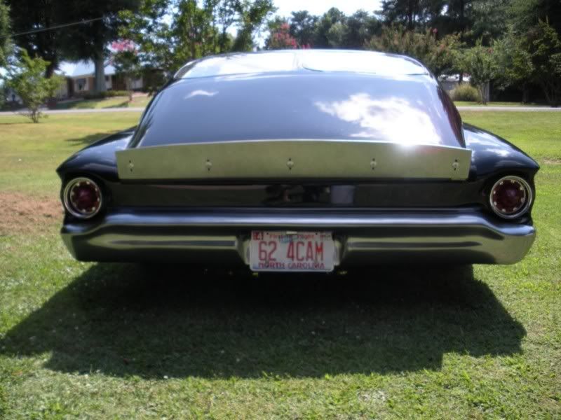

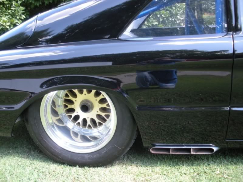

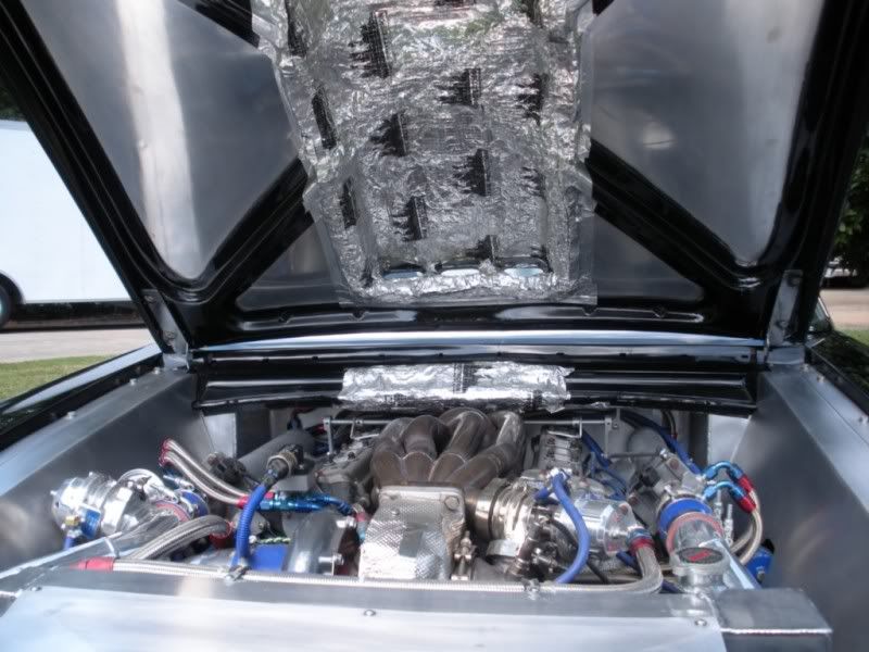

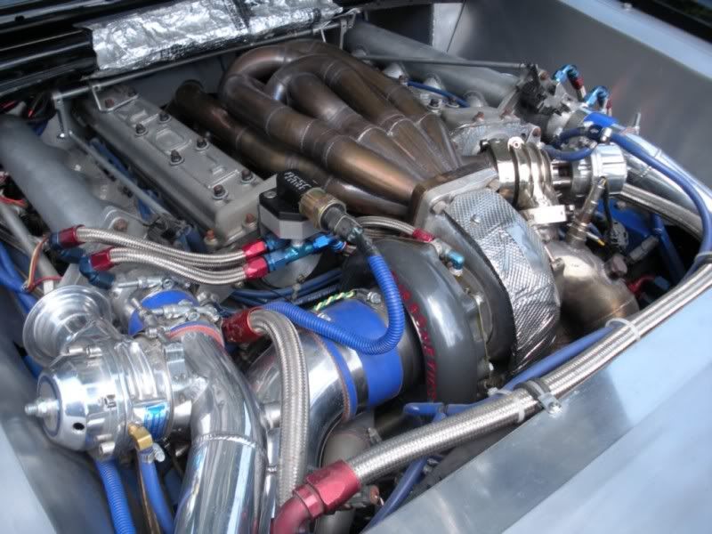

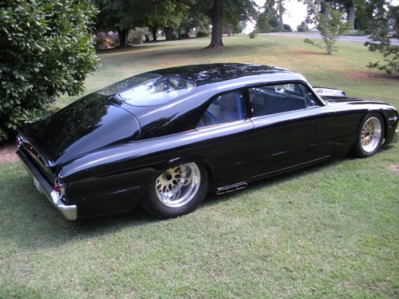

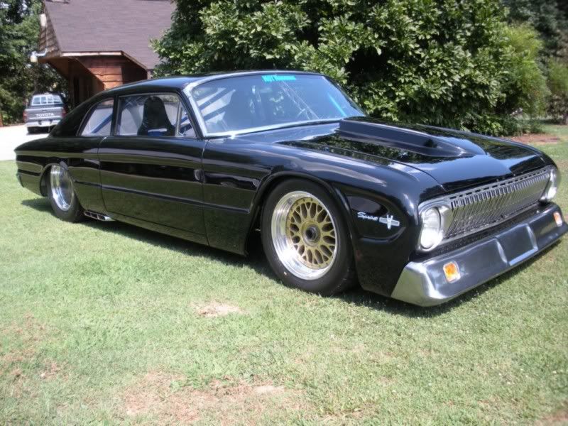

    1962 Ford Falcon. Heres the info on it.
    This car is totally professionally built. It has (no) rust at all. Car has been chemically stripped. It has been sectioned 3 inches, chopped 3 inches and widened 4 inches to get the proper suspension underneath and leave the sides completely straight. (No fender bubbles) It has a complete fastback top which is all handmade with a split rear window. The doors, hood and trunk are all made of aluminum. The underside of the hood and trunk are not painted to show that it is aluminum. Because of the 3 inch section the rear tail light was so large that a smaller 1961 Oldsmobile light was used. The paint is flawless.

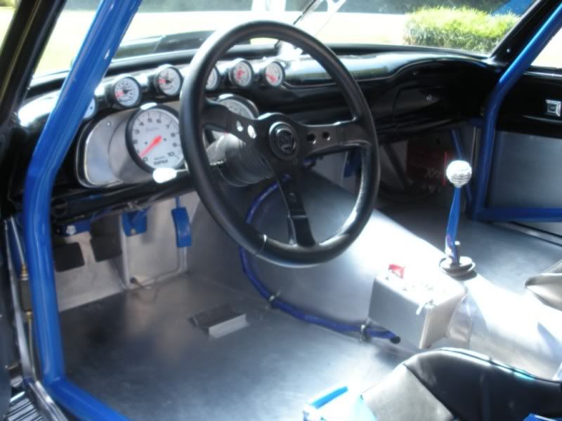

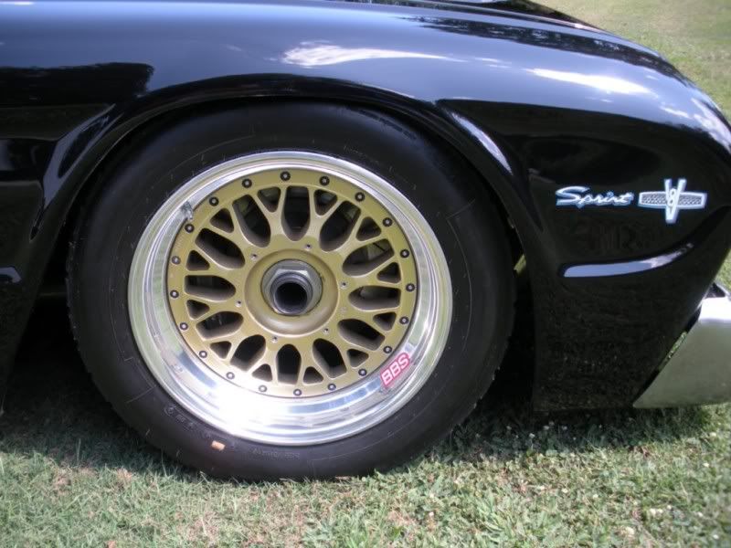

    The chassis is the same as is used in a SCCA Trans am series car. The rear is parallel four link with a watts linkage to center the housing. There is a rear sway bar and coil-over shocks. It has a Gleason locker which is much smoother than a Detroit locker and 4 times as expensive. The rear axle ratio is 3.89. English made Alcon calipers and rotors are used front and rear. The front suspension is all handmade uprights with A-frames, sway bar, and sway bar. Nothing cheap. It has a complete professionally built chassis, with a very intricate roll cage. The wheels are BBS center locks 12 inches up front and 13 inches in the rear. Wheel diameter is 16 inch with B F Goodrich Trans- am rain tires.
    The engine is a complete story in itself. It is an extremely rare 1965 Ford 4 cam Indy engine. This is the same engine used by Mario Andretti and A J Foyt to win the Indy 500. No junk parts are used here. It has a new billet stroked crank with a 3in 130 thousands stroke. The rod journals are Honda 1.888. The rods are Carillo with Carr rod bolts. Diamond pistons are used with Chevy wrist pin size. The compression ratio is 8.3 to 1. Special inconell valves have been made because of the turbo which is a Turbonectics GTK 1000. There is a huge intercooler up front with a CO2 sprayer. It has a FAST computerized system which is laptop tunable. The injection is sequential. When these engines were raced with 159 cubic engines they were app 1000 horsepower in 1980. This engine is 276 cubic inches and with a much improved injection system and turbo. Actually I do not know the power because I haven't put it on a chassis dyno. It is either stainless or ceramic coated exhaust depending on where it is at. The transmission is a Tremac TKO 5 speed. It is quite possible it could be the world’s fastest street car, I don't know. The top of the roof is 47 inches tall and very aerodynamic. It is not a cheap car but should be in someone’s showroom. It really draws attention. In December 2008 issue of Popular Hot Rodding it is the featured car with an 8 page story and can be viewed under feature cars at http://www.popularhotrodding.com/fea...con/index.html
    Now the Photos.

    man if it would not have been for the motor shot, that thing would be rice! :idb:

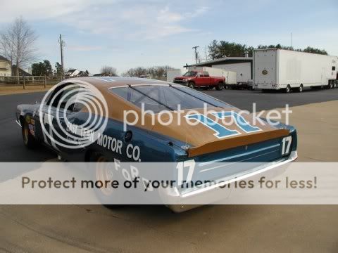

    Not really. Looks like a 1968 Holdman Moody Torino Nascar. (Back when Nascar was great)

    That engine bay actually made me say out loud "damn"
    9,195
    x2
    That's a deadly mean looking car...and look at that MANIFOLD!

    what motor is this ive never seen anything like it?
    3,741
    Quote Originally Posted by 08turb@x
    It is an extremely rare 1965 Ford 4 cam Indy engine. This is the same engine used by Mario Andretti and A J Foyt to win the Indy 500. No junk parts are used here. It has a new billet stroked crank with a 3in 130 thousands stroke. The rod journals are HONDA 1.888

    Freaking manifold is crazy, sick car

    Holy huge turbo batman!

    thats 1 crazy fucken lookin manifold lol
