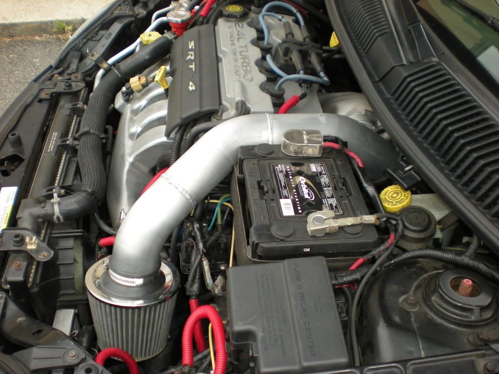

    We had a customer come in with a boost leaking SRT-4. After modifying or replacing all of the intercooler pipes and couplers he decided he would like to get rid of the stock air box. I made him a 3" aluminum 1 piece intake. This intake will install on your stock turbo equipped car. After market turbo set ups will be custom made to fit. Comes with the intake pipe, K&N filter, and silicone elbow coupler.

    looks good, nice beads, but that ain't no k&n filter

    Customer supplied that. We will put whatever filter you want but standard issue is K&N.
    And for no extra charge we will add a bunch of red wire loom in random places!!!!

    lol! That's one clusterfuck of an engine bay...wires and vacuum lines everywhere! *sigh*

    what is that pipe made of? or is it coated? my IC pipe looks like its made/coated with the same stuff.

    Its aluminum they just brushed it to get that finish

    yeah raw aluminum with some scotchbrite "brushing".
    We are selling that unit for $200 with the Filter and coupler. I think $125 is pretty fair for just the pipe. It could vary depending on application too.
    If you would like one for an after market turbo set up the price shouldn't change unless more materials are needed.
    If you would like a 3.5" or 4" the stock battery location is going to cause a fitment problem. anything like that is going to be a per hour job.

    lol @ the walmart positive terminal on the battery
    not a bad intake

    Nice fab work but I didn't see where it is mounted or does it just kinda float there. Also, is he getting a catch can or is the valve cover breather just an open hose.

    It does float although there is a natural "rest" there. I don't know if he is planning on getting a catch can or not. One would be nice, maybe we will fab him one of those too.

    looks good! what about a cai?

    There is room for it to go further down but it would be a little extra. Depending on how far down then we would have to look at a by-pass valve.

    this sounds good to me. the heat that comes off that engine sucks. i would like to get away from that heat soak that you get from a short ram. just an idea.

    wheres the heatshield? where does the air come from (besides the hot engine bay). its great fab work, a good looking piece, but other than an increase in flow, its almost pointless if its just pulling engine bay temp air. More hot air is not better than less cool air. i think a heatshield at least, if not some small funnel to direct outside air toward the filter. For a simple intake its great, but lacking a little on the technical side.
    so, no hating, just sharing my opinion.
    also, i wish i could weld aluminum

    I guess the point would be to free up some intake flow instead of using the super restrictive stock air box. The stock air box has a cold air duct and it stays in place to direct cool air to the new filter. The car did pick up some power over the stock set up but it is a basically stock car.
