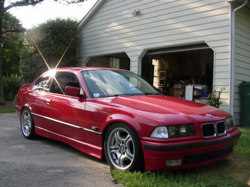

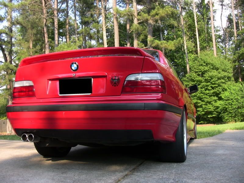

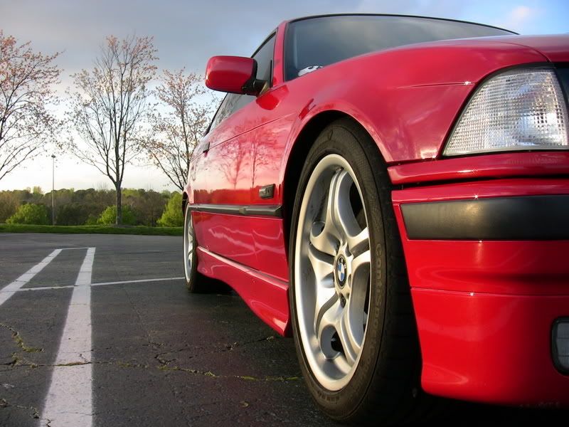

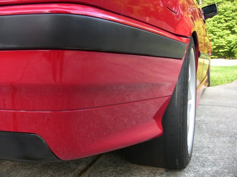

    PICS! I just put some 8mm spacers on my rear wheels. The M68s were 17x8.5 et50 rear, but now they are et42, exactly like M-Contours and DS2s. I was amazed how much a simple offset adjustment changed the car.
    BEFORE:
    AFTER:
    Yes, I need new tires. They are in the mail.
    Sorry about the shyte quality, they were taken with my camcorder. Anyway, this is as far as I can push them out without fender work. They rub a bit on big bumps.

    Looking good! And yes those tires look dangerous hah
    140
    GET SOME 15MM..AND REWORK THE FENDERS...BUT AS IT IS NOW, ITS PRETTY NICE MAN

    i hope you have some better than disc spacers? or have some extended lugs for those..dont compromise safety!

    they are most likely slip on spacers. he should be alright with a 7mm.

    and from what I can see, you are still running blots. Change over to long lug studs or your gonna lose a wheel...and fender, and bumper...
