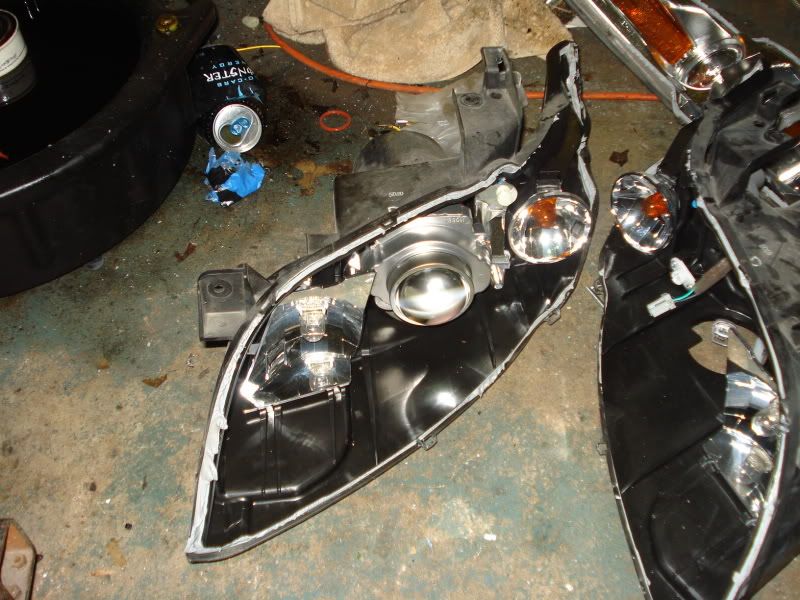

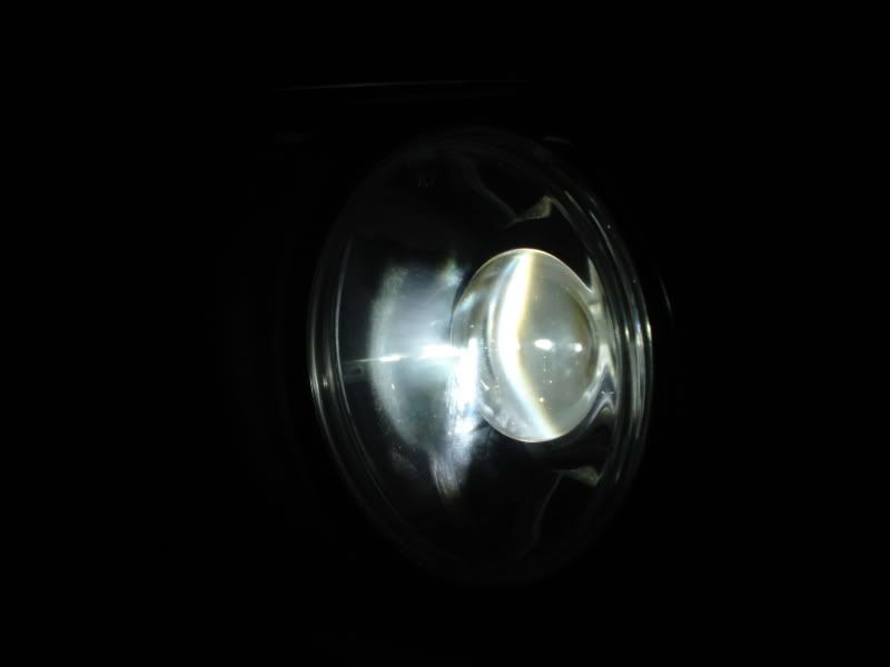

    well we start off with a set of fx 35 bixenon projectors..
    screw the sealed beam halogen bung hole glass thingys... went out purchased some gangsta "spot lights" from autozone....

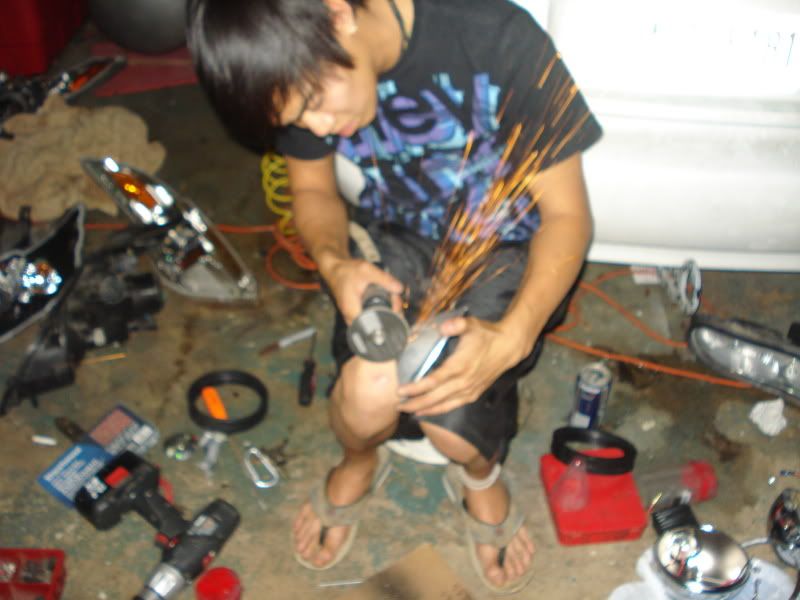

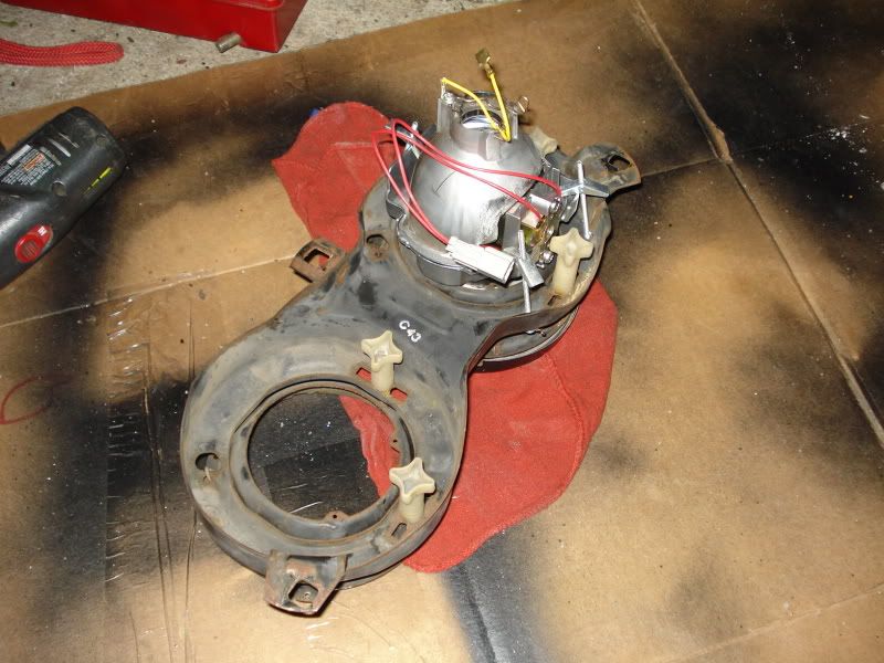

    me cutting the thing apart so the projector can go through...
    and then the projector in the back of the headlight assembly...

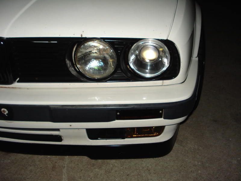

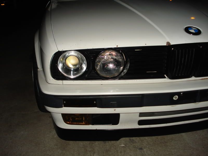

    then the finished product! tada....with the electronic flap functional as the brights.. I love haters...

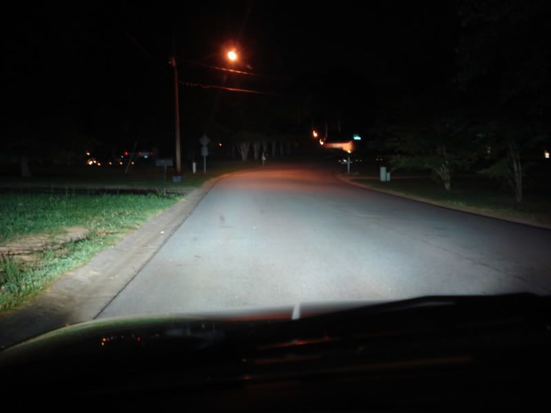

    the low beams in the car...
    high beams in the car...

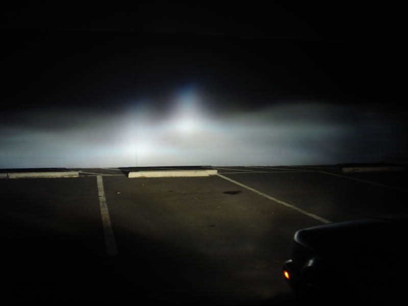

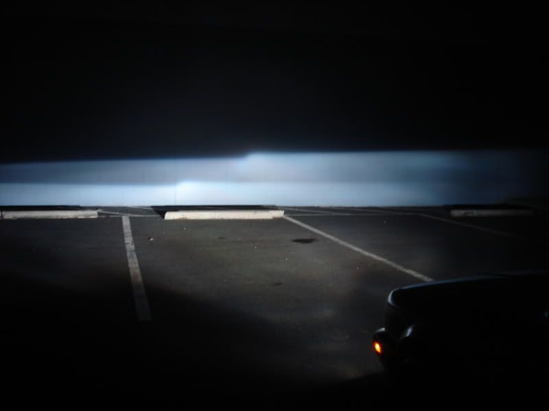

    low beams outside the car...
    high beams outside the car...

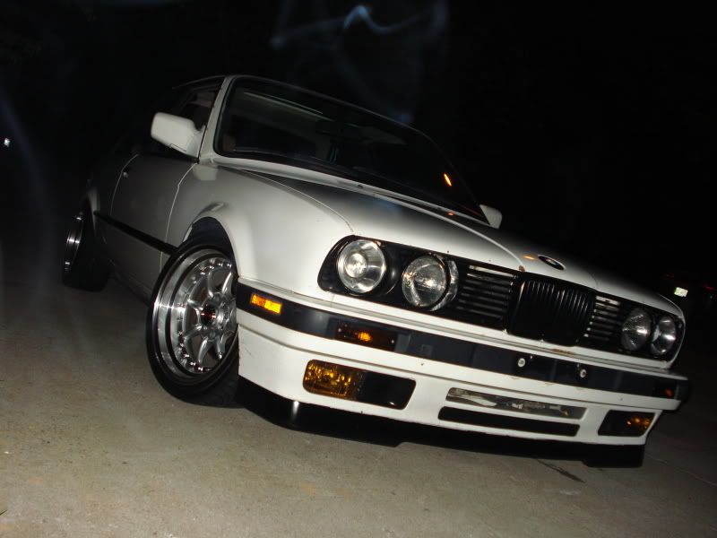

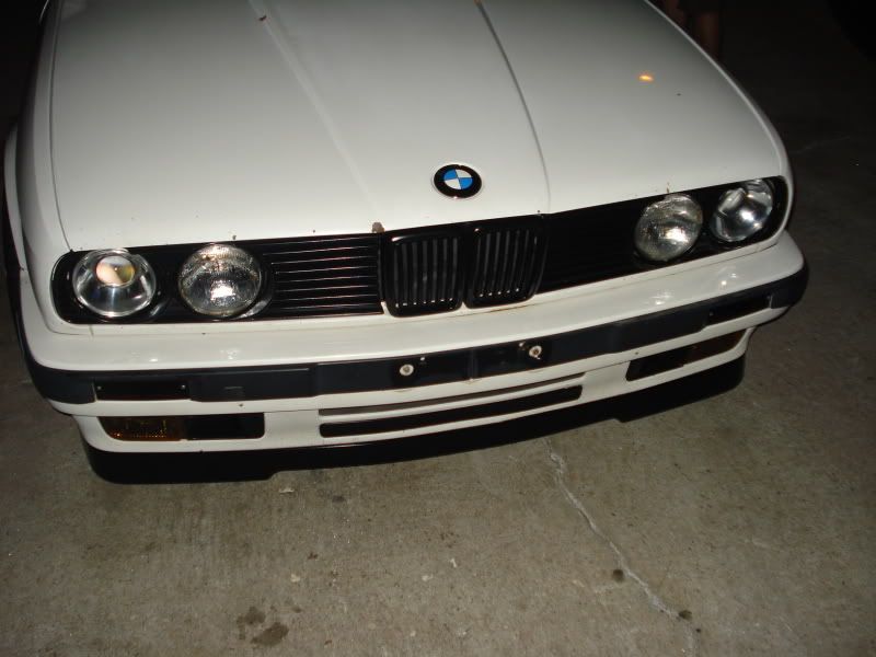

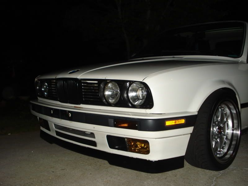

    and the whole car...

    no it's not a hi lo kit.... it's bixenon... the cut off line is a mechanical flap that when you hit the "brights" the flap opens to allow more light... you can tell a big difference when you're in the car...

    no.. it's one ballast one bulb and one flap in each projector....they're mercedes stock bixenon kit..

    Looks good although you really need to align them!

    safety is not your strong point.. metal flying and no glasses.. smooth..,

    I hope you're going to aim them, because the current pattern looks awful against that wall.
