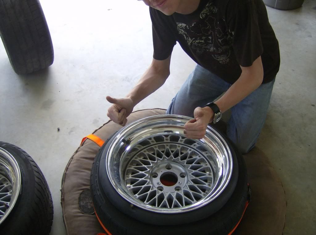

    My cousin and I were having a hell of a time getting the 225/45/17 on the 10.5. We were using a ratchet strap and starter fluid Too much stretch, and not enough bead shelf for it to work though
    I ended up taking it to a place near my house I had never been before. The guys were super cool about it and there were actually 4 people working at getting them mounted
    Starter fluid was a no-go. Then the cheetah was a no-go as well. Then an old guy came over from next door where they mount tractor tires. He used Murphy's oil soap around the open bead while giving it air through the valveless stem. The cheetah worked that time

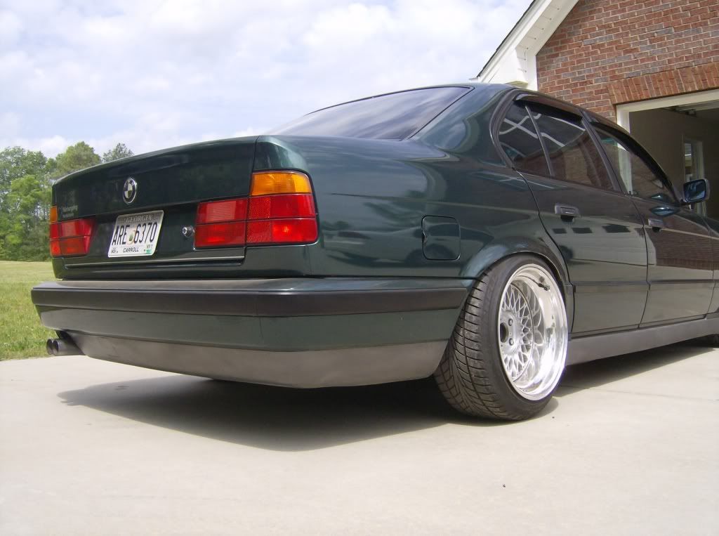

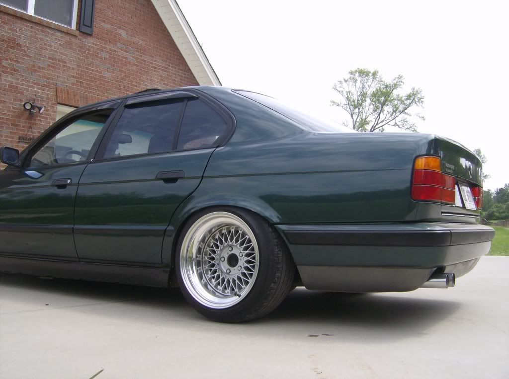

    Here is the stock 15x7 on full drop.
    And now.....
    The money shot

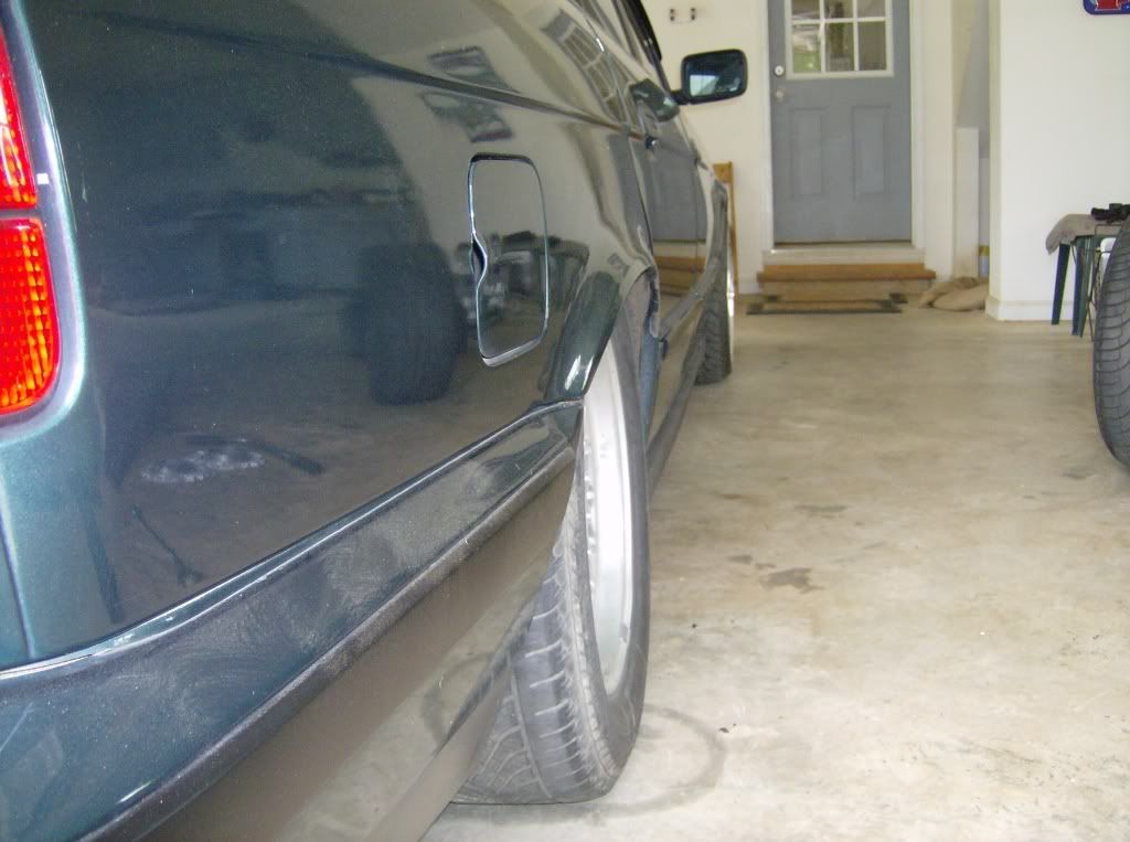

    my god thats low.....Had any problems with the oil pan contacting anything?
