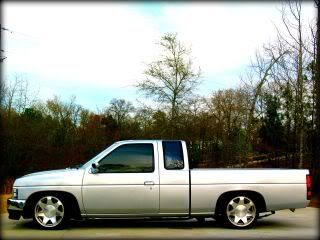

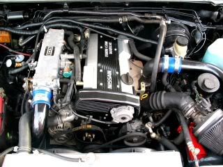

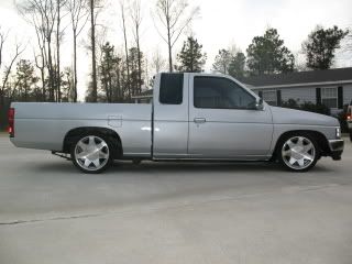

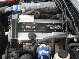

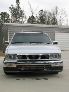

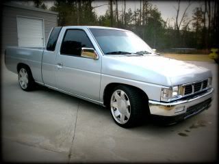

    Ok guys i figured i'd post up some pics of my Nissan pickup. I just about done with it so far.
    1997 Nissan D21 Hardbody Pickup
    Mods: Lowered 4 inches all the way around, cadillac escalade 17 inch wheels, LED tail lights, shaved tailgate handle and antenna, 92-95 Toyota 4x4 pickup front bumper and valence. With new paint, painted by me this is my very first paint job doing all the work by myself.
    Oh and the most important CA18DET 180sx Silvia swap.
    I know you guys may say why not the SR20DET swap? To many people has done them i wanted to do something different.
    In a couple of months i'm going to install a new rear end out of a nissan 4x4 that has LSD and a gear ratio that better for the CA swap and a T3/T4 top mount turbo set up, 550cc injectors, N60 MAFS, light weight flywheel and stage 3 clutch. Hopeing to get around 250-300whp out of her.

    wow thats pretty badass.... first hardbody ive seen with a ca18
    926
    Sick. Absolute sickness. Clean and purpose built, the two most important thing.
    Kevin
    Warner robins ,Ga
    2,619
    thats badass. werent expecting the CA at all...
    WillAgreeForReps!!
    The Town of Lula
    2,111
    very nice. when i heard caddy wheels i expected it to be layin out tho haha
    1.5T AnTi-PooN's Avatar
    L'villE
    3,124
    cant burn much rubber with those tires lol
    Hamilton, GA
    5,051
    Very nice!!
    I keep it real. AFSil80's Avatar
    Mar 2004
    Savannah
    1,986
    Still my favorite hardbody of all time. GOD I love this truck.
    Lemme know when you get that rear end in there! That thing is gonna outrun my 240 if I don't step my game up.
    -91 240SX -- CA18 Power...SOLD, now terrorizing the streets of Alabama
    ccw replicas
    kennesaw
    4,355
    very nice sir
    HF
    YoTa_BaNgEr YoTa_BoX's Avatar
    Dec 2003
    In a Yota
    1,919
    although it is a good looking truck...its not low enough
    Life is a thought, think about it.
    the land of race car ya-yas.
    21,339
    57
    jk.
    nice truck, man.

    that is very nice man, nice to see another static dropped engine swapper here although i'm not engine swapped as of yet. reps
    how much HP you have now? and how is it keeping the tires connected to the ground lol. i was wondering this so when i swap the 1jz in my toyota p/u
    Byron, GA
    485
    Thanks everybody for the props.
    Right now everything is stock. It gets a nasty wheel (one wheel pill LOL) first and second after that it's a little slunggish because of the 3.5 rear end ratio. Did some homework and found out that the cars that came with CA's had a 4.3 rear end ratio from the factory.
    So i did some digging and found out that a nissan 4x4 V6 5 speed has a 4.3 ratio rear end and has LSD. So i found one last week in a pick n pull and picked it up for da $60 bux! After putting in the rear end and putting the t3/t4 turbo set up on it and getting it tuned hopefully looking to get 250-300whp at of it with about 15psi of boost. I think that would be good enough for DD with p/s and a/c.
