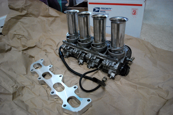

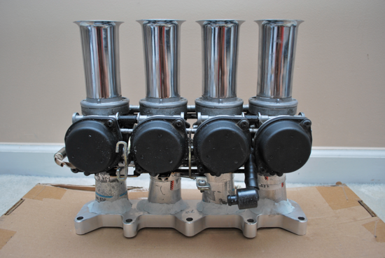

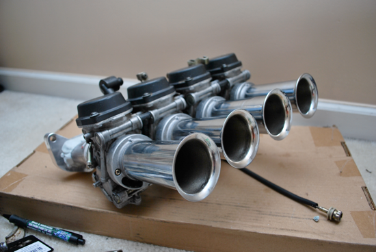

    btw, its a Yamaha R1 bike carbs

    not a whole lot. most are stock internals. the itbs should give a serious response. from what i read on Club4ag, bike carbs has more response than Weber dual carbs

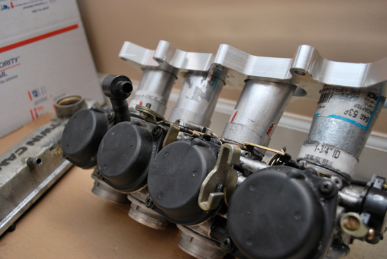

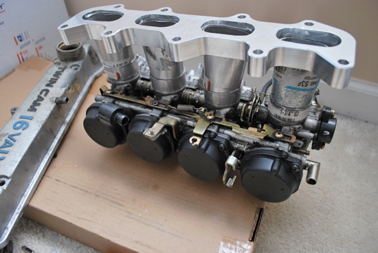

    just got done custom making a manifold. time for Mighty Putty! RIP Billy Mays..

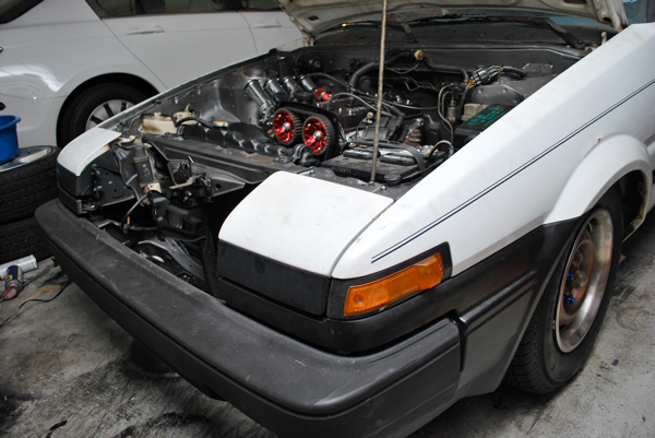

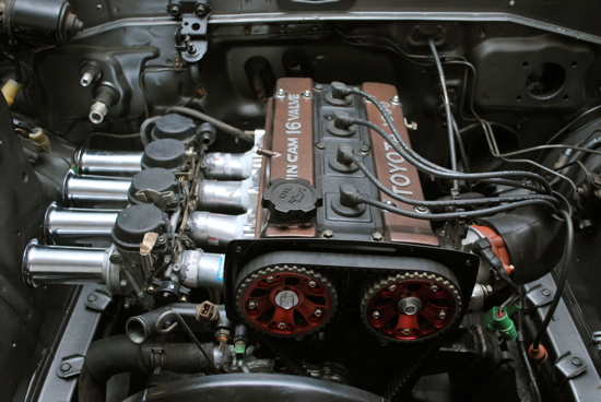

    just got done with the carburetor setup.
  12. #132
    ifureadthisurgay imbatman's Avatar
    Stockbridge, Ga.
    936
    what u guys think
  13. #133
    homie dont play that
    4,794
    wow very creative i like

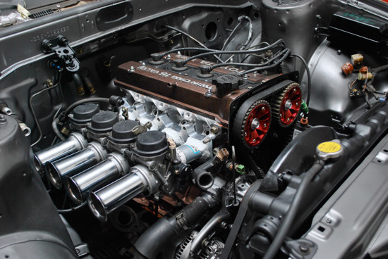

    after months of painstaking work and literally blood, sweat, and tears, i am proud to announce that its back from the dead!
    http://www.youtube.com/watch?v=IFB3J...layer_embedded

    I am assuming the vacuum leak is causing it to spit back out the carbs? Anywho.. The project looks like a nice one. I am not digging the smooth wheels in that one photo but its a clean start.

    yeah, it has vaccuum leak. i havent hooked the brake assist up, intake manifold isnt torqued down yet and stuff. just a test run to see that things r working.
    im putting the bronze supra celica wheels back in. i will put those MK1 knock offs on my next project: mx73 cressida

    damn man its come a long way and lol at mighty puddy but hey it works. couldnt find anybody to weld the intake for you?

    i could have but not right now. the intake manifold is just a prototype for now. ill get a better version of intake later on after breaking it in... and it will be welded this time

    its running perfect NOW!!!!!!!!!!!!!!!!!!!!
    before(on the video i posted above) the engine would revv so damn slow and wouldnt even reach 2000 rpm. my friend Nhan and i messed with the distirbutor, changed the timing and..........KABOOM!!!!

    i told you that the 4ac distributor needed vaccum supply for vaccum ignition advance.

    john, thanks man. it was the same problem when u tuned the timing for my 1st corolla hatch, timing was way off. i couldve never done it with out u. u should come by and check the car out. the R1 carbs sounds so SICK!
