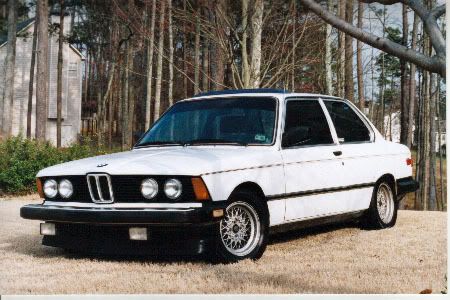

    Quote Originally Posted by StraightSix
    Be careful. There aren't that many wheels that will fit an E21 chassis. The offset on the original wheels was 13mm. That was for both the factory turbine wheels and the sport package basket weaves. The offset is nowhere close to an E30. You have to go with something that has a low positive offset, since the car's brake system is set up like an old school RWD car. Later model RWD drive cars typically still have front brakes that are similar in design to FWD cars.
    E30 bottle caps will fit, but look...meh, at best, imo. The E30 basket weaves won't fit, iirc. Keeping 13" wheels on the car while a nice try to keep it closer to original yields really crappy tire choices. A 15" wheel will yield better performance and much better tire choices.
    Oh, and that pic is of an E21 315 or 316, not a 320i.
    I see. Yeah, I didn't think about the brakes. Now, I'm leaning more towards the 15s. I have always like the smaller wheels, for better gear ratios [Thanks Dave]. But you're right about the picture. I've updated the OP with the actual car. Thanks for the input. With the 15s, if it's dropped low enough, we can always roll and maybe pull the fenders.
    Are you joking? Do you know how long Panasports have been around? Later, QD.

    Seeing a pic of the actual car, now, I've changed my recommendation.
    Lower the car, keep the those 13s and put some 205/60/13 rubber on them. The size is tough to find, but there are some out there. They are lighter than any larger wheel. Here's pics of my old E21, the wheels on it are 14s, though. Mine was on Suspension Techniques springs and Bilstein sports.
    E30 basket weaves just don't look right on E21s. The face is too flat for the styling of the car.
