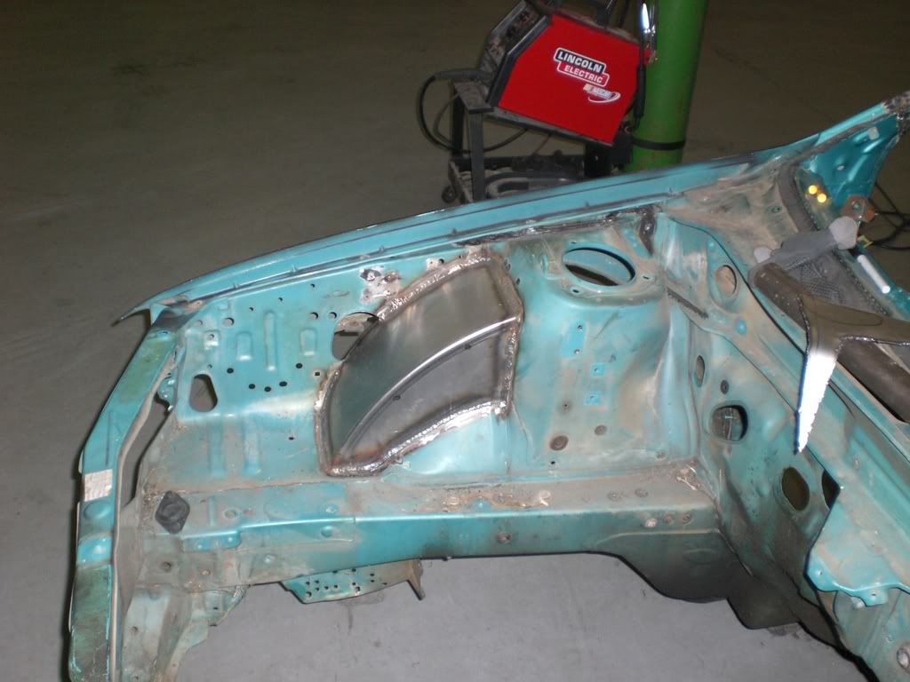

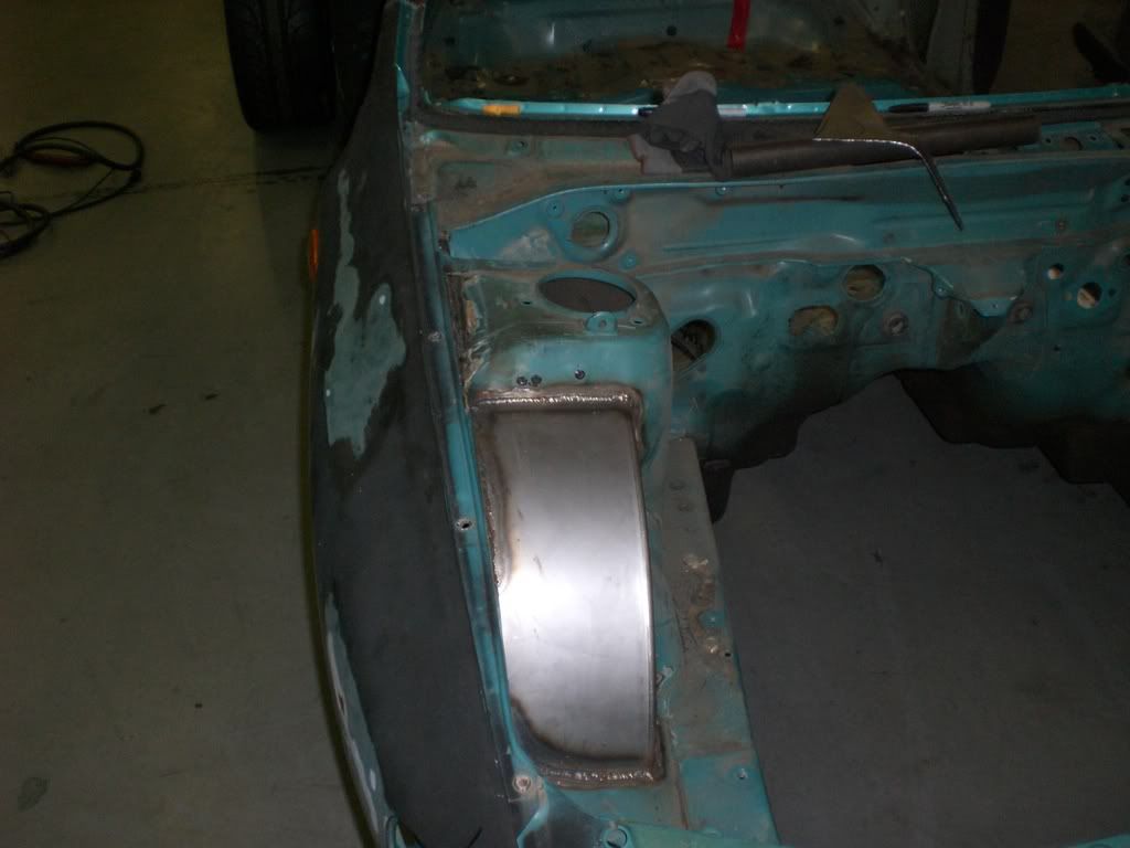

    1/05/09 Update: Here are a couple pictures of the front passenger wheel well. I have extended it up and out by about 3". This will give me the clearance needed to run the car lower.

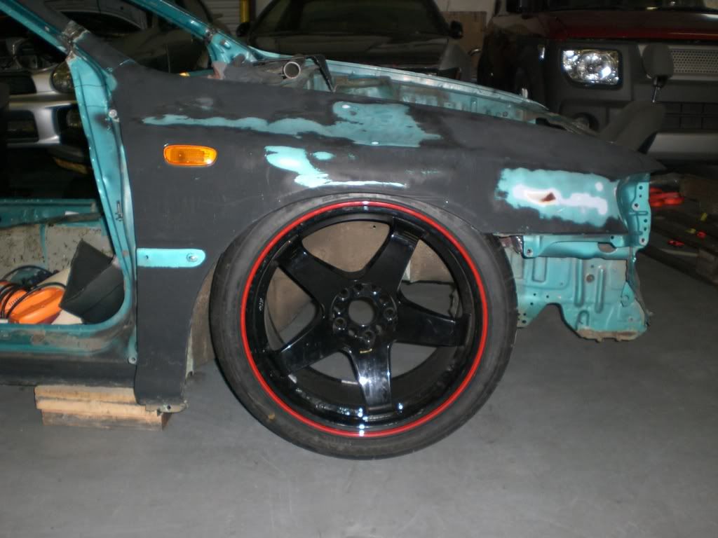

    This last picture is with the wheel sitting inside the fender. This should be about the final ride height once everything is done.

    The arch "tubbing" looks a bit small, how come you guys didn't extend it out to the end of the shock tunnel? Also, will there be any issues with tire clearance if the car is in full lock??

    Quote Originally Posted by dappsta
    They don't need to be any larger towards the center than what we have them at now. There is plenty of room on the inside. Our main issue was with he car sitting low it would rub the top side of the tire. The new tubs have raised the wheel well up about 4" giving us plenty or suspension travel and wheel clearance now.
    Understandable. I guess i was more looking at it from an aesthetic POV, however, it still looks great! and the welds are excellent, i can't wait to see the finished product
