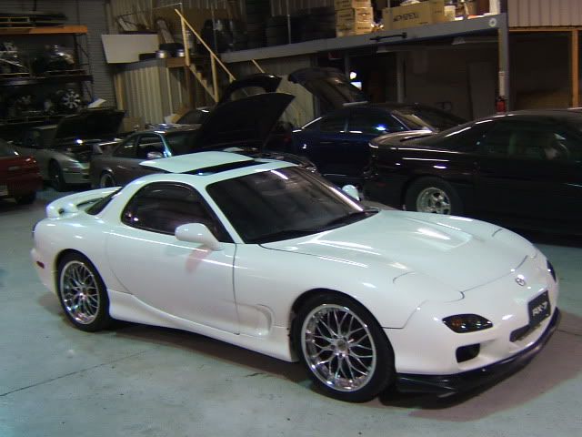

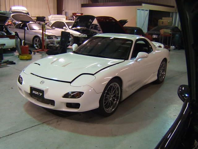

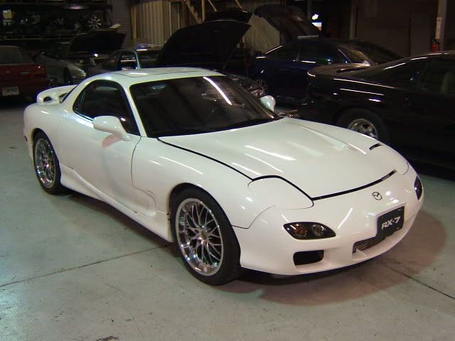

    My brother purchased this White 1994 FD Touring Edition with a couple goodies like some Reeeiiiims, Tein Coil Over's all the way around /w other adjustable suspension pieces , a Turbonetics 62-1 turbo, Greddy Profec-b Spec 2 EBC, Apexi Power FC, 3" Racing beat exhaust, TurboSmart 45mm External Wastegate, Aeromotive FPR /w bigger secondaries and a custom Fuel Rail, GReddy FMIC, Fluidyne Aluminum Radiator, 99 front bumper, 99 rear tail lights, a gay ass HKS SSQV BOV, and some ricey pillar guages and a couple other at least it's better than stock goodies.
    Although it's not the rare yellow or anything like that you don't see many white FD rx7's.

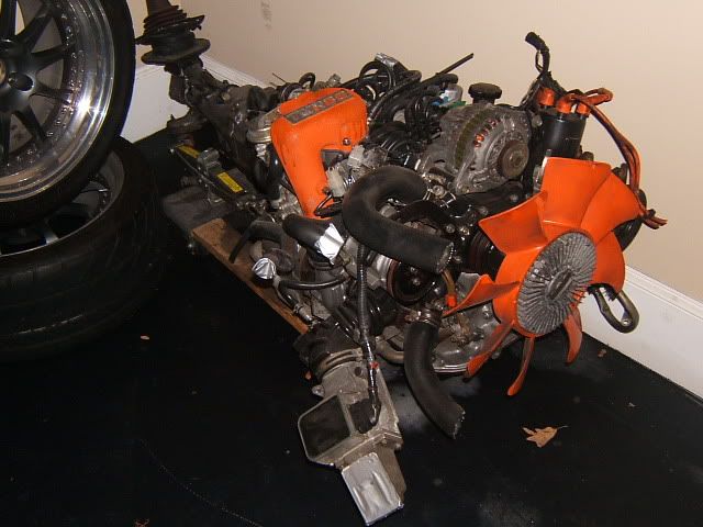

    here's the 13b-RE sitting in the 1994 FD engine bay. i know u like that football gasket i made

    his turbonetics 62-1 before i cleaned it
    and after. btw they have a 62mm inducer and 88mm exducer for the compressor wheel (in case u wondered, i measured it while i had it off). In retrospect a GT35R has a 61mm inducer to give you and idea of the size, too small for a rotary in my opinion.

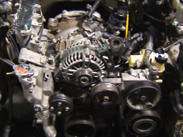

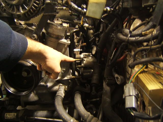

    i got the REW accessory bracket to bolt up by simply removing the top stud on the RE's timing cover. that was an easy one.

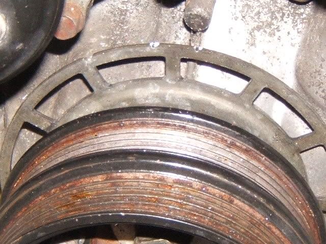

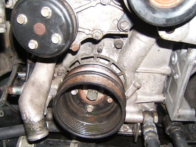

    then i put the REW's crank pulley's on
    after i made the RE's timing marks into it, like so

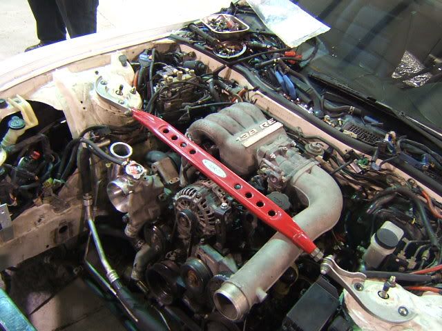

    so now the motor looks something like this

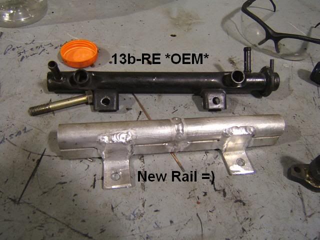

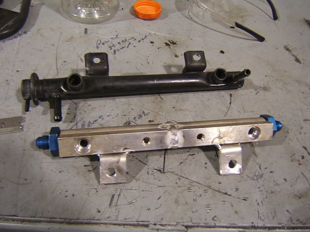

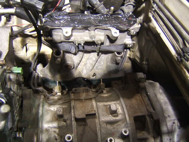

    since the car has an aeromotive FPR and bigger secondaries it was time to get rid of the g4y stocker crap. we had to mod the fuel rail from the REW and make it about an inch shorter and give it some mounting tabs, like so
    and
    once that was taken care of, i bolted up the shiney turbo and ran into an issue with the plumbing, ie the oil return flange where it meets the motor and also the return hose just didn't reach so i needed a new longer piece of -10 steel braided hose. the 2 bolt flange on the front of the motor on the REW has the holes close to each other where as the RE's are farther apart. so we made a flange and welded a -10 steel fitting to it, voila

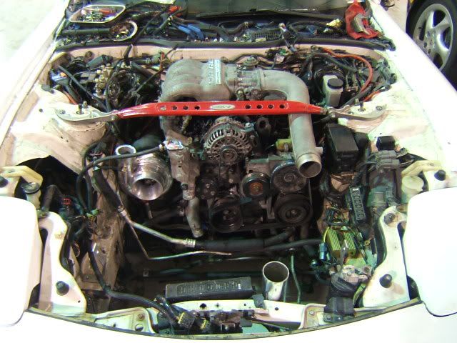

    here's a pic of the REW's IAT in the RE upper intake
    here's today's progress
    and
    the next 2 days i'll be cleaning up the wiring harness and making it sexy, then the Amazing Kyle's gonna freshen up aka throw the previous intercooler piping in the trash cause it looked like crap before. i'll post pics tomorrow.
    we still gotta strap this puppy to the dyno and tune the power FC =]

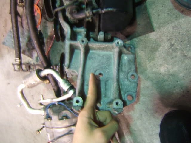

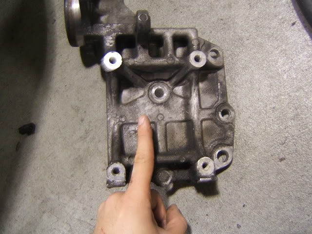

    here's the 13b-RE accessory bracket with my finger as the ruler. pay attention to the hole by the tip of my finger
    here's the 13b-REW accessory bracket. notice the top hole is farther up
    here's the stud you remove from the RE's timing cover to use the REW's bracket

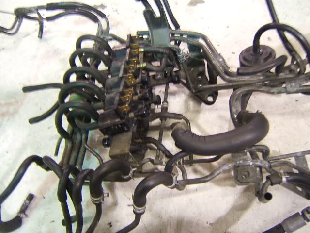

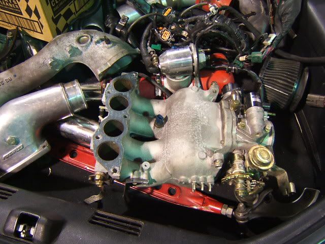

    this is what rx7 guys refer to as the "rats nest." it's what it uses to operate the twin turbo's sequentially.
    you get to delete all this crap when you get rid of the stock sequential twin turbo set up and either run the twins together or go single turbo. luckily we have the single 62-1
    here's how the motor looks without the rats nest under the upper intake. you can see just how clean this RE motor is by seeing how nice the stock Oil metering lines are if you look closely

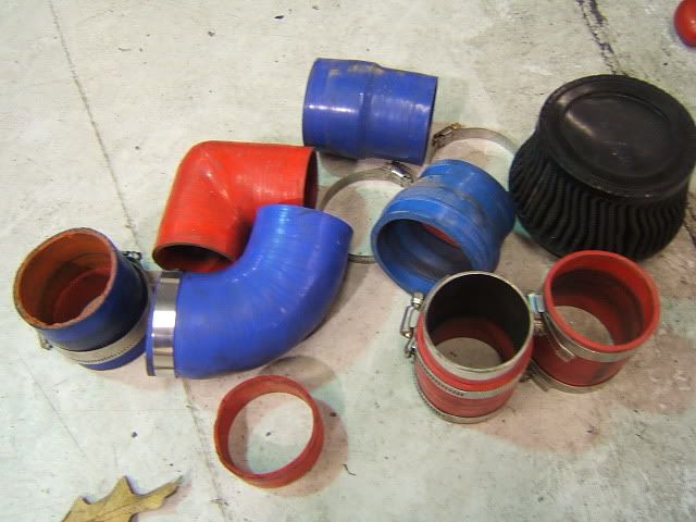

    here's the uber restrictive brick wall 90 degree coupler and where it was sitting that definately HAD TO GO
    here's all the other couplers it had. those going in the trash too. aside from there being too damn many of them, some were dry rotted and cracking

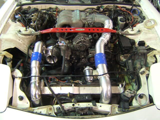

    and Kyle's sexy new and improved piping that fits under the hood support rod (unlike before) as well as the cold side which snakes nicely under the strut bar, along with upgraded 3 ply couplers instead of 1 or zero ply it had before
    and a side shot

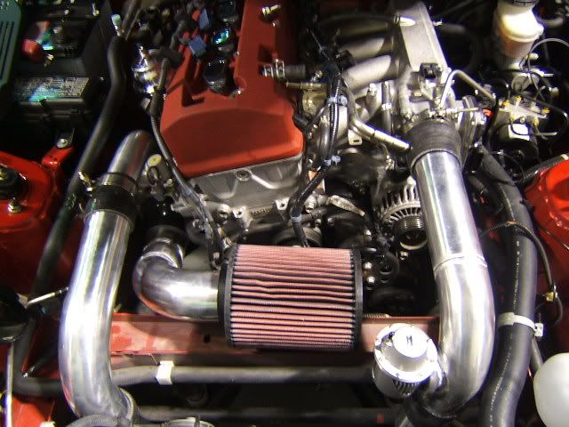

    this is the GT30/76R s2000 stuff we're almost finished with at the shop
    and a close up of the manifold
    here's the fmic piping Kyle made

    here's some more pics with the cowled fiberglass hood (the hood is popped btw)
    and the other side
    and she lives

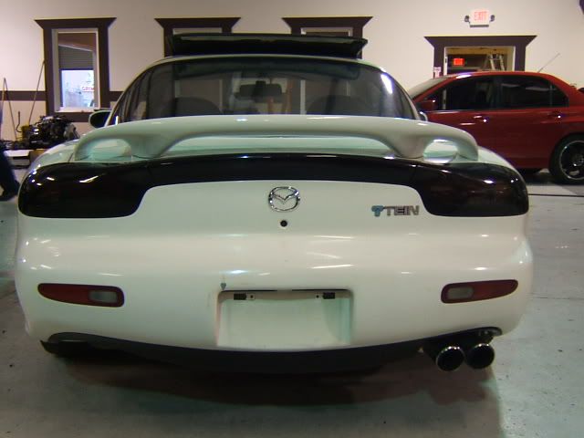

    I like the New mazda emblem's and the Tein Badge

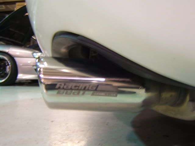

    Racing Beat Exhaust is gangsta as hell, looks stock and sounds good
    here ya go Mikey
    and
    i like this one the best
    but pick which one u like more i guess, looks way better with the front lip
