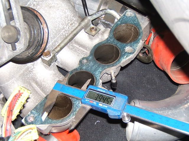

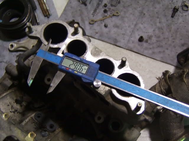

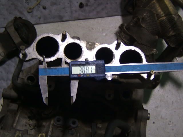

    here's the measurement in MM of the bigger ports on the 13B-REW (don't write the measurement in stone but it's pretty close)
    here's the measurement of the smaller REW ports
    here's the measurement of all the ports on a 13b-RE

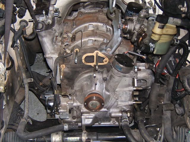

    here's the 13b-RE sitting in the 1994 FD engine bay. i know u like that football gasket i made

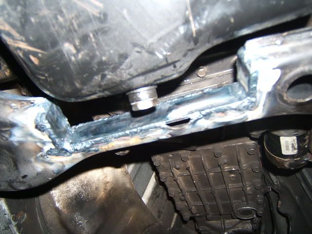

    here's the crossmember modification so the 13b-RE's oil pan didn't hit the subframe

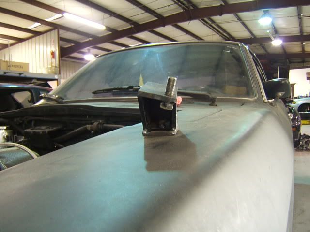

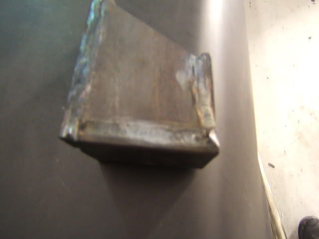

    here's one of the motor mounts you'll need to put a 13b-RE into your FD. pay no attention to the sexy 280z it's resting upon
    another pic of the mount
    a closer shot of the mount

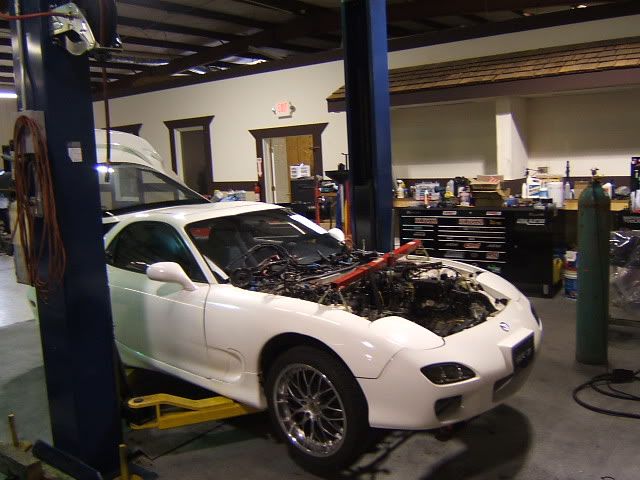

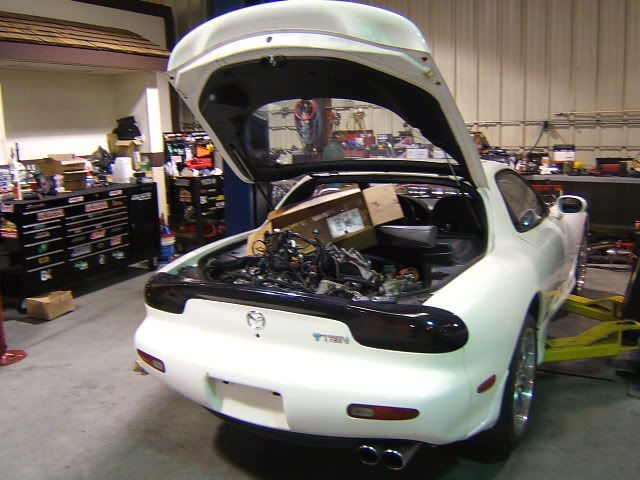

    a pic of the FD on the lift
    and another, nice tail lights, and on the left is my new tool box , had to label all the drawers with stickers so when someone needs something i can tell them which drawer it's in. (sometimes it sux having the good tools, everyone except you is always using em >_<)

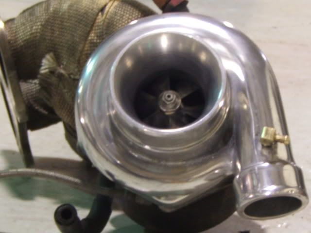

    his turbonetics 62-1 before i cleaned it
    and after. btw they have a 62mm inducer and 88mm exducer for the compressor wheel (in case u wondered, i measured it while i had it off). In retrospect a GT35R has a 61mm inducer to give you and idea of the size, too small for a rotary in my opinion.

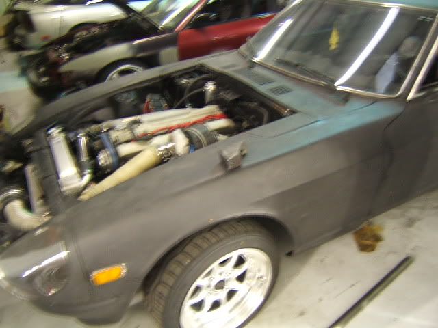

    another pic of the FD on the lift *wink pay no attention to that GT40 on that Z28 camaro /w 345's on the back :P

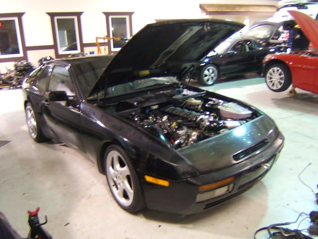

    Elian's Porsche 944, awesome porsche motor
    a close up of that beautiful rare porsche V8.....it's the 944 LS1 limited edition
    lol i couldn't resist. i'll stop threadjacking my own thread. back to the subject...
