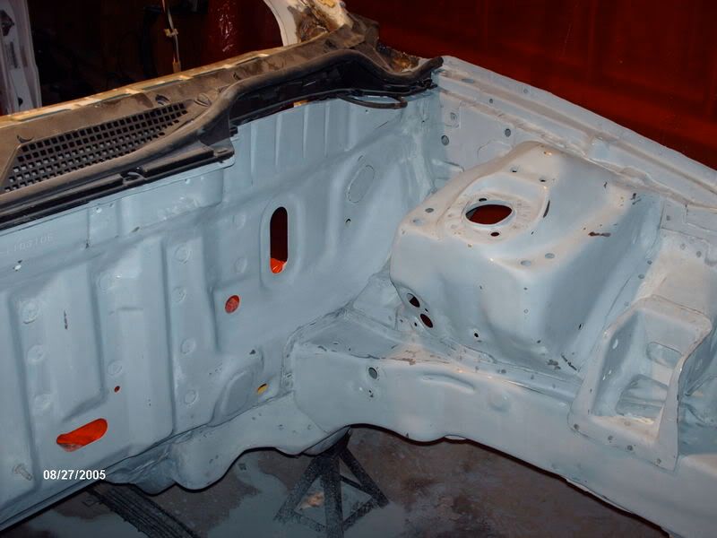

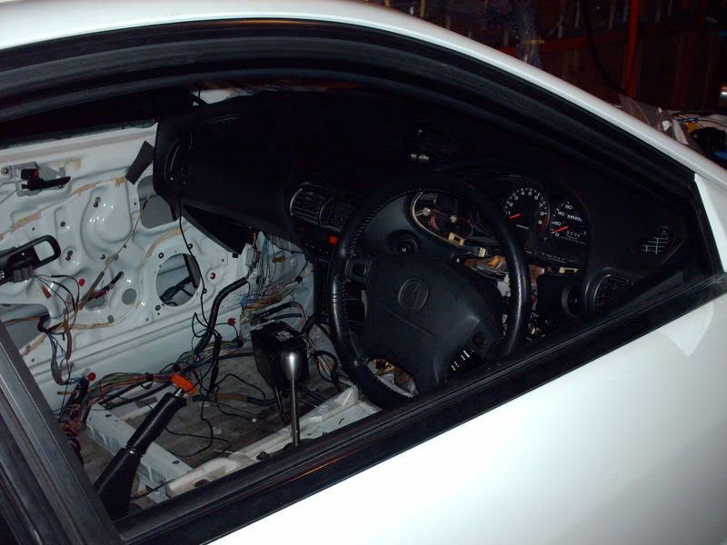

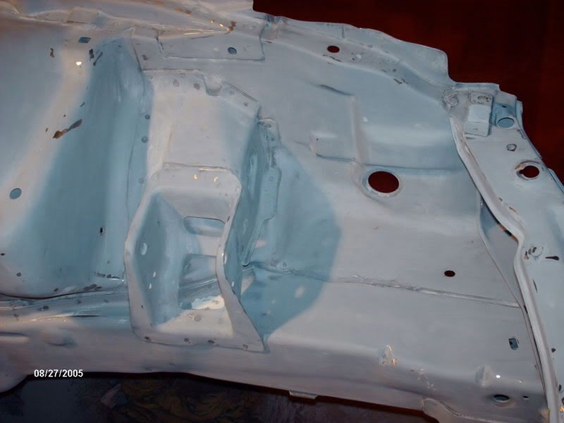

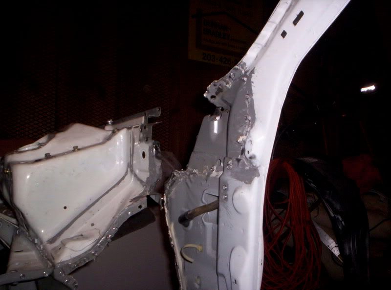

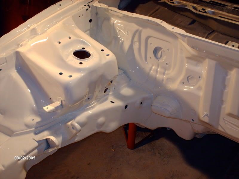

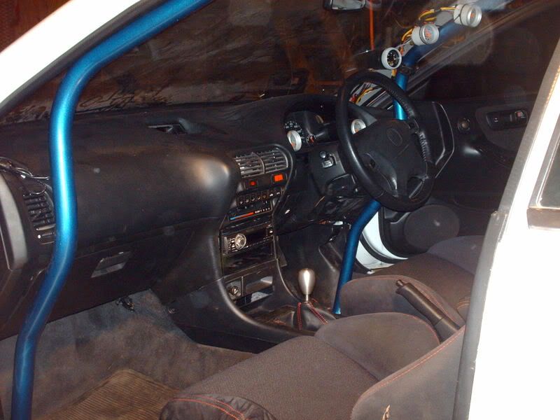

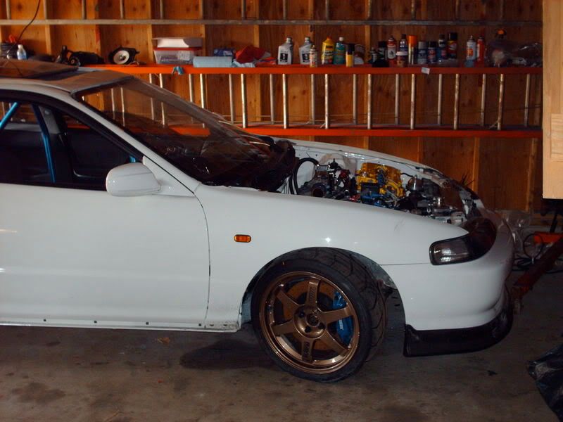

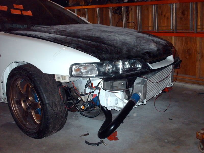

    Pictures from me converting my car to Right Hand Drive

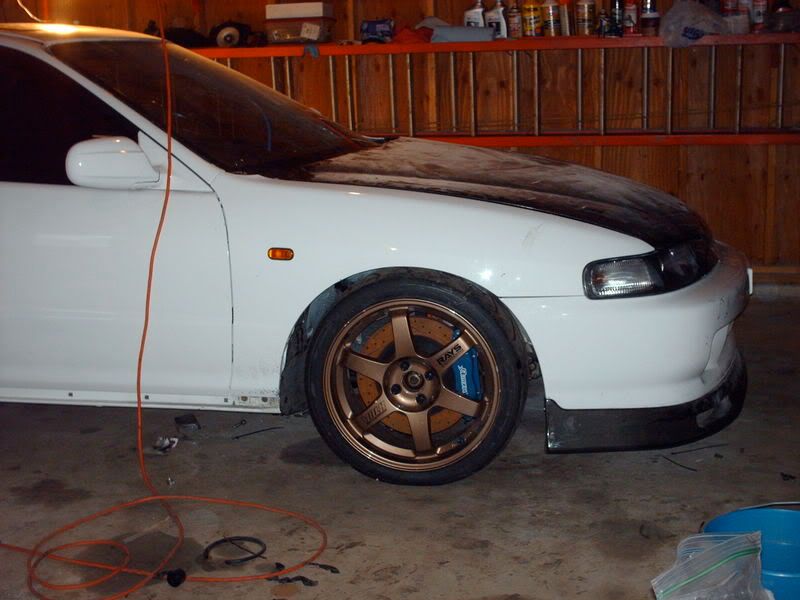

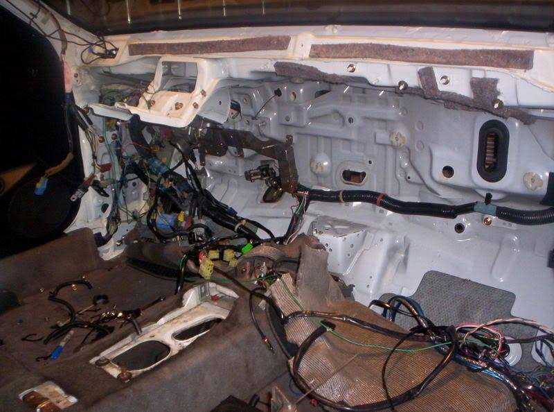

    Before the wire tuck and still Left Hand Drive

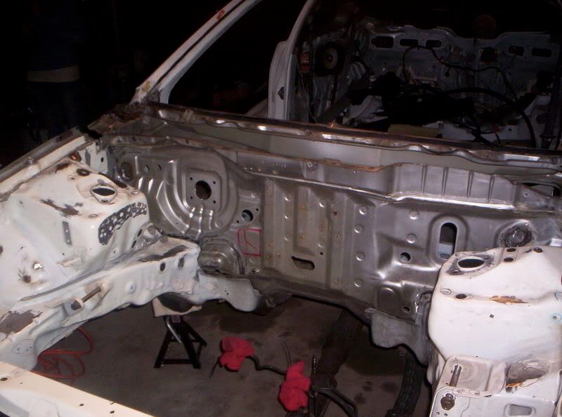

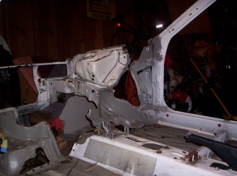

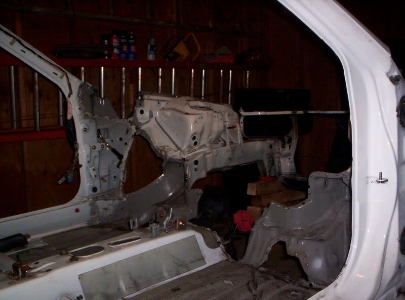

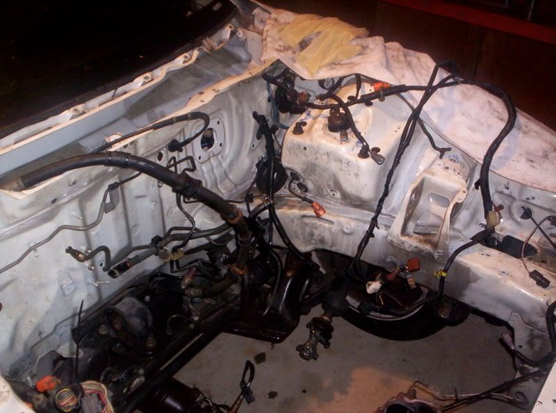

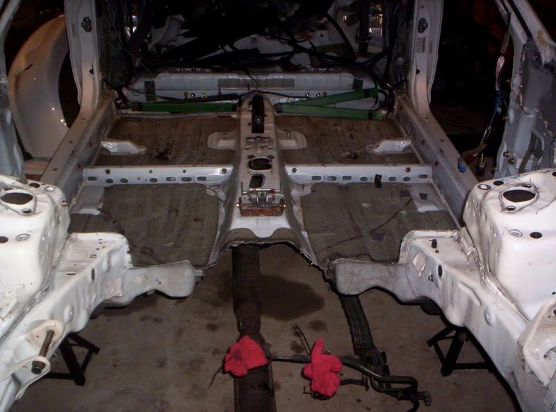

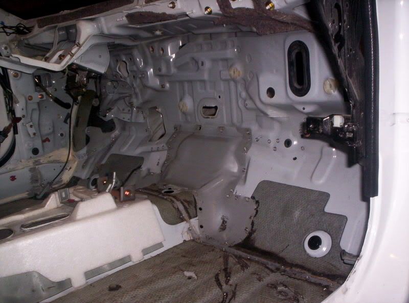

    Beginning the tear down
    Starting to drill out the spot welds on teh firewall

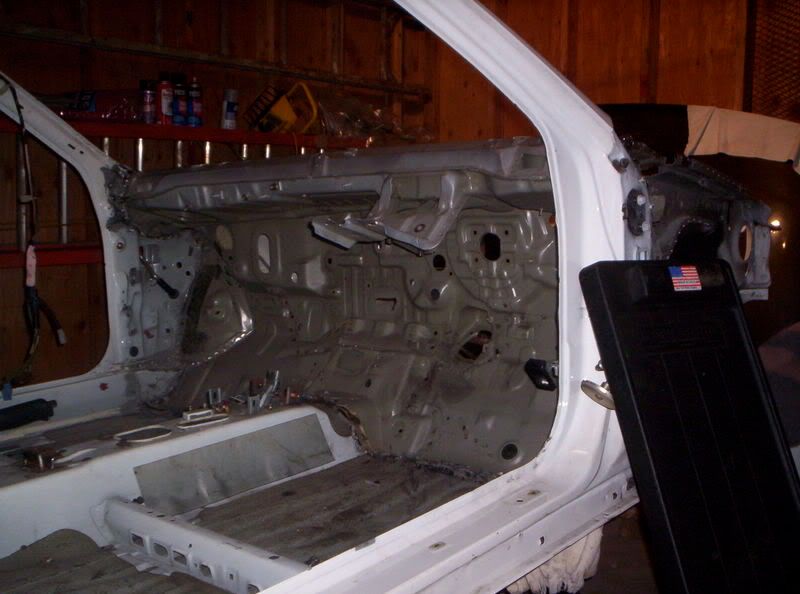

    The firewall removed

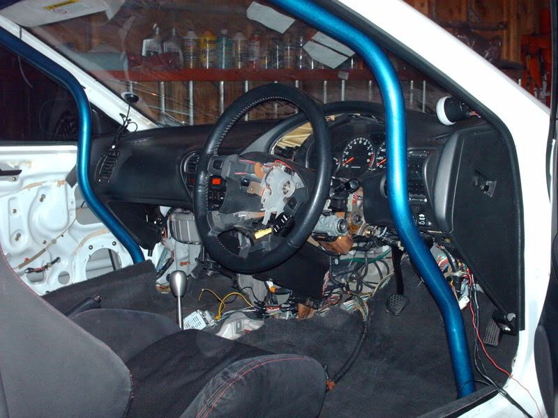

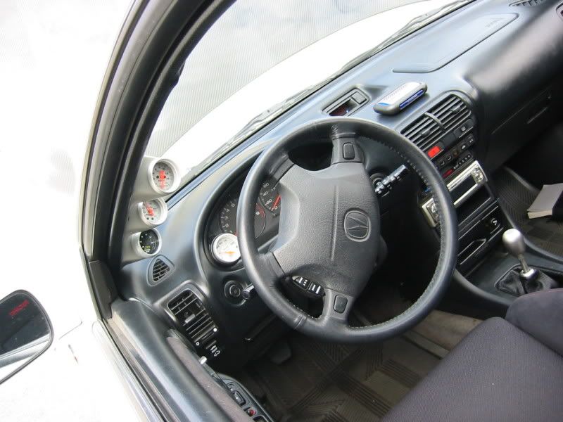

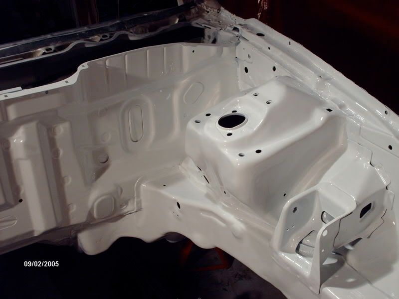

    Right Hand Drive Firewall Installed

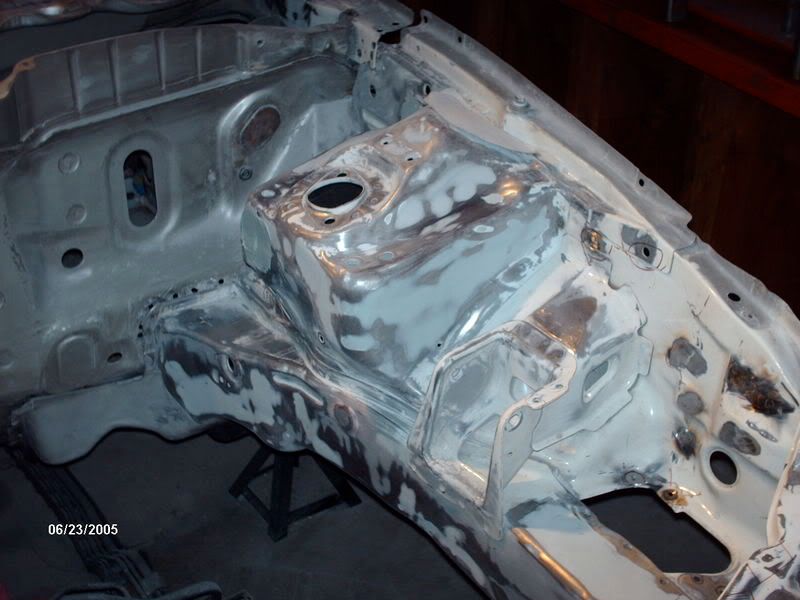

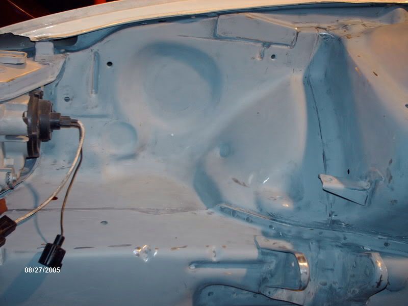

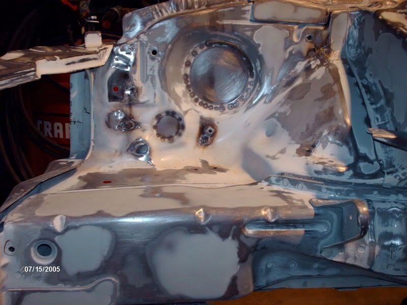

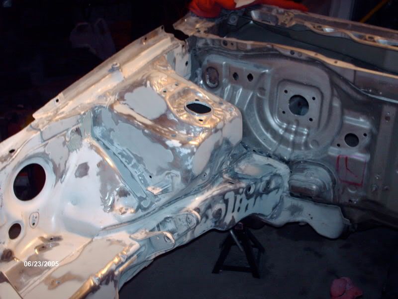

    Now, the welding, bondo and sanding of the engine bay
    Primer was sprayed in my garage
    The car was towed to a shop to get the paint, this is it when it returned
    Mock up of my brake lines

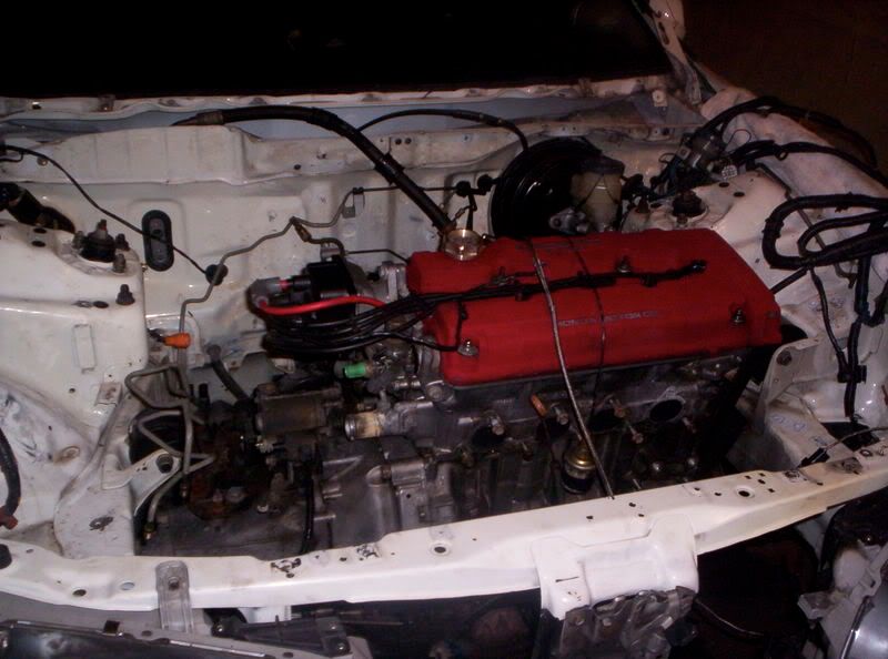

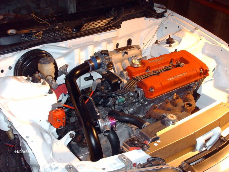

    Installed engine

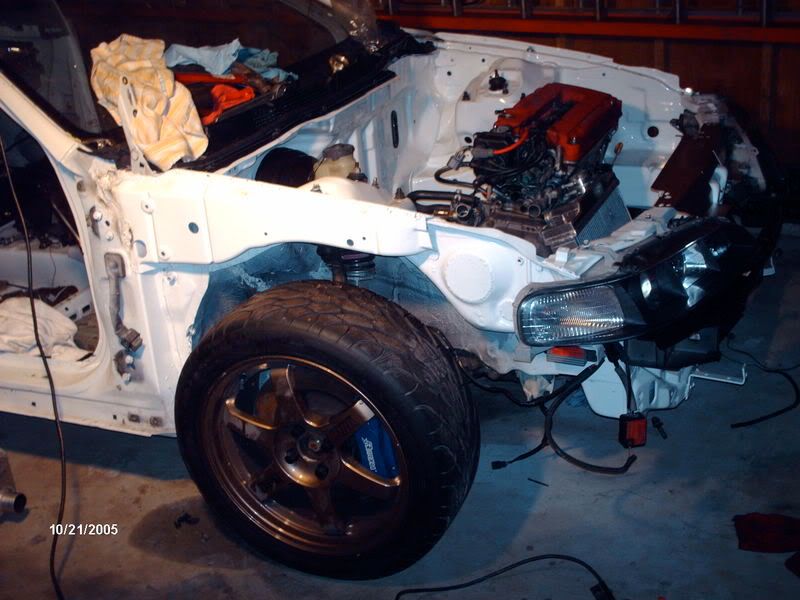

    Test fitting some pieces
    Baught some new tires for the car

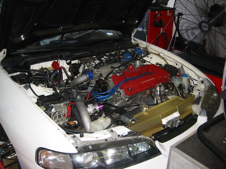

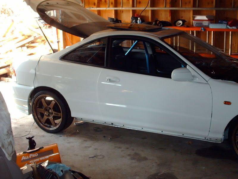

    And here it is almost done
    Thought that some may find the pictures interesting.

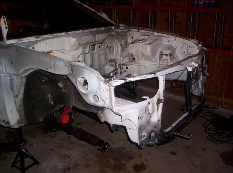

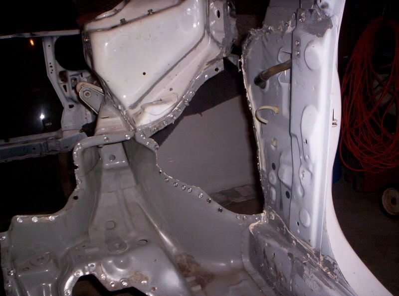

    So, from the looks, you have cut your front clip off and now you are rewelding the RHD clip on?? Is that correct??
    71
    Sorta. I drilled the spot welds out of the firewall and removed that. As far as the front frame rails, they stay. The JDM front (fenders, lights, bumper and hood) is able to bolt on with just the radiator support being swapped. The JDM radiator support is already on in the pictures.
