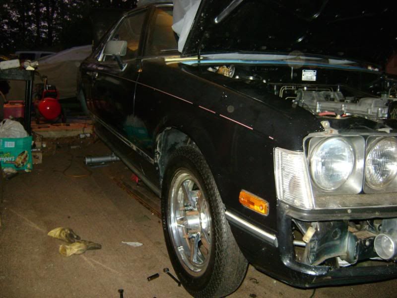

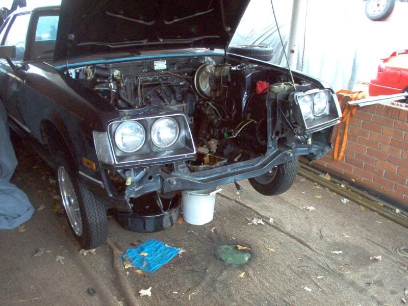

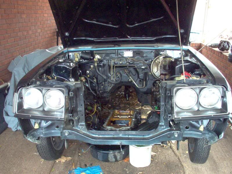

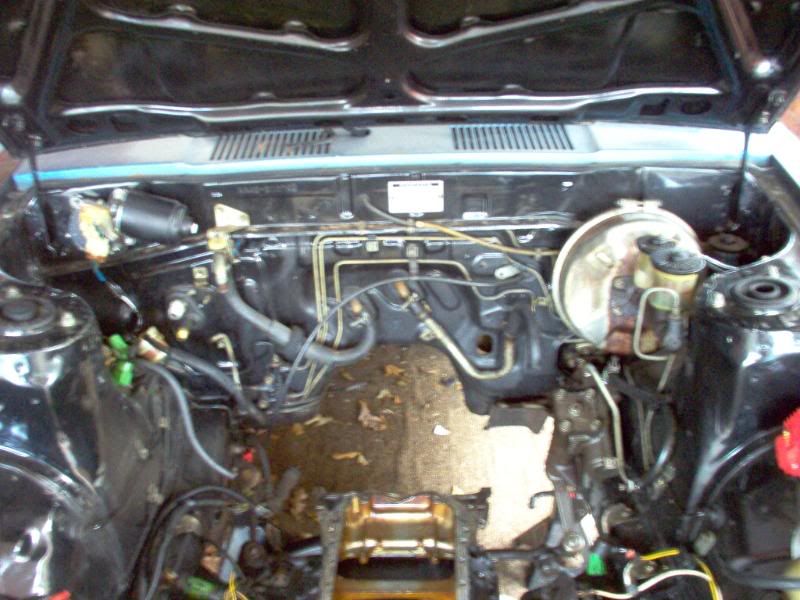

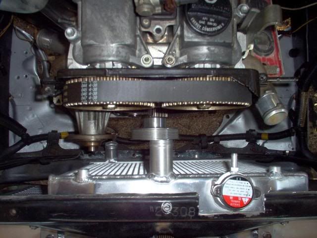

    i prep the mock up engine+trany (in a note this is the w58 i got for now cuz i got all the components for it but the r154 is on the basement waiting for the 1jz bellhousing,
    and you guys wont going to belive it but it went so clean inside the bay that i was like... :shock: something is going to happen!!!! 8)
    and to surprise me more look the trany shifter position, now i really start to worry and i was really like,,, :shock: damn something is really to be real f..ked up later i know :roll:
    then i realize today is my f..king day cuz it was almost unbelivable when i went down underneath the car and the transmission x-member and mount just bolt together and the driveshaft went in like it was made for it! CAN YOU BELIVE THAT :shock: :lol:
    now is a really small interference with the turbo and hood, but nothing serious cuz i was going to cut most of the reinforcement out so no problem at all!

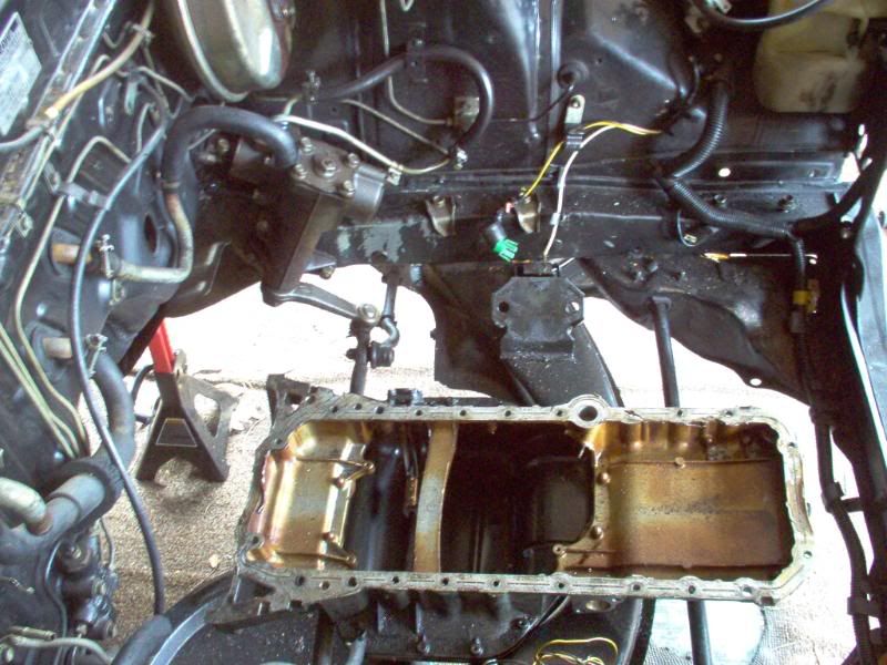

    and here is were i got to do my magic, i got to cut the factory x-member brackets to weld new ones nothing serious it is going to be super easy thats on the next update.
    look the front of the engine oil pan line in comparassion with the front radiator suport almost scuared ahhh?
    i lower the car to the floor and the ride height is almost the same as if the 22r engine still there.
    and here is how it looks !

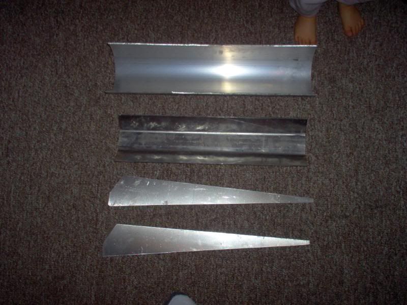

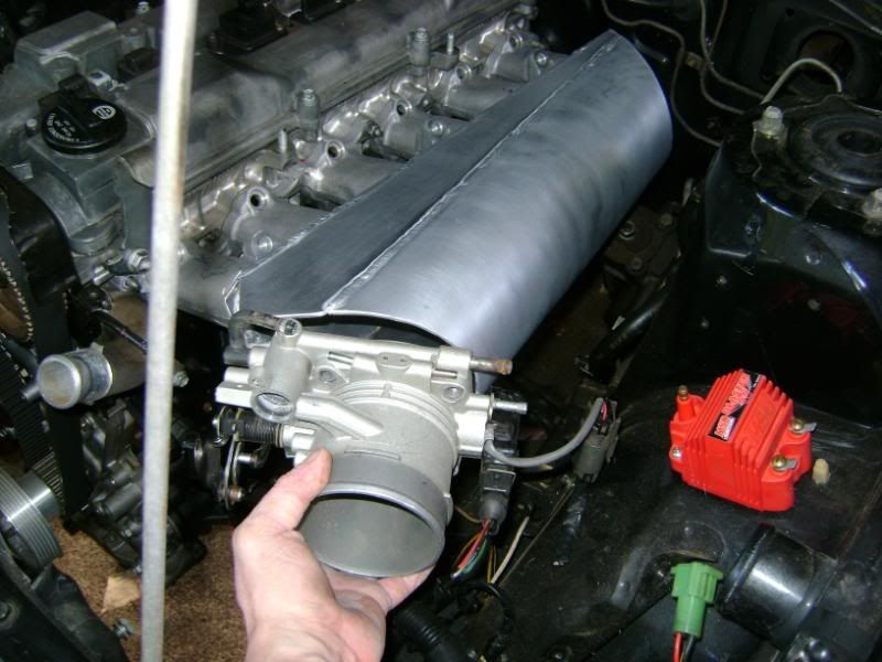

    my sheetmetal intake manifold parts like cuting the parts out of cardboard templates and this is what i have done till now!

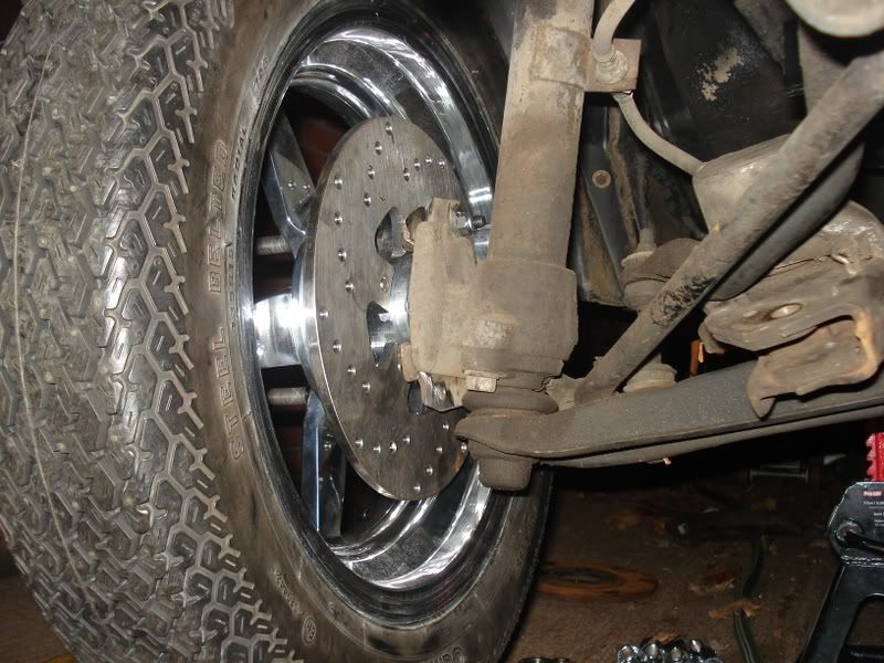

    and here the front brake system done :wink:
    ok now the front brakes are complete with the front suspension, what you think now ahhh?

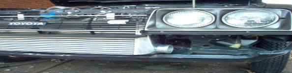

    here are some new pictures of the intercooler mounted!

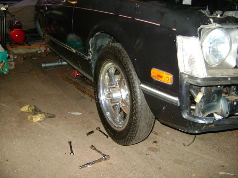

    ok i did massage the rear inner fender (and boy that was a fricking hard job to do so) and look at the diference betwine them with the 15x10 wheels side by side!
    unmassaged; the tire was touching the iner fender in this picture
    massaged; the tire is like 1/2 inch from the iner fender in this picture

    it is just mounted but i will weld in -16 an fittings and stainless lines for it

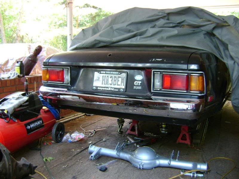

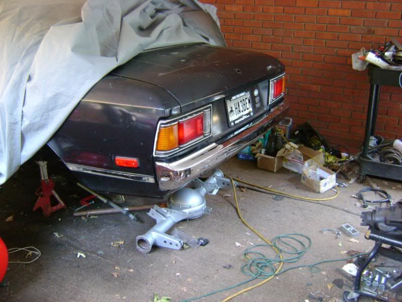

    some new axles from moser that includes green high perf. bearings and 5/8 race studs kit.
    the rearend housing painted and ready to go in!

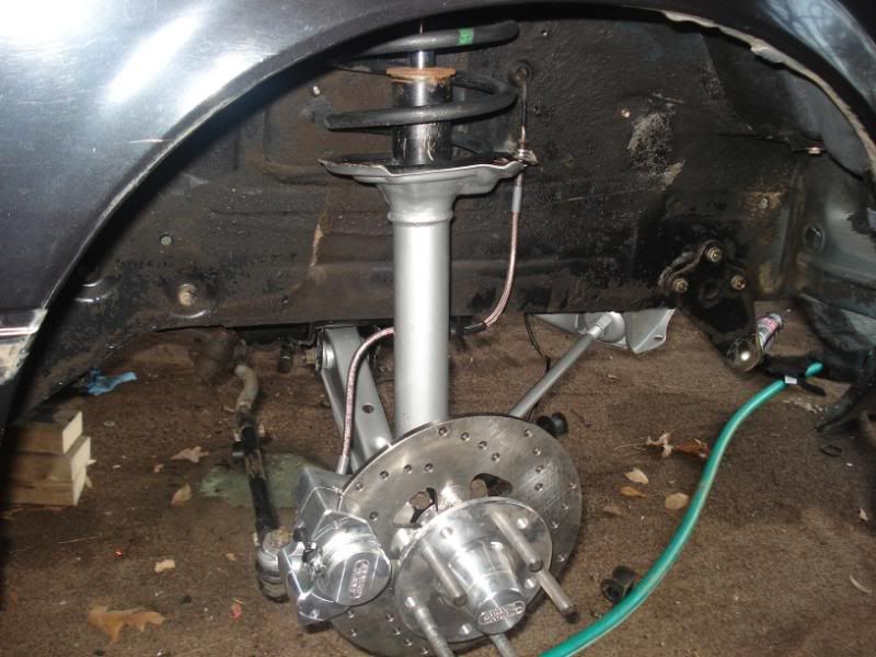

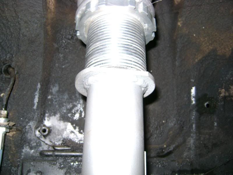

    the front coilover suspension ready and installed! ( by the way it came up super nice and smooth)
    in this picture i want to tell that the car is on the air on jackstands so it got to look sick when i lay it down in the floor!
    and the rear bumper installed, i made custom brackets for it and it really pays off it is just beautiful!

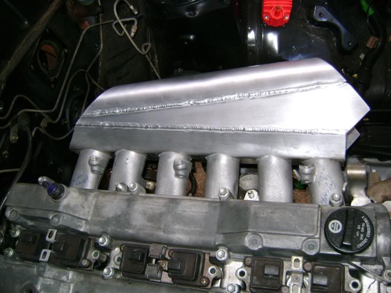

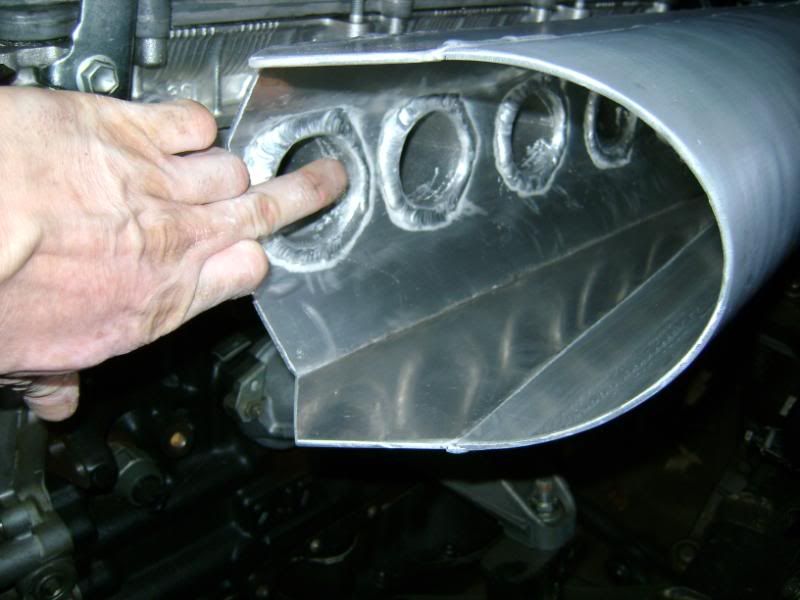

    here is the intake half done it need to be welded from the outside of the runners, smooth out the runners, the back plenum cover the front one with the TB flange, and the fuel rail! sounds a lot but it is less than what i have done on it already !check it out!
    chek what i was talking about with the weld taking the place of the velocitys!
    rear end + suspension setup!
    brake pump installed just waiting on the line lock to hook it up!
