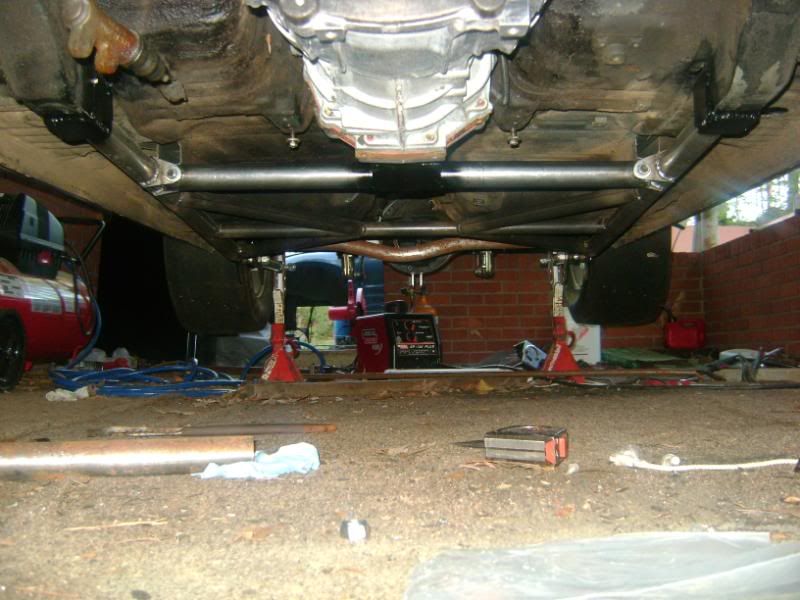

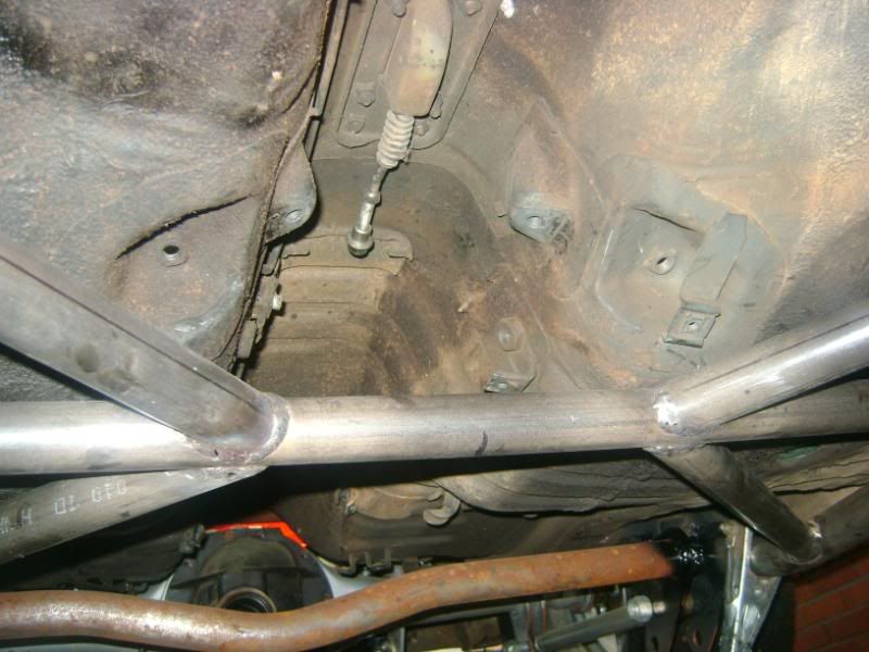

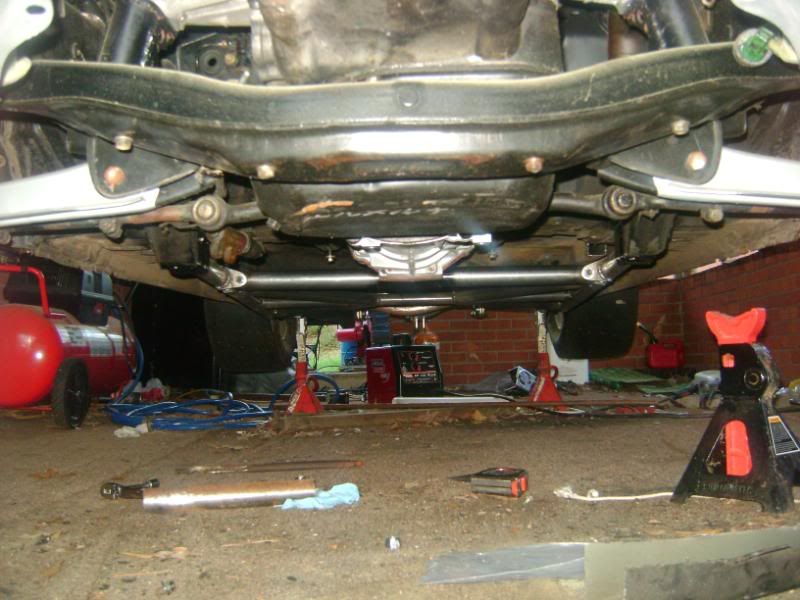

    Thanks Dave and here is some update

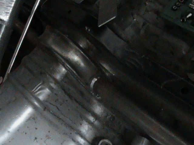

    Subframe connectors are finished! R154 TRANY in mocked up.

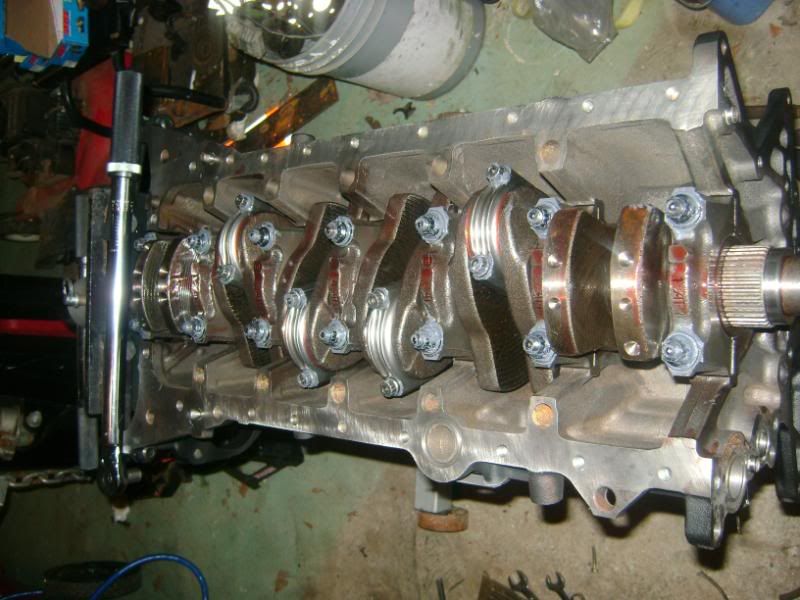

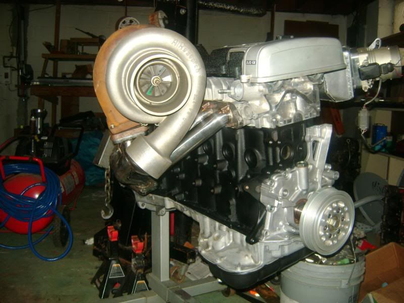

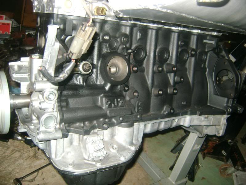

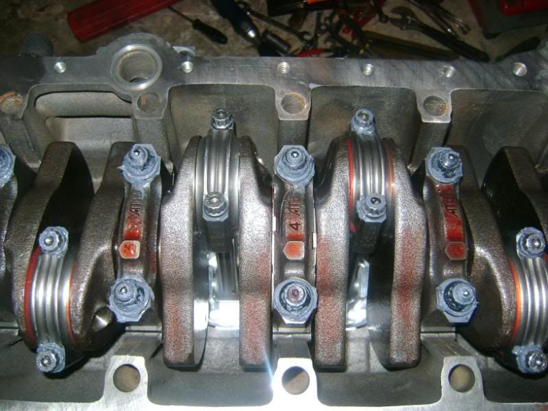

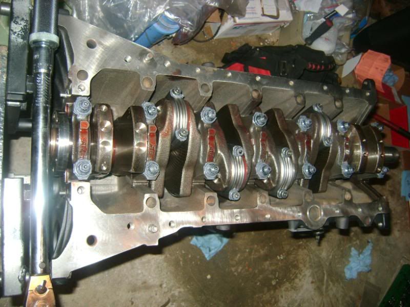

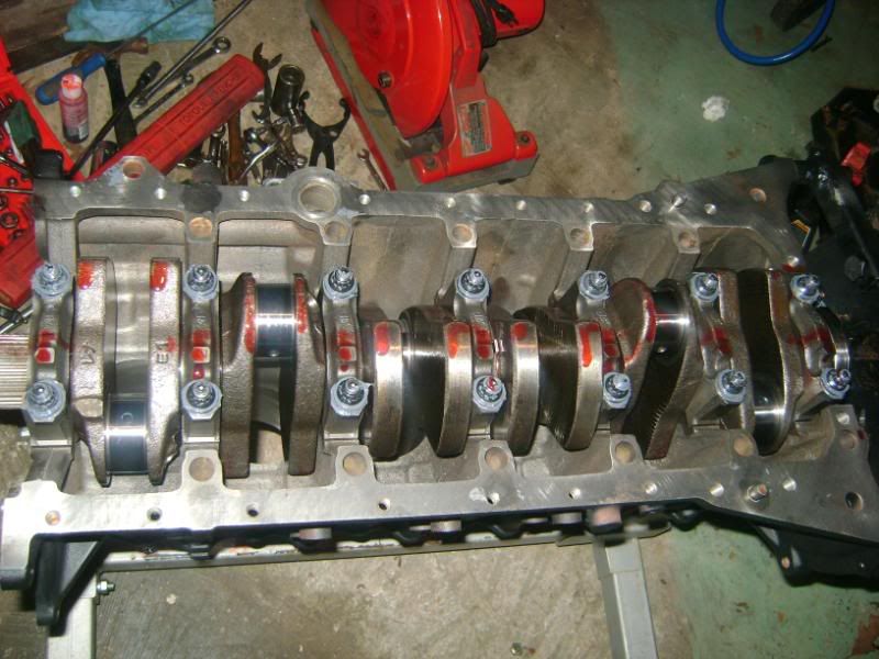

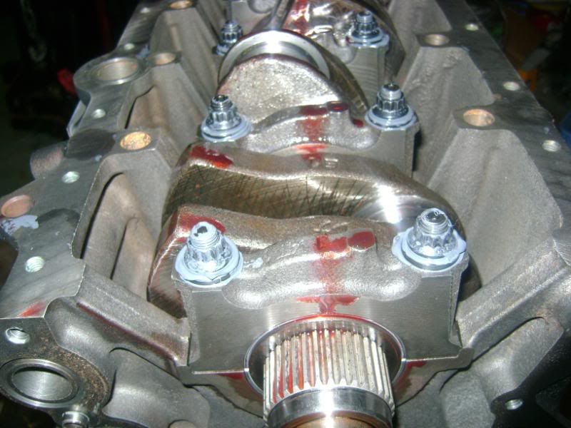

    OK here is the engine, i start to put it back together so here we go
    by the way i got a set of Eagle Rods with the new 3/8 ARP 2000 bolts yeap not the normal 5/16 weaker bolts, so i got to give it a try cuz eagle rate'em up to 1200 whp. i trust em with the new bolts also there is always to upgrade to a L19 ARP bolts!

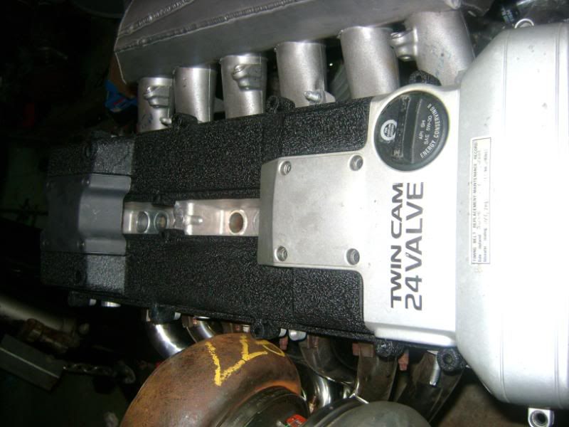

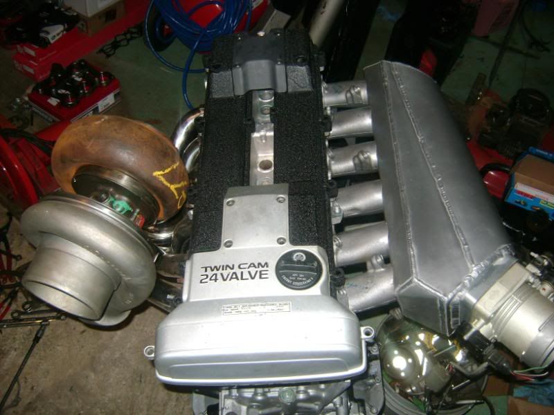

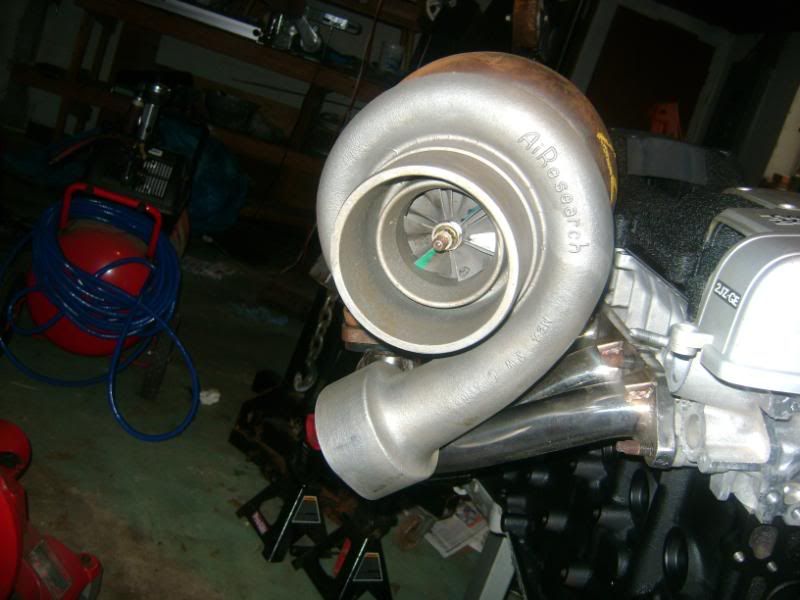

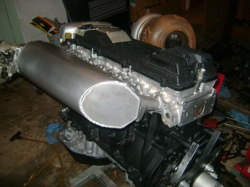

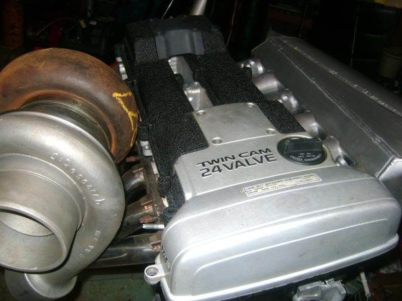

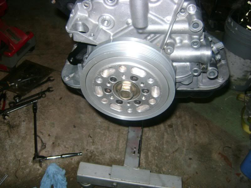

    i just mock up all the stuff on the engine to have a clue of what it is going to look! :roll:
    Check the turbo this is not the unit i am going to run in my car this is a spare i got to upgrade later on you know just in case, and the BOOST LOGIC race harmonic balancer

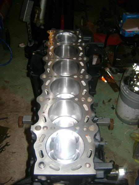

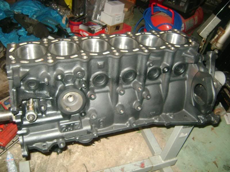

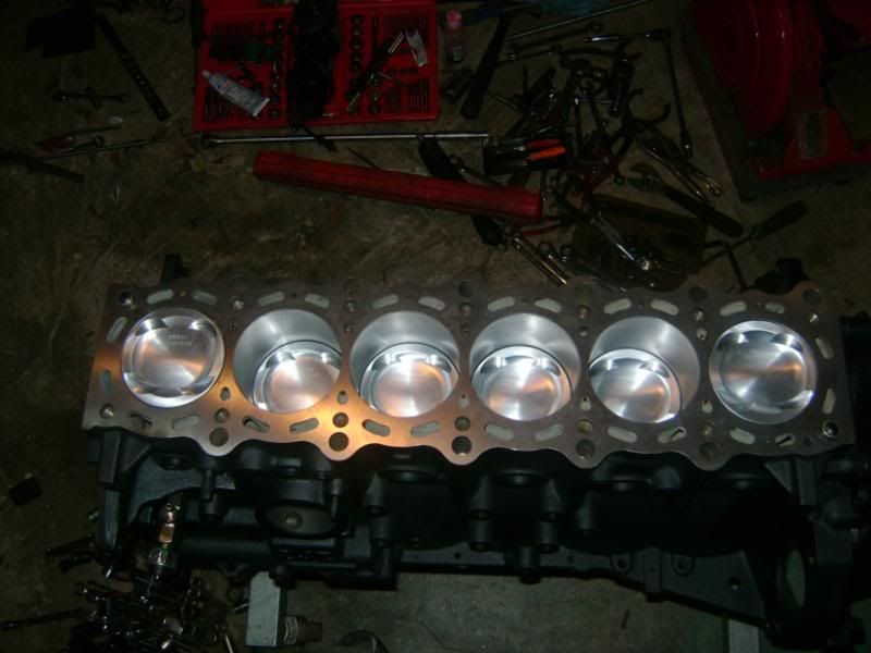

    Lets keep going with the engine assambly!
    Pistons and rods already in and torqued down how it looks?
    Next the head :roll:

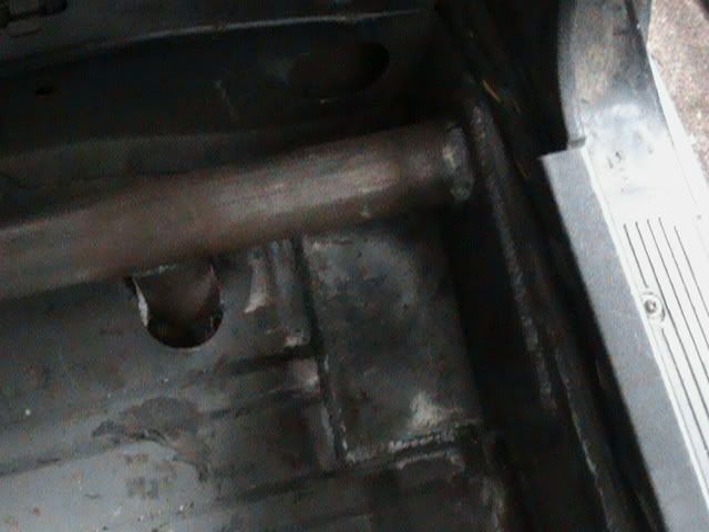

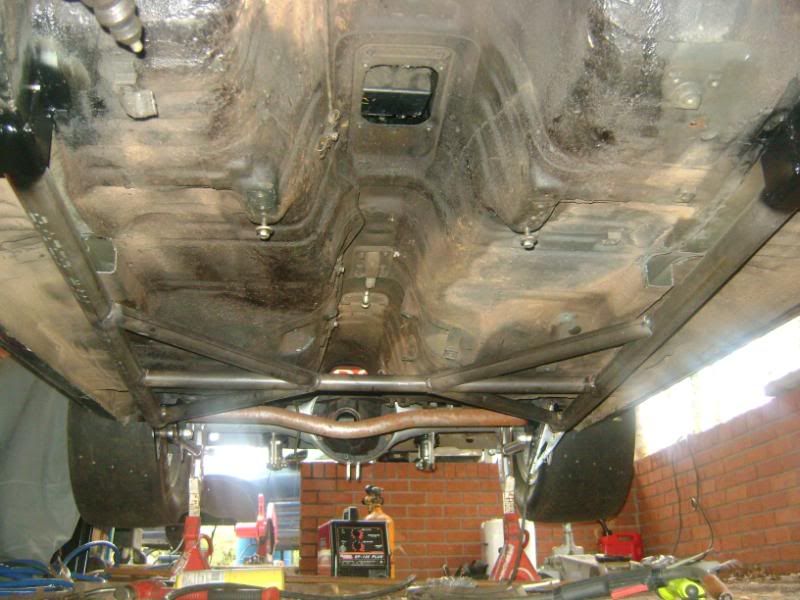

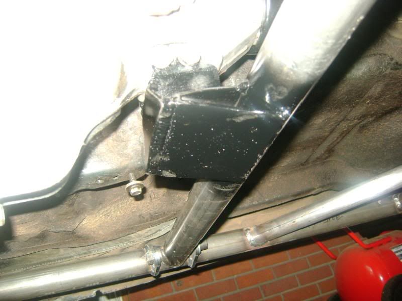

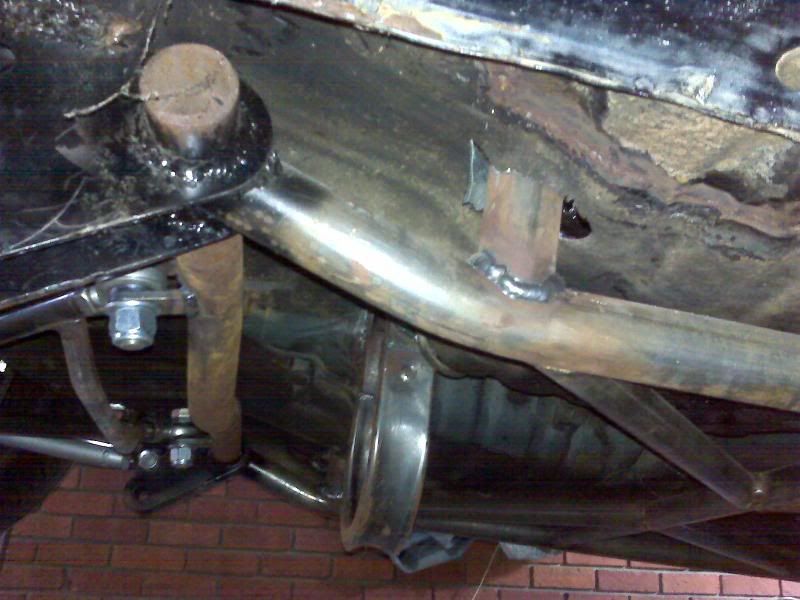

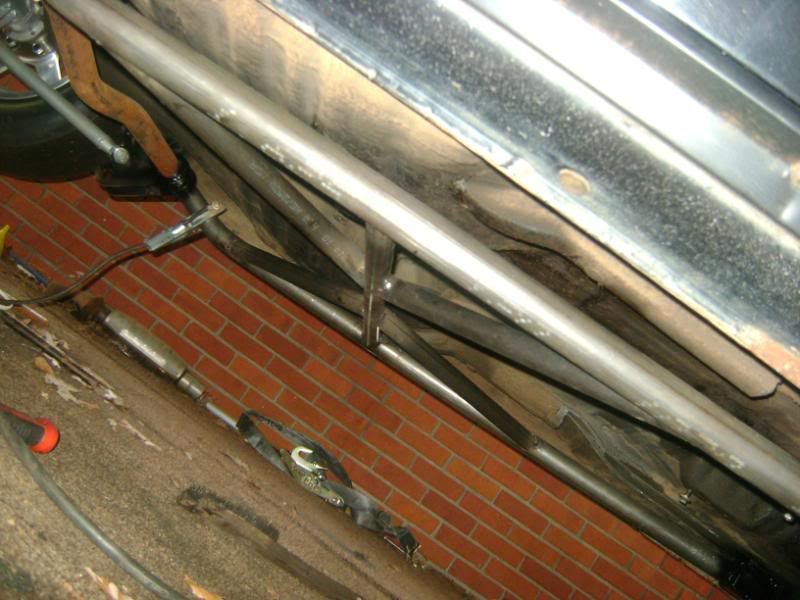

    well here are some crapy pictures of the panhard bar replaced by a wishbone track locator, and the cage foundation welded in the chassis already.
    More updates soon to come, very soon

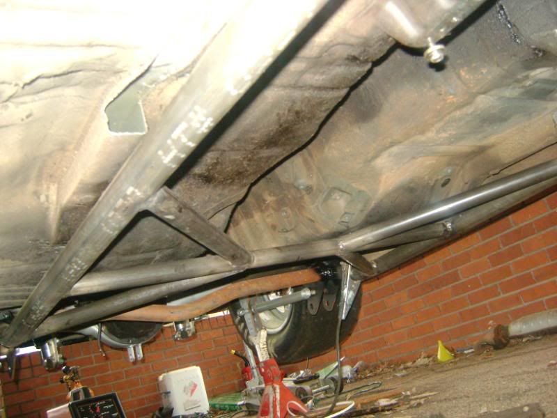

    lets see if this work!!!! ok it does so here are some more in the cage
    As you guys can see, i did the rollcage foundation to be one with the subframe connectors to tie evrything together in one very strong SFI Cert. way, it is going to be a 8.5 Cert for now as i state before, i know it doesnt need all those other tubing for the 8.50 Cert. but i do it anyway to upgrade later to a 7.50 Cert. adding just couple of tubing more planning on future more agresive upgrades!
