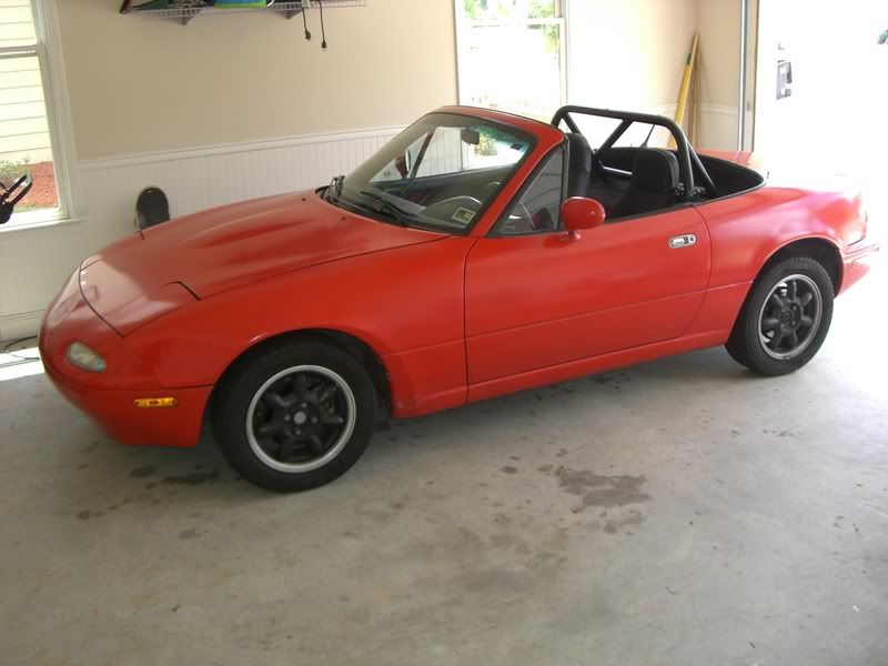

    Well, many of you have seen my poor Miata. Fading colors, having to buff/wax weekely to hold shine, so I decided to try the famous $50 roller paint job. I only have done the trunk, but so far so good.
    Materials:
    -Rustoleum paint (red)
    -Foam roller
    -Sand paper
    -Mineral spirits
    I started off with just the trunk to test/play with it. I sanded it down really well, and went to work. At first it took some time to get the right mixture of paint and thinner, but it worked out. Here are a couple of pics after ONE coat, so can't say it's bad yet.
    I plan on wet sanding it, and adding one more coat. It had a orange peel type finish when wet, and worked itself out drying. It's really smooth. I am hoping to get it where I can safely buff/wax it, just like regular paint.
    YES I KNOW SOME PEOPLE USE MORE ADVANCED PAINTS NOW FOR THIS. BUT IT'S A RACE CAR, IT'S GOING TO HAVE BOO BOO's sometime!!!
    In the pics you can see a few bubbles, this will be worked out with wet sanding, and maybe a little more thinner. We shall see

    are you gonna clear coat it too? that might help give it a better finish that you can buff/wax
    66
    MAYBE, I will look into it, I havent read anyone clearing it yet, many buff/wax it without clear and say it holds up just fine.

    I've seen some good results from this. The whole paint job is really in the wet sanding stage.

    wetsanding is getting the imperfections/trash out of the clear coat and also giving it that smooth as glass look..
    i dont see how you can wetsand just paint and buff it..?
    maybe just polish it instead of wetsanding it?
    I used cheap duplicolor paintshop clear,and wetsanded and buffed..and the paint came off on the buffing pad and went straight through to the old color.
    but for what it is,looks good.
    3,502
    Because that is a single stage paint.
    BMW 750iL
    66
    ^Well I am wet sanding to get the paint as smooth as I can. Buffing to help, then wax.
    Depending on how many coats buffing and waxing can be done safely from what I read.

    looks good for a rustoleum job man!
    66
    Thank ya sir

    my gas cap cover paint was chipping and with some fine grit sandpaper, rustoleum, and clear, can't believe how good it came out. If you take the right steps, you'll be really surprised how good it'll look. light coats

    That doesn't look good at all and I really can't see it turning out any better.

    ugh... rust-o-leum shafted me in the arse, but we tried to spray it and not roll it. plus we cleared over it and it didn't turn out well. they didn't want to mesh. so i wouldn't suggest clearing it and just stick with rolling and sanding.

    I don't think it looks all that bad, and wet sanding will help it a lot. Also, everyone telling him to clear, don't. It's one stage paint. It's not meant to bond to clear. (My car has one stage from the factory, it's a semigloss finish).

    For $120 you could have had some auto paint and cheap gun and be done in half the time.
    BMW 750iL
    66
    ^This takes no time, and is like $35 lol.

    your miata is gonna look like mine lol, i did the same paint and color on my old miata, looks good so far though
    66
    ^I'd be happy with that.
    Plus it'll have purty stickers all over it lol.

    what class are you running in for scca? i was building mine for e-stock before i sold it, and i cant wait to see your final product

    Well paint sure yours will be better, no shit lol. My body is fine, no dents or anything.
    But ANYWAY, car will be used in ITA road racing class. So spending tons of money on pretty paint would be risky, accidents happen and bumping occurs lol.
