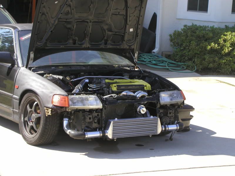

    fabed up brackets for the ek radiator and yes the hood does fit i had to lower the brackets about 1 and a half inches.

    That is looking pretty good! How much boost are you gonna be running??? Is the motor built???

    the motor is all stock and 10psi. im ordering a kms block gurdle for it ill keep yall posted!!

    you might want to weld over all the welds on the manifold and maybe it wont crack

    that clean.. it should be ok, i would just watch out on the mani!!

    ya the mani kinds worries me but ill just weld over all the existing welds and + it looks cool

    good luck getting anything from kms, just had a 3 angle valve job and a full polishing job done there and it looked like **** had to have it redone somewhere else not to mention they lightened my flywheel and it was so out of balance when they finished we had to throw it away and buy a new one
    turbod B16 in the crx should be quick as **** though but be careful on 10lbs those stock pistons and rings wont last no time if you dont tune it imediately,

    you should flip the wastegate the other way to where it dumps downward... and are you planning on using that ebay turbo?

    wire tuck maybe ??? looks good so far ... jus dont go past 10 psi on the egay turbo if you want that thing to last a lil while .

    if i flip the wastegate the other way there is no room for a dump tube and im not gonna dog the **** out of it without a good tune on crome and i hope the kms doesnt fuk my **** up ill be pissed and do you think that stock ls pistons will do better than the b16 ones?

    the ls pistons would be better but then you will have to hone the block for the 1.8 pistons at that point you might as well go ahead and at least do some forged 9.0 : 1 pistons and get some better rods, b16 rods are weak as ****

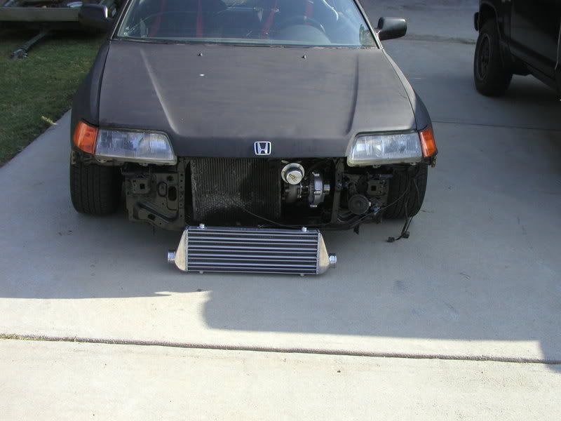

    ya got the intercooler kit and bov fabbed up brackets and **** will post pics later and my oil drain kit is on back order for two weeks

    thanx for the reps. guys and im runnin a obd-0 to obd-1 jumper and a obd-1 jdm b16 ecu for now eventually will get chrome with a data log cable and ****!! i cant wait to post these intercooler pics i think i did alright for my first boost project and keeping it jdm with my ef8 bumper ill post pics today later!!
