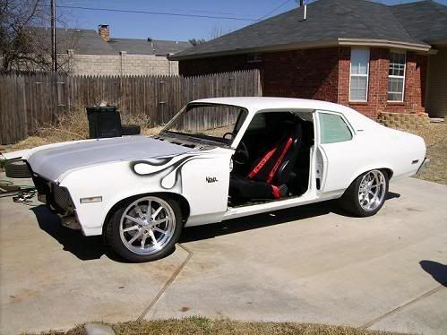

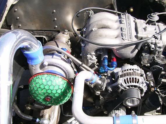

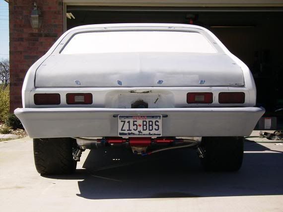

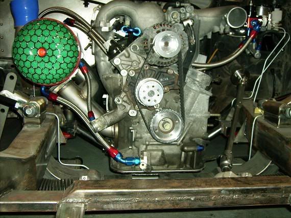

    Just wanted to share my project with everyone. I decided to do something different and put a 13b-re in a 1974 chevy nova. The typical comment is that a musclecar is too heavy for a rotary, but we have gone to great lengths to lighten the car. Without going into details, the car will weigh in at just over 2700 lbs. Love it or hate it, you gotta admit....................never seen one of those before.
    Engine
    13b-re Engine
    1/2 Bridgeport
    GT40R Turbo
    Haltech e8 ECU
    Gilmer Drive
    FMIC
    Exhaust
    Custom schedule-10 SS Exhaust Manifold
    Tial 44 mm Wastegate
    3.5" SS Downpipe
    3.5" Aluminum Exhaust
    Burns Lightweight SS Muffler
    Wheels/Tires
    2" Rear Mini-Tub
    Budnik Gasser Wheels
    Front - 18 x 7 (235/40/18 BFG KDW)
    Rear - 18 x 11 (315/30/18 BFG Drag Radial)
    Drivetrain
    TII ACT Extreme Pressure Plate
    6 Puck Disk
    ACT Streetlite Flywheel
    Turbo II Transmission
    Aluminum Driveshaft
    12 Bolt w/ 33 Spline Gun-Drilled Axles
    4.88 Gears
    Suspension/Chassis
    Chris Alston Front Clip
    Front Coilovers
    Custom Traingulated 4-link
    Rear Coilovers
    Subframe Connectors
    And the list goes on....

    someone needs a metal fabrication class or two...

    I bet that's fun to drive. That bay dwarfs that motor. I love original swaps like that, like the 2jz Camaro someone just posted up. Whether you like it or not you gotta give the man props for pulling it off, that has to be the first 13b Nova ever done.
