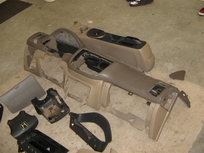

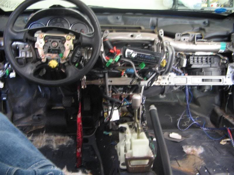

    Dash/center console/random pieces out

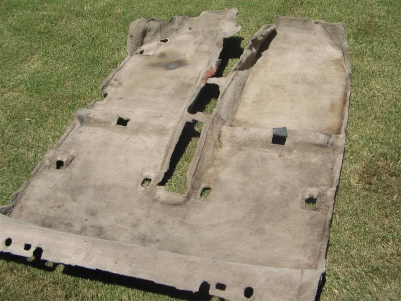

    Dirty ASS tan carpet
    ITS GONE!!!

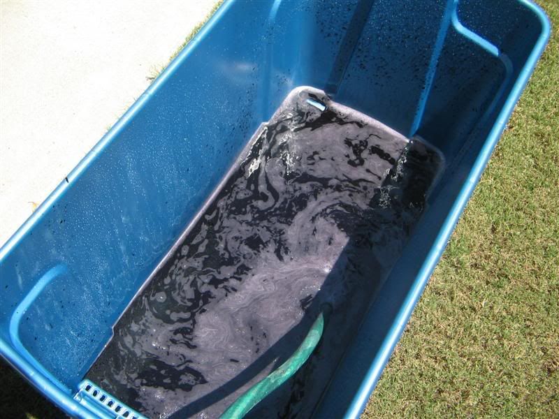

    I ran to walmart, got a big tub and some dye... total $15

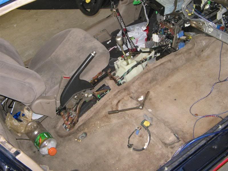

    Carpet out...
    THis was when i had a WFT am i doing moment...

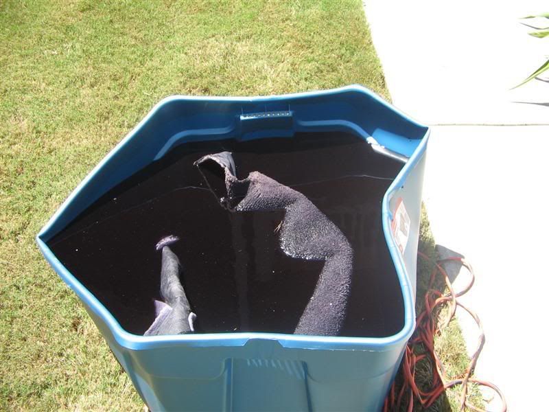

    Carpet in!!
    (****ty rummermaid tub )
    I let it soak for an hour and a half, moving it around every 30 min or so

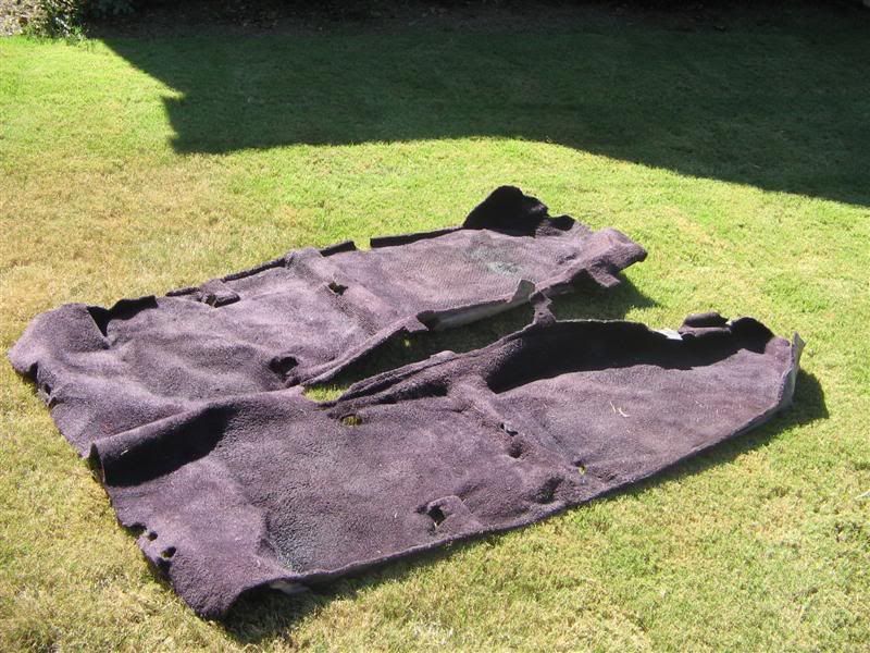

    End result... still wet
    More than likely i will soak it again tomorrow depending on what it looks like when it dries...

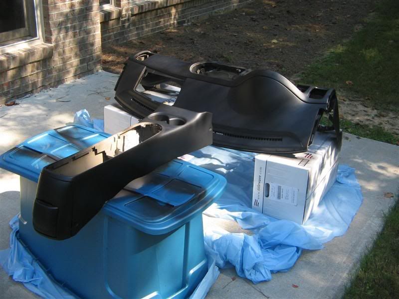

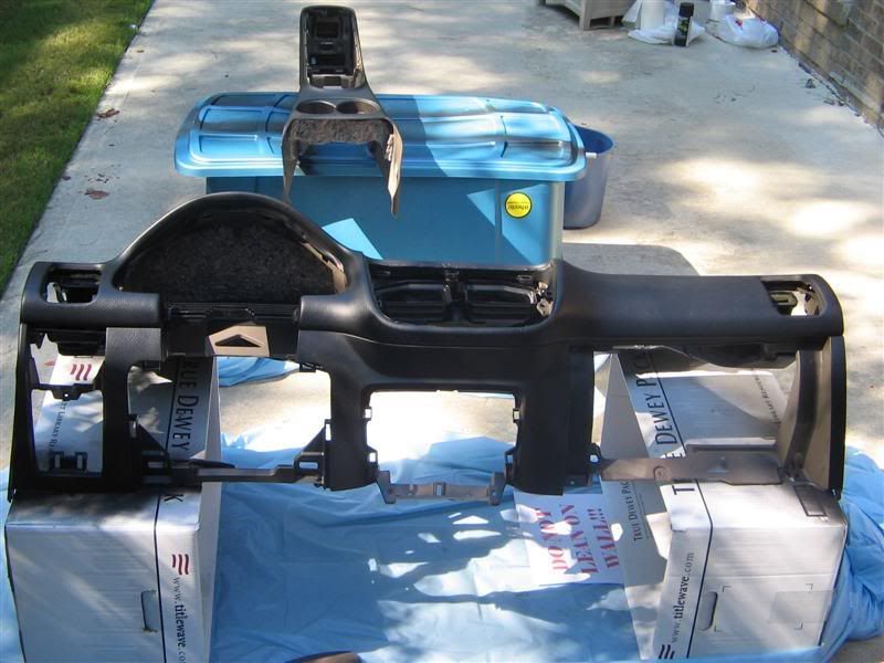

    I decided to just spray them with some duplicolor flat black vinyl dye...
    I cleaned the panels with soap and water, then wiped them down with some rubbing alcohol. Sprayed some adhesion promoter, and then the black
    dash and center console first

    Carpet looks.... purple?
    I know

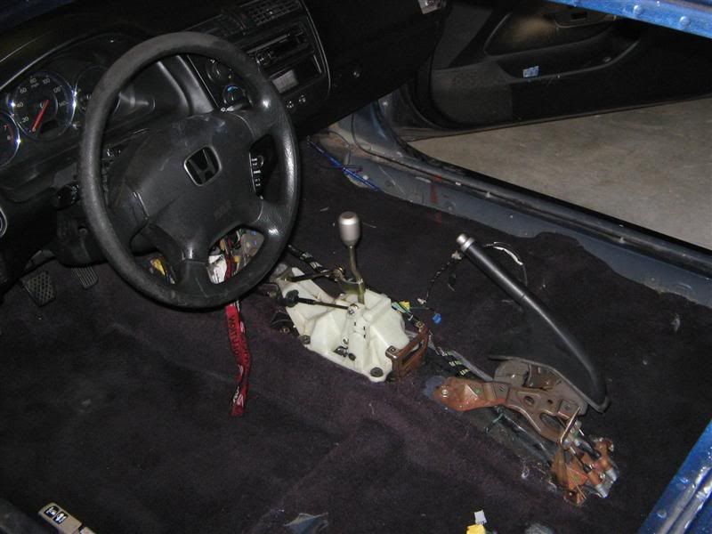

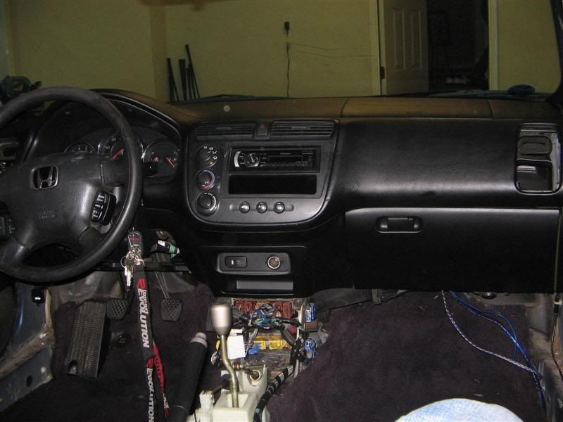

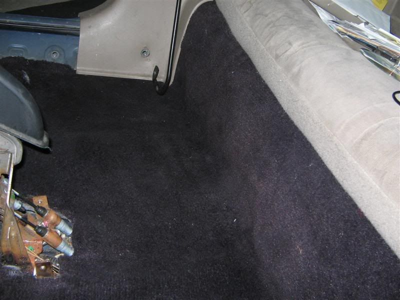

    SO i got the dash board and the carpet in... still gotta put in the seats, center console, and some trim pieces..
    Here are some pics for now..
    Dash put back together
    The carpet isn't SUPER black, but its close enough for me
