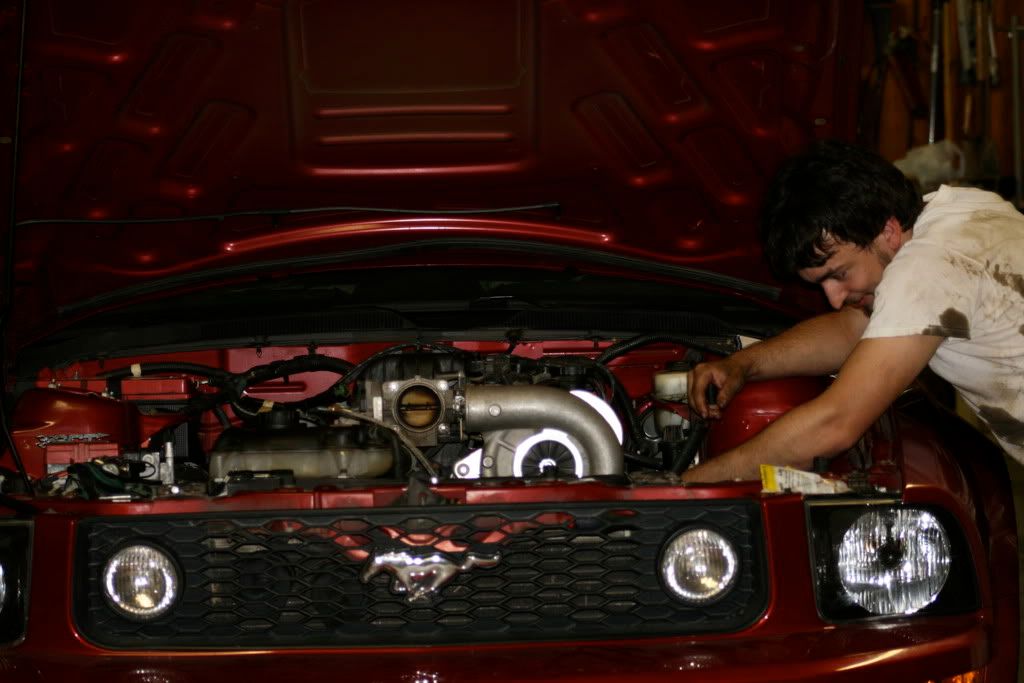

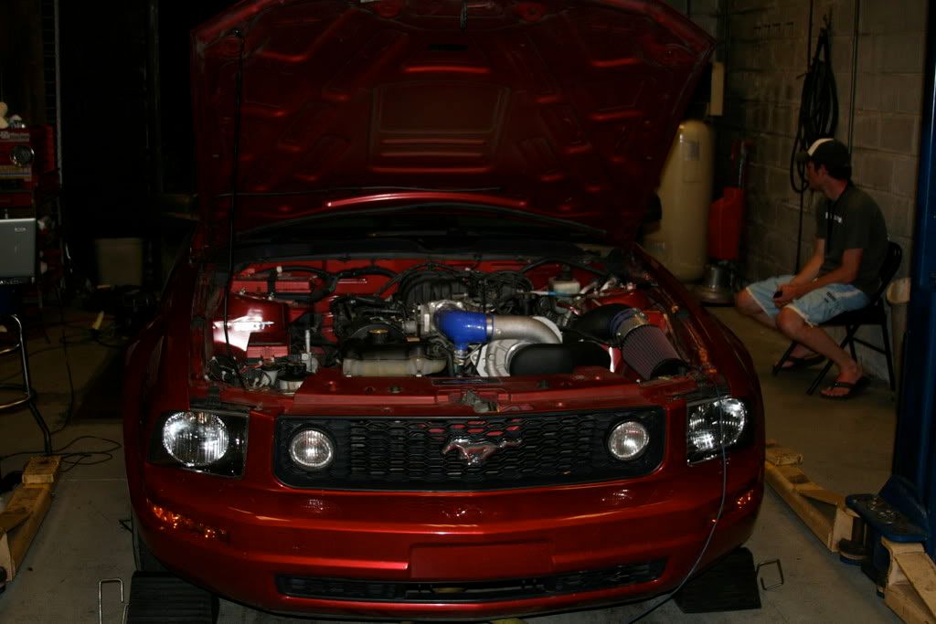

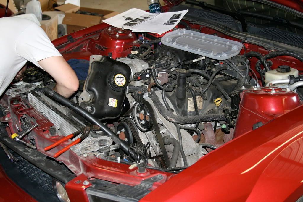

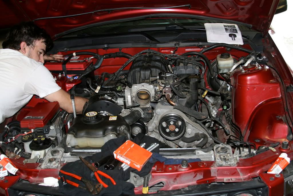

    Me and my buddy got the blower installed and took it to be dynotuned this weekend. thought id share some pics of the install and pics at the dyno.
    Car was tuned by doug at bamachips. (www.bamachips.com)
    final numbers were 285rwhp/274rwtq @ 7psi
    sry for the low quality pics.
    The install
    Now the Tuning
    Mine is on the right

    SWEET! nice blower, how much more power do you plan on getting out of it? any internal work? how much power does the one on the left put down?
    Hybridaccord
    PS3 online screen name: Eiswritsat
    3,580
    the one on the left is my friends( the one in the pics) his put down 353 rwhp/340 rwtq on 11 psi. i dont have any internal work, but will be getting a meth/water kit and a 10 psi pulley for it soon so im just shooting for 310 rwhp.

    lol i have had two people just here in rome already ask, is that turbo'd! i told them yes it is if turbos are belt driven lol. oh and btw thats not me in the pic thats my buddy jeremy who helped me with the install. i was nervous about tapping the oil pan for the oil return line, and hes done it before so i let him do that part lol.
    eww....thats why I went with the Procharger. It is self contained. Uses Procharger oil instead of the motor oil. And your SUPPOSED to remove the pan/cradle before taping so you can get all the metal out of the oil first.
    -Ant.
    yeah we greased up the bit really well and drilled super slow. we got all the shavings out, then changed the oil twice. no shavings were found in the oil when we changed it.
    vortech has a new v3 blower (i think its called) that is now Self contained. but when i tell you the price i got this kit for youll understand why i went with this over procharger.
