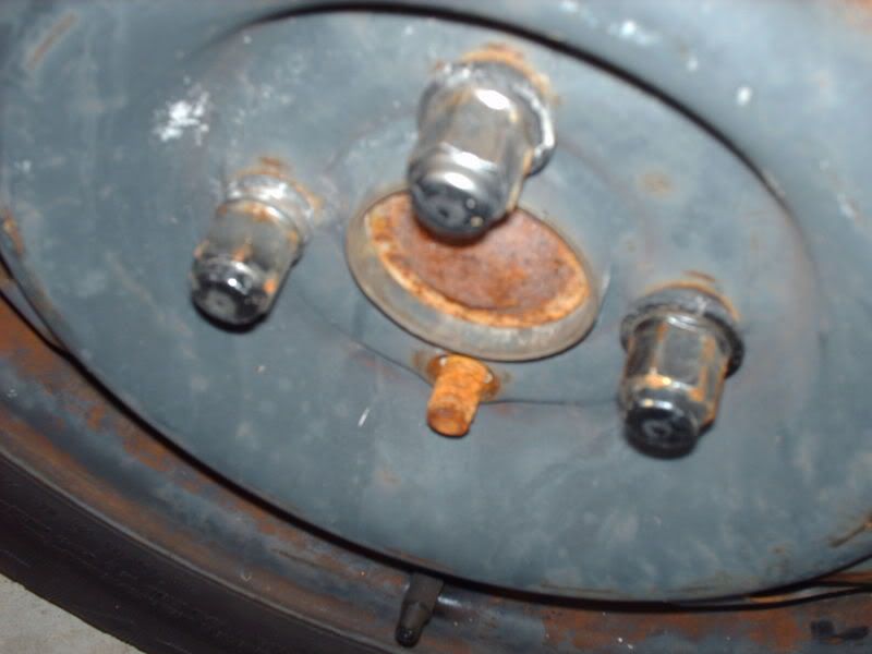

    one bolt on the brake disc is rusted and stripped. do i have to change the whole spindle? or can i change the bolt part?

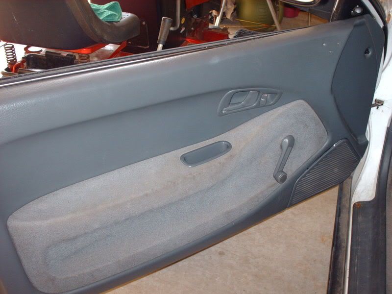

    window was not aligned so i pulled it out. i tried to align it myself by takin the door interior apart. but i couldnt take out the manual window pully out?

    u have to get a little tool to remove the lock on the handle.. go to the parts store, and look, youll find it. i forgot the name of it tho...door handle remover? lol

    you can just knock that rusted stud out you don't have to change the whole thing...just get it to where there is nothing behind the stud and fu.cking hammer it out

    hope i caught you b4 you went at it bro but there called pick tools and you nee the hooked one and theres like a horseshoe pin behind the handle be carefull now that ish will fly dude. g/luck with the build bro keep us posted

    thnx bro i kno exactly what tool to use now, and u did catch me b4 i went at it lol.
