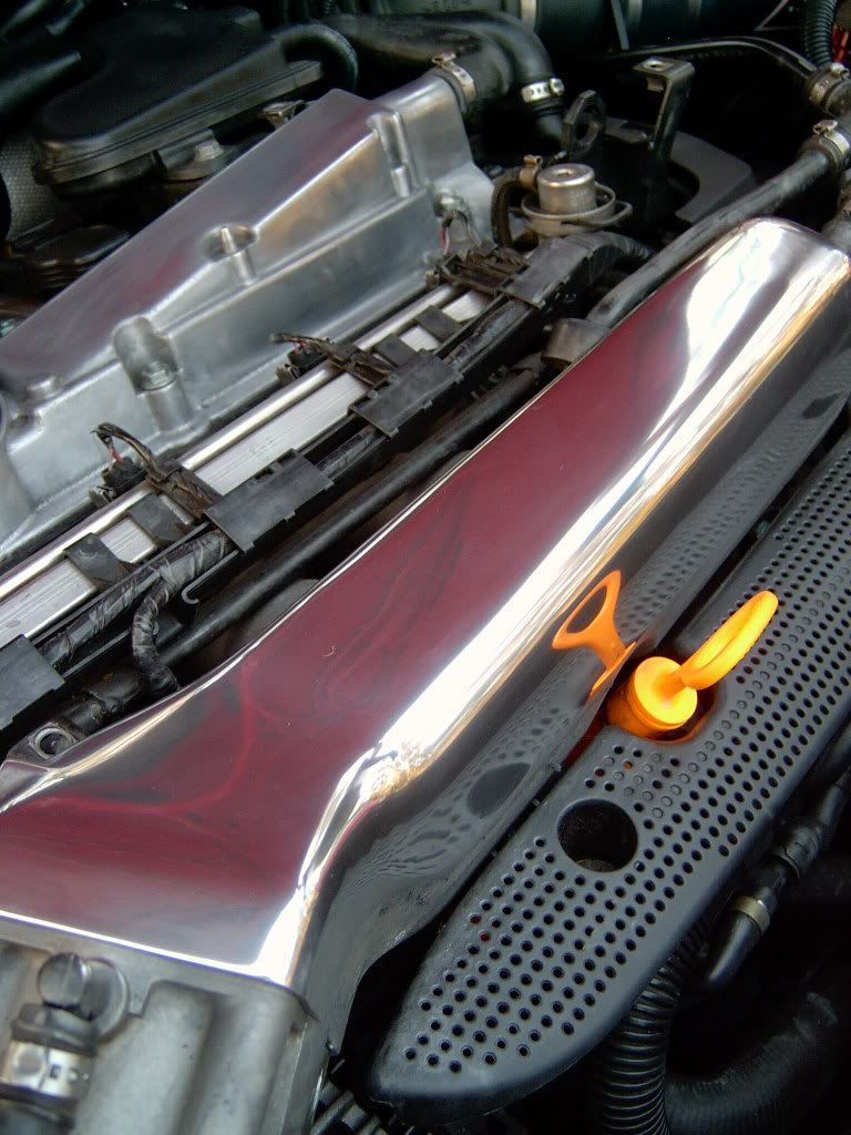

    Feedback? First thing I've ever polished.

    Looks good, Goodjob...............

    Appreciate the compliments.

    Like they said gti, pics will be up in a few weeks if parts come in.

    Nah I just masked a little of it off, I'm up in the air about taking it off and polishing the back of it.

    Haha my fingers are still recovering.

    You did a VERY good job for being your first time
    f.b.
    2,726
    what did you do just sand it down and polish like hell?
    7,405
    Thanks, I really didn't want it to look half assed so I spent a bit of time on it.
    Quote Originally Posted by d_day87
    I wetsanded it and made sure to go right to left always never up and down, started with 800 grit(awful idea, I thought my manifold was much smoother than it actually was) and worked my way up to 2000 grit. I always kept a lot of wd40 on the sandpaper and manifold and made sure to wipe it every so often. Then rubbed mothers aluminum and metal polish into it until I saw the polish turn black then I would wipe it off and repeat. I think it was well worth the effort.

    Thanks, Im going to try every part but the top near the coil packs. With all the issues our cars have with coil packs I am hesitant to even take them out to remove the valve cover.
