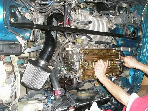

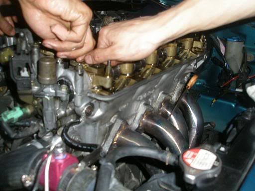

    first they took off the valve cover....
    next remove the distributor (I think thats how its spelled)

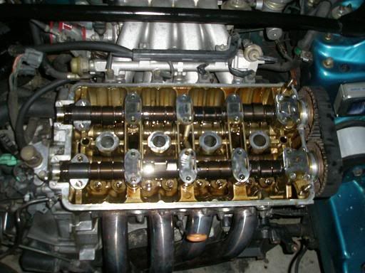

    then the cam rails

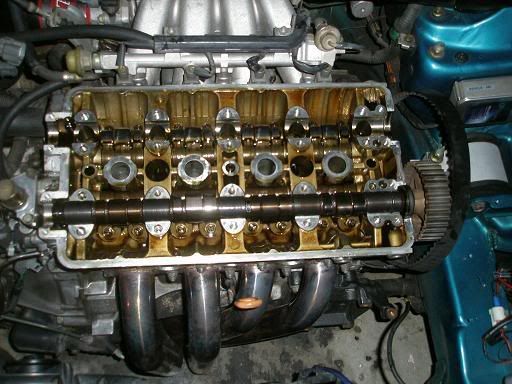

    cam caps removed and intake cam

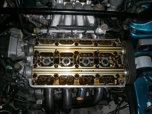

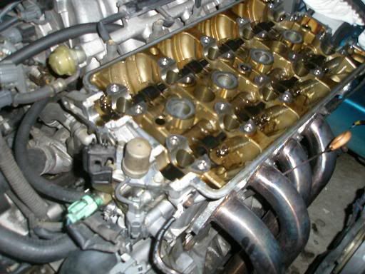

    empty head, lol

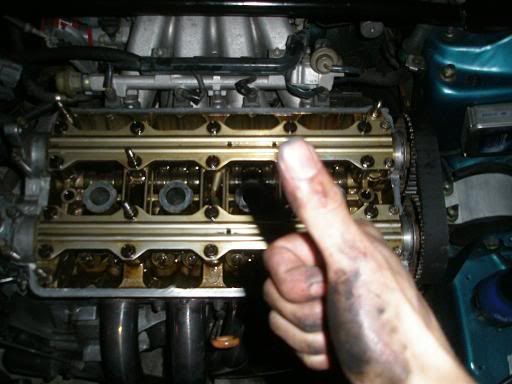

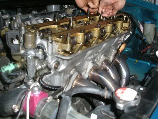

    putting it back together

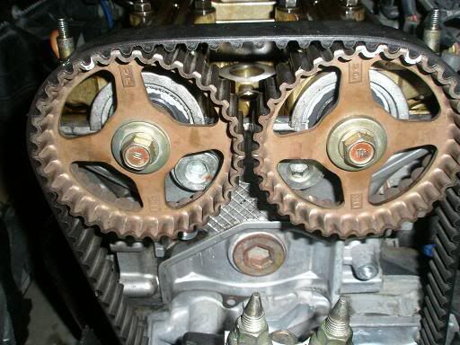

    everything lined up exactly how he left it. You can see honda bond on the cam seals and that the cam gears line up with the 2 lines going horizontally.
    everything torqued down to specs.

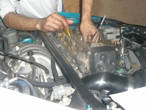

    now the valve adjustment

    ahhh, looks like somebody doesn't use "synthetic" oil
    how can you tell? he's using castro syntec blend right now, not sure if he wants to switch to full synthetic.
    He just rebuilt the motor not too long ago.
    1999 Honda Civic EX - SOLD
    Nov 2003
    22,589
    Quote Originally Posted by DC2girl
    The inside is stained like it's been run on conventional oil for a long time, no big deal and not like anyone else is gonna see it
    ...but yeah always run a conventional oil with a brand new build or rebuild for 500+ miles before switching to synthetic.
