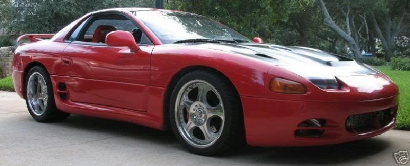

    Default <<< TURBO + SUPERCHARGED + NITROUS VR-4 >>> 1000+ HP
    Saw this earlier scanning through ebay...pretty unique

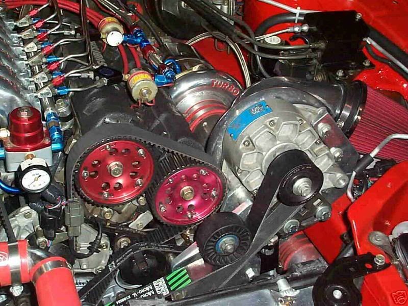

    that engine looks sick like SARS!

    that suede is amazing. It just screams " drive me naked and let my seats caress your nuts"

    car is ridiculously hot nice find

    Not to mention the fab work to mount the engine like that. Pretty slick ride.

    i bet that motor is begging to explode

    no bc the vr4 is a twin turbo setup all he did was put a huge turbo on it that he couldn't spool up by itself and the supercharger is there for no lag.... my dream car is a vr4

    what does that matter, any motor making 1000+ hp needs to have a stronger block. I mean, yeah you can not upgrade it but it will split sooner or later.

    the vr4 stock comes with 9 or 11 psi of boost stock and can be as high as 15 b4 the fuel management has to be upgraded.. once the fuel system has been upgraded the stock turbos can handle more... and with the money vr4s are goin for and what kind of mods i can see i am pretty sure it is done right

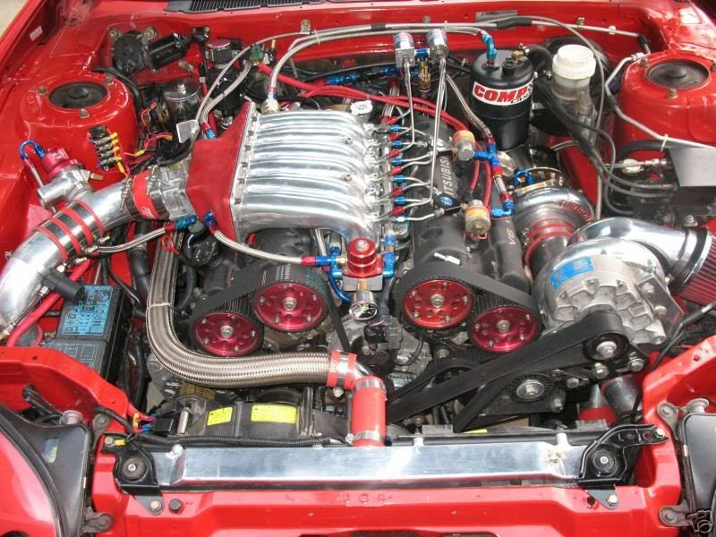

    I bet you this guy has at least 100 grand under the hood of that car.
    In all seriousness though that's pretty redic cause the completely changed the mounting of the motor which means the tranny hooks up different which means a lot of fabrication went into this car. Props to the builder

    good goodness, massive fabrication involved. it the car now rwd? and isn't a stock VR4 engine mounted transverse?

    the vr4 is awd so it is mounted right the regular 3000 gt is fwd

    If you are saying that is how a vr4 motor is always mounted you are wrong. They are usually transverse.

    nice sleeper with the chrome wheels.. LOL

    its built but not a stronger or sleeved block
    ENGINE CAPABLE of 1000+ HORSEPOWER:
    6G72T 1995 model true 4-bolt main block
    Decked and bored 1mm over
    Crower Rods
    JE Sportsman 8.2:1 pistons
    Swain coatings top and skirts
    Full head porting
    Dynamic Racing Race grind Cams
    Fidanza adjustable cam gears
    Ferrea 1mm oversize valves intake and exhaust
    Ferrea springs, seats, retainers
    Late model lash adjusters
    Custom Carbon Fiber Plenum intake
    75mm Vortec Throttle Body
    All ported and polished

    its very nice but the wheels are gross!

    VR-4's have always and probably will always be noice. That could soon be one of the best 3000GT's out there if a good, smart-tuner buys it. Just imagine putting alot of good quality show parts on that. The GO is all set, now the new owner just needs to know how to make it look better and that car is Magazine-sponsored set. Maybe even race sponsored.
