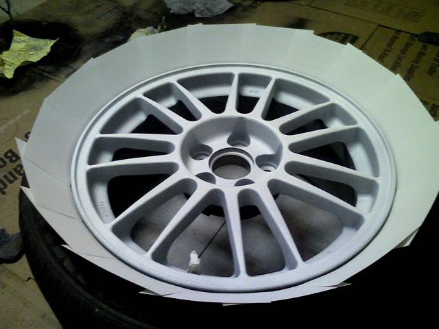

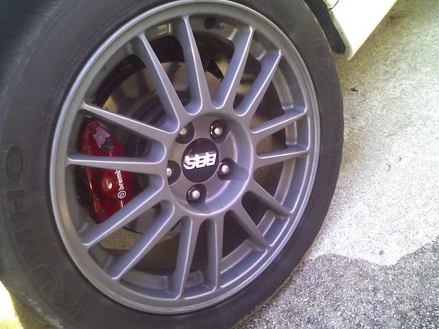

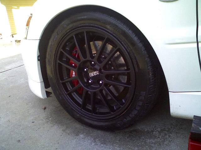

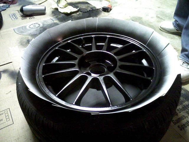

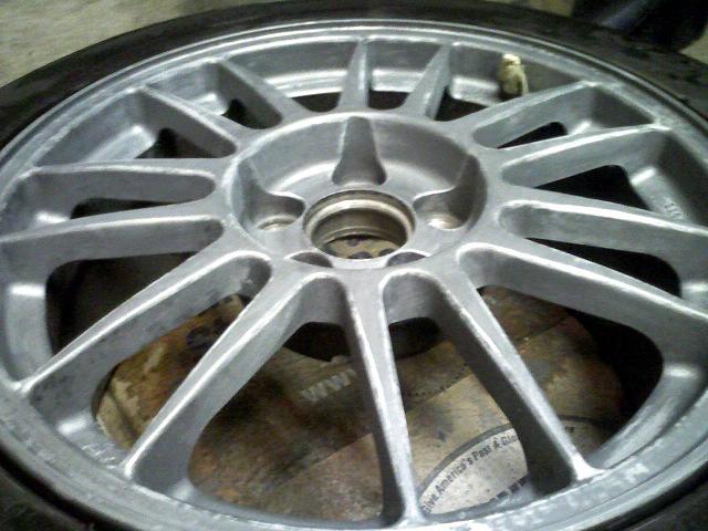

    me and my buddy mike got bored last night and decided to paint his BBS Evo MR wheels. we took our time and did them right and they came out really good. we cleaned the rims, stripped them, primed, painted then cleared the rims.
    so here ya go peoples..this is what u get when ricers get bored

    Looks nice but everyone paints there evo rims black
    stockbridge
    18,643
    your not allowed to have a white evo unless it has black wheels ^
    20,312
    Quote Originally Posted by mastakey05
    his car is white with tint, black housing headlights and tail lights, and its a RS so it has black door handles and mirrors so hes got a white/black theme going on so it was natural to paint them black

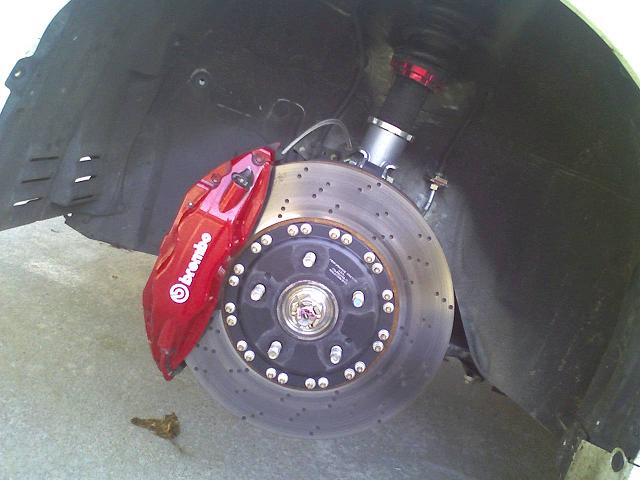

    he wanted to do white but keeping them clean would really suck with the brake setup he has cause it creates alot of dust. the gunmetal just didnt look right on his car with it being white in my opinion.

    oh yea, the hell are u all stripping the wheels with? i need to do what everu wall are doin, it took me days to strip my wheels..

    its called "klean strip premium stripper" we got it at wallmart last night. its in a spray can and u just spray then rims, let it sit for 10 min. or so and it straight eats all the clear and paint off down to allmost bare metal. the sh1t is amazing.

    WHAAAAAAAAAT
    so u mean i went and used that bull**** airplane remover, ametal paint can, and a paint brush and spent hours scrubbing to get a half ass job for nothing...
    i think i saw that suff too..lol
    20,312
    WHAAAAAAAAAT
    yep lol
