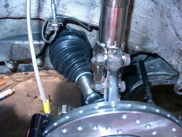

    Cadilliac axles mounted to VW hubs: The Auto/trans also hooks up to the VW linkage

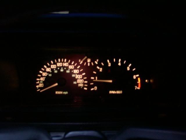

    STS Gauge cluster mounted into dash

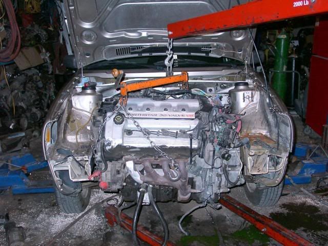

    Early in the build. the Northstar is 3ins shorter than a vr6. go figure
