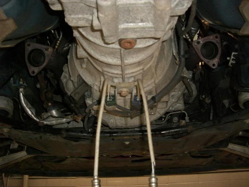

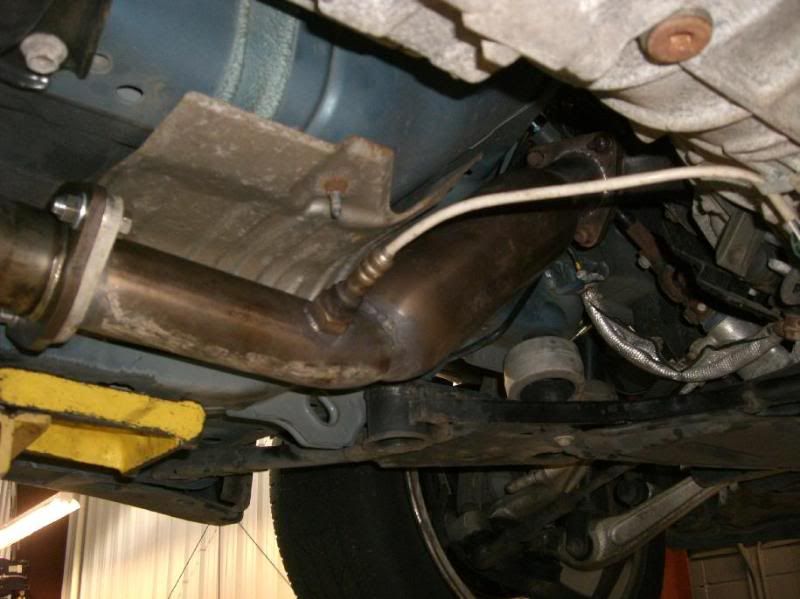

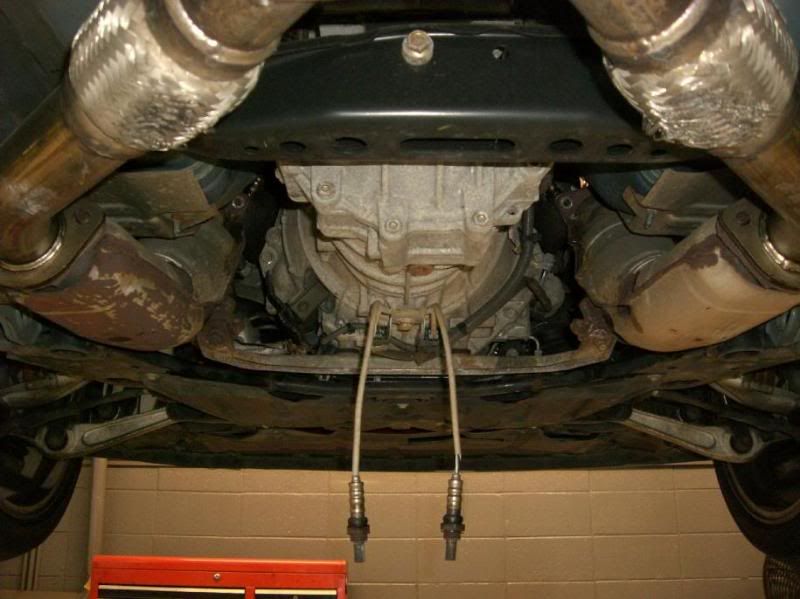

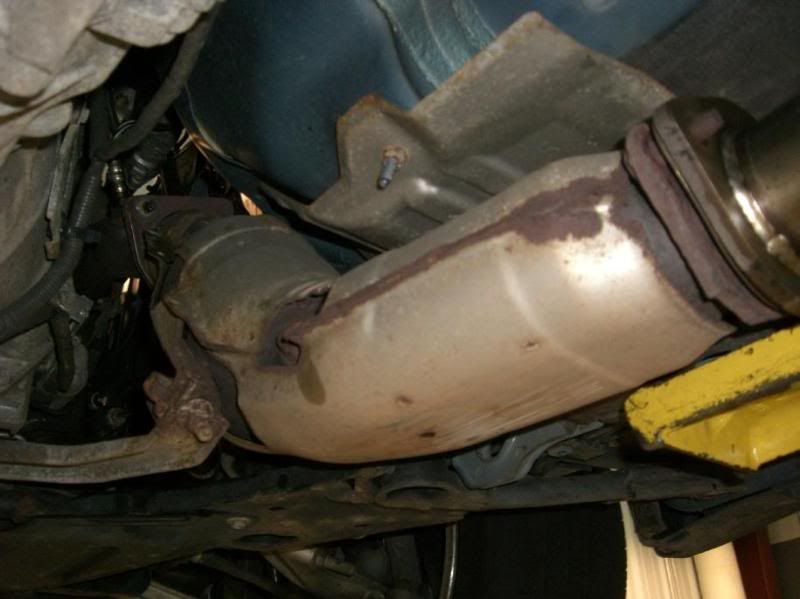

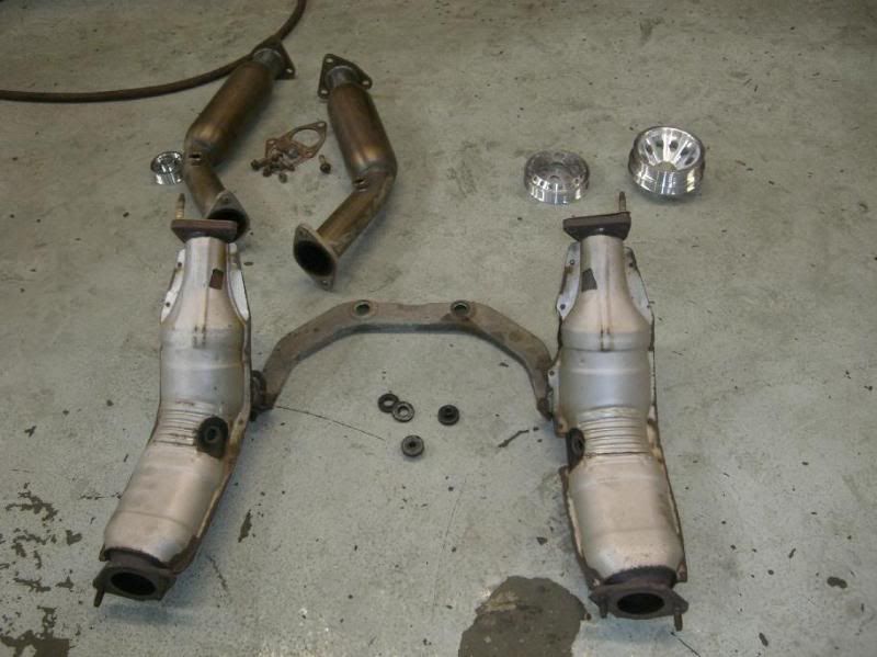

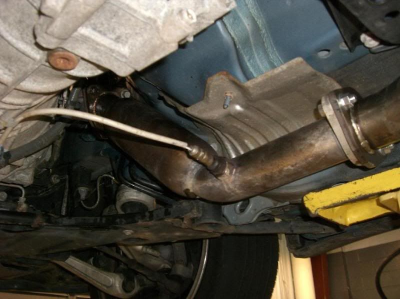

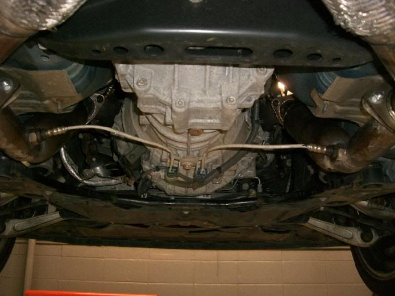

    Today I installed my test pipes after work. The install was smooth and went pretty easily. Nuts were rusty but broke loose fine. Here are some process pictures and sound clips. I'll get a fly by video tomorrow or sometime this weekend.
    Uhh yea, the "Service Engine Soon" light came on very shortly after, on the way home. Oh well...haha.
    With Cats
    With Test Pipes

    That is nice...try to add some ring/spacer on the o2sensor, the service light might go away.
    National G Club Jonflip29's Avatar
    Atsugi, Japan
    545
    Quote Originally Posted by cdhtang
    I used spark plug non-foulers to space the O2 sensor. CEL is off.
