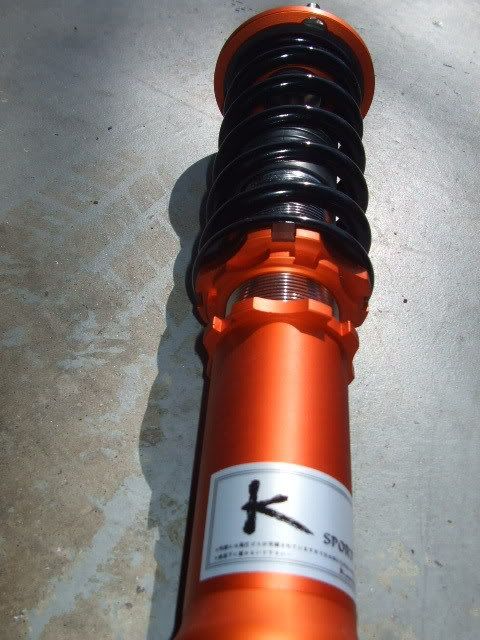

    little update non turbo related
    got my new suspension

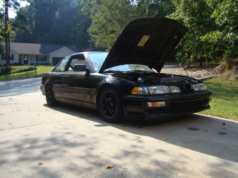

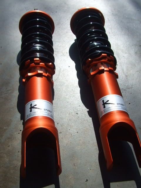

    got the suspension on and i made another thread with pictures of the car.
    and i got three of the rods and pistons in the block, waiting on a piston ring to put the fourth in and ill post pictures of that as soon as its done.

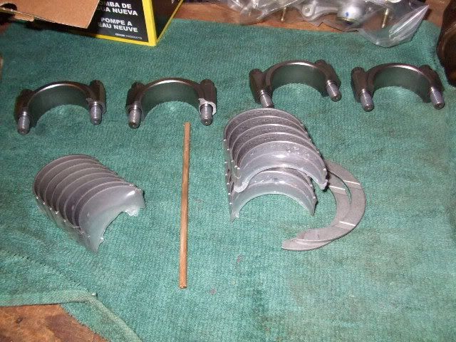

    i went to install the bearings and crank when i realized the bearings were wrong.
    so i gotta get new ones now. otherwise i would have some updates. but hopefully i can get them soon.

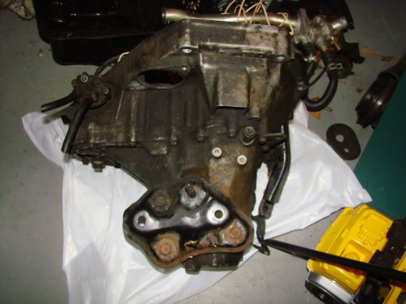

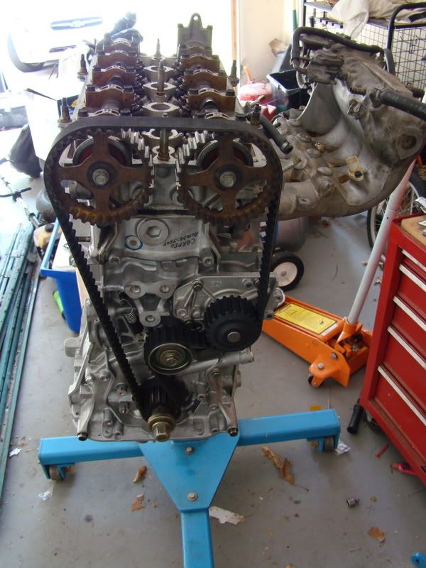

    alright so a few of you might have thought i gave up on this but no
    i just hit some snags but it is finally getting there
    my transmission decided to take a huge crap this past weekend.
    like a huge crap
    so no im taking the tranny and old motor and and putting in everything for boost
    here is where it sits as of now
    here is her new heart ready to be dropped in

    here is part of the the transmission it decided it didnt need
    and here is the new transmission
    needs a little bit of scrubbing

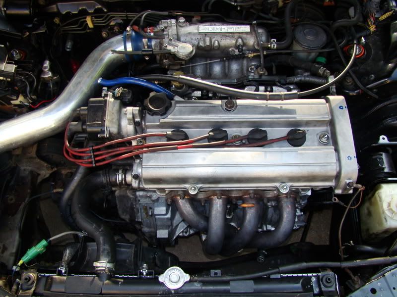

    new motor is in the car
    my camera took a crap on me but now is fixed
    sorry thats why i haven't been able to update but i will get some pictures of everything tomorrow
    I'm waiting for about 800 miles to be put on the new motor before i put the turbo on so i can break it in and make sure its running right
    sorry this has taken so long everyone but its finally almost done
