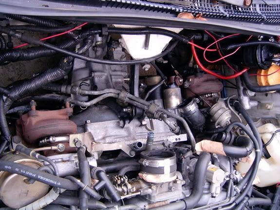

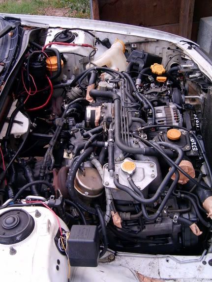

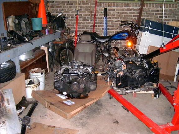

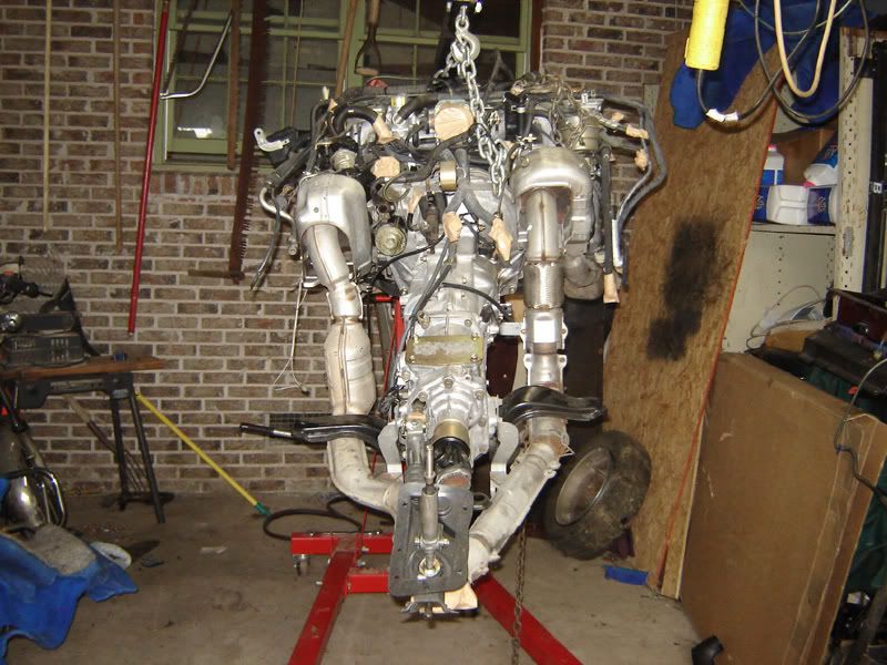

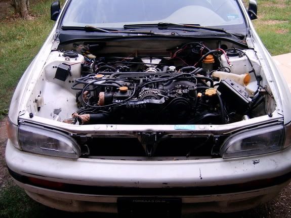

Here is my friend Subaru, that we're in the process of swapping an EJ20R into. He wanted me to post these pics so here they are. We've come along way and have gas tank and lines done, rear 4wd suspension done (converted from 2wd), pumpkin in, shift linkage in and fixed, motor in but of course still fitment issues with the steering column hitting the turbo downpipe, new front crossmember in, etc., etc. Trying to find a way to keep it twin turbo, but if worse comes to worse then it will be single. About to start on the wiring in a few days. Cheers!
New EJ20R from JHOT
Comparison of stock vs. new

Engine In
