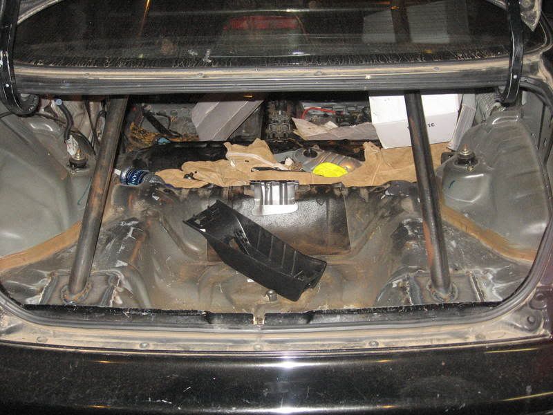

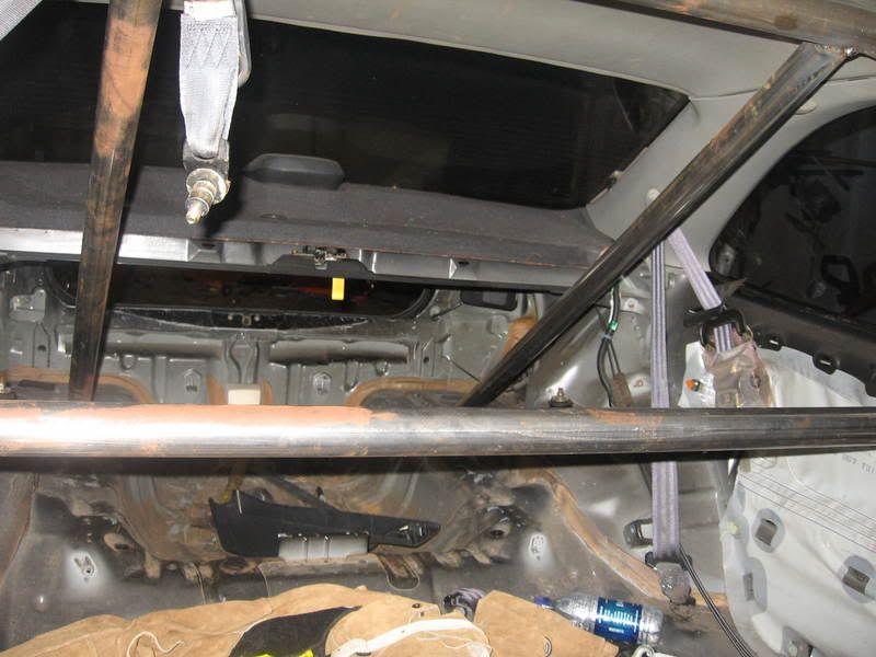

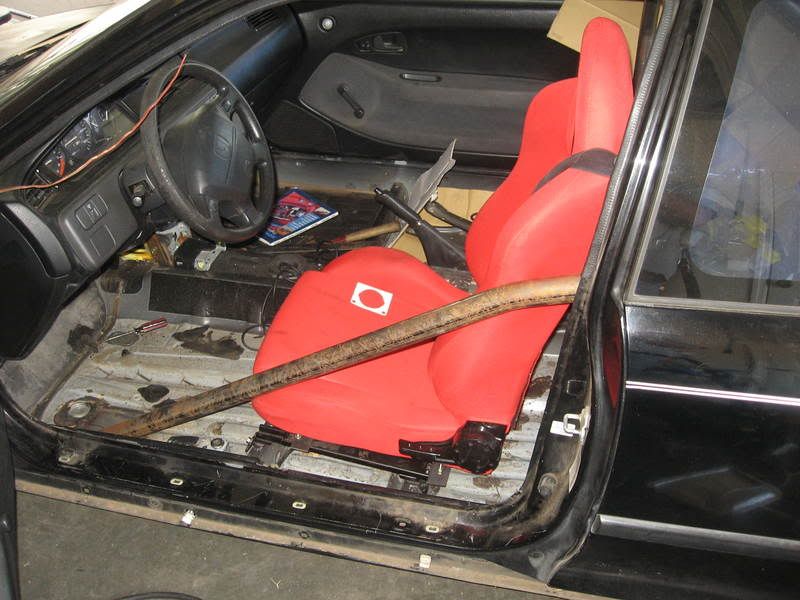

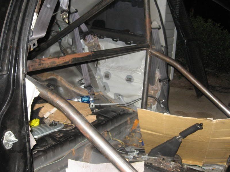

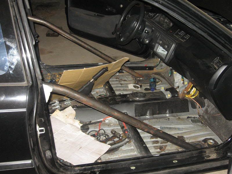

    i have been working on this roll cage in my spare time for a few weeks now and im finally done. the install wasnt bad at all. everything went good no major problems.

    whats this for, i dont want to start picking out problems before i know if its for pleasure or actually racing and stuff. Looks like you are on the right track.

    are you doing this for drag racing?

    yes

    then its not done, you have to add the cross bar at the bottom between the rocker sills and put the D bars down to it, IF you are going to use it for real. If you are just doing it to help your own safety in general then its ok i guess. the d bars keep the cage from folding over sideways in a flip.

    i have those i just need to add them in. i just need to get a couple more plates then i can put them in.... thanks for the info

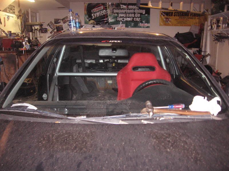

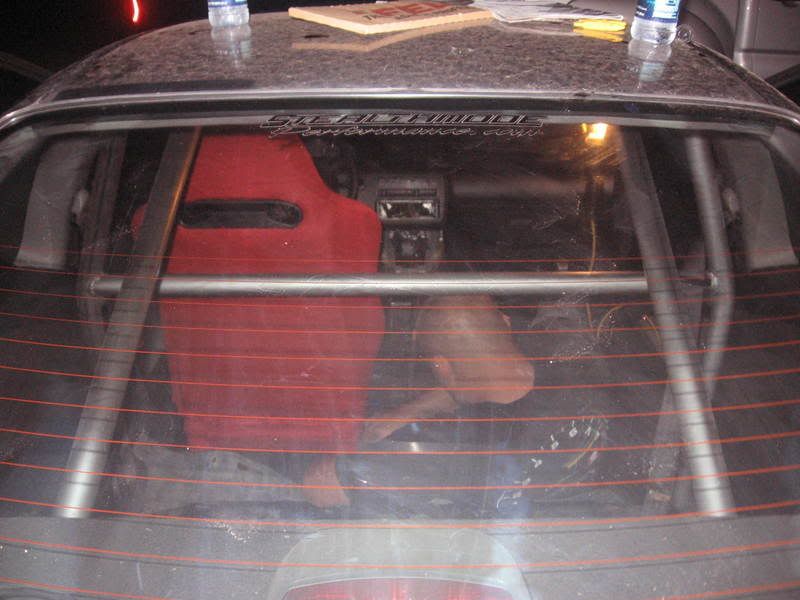

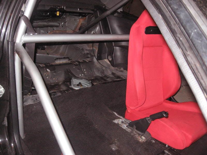

    here are a few more i got it painted and got most of the inteior back in
