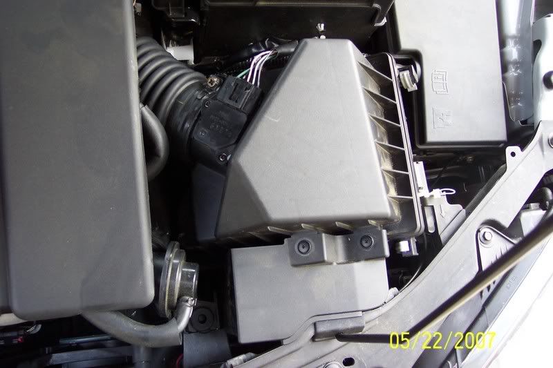

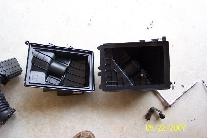

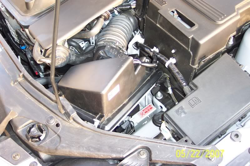

Stock

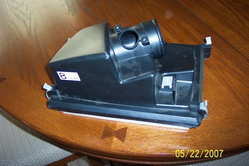

Stock from non turbo (strikingly similar! )

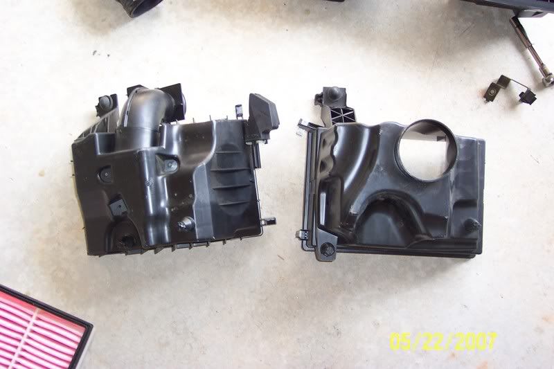

Non turbo(on left) Turbo(on right)

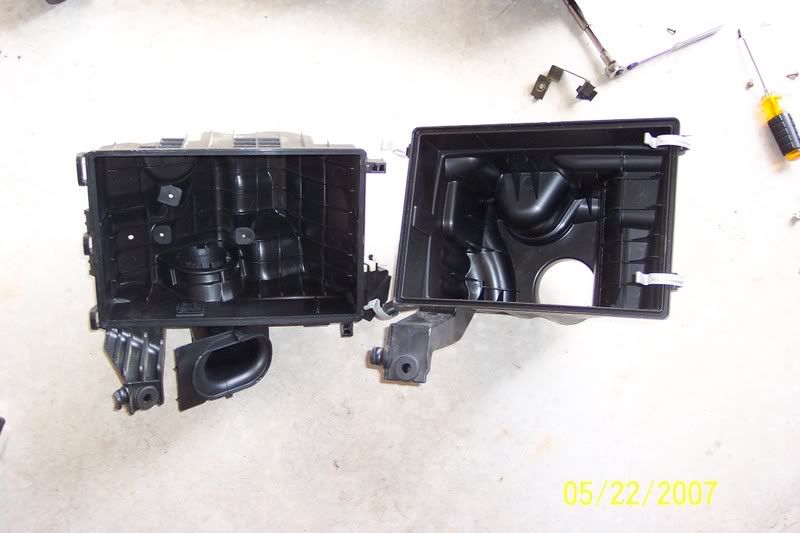

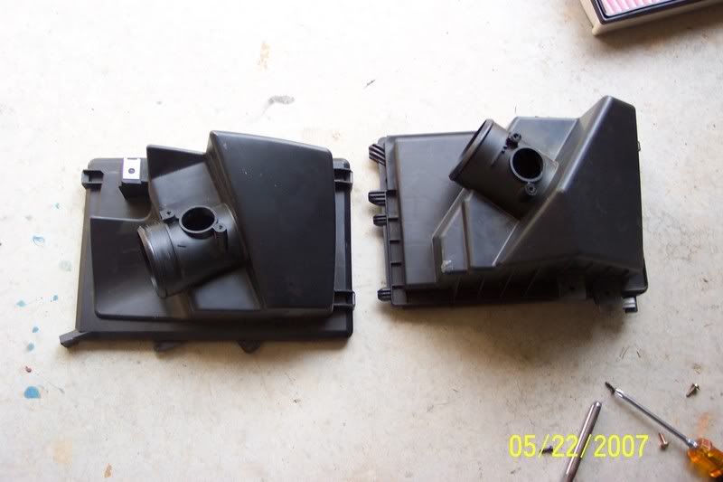

Turbo bottom (on left) Non turbo bottom (on right)

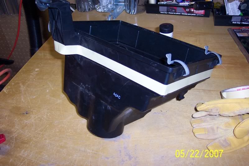

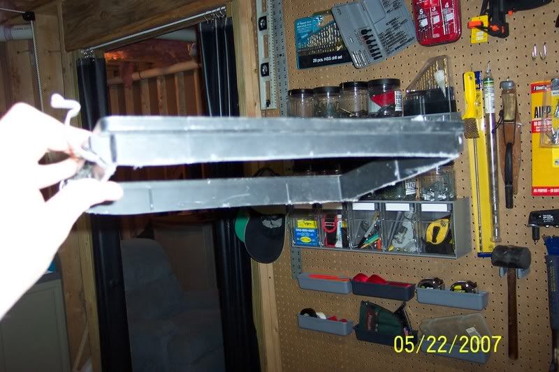

Fabrication time!

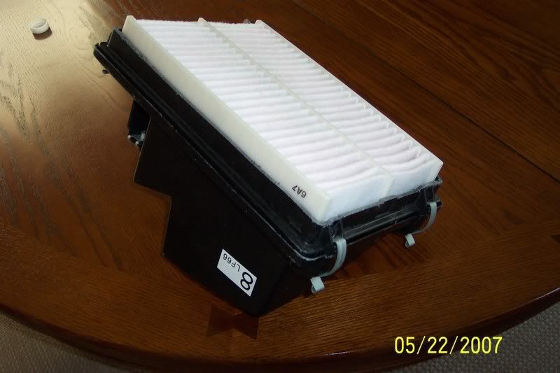

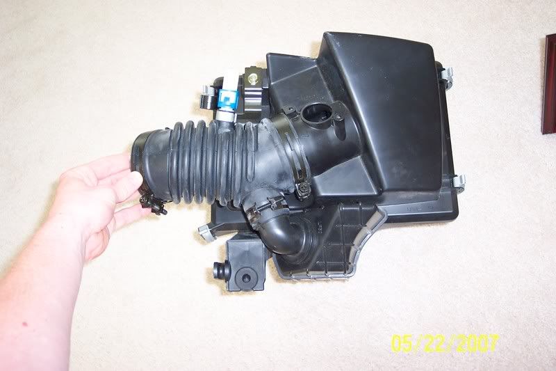

Finished!
There were no real fitment issues i just rapped one of the housing clamps because it rests close to the upper radiator hose. The butt dyno says 0 gain so far but the ecu needs to adjust, also there is a light stall in first. I checked the diameters of the MAFS housing and they are the same size. I get all the cool turbo noises now too lol. Only thing left is to get a K & N and allow the ecu some time to adjust!
