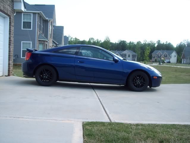

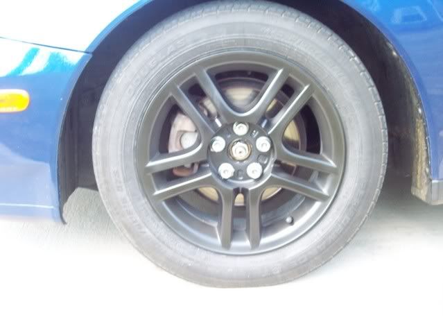

    Well this past weekend my and DaKilla4Eva (Davis) painted my wheels, im pretty surprised on how the came out.The wheels actually turned out a lot better then i thought they would. We started painting these wheels on this past sunday at about 3PM and finished at about 11:30PM. Let me know what ya'll think.
    Steps I took to paint the wheels.
    First i wet sanded the entire rim with 220 Grit. After that i taped off wheel, then used a High Build Primer (Really good for sanding & you only need 1 coat), then i wet sanded the primered wheels with 400 Grit to get it nice and smooth. Then used Dupli Color wheel paint. First 2 coats were applyed lightly!!! last 2 were applyed thick.
    Make sure u follow the drying instructions on the back of the paint and primer cans, for best results.
    The wheels have a few scratchs around the lugs from putting them back on the car but those will be fixed this weekened. Actually thinking about leaving the off, but not sure.
    Before: Pics of me and some friends, before i was dropped and painted the wheels.
    Afrter: Drop on Hotchkis Springs and painted wheels.

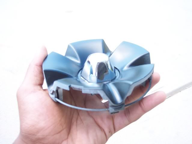

    Center Caps: Still off car untill paint is fully cured (7 days on the back of paint can)

    looks good!
    No
    9,232
    They actually look decent. +1.
    who knows.
    3,576
    looks good , tryed pming u on gettin u some lower pro's u need some bro but the paint looks freakin great!

    Thanx everyone, i was surprised too on how good the came out. the car looks soo much better. in about 2 weeks ill be smoking out the tail lights and amber side markers.

    looks good man and you need to come out to the next skate meet +1
    Looks good Drop is hardly noticable IMO though
    Southside
    1,268
    Finally a Celica w/o altezzas +1 for the good job on the DIY

    well in the front it's not that noticable but it is in the rear and seein it in person, if u notice all stock celicas have that fugly neon stance but wit the hotchkis springs they kinda level out.
    yeah i hate looking a celicas wit euros/altezzas, but this weekend im smoking out the tail lights and amber side markers. so be on the look out for more updates.
