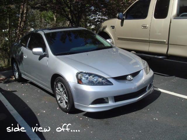

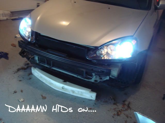

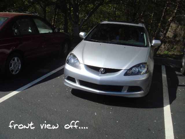

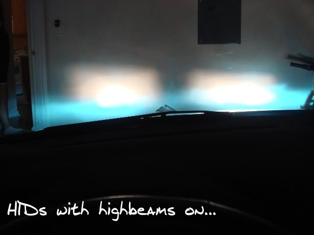

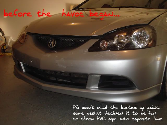

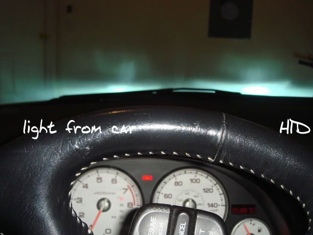

    Nothing special just a base 05 auto RSX. Got the 10k hid from Nitro and install was a breeze (EXCEPT for the fact that on RSXs you have to remove the bumper to change bulbs lol and take out headlights). PICS \/
    LAST NIGHT...
    TODAY....

    Glare ftl. But I still like blue.
    2.0TRawr ironchef's Avatar
    8,414
    Good look but 10k, eww, no higher than 6k please .
    Dacula, JawJuh
    11,444
    I didn't get 10k for functionality lol I mean its still a hell of a lot brighter than stock but i likey the blue.
    Yes and glare for the mother fucking LOSE.
    I just figured out my fiancees car has projectors (even though I cant steal them) I am going to get her 6000k's so she can see better in the rain and such.
    And yes I am in the process of getting some things together to do projectors on the RSX hehe

    i think you might have to make a custom housing or something. those HID's have no cut-off line whatsoever.
    Dunwoody/Sandy Springs
    3,631
    Quote Originally Posted by ironchef
    x2
    you lose output and it hurts you eyes (at least mine) when the colors reflect off of everything.
    Quote Originally Posted by TTaz02
    nice set-up but get projector housings. you're killing on-coming traffic with the glare.
    x2
    i put a set of hid's in my halogen projectors on my old car for about a day, then i realized how much they blind ppl. then i got some projectors, which are a must.

    Not to rain on your parade, but 10,000K is too impractical. You have defeated the purpose of HID (created the whitest and cleanest lights) and just turned your lights blue. After passing a point, everything just becomes a downgrade in visibility. The only way to really do HID aftermarket on reflectors is to retrofit to projectors. Right now, you are blinding everyone and suffering with downgraded visibility.
