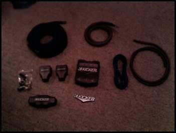

    on a good note, here are some more pictures of the stuff.
    comparison of 4 gauge wire and the new 1/0 gauge. pretty huge...

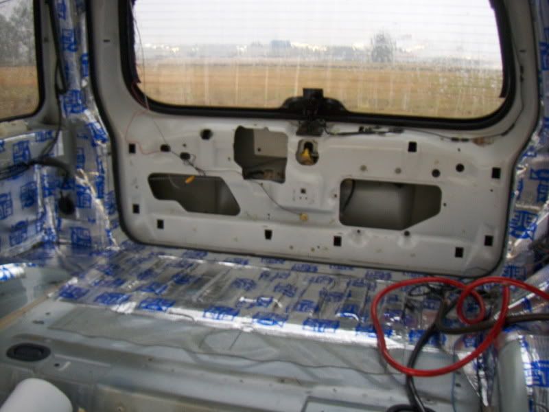

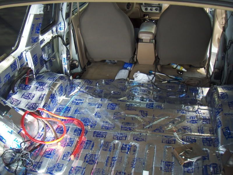

    today i put the new battery terminals on, ran 4 gauge wire to the starter, alternator, fuse box, and abs relay box. 1/0gauge was ran to the back and i changed all my chassis grounds to 4ga along with one 1/0 ground from the battery to the chassis.

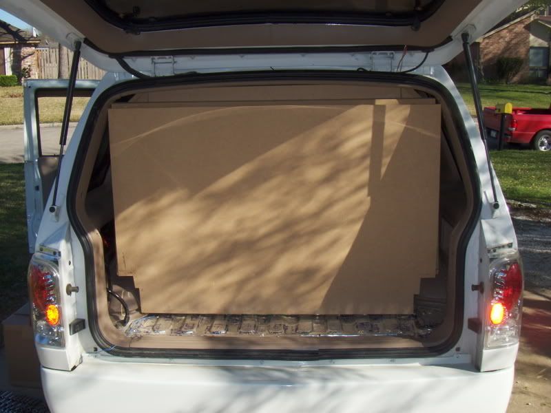

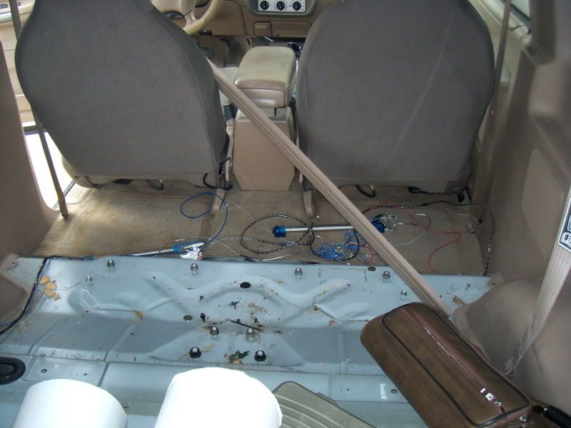

    tonight i started on the rear seat delete and cutting the boards for the box. i only had about an hour before i ran out of daylight, and i dont have a garage so once its dark, thats it. i didnt take any pics of the boards for the box, but here's a cell phone shot of the progress on the rear seat delete. obviously the boards will be together with no gap and carpeted, but that gives you a general idea

    the final product will be in 1/2 mdf, right now is just a outline

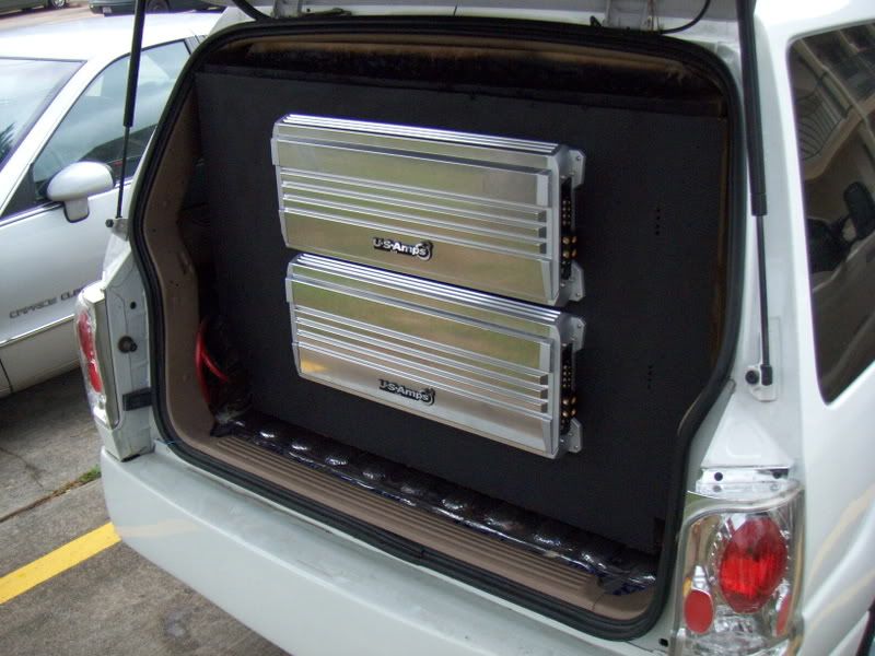

    Right on...that is the only way to do it. Bass ftmfw!! Just pulled 4-18" FI BTL subs out of my truck. Was walled off.
    02 WRX patrick4588's Avatar
    warner robins
    2,329
    omg pics please

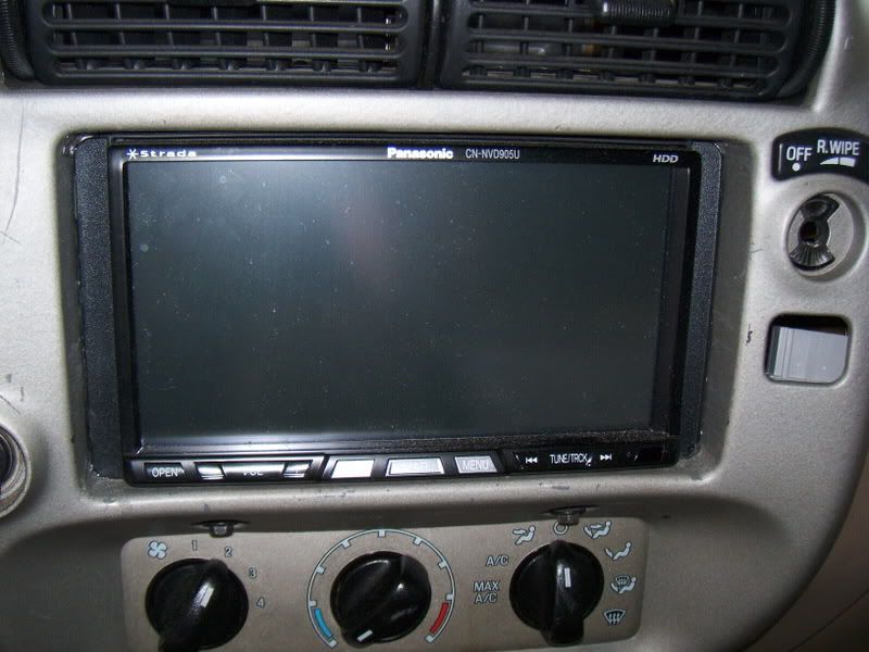

    Got rid of the Pioneer Avic Z1. Bought a Panasonic Strada 905U. Nice.

    Tore it all out. I still have one more BTL for sale....The amps are all for sale, even the four channel for the speakers. Already sold the mids and highs, and one battery. But have two batts left. It is all in the for sale section. Selling the radio too. Was going to do 16-P3 12's in there, but I am holding off for a little bit right now.

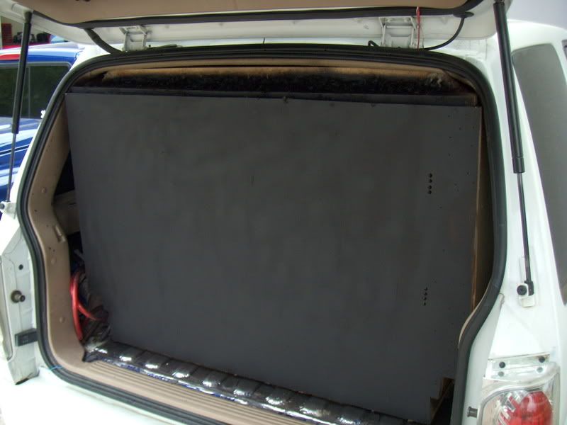

    spray painted the box black just in case the carpet ever tears or anything like that it wont be very visible. also bought the carpet for the box.

    today i painted the ports and carpeted the box except for the sides (ran out of material). i left a little carpet overhand on the sub holes because it should help seal them up.

    this ish is gonna be sick!! cant wait to see it when its done! thats a good idea to paint the box in case the carpet tears... just as long as the wood doesnt get scraped it wont show
