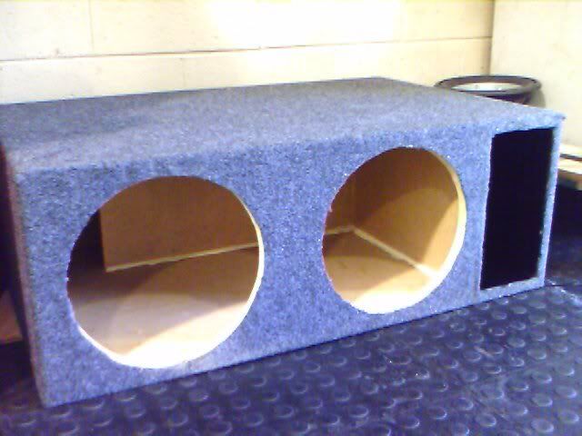

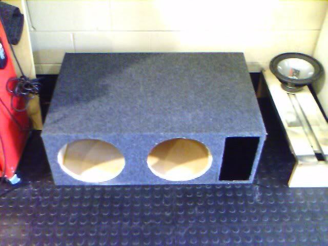

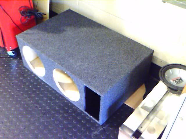

    I had a customer come in this morning and wanted a basic ported box built for 2 12" MTX 9500 2.5cu@34hz the face is braced in 3 spots but you cant tell from the pics in a bronco His box was stolen but they didnt steal the amps he just got the 9500 shipped to and should reach me today. He is running 2 jl1000's i will have some pics when i get them installed, they should beat pretty hard.

    dude i've been fuckin with caraudio forever and that box lookes like a speaker tearer upper ,,,,that port is retarded ..gonna be some serious travel going on
    I like these slumpy ass boxex but I;d never sell to any of my customer ,just for the simple fact I DONT like swapping out subs every other week
    but with that being said ,,i'm sure she's gonna knock!!!!!

    i use winsid on all my box's ive built and double check my math even after i get the plans, and tune according to what the customer music need are for .I just dont buy 4 pieces of wood and slap a box together and have not had anyone blow subs in a box ive built unless the sub was just bad or due to the customer going behind me and turning up the gain on the amp after i set it correctly. i go by the manufactors spec and if tehy want a lil more boox i might make it slightly larger to get a lil more low end but nothing crazy. i would have made the box higher then the port would have been slimmer, but the customer need a low box and what you make lower you have to make wider.

    so let me get this right he's gonna rock 2 mtx 9500's and 2 1000/1 ...whoaa thats gonna be retraded
    and that math on the box 34hrts?????no wonder the port is so fucking gianoumous what the fuck does this dude listen to???

    i was also wondering why the fuck you would not chamber that box and build 2 ports since he is running 2 amps....
